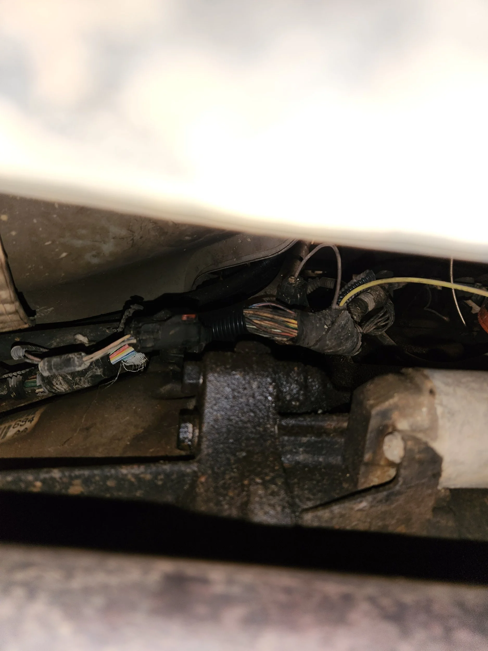

Check the wiring harness on the driver and passenger side for rubbed/chaffed wiring.
I found a rubbed wire on the passenger side of mine and repaired it and no more codes!!!!!
Mine was right above the sensor and that's where it rubbed and was messing it up.
Not the best picture but that's where mine rubbed
