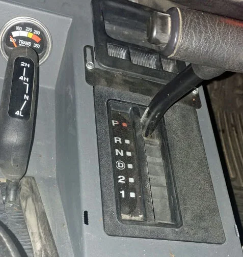

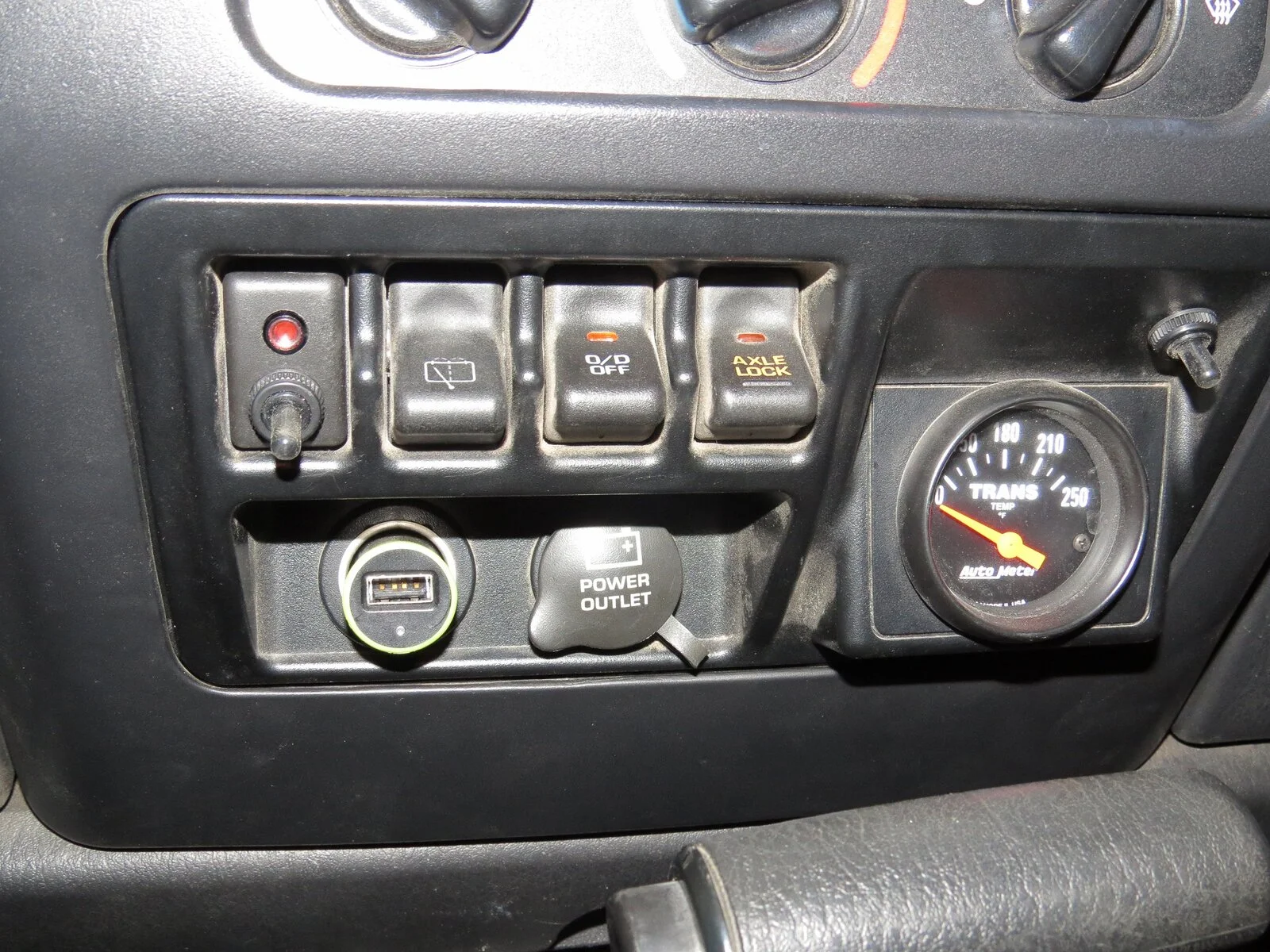

What does the gauge say you should do?
As in ATF/transmission temperature gauge you add which is strongly recommended.
Like this one from B&M...

With the drain plug as the sender will the engine skid still have clearance is what I’m looking to discover.
Which engine skid? Mine has a Dorman pan with a drain plug and a temp sensor. It barely fits inside the Savvy engine skid, but that would be true of the stock pan, too.
