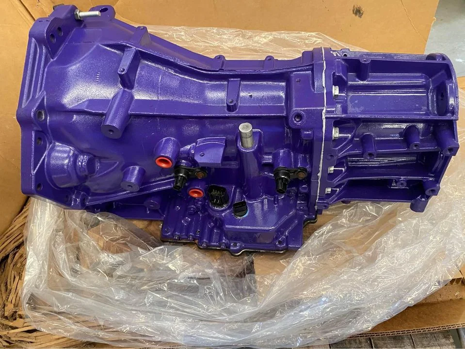

Can anyone verify that this will fit a TJ? ATS says it does fit.

2003-2006 Jeep 4.0L / 2007-2011 Jeep3.8L ATS Jeep jk transmission, torque converter, trans cooler and co-pilot trans controller. Has less than 1,000 miles on it until the Jeep was totaled out. I had only ran amsoil fluid in it. Buy brand new for over $4,000.

That's interesting, as the bell housing should be different between the JK 3.8L and a TJ 4.0-L, right? Like if its a JK transmission, its not going to bolt up to a TJ...even though they are the "same" transmission.

The bellhousing is different. I suspect that there are other differences as well, potentially gear ratios.

Unless someone makes an adapter it’s not going to fit a TJ. I say that because that bellhousing doesn’t look like it’s removable.

if you look closely at the bellhousing bolt holes, you'll see two different patterns drilled in the casting. I'm not saying it for sure fits, and don't really have that much of an idea of what the bolt pattern looks like on either engine, just noting my observation.

The only reason I am sure about it is because I was reading old threads and someone attempted to put a JK 42RLE on a TJ and they said it didn't work because the bellhousing wouldn't mate up to the 4.0.

Was it just a random 42RLE or specifically one from ATS? My comment was based on the possibility that ATS could get housings cast to allow for interoperability that the original factory transmissions didn't have.

@Wildman that is a JK transmission with ATS' own trans controller ("co pilot" as described in the ad) that interrupts the signal from JK PCM and replaces it with it's own. It won't bolt up to the 4.0 since ATS diesel just rebuilds cores with their internals.

I have a ATS built 42RLE in mine. I talked to them and gathered all the information before I ordered. From what I learned, the JK one with the co-pilot is incompatible with the TJs. The bell housing doesn't fit the 4.0. The seller is very likely guessing but that's quite common 🙂

I think the JK uses a variable rate pump to soften shifts and reduce drag so there's more than just the bolt pattern. I don't know if the variable rate is mechanical or computer controlled. Funny thing is the transgo kit does the exact opposite, raises the system pressure to firm up the shifts.
