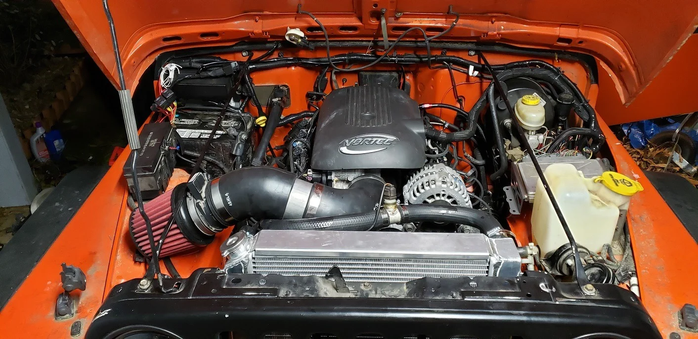

It's been a busy week but I got to drive it today and there is a HUUUUGE difference in drivability. I went from barely being able to hit 5th gear, to burning rubber through 2nd gear with 33 inch mud tires. The exhaust was kind of a hold me over design I made since I already had a 16 inch glass pack so I ran to AutoZone, bought a 24 inch glass pack and a few other connectors and welded it together. The exhaust on the passenger side used the original after market 2.5 inch exhaust from Pace setter that was on it I just needed about a foot of pipe and a new hanger to bridge the gap. the drivers side was where I used the glass packs. They're pretty cheap at about $24 so it goes from the down pipe, to the shorts glass pack, then the longer, and then it just turns down right after the T-case. I think I'll have them match the drivers side exhaust to the passenger side eventually with another pace setter or flowmaster muffler right after the T-case but for now it sounds pretty awesome and it works.
I have to reset the shifter. I have it leaning to far back so I cant put the center console back in but that an easy fix. Just have to cut it, adjust the angle and weld it. I have to reset the gas pedal to the right a little too because the brake pedal it hitting the brake but that's a pretty easy fix. it's been a long weekend, But ill be posting pictures of everything i did soon. In the meantime. enjoy the nearly finished product.

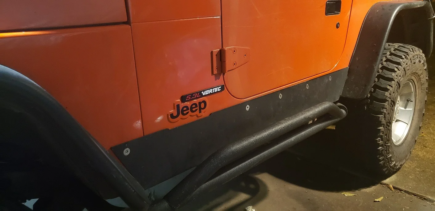

You know... in case anyone gets curious. I kinda wanted to put it higher but I felt like I needed to go next to the jeep emblem. either way... might change it around later but I think I like it there for now.
92624
I thought about an emblem for my swap too, where did you get it?
I got them off Amazon. Just search "5.3l vortec emblem" and a whole array of them will pop up. I got the 16 dollar ones and I like the quality of them. But they have all kinds of colors. I actually ordered another set because I messed one up on the passenger side. I'll have one to put on the back now so people will know what passed em! :p

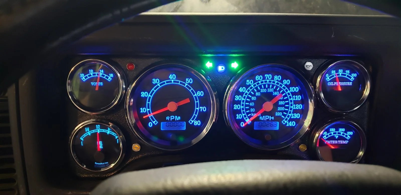

I changed the dash around. Found these pretty cool LEDs with the actual emblems and added a low oil light. Couldn't find one for the 4x4 so it's still an LED but I'll keep looking. Also got all the gauges working. I had to splice a 12v key powered 1k resistor into the input signal for the Tach but now it reads. The water temp sensor is in radiator and the oil sensor uses an adapter that replaces the stock sensor near to top back of the block.
