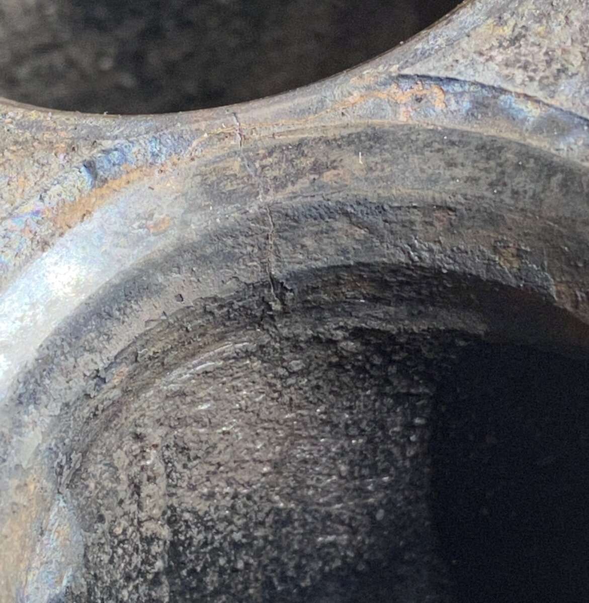

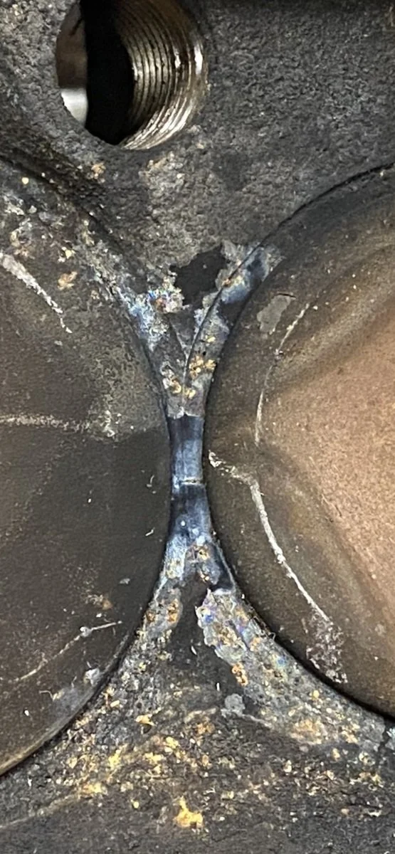

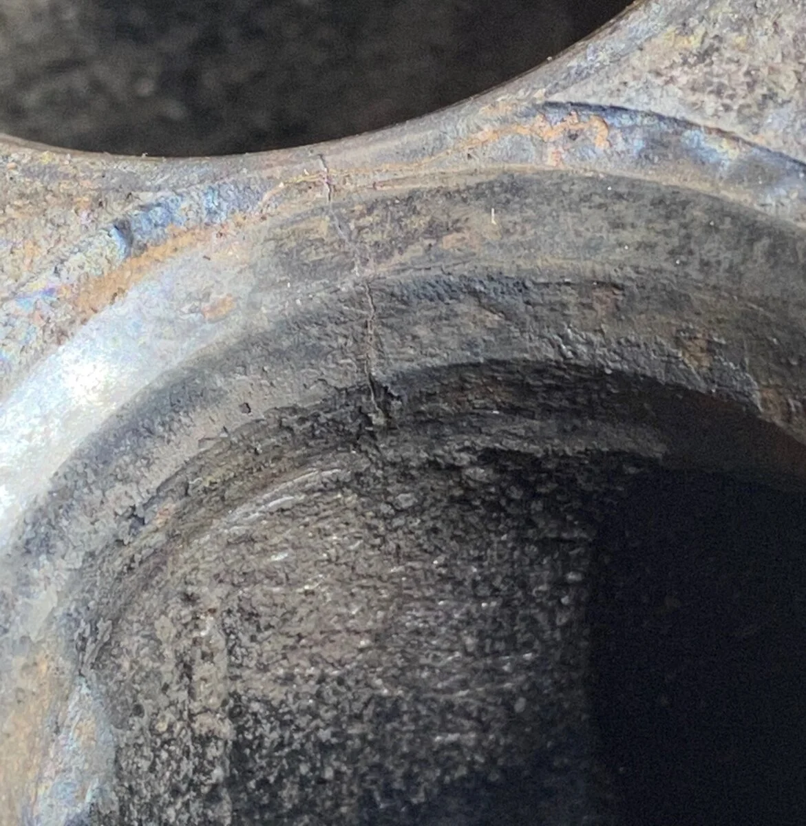

As I said there's folks here that can help as you do things. The #1 issue with the kegger on the Magnum is the plenum gasket blowing and then you sucking oil into the intake. The #2 issue with the Magnum engine is the heads cracking around he exhaust valves. A lot of heads will crack with no issues but then other times you engine up with major issues so doing a compression test & leak down is a good idea. They are actually pretty good engines.
This was one of the heads off my 5.2 Magnum
