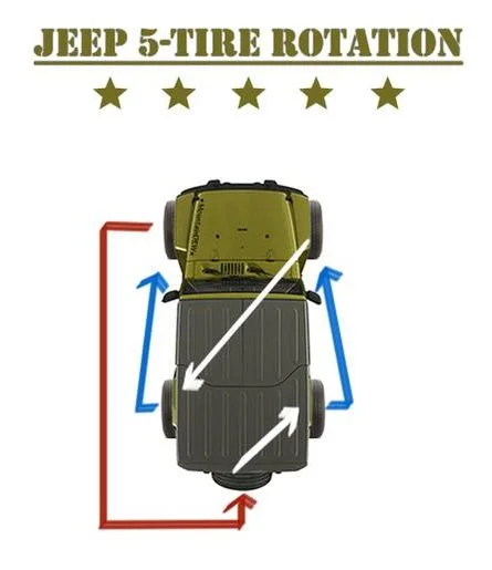

5 wheel rotation, is it worth it?
I used to run 4 33x12.50x15 with a 33x9.50x15 for a spare, when I needed to use it I couldn't tell it was there but particularly when going off road I always like to carry a full size spare.
Off topic: We have the strangest rule regarding the spare tire in australia...
You are not required by law to carry a spare but If you do, it must be the identical size and tread pattern unless it's OEM
I'm old enough to remember when you didn't change direction on radial tires. This is no longer supposed to be the case but because I've been doing it for so long I still only swap front to back. I don't rotate in the spare, but if I have a posi I make sure the spare is the same size as the the other tires so if I put it on the back it won't eat the clutches. If it is not, I will only put it on the front. This creates some pretty crappy handling, but will get me on the road (or trail) again.
Reactions: Wombat
If your TJ is a daily, I think it is worth rotating the spare, particularly if you don't use a spare tire cover to shut out the UV and even if you do a tire comes with a DOT manufacture date stamped into it and once its over five years old it's not roadworthy here in AU and needs to be replaced. A tire fitter wont even fit a tire that's over five years old here in AU and that's a good thing, I've seen too many disintegrate from age, It's common over here to see trailers stranded because they didn't pay attention to the age of the tires.
We all know running oversized tires exasperates the effects of poor handling but coupled with old or worn out tires posses a big risk so you might as well get some use out of the spare that you should be getting rid of once it's past its use by date.

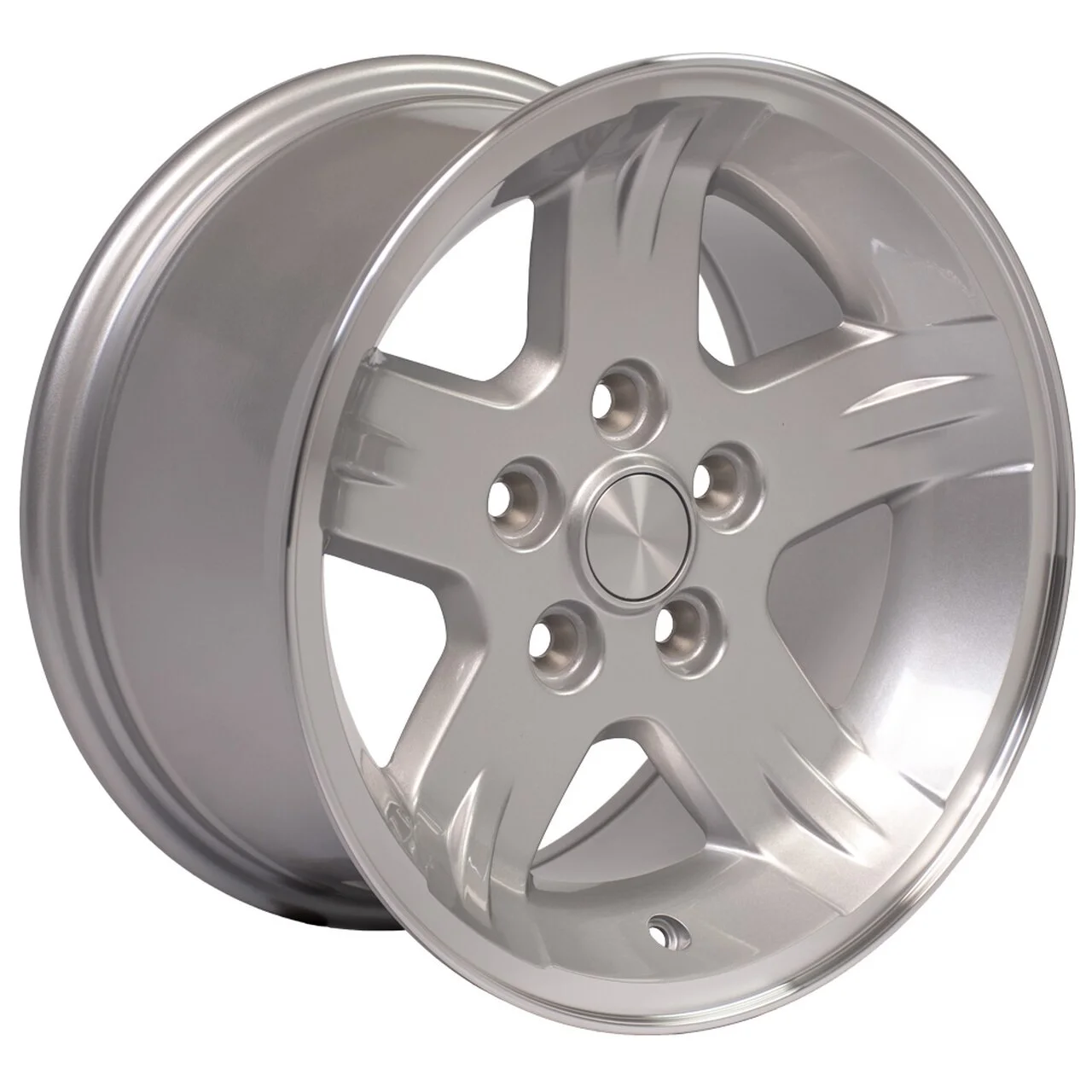

Related question, if I got new wheels/tires I'd sell what I've got. Which are 30x9.5 General Grabbers that were brand new a year ago, have maybe 5k miles on them. I didn't buy them, bought the TJ and that's what it came with. Spare is a matching OEM wheel, but not a matching tire. It's a Wrangler tire, same size at least.
What do you think I could get for the full set?
It's these wheels.
Around 500-600 especially if the wheels are good
Reactions: Wombat
Oh wow, nice. I may look into upgrading anyway then. The wheels on mine are so nice I suspect they might have been new as well. If the backspacing was right for wider tires I would just run them. I don't really care for spacers, would rather have the right wheels.

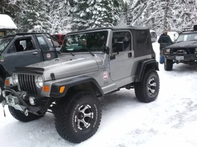

Anyway, thanks for the opinions. I think I'm going to stay with my original plan for a matching spare. Kinda like these wheels, if I'm buying new.
Random pic pulled from internet, mine is Khaki metallic.
Good luck.. like the color... those ravine wheels are nice!.. if you can keep them you might be glad down the road that u did!!
