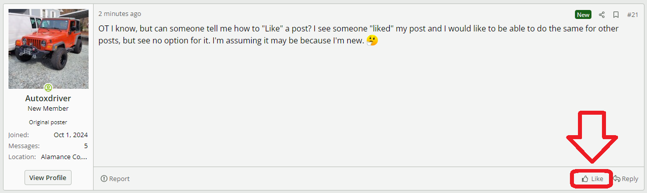

OT I know, but can someone tell me how to "Like" a post? I see someone "liked" my post and I would like to be able to do the same for other posts, but see no option for it. I'm assuming it may be because I'm new. :unsure:
Lower right corner, but if you don't see it, it could be due to your low post count, as you suspected:
