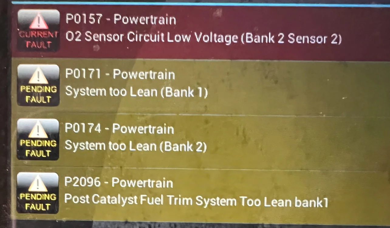

That said, I had a similar situation and that was with new cats installed. I was getting exactly 7mpg on the highway because my intake manifold had a vaccuum leak due to a hose coming loose. I had lean codes and the system was pouring in fuel to keep me from running lean. My suggestion is to do a good inspection of this. Ask for help if you don't know all of the locations to check.
I smelled a heavy smell of gasoline because the system was dumping too much fuel into the system to account for the vacuum leak.
BTW, I fixed the vacuum leak by connecting the loose hose, but I also had an issue with the B2S2 wiring that was shorted between the transmission. That's why you see the O2 code in the following screenshot along with the codes from the vacuum leak.
Additionally, a pressurized smoke device (using shop air) will make quick work of knowing if you have vacuum leaks, but it's not necessary for finding something obvious like a disconnected hose.
