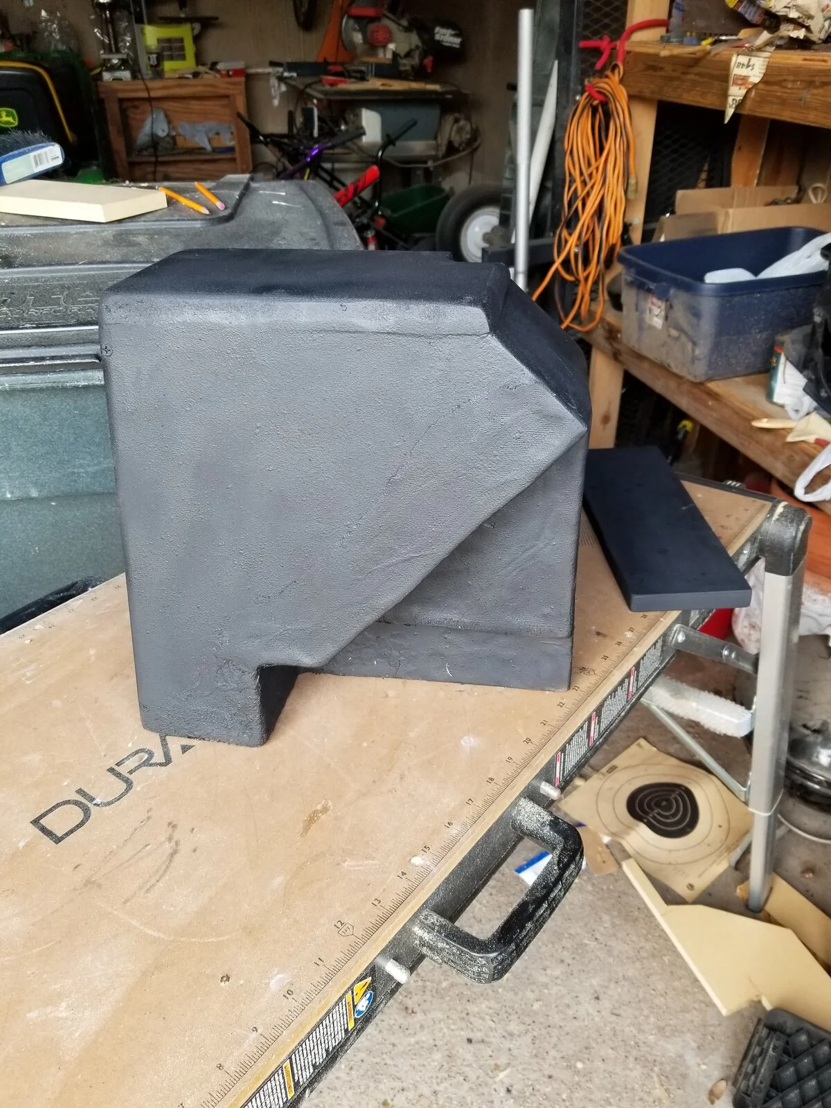

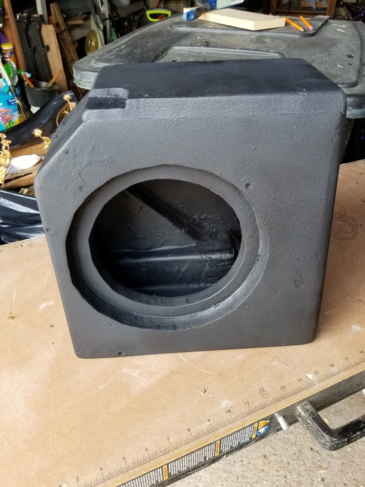

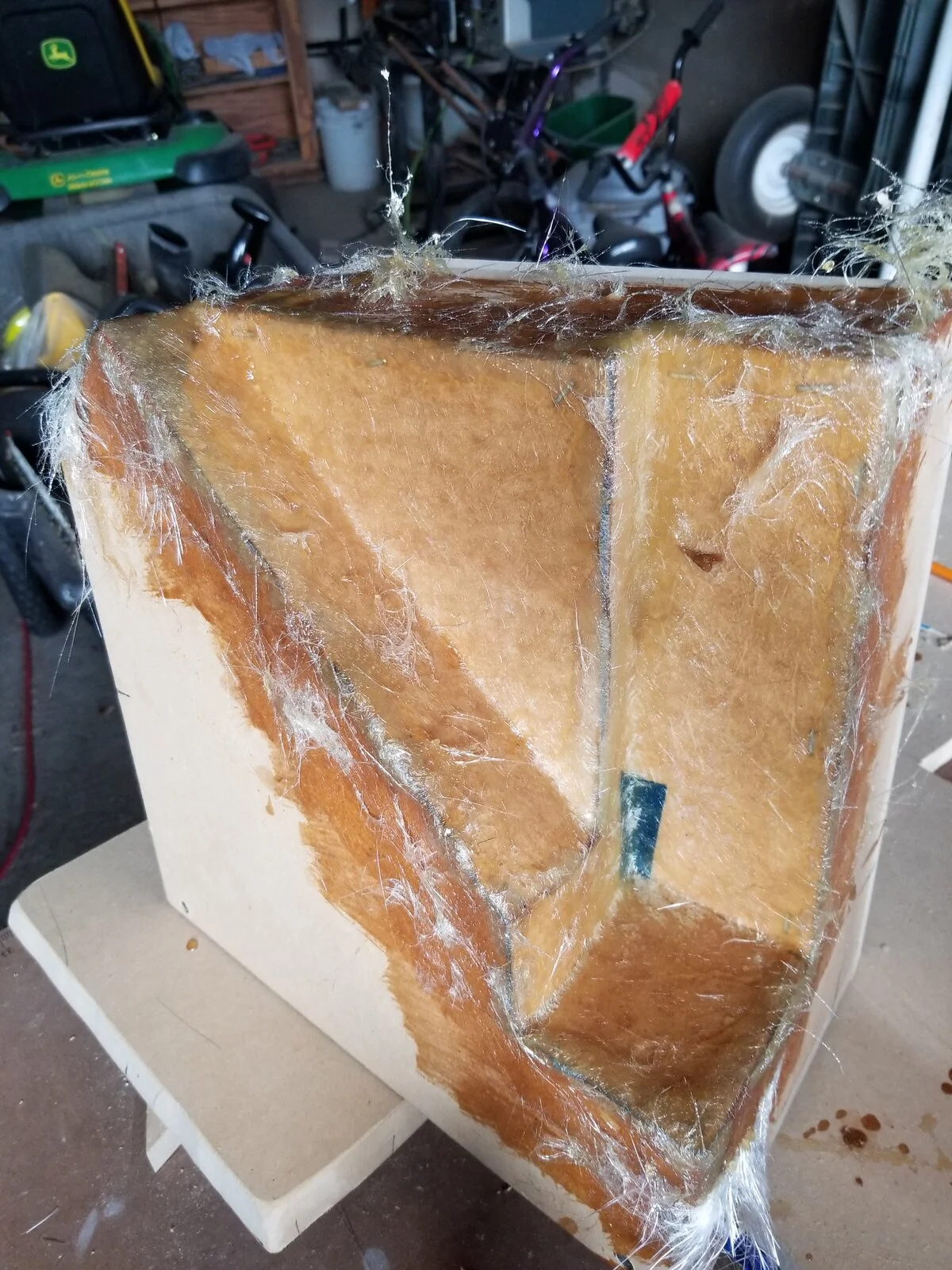

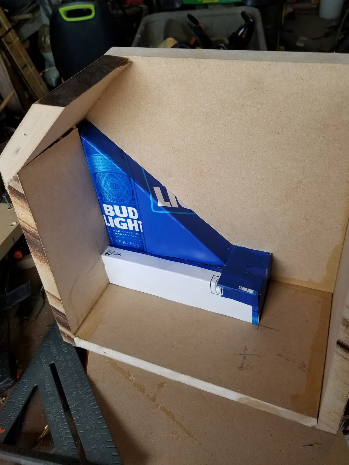

After you see how to measure and design the box stop watching. He uses the wrong type of wood and has huge gaps. Plus a few other mistakes. Use MDF. The pics are of the one I made for mine. I used fiberglass for the e-brake cutout(didn't have to but helped give a little more airspace). Fosgate P3SD2-8 requires very little but I was right at the minimum. I dont have the dimensions of mine but if you use the video to design the box you can tweak little things to make yours fit. I used a clarion 5 channel amp the fit under the dash.

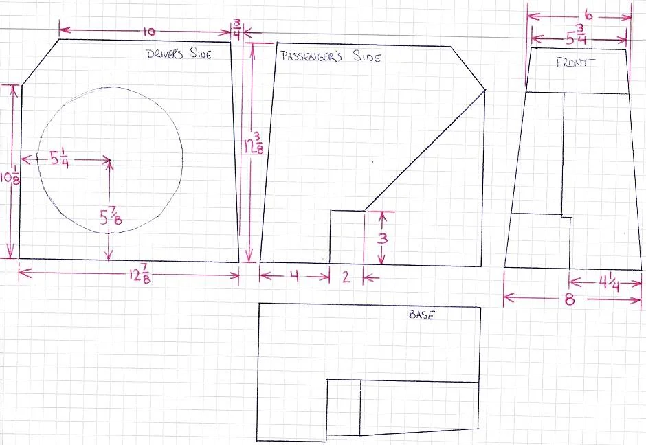

I dont have a thread but here is a sketch I went off of, as I remember I had to modify it a little. As shown in the pics I used fiberglass on the area cut out for the e-brake. The measurement for the speaker cutout centers it behind the console grill. Also I cut the whole big enough so the speaker would sit flush and put a ring on the inside to hold it.
I used a clarion xc2510 to run the whole system. I picked that one because it was small enough to fit under the dash and its a marine amp so it can take a little moisture in case I leave the top off and get caught in the rain.
