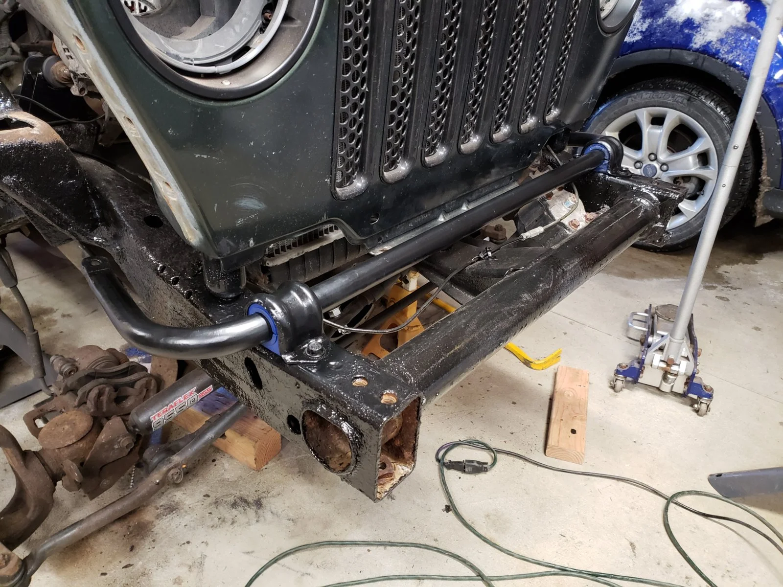

My Jeep was named Death Trap by some of my co-workers who rode in it before I started repairing all the rust and worn out parts. Despite how it looks on the surface, there have been plenty of surprises along the way. In hindsight I probably overpaid for her, but there's something about this Jeep that makes me keep working on it.
Before I put these pics up, I will say the frame still concerns me even though it's been "repaired"and once I have the $$ I will buy a new one.

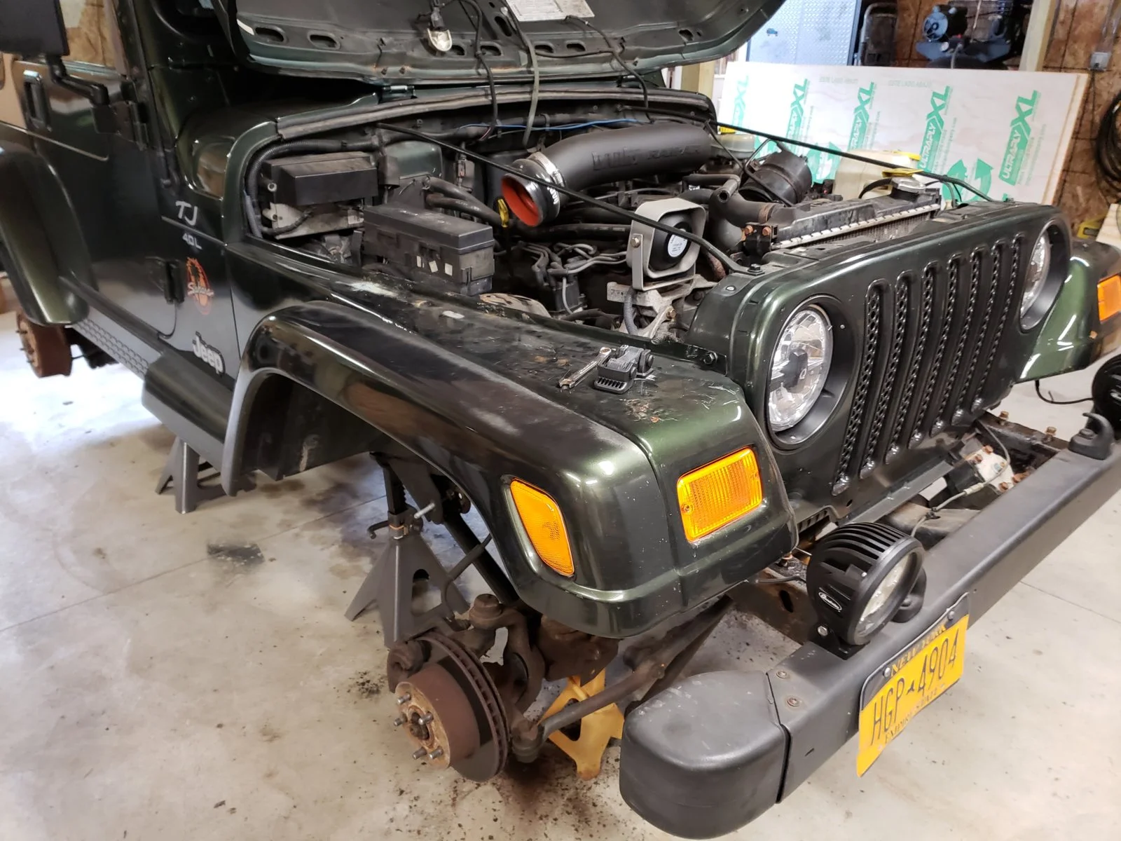

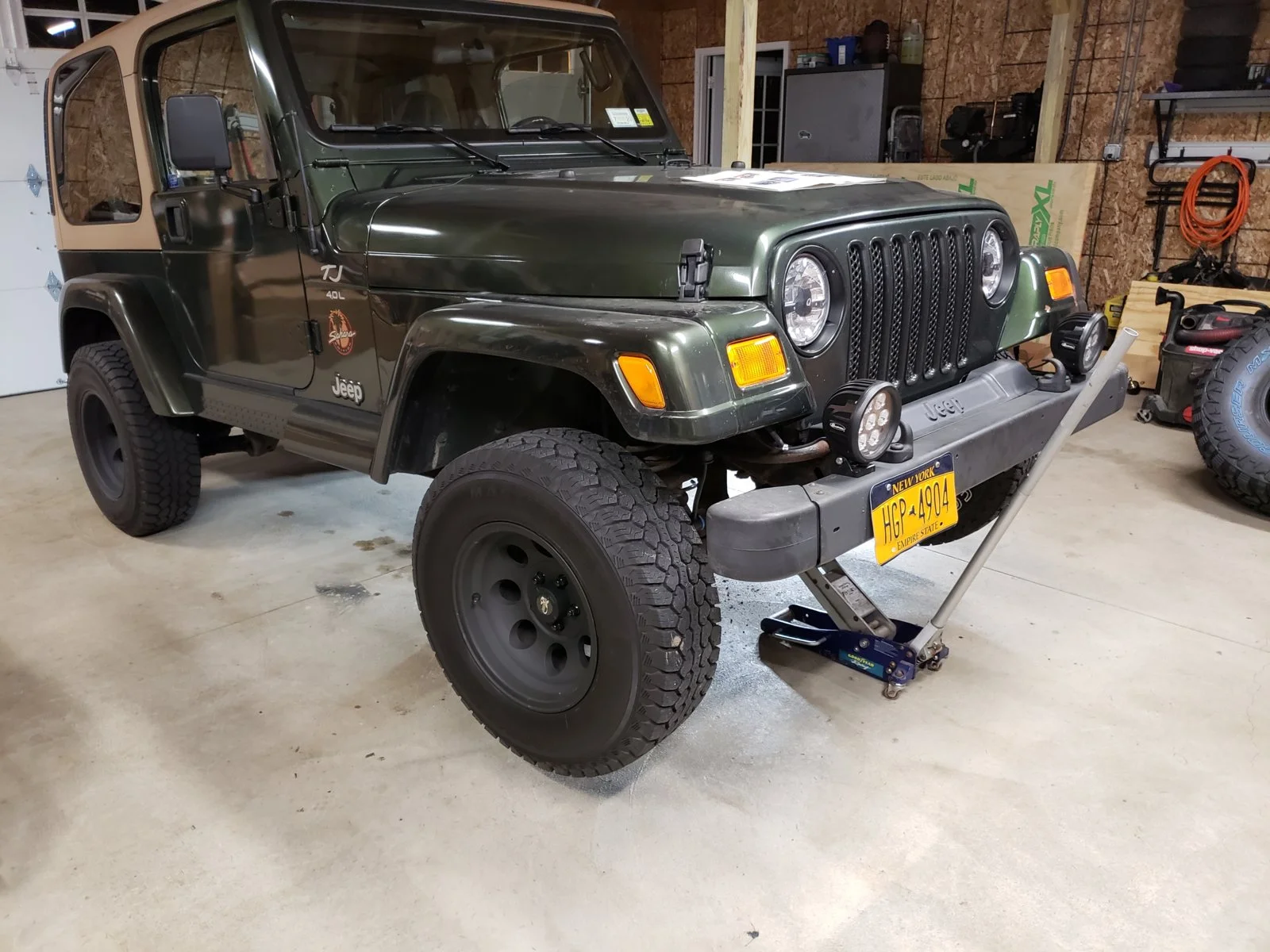

Just before I took it off the road to fix all the problems I was having.
New wheels, LED Headlights and LED Fog Lamps

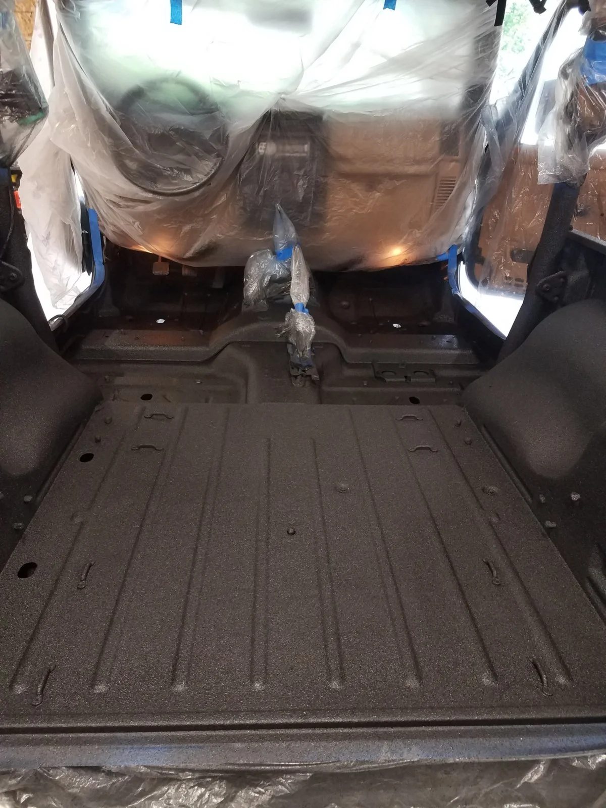

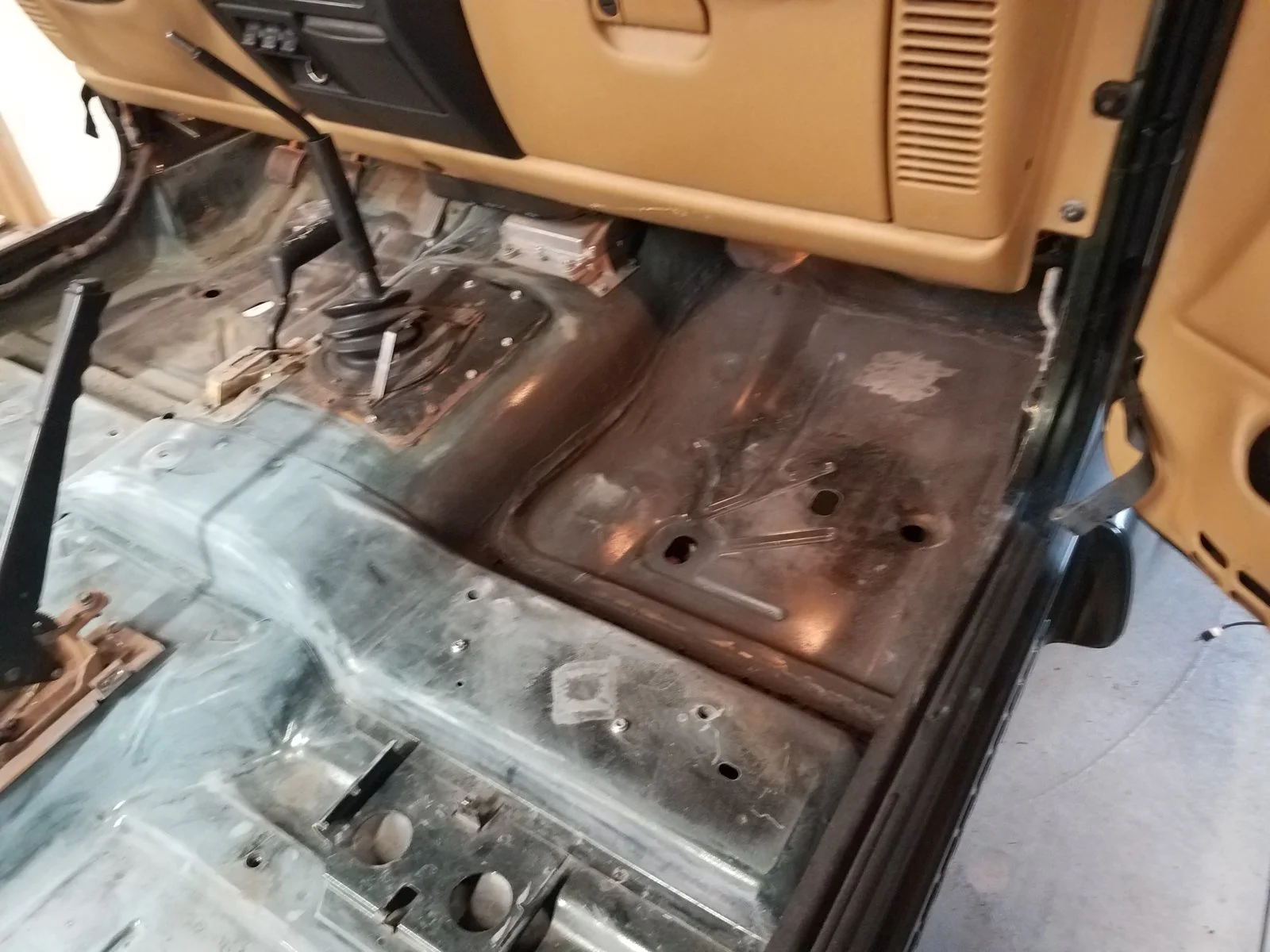

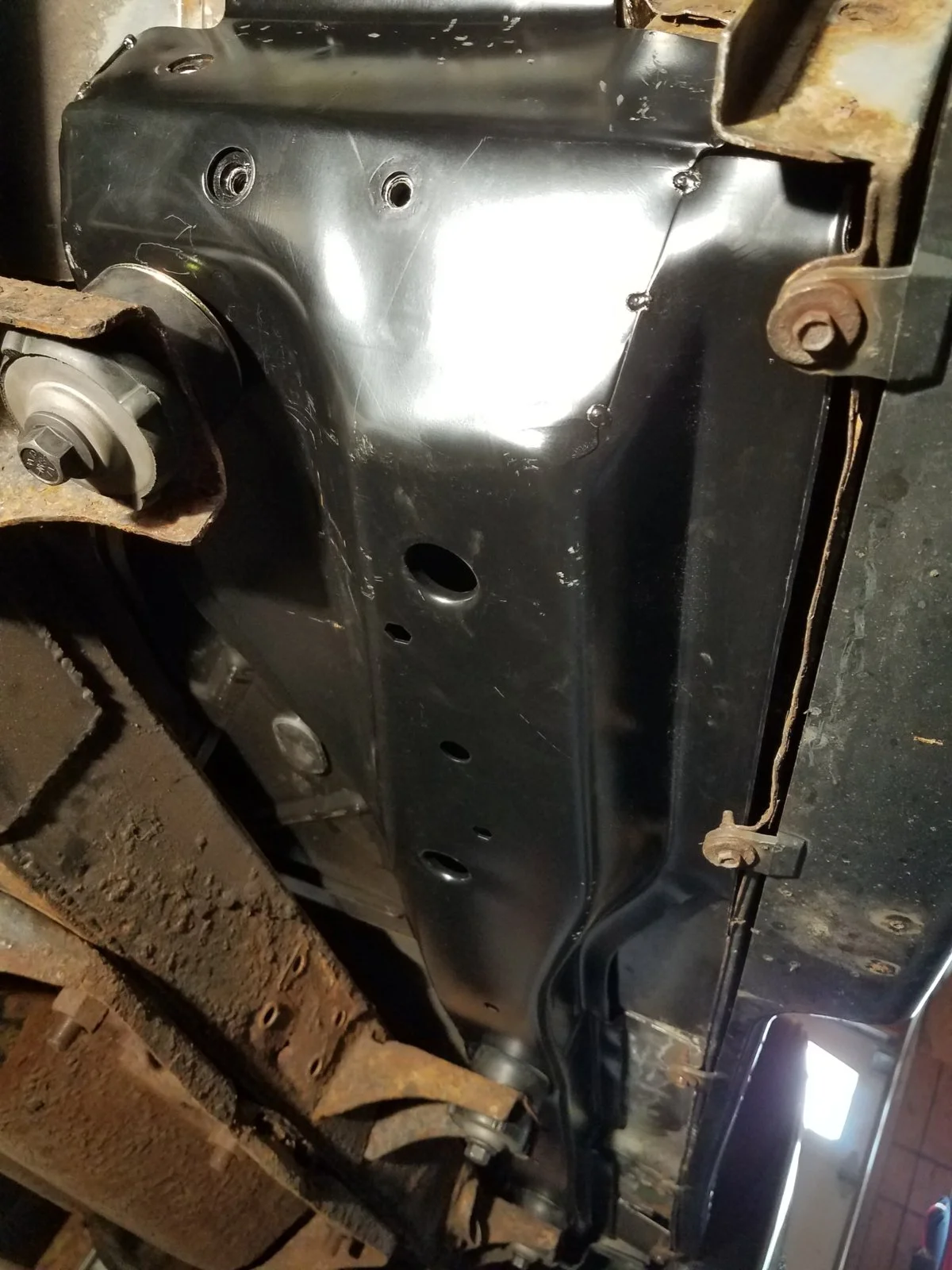

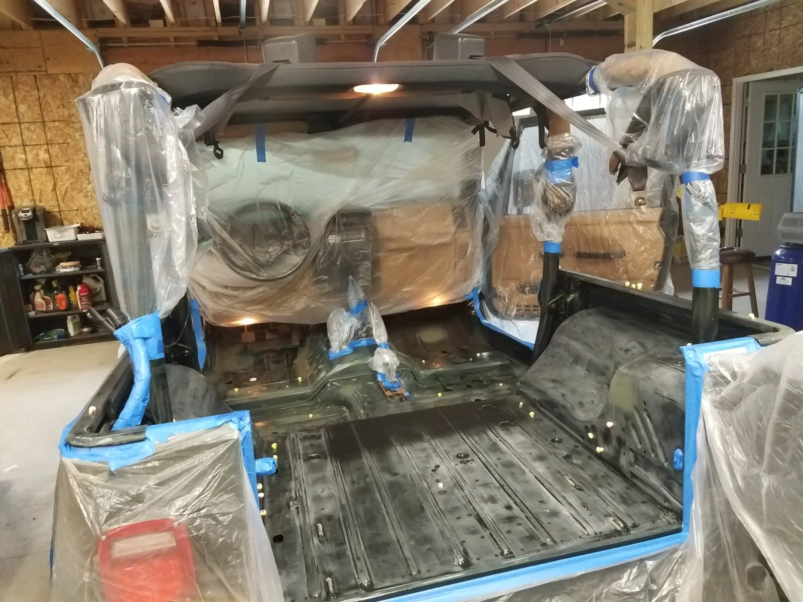

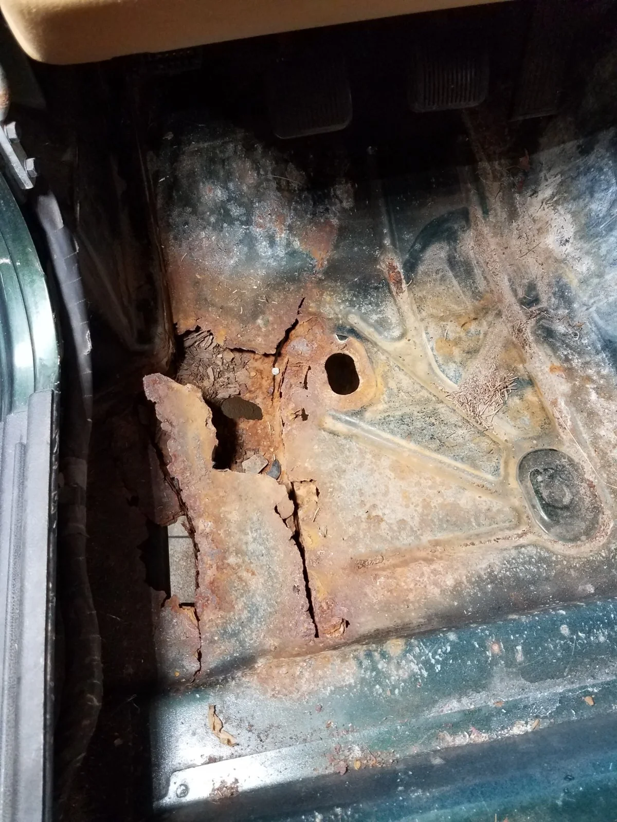

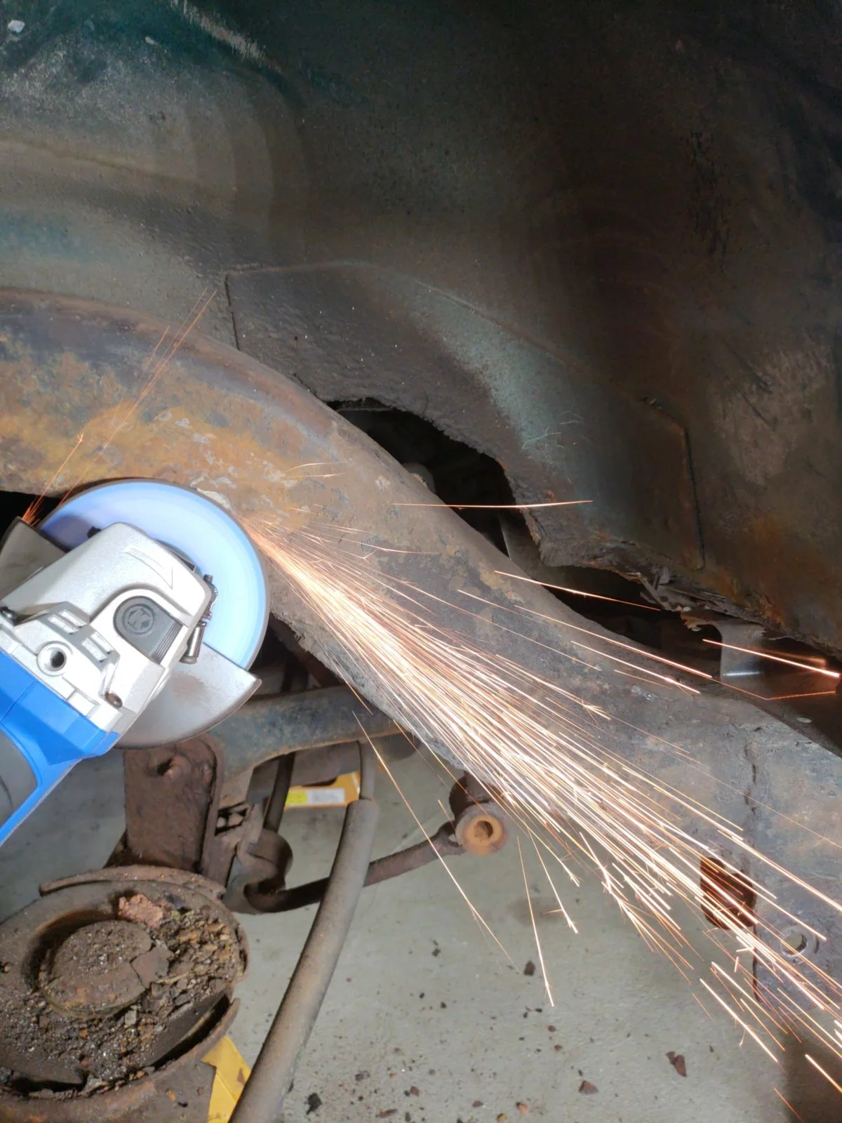

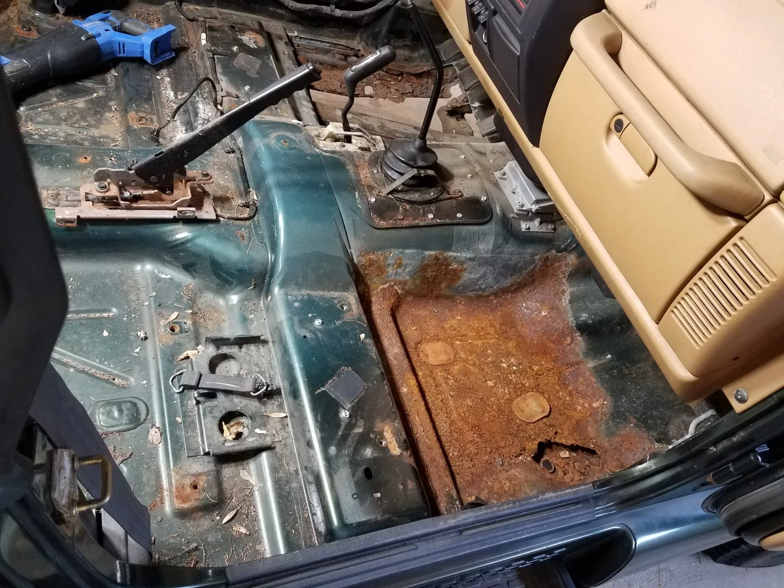

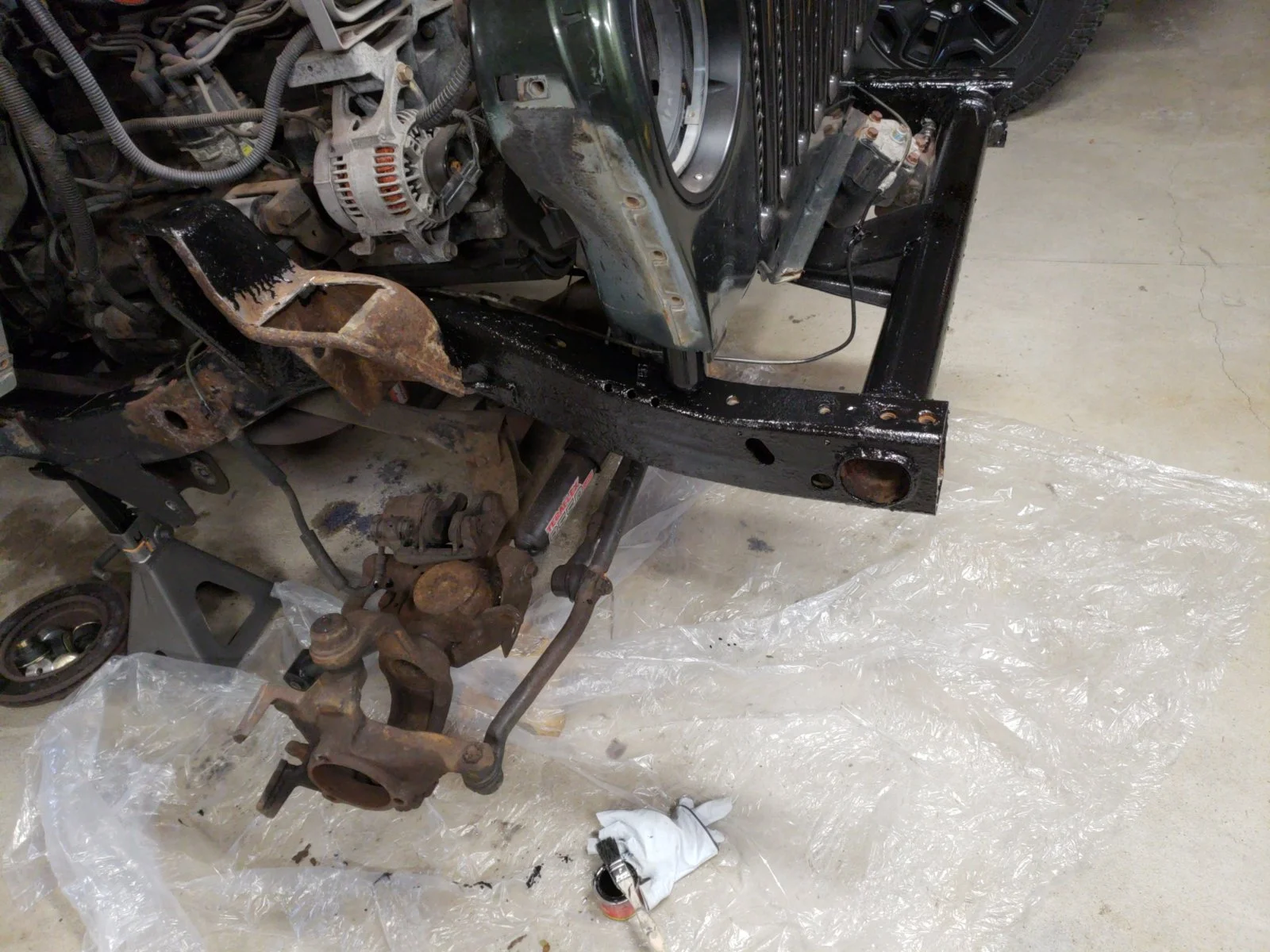

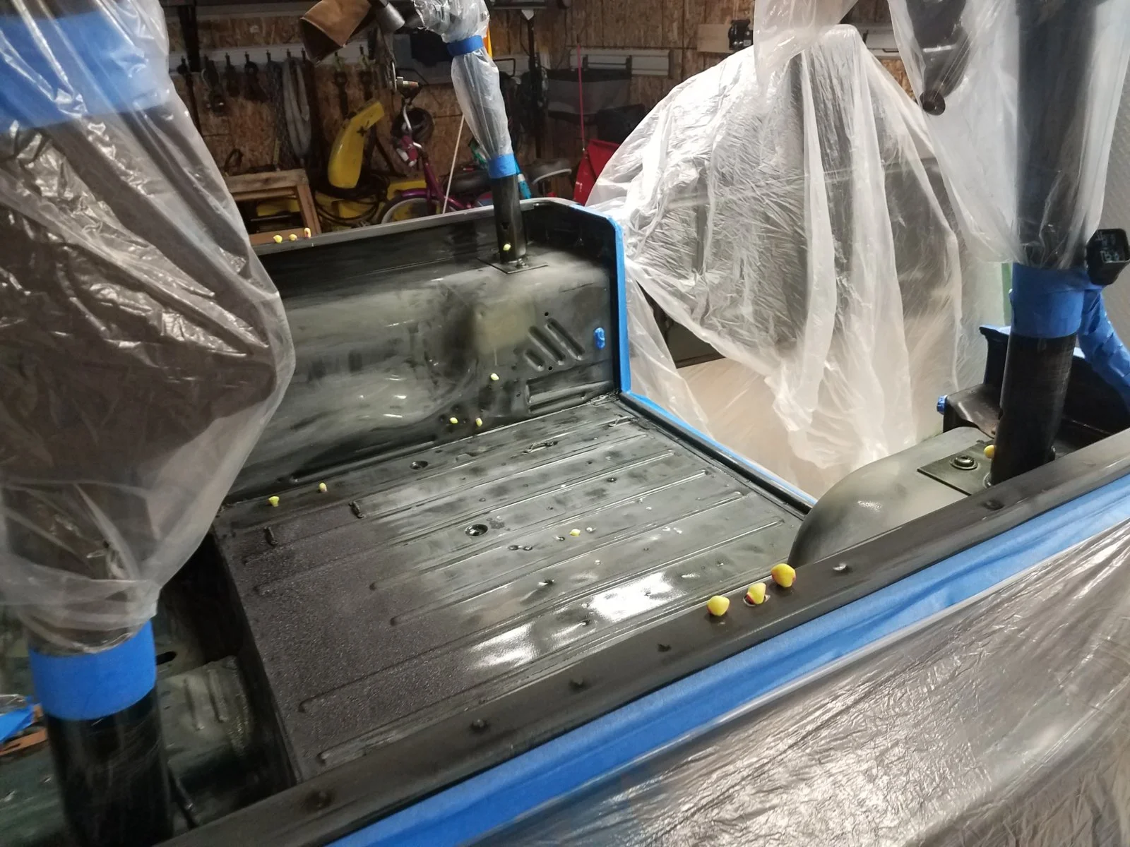

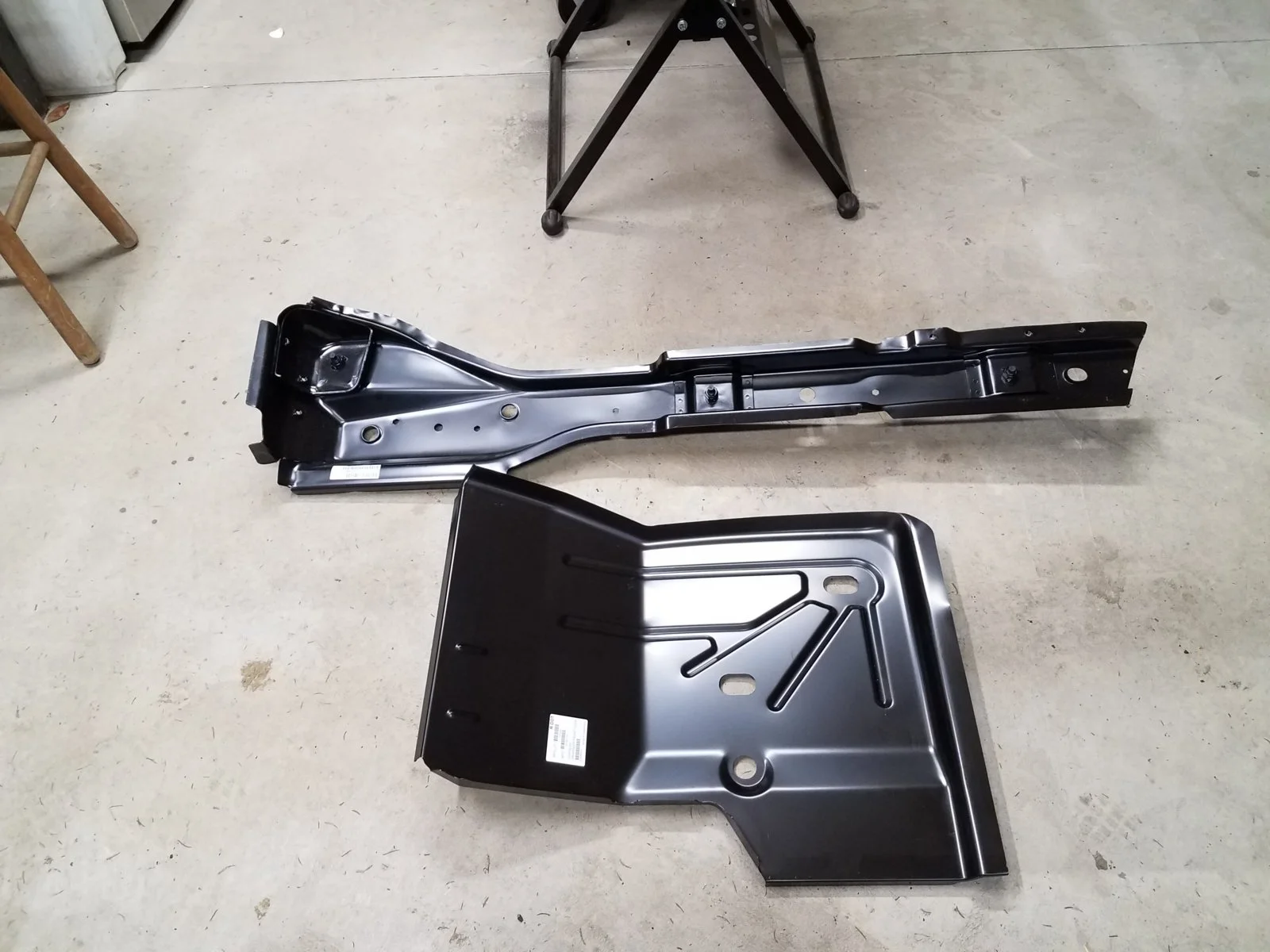

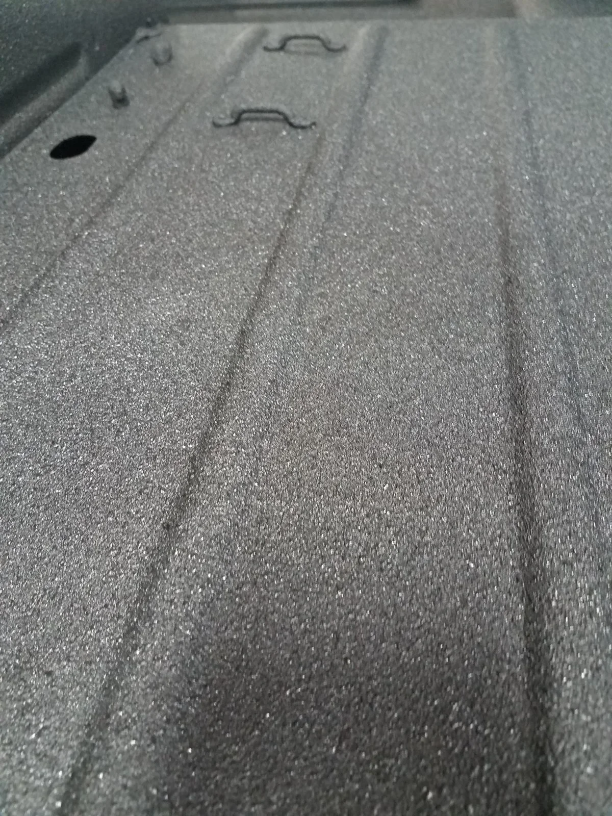

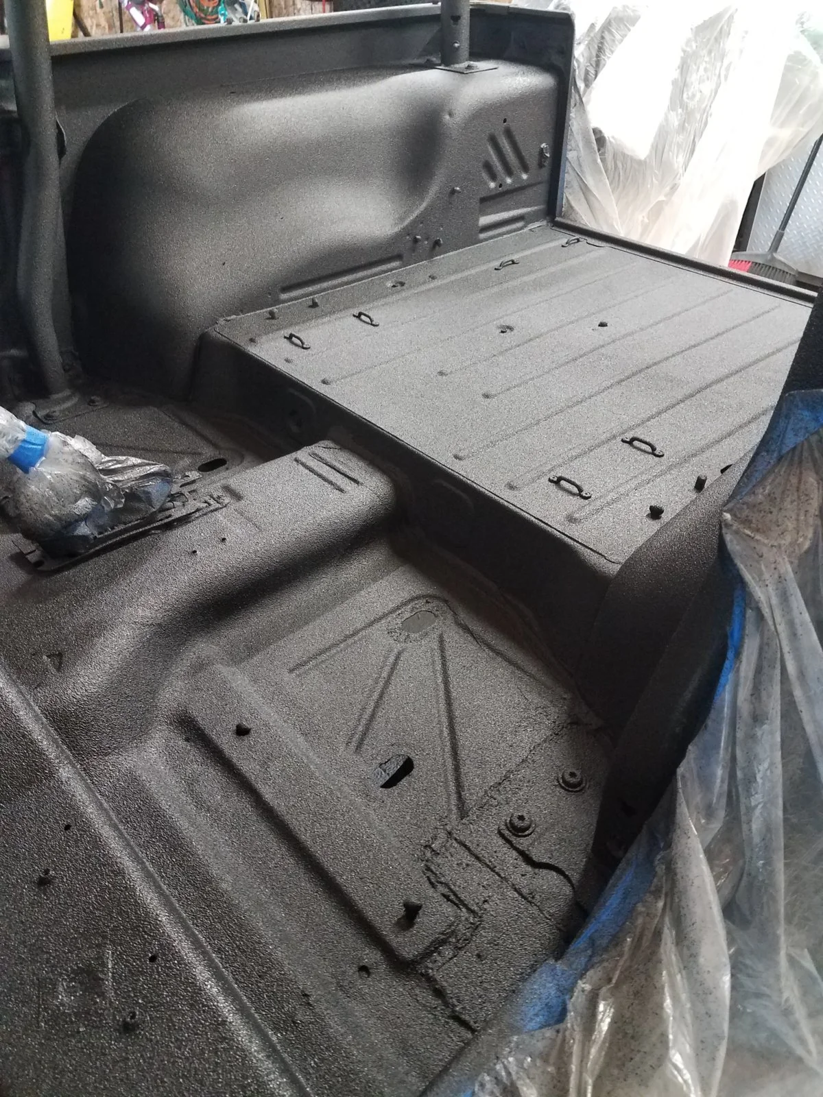

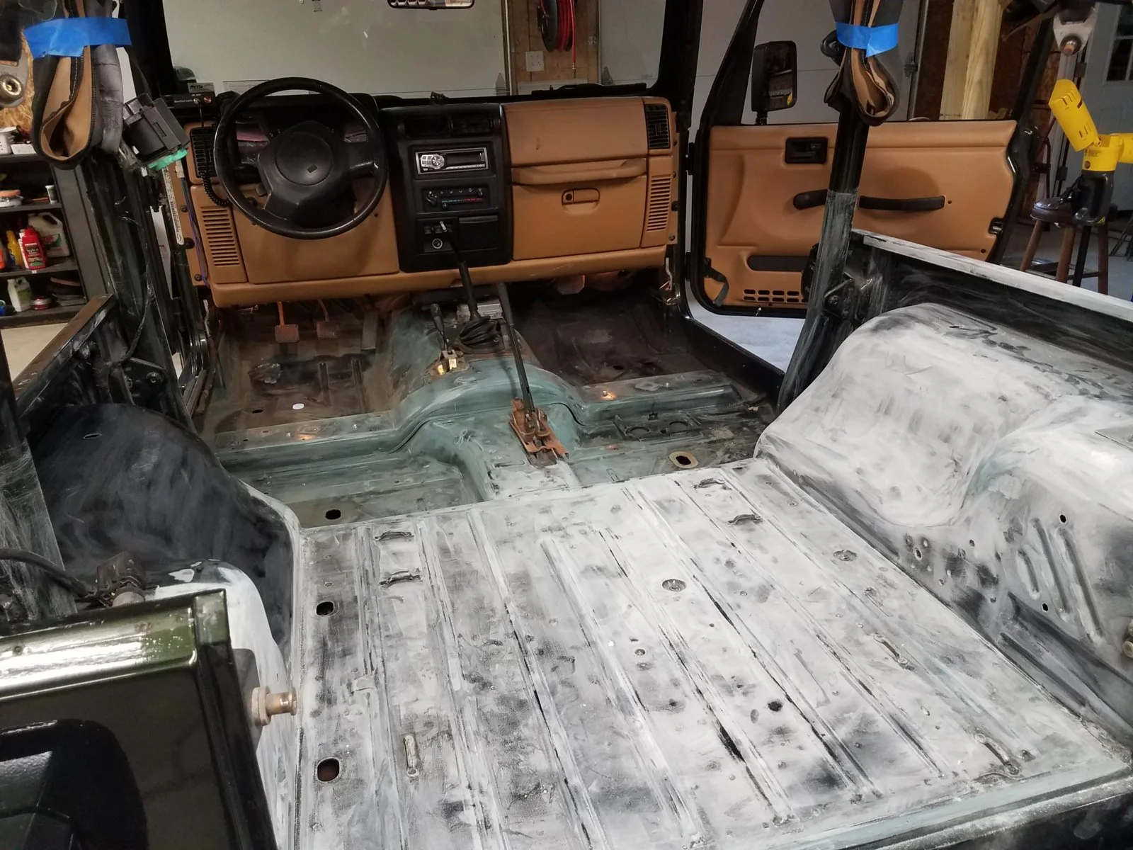

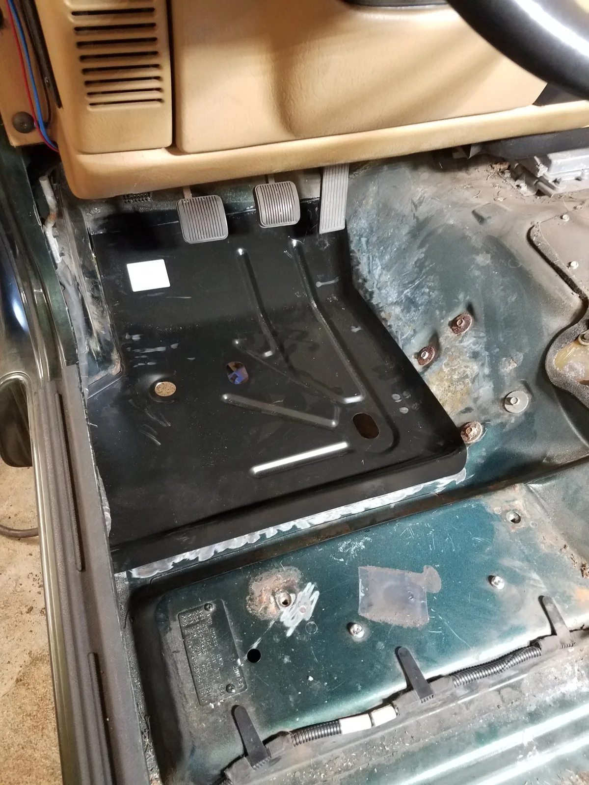

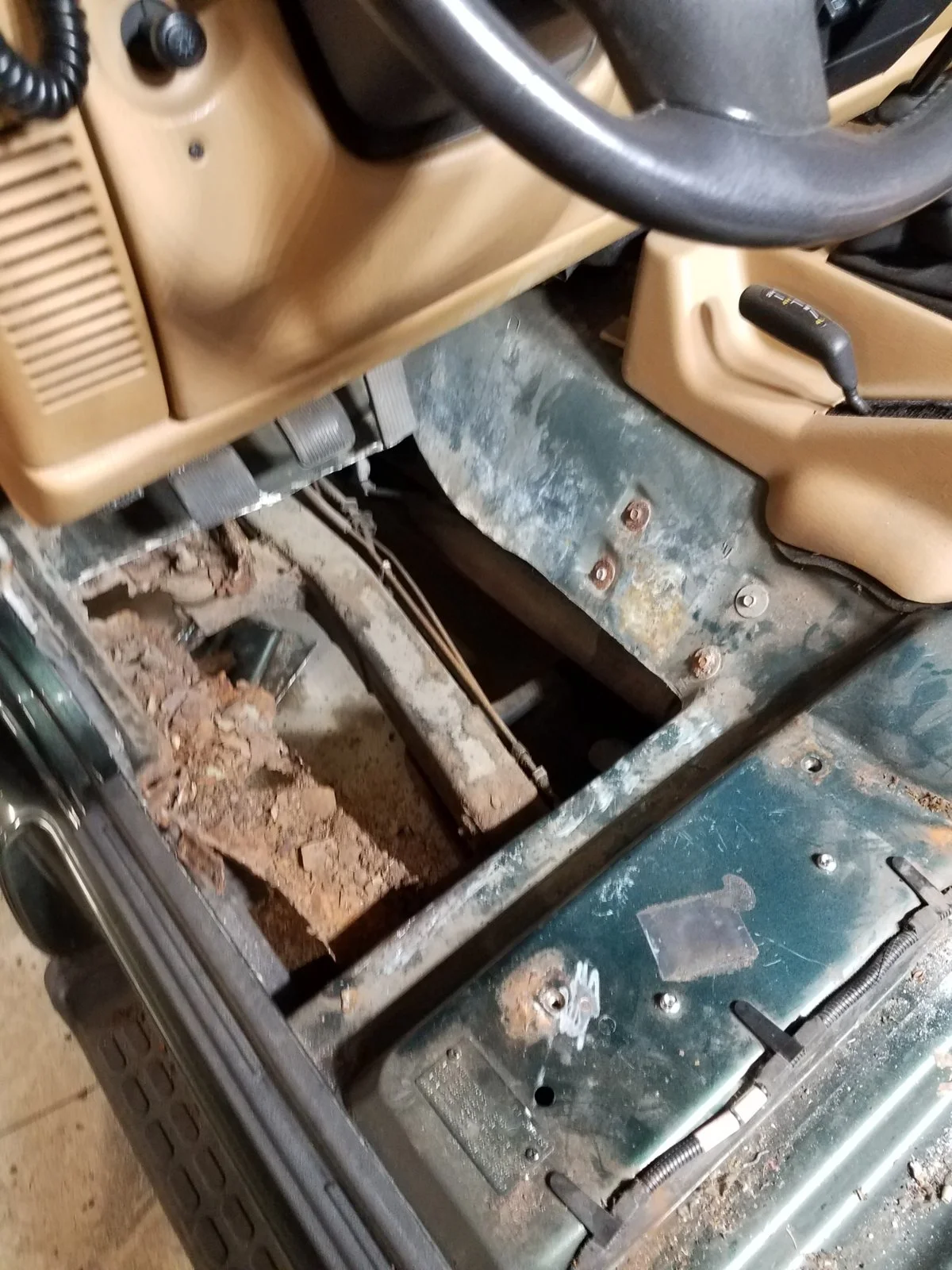

Repairing rusted out floor boards, body mount channels and Raptor lining the tub
Prepping for Raptor Liner

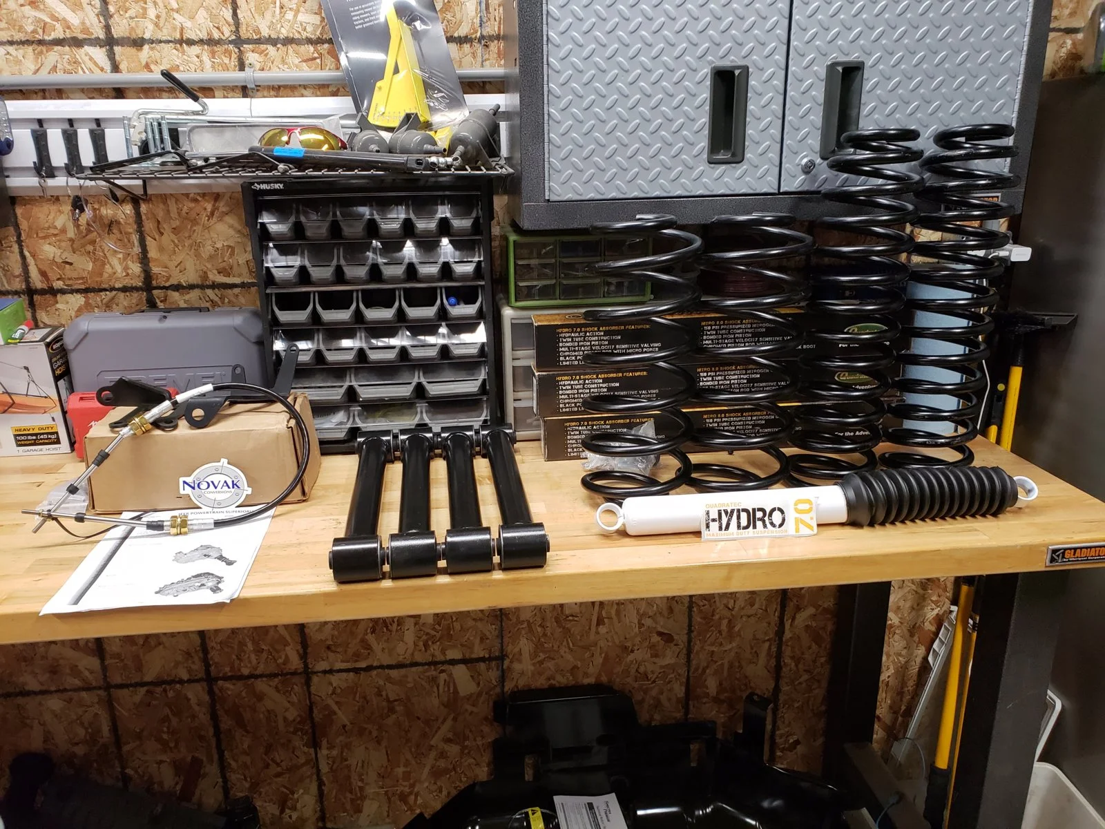

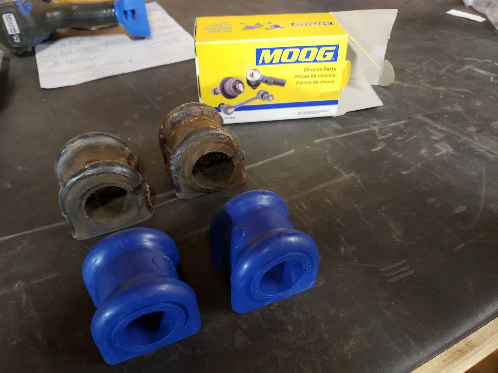

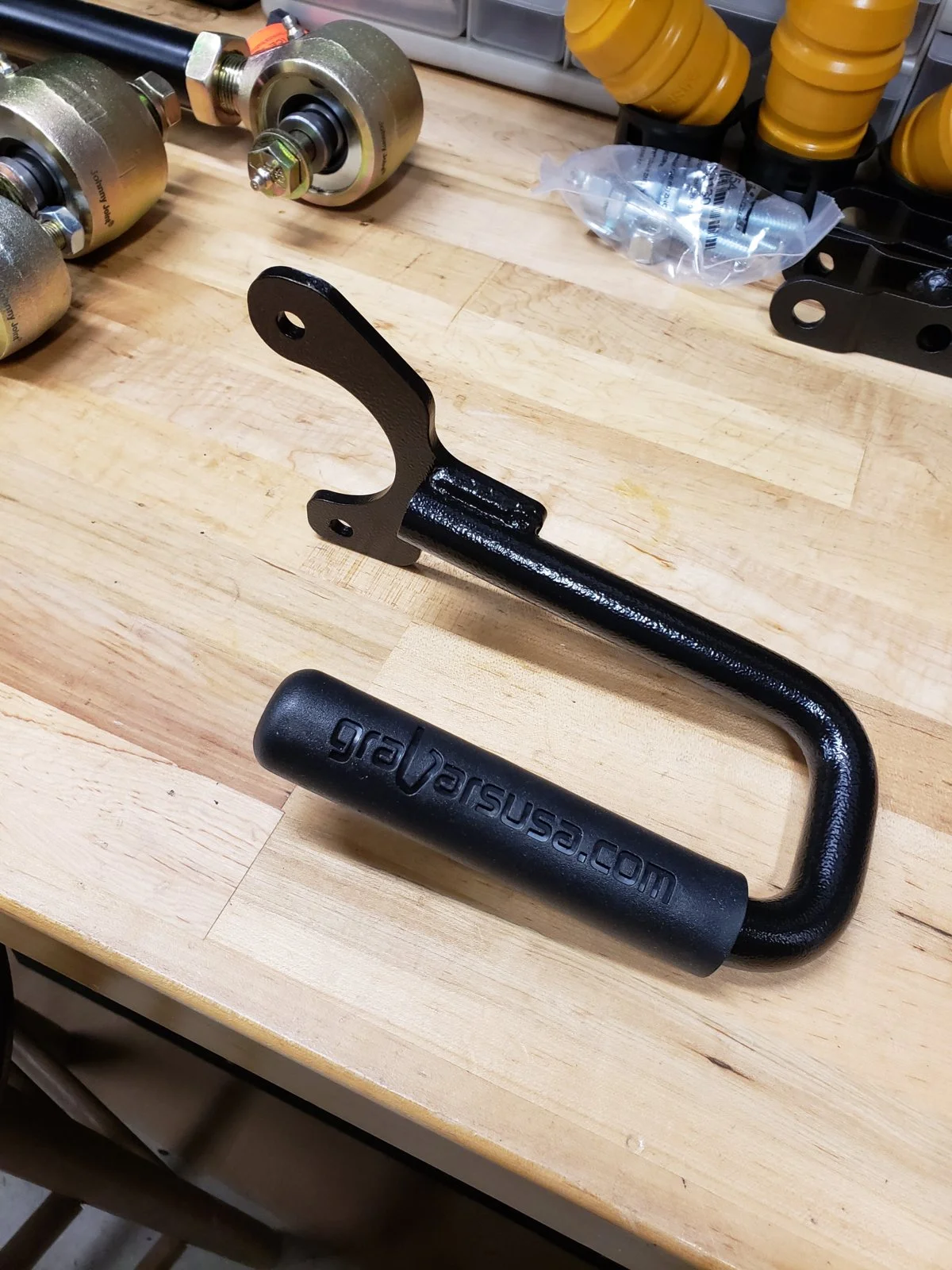

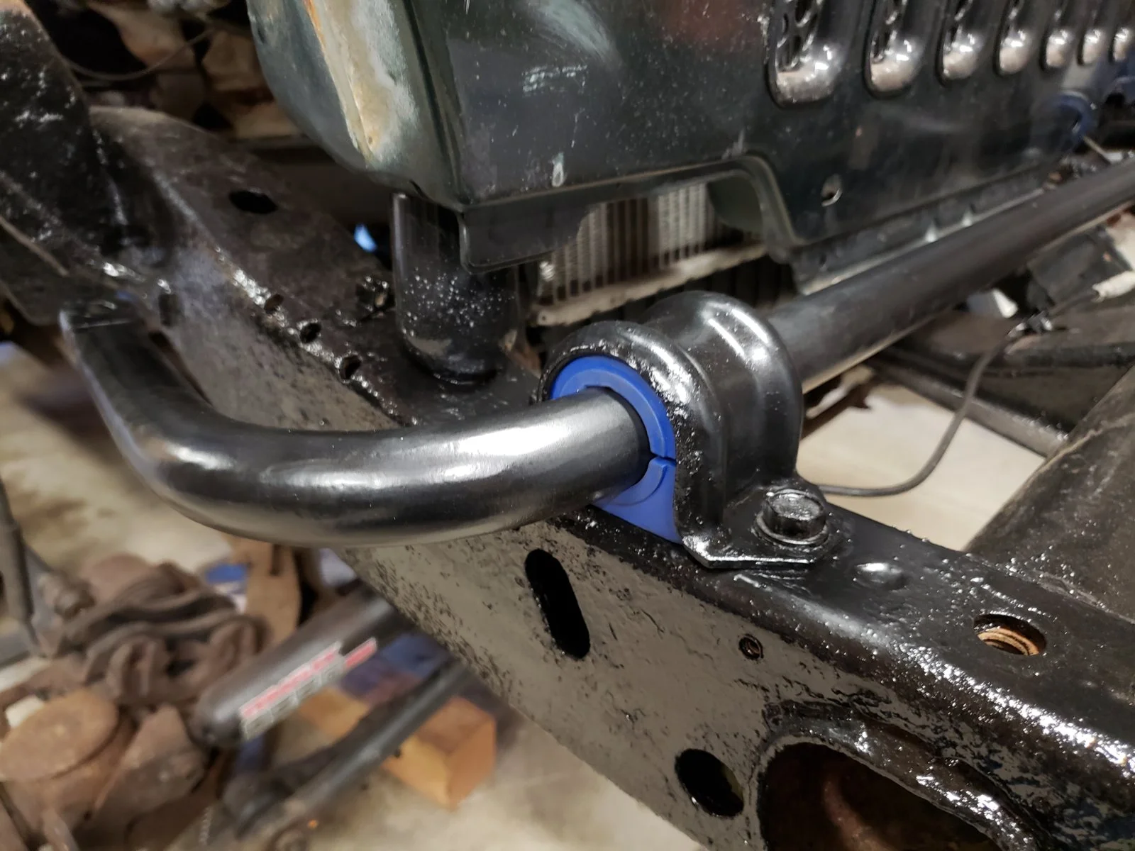

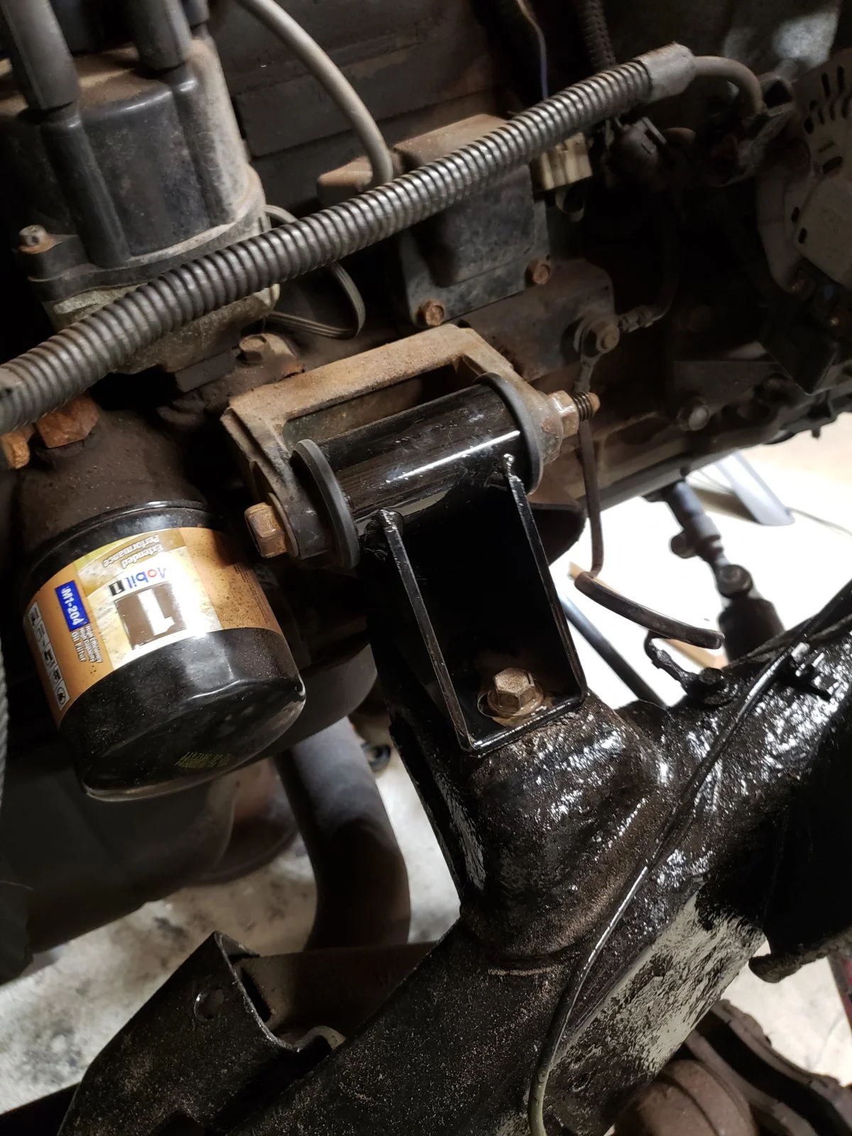

Some of the new parts. (I'm missing a lot of pictures so I'll just list parts off and add the pics when I install them)

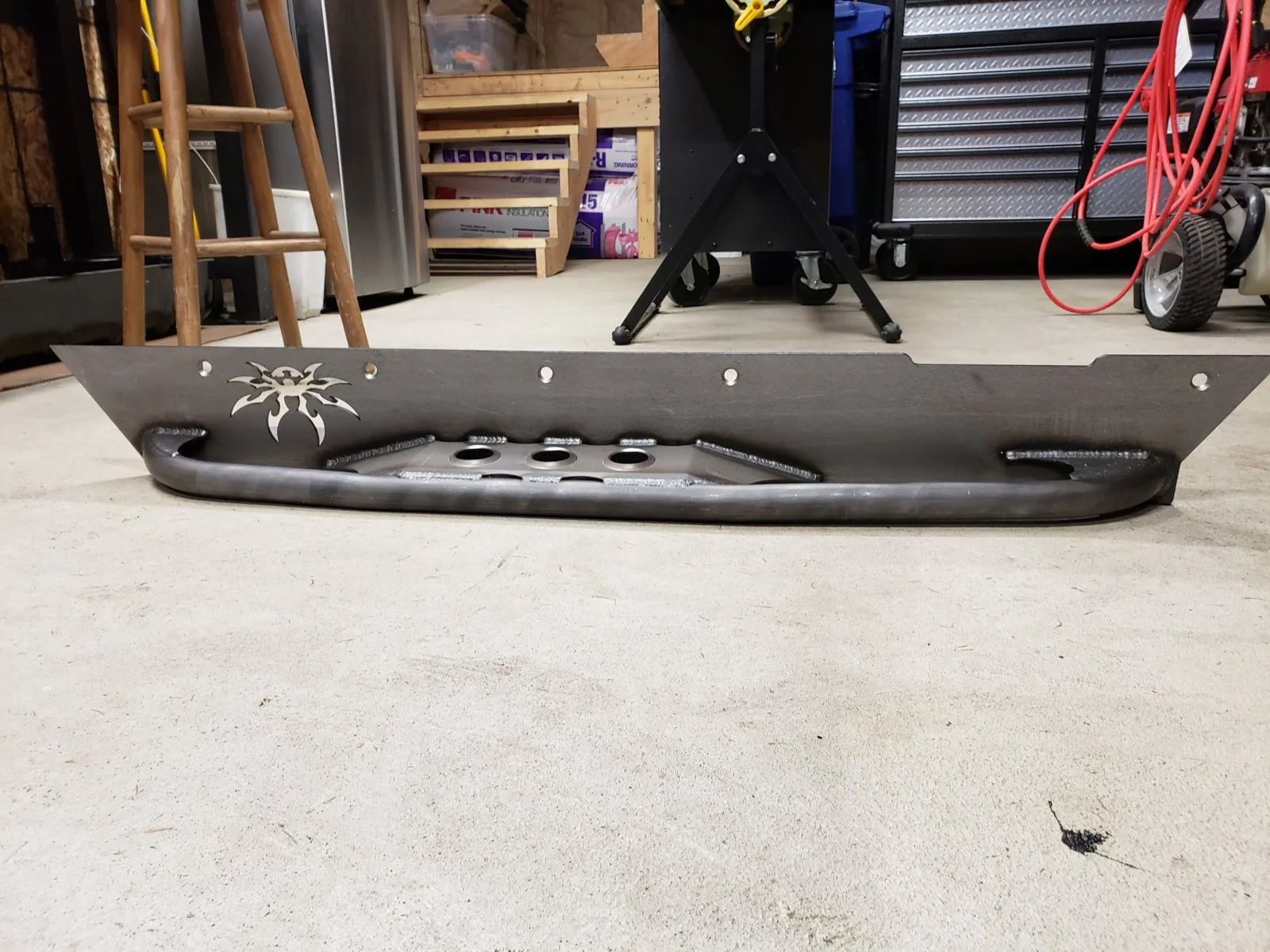

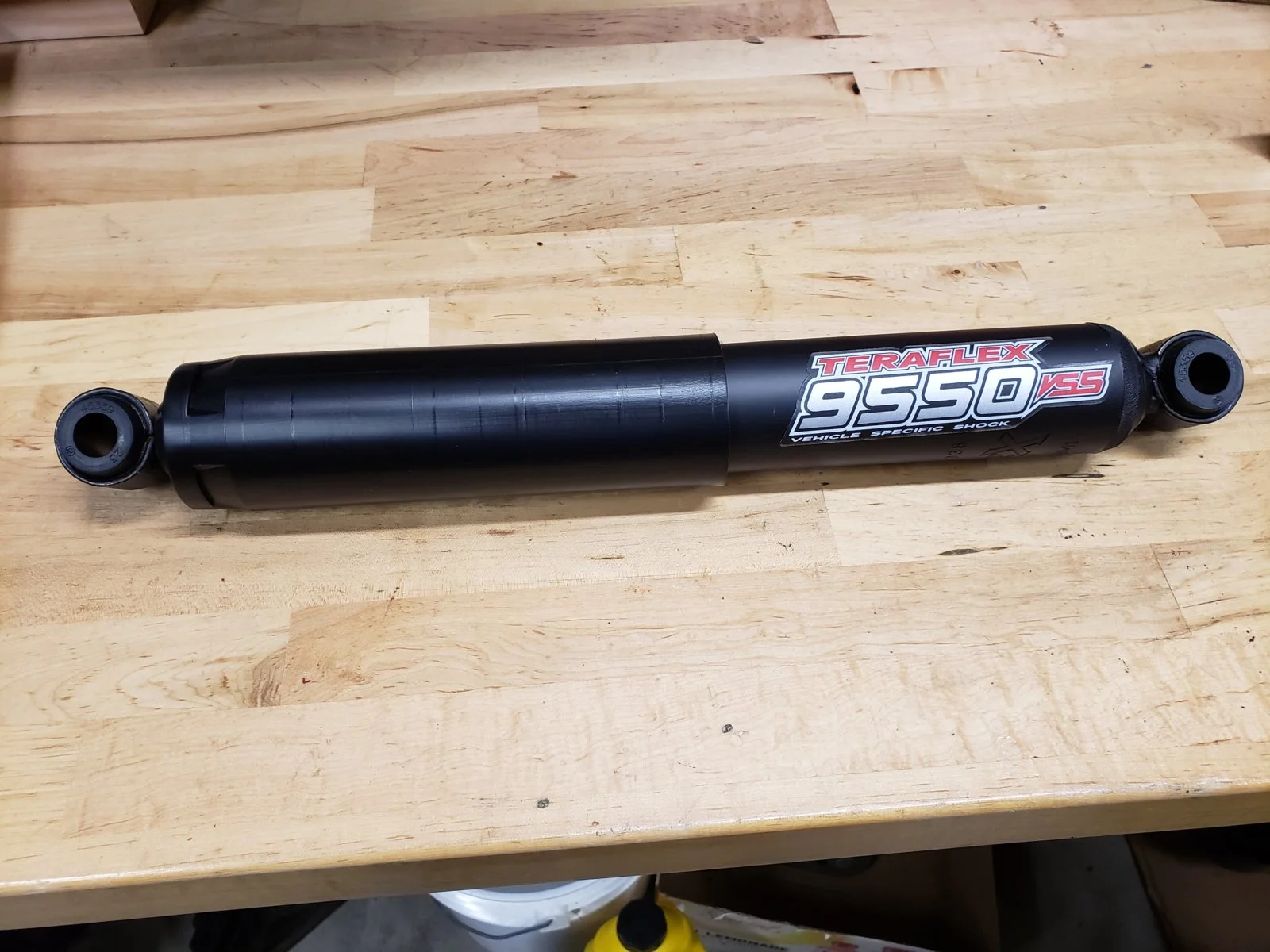

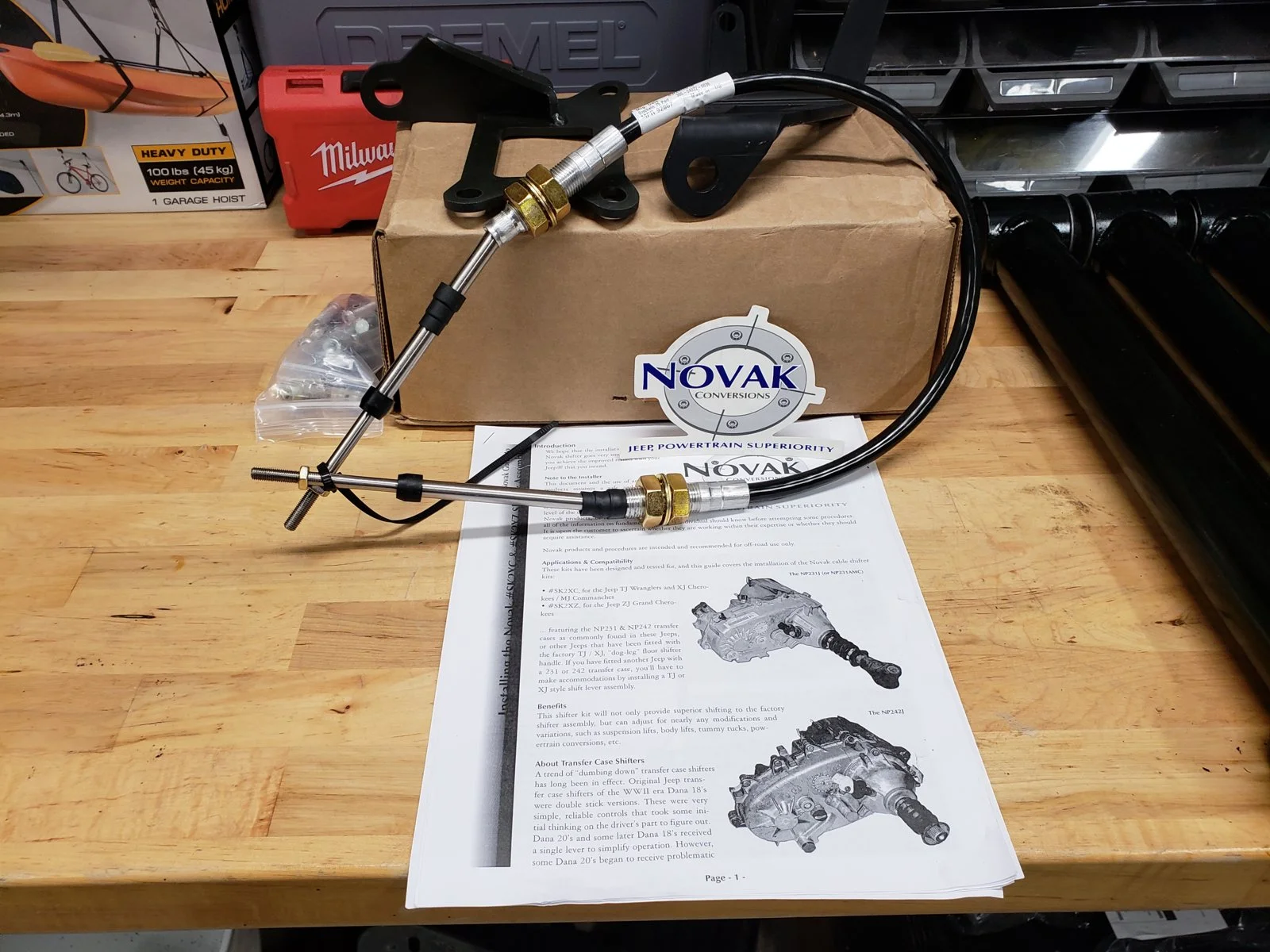

4" lift, Novak cable shifter, Currie adjustable upper and lower control arms (not pictured), Tom Woods rear drive shaft, Advanced Adaptors SYE, JKS adjustable front track bar, M.O.R.E 1" body lift with steering bracket. M.O.R.E 1" Bombproof motor mounts, Teraflex 9550 vss steering stabilizer, Safe-T-Cap upper spring buckets, Poison Spyder Ricochet Rockers, and more to come.......

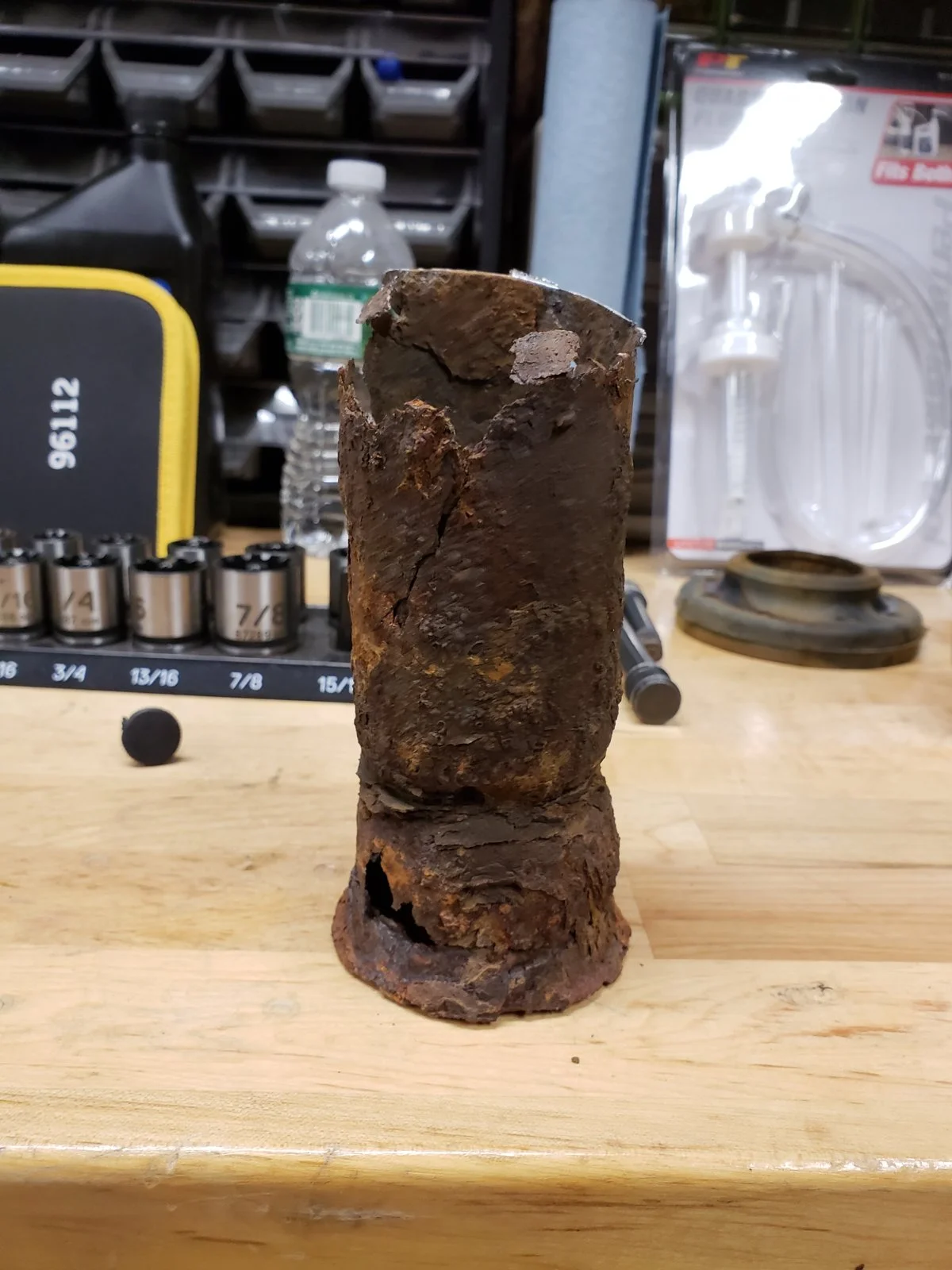

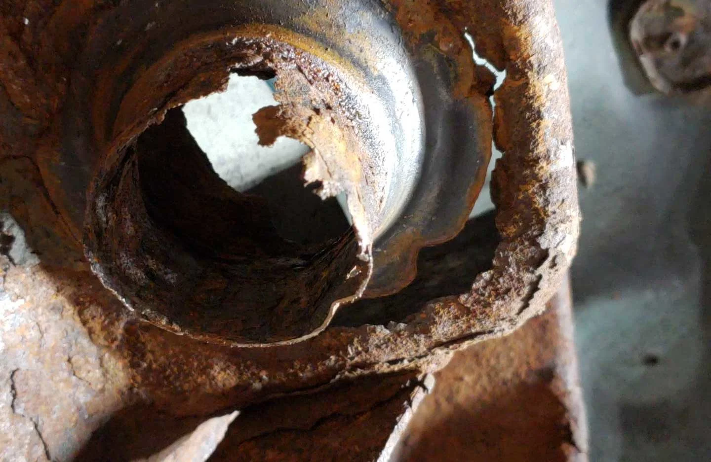

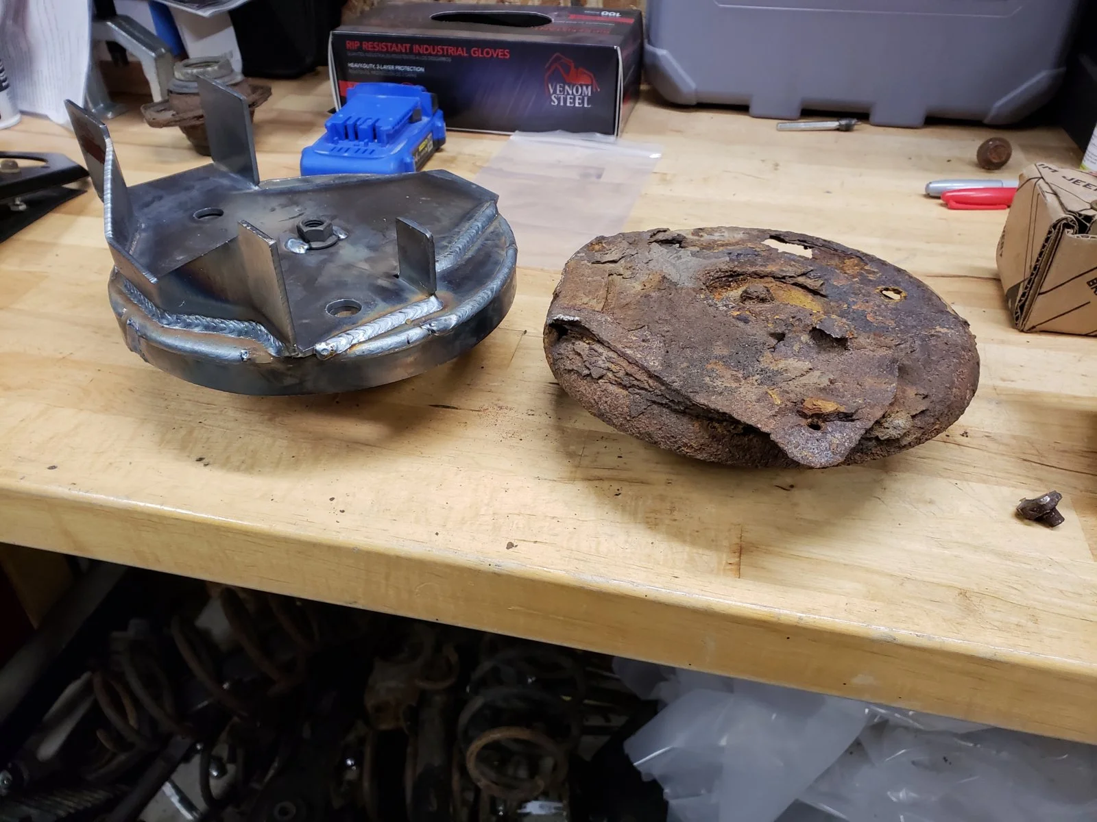

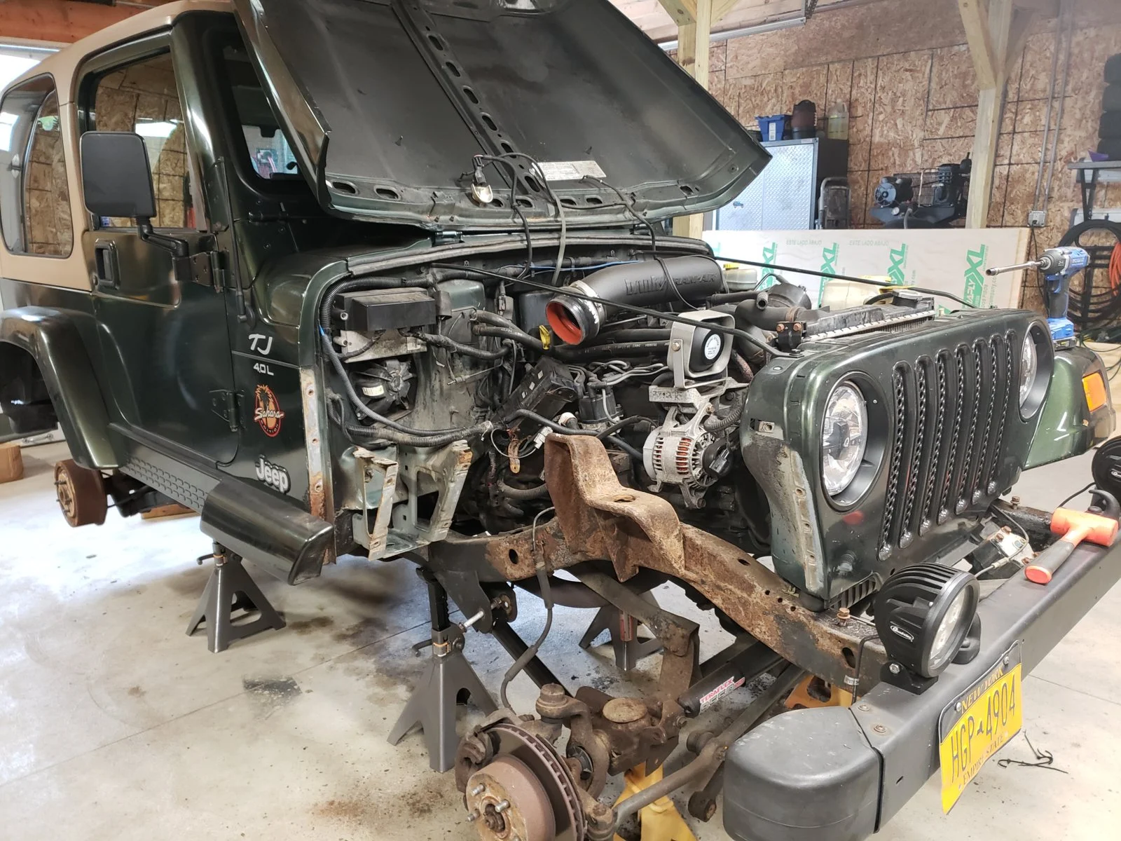

My biggest PITA right now......... All the RUST!!!!!!

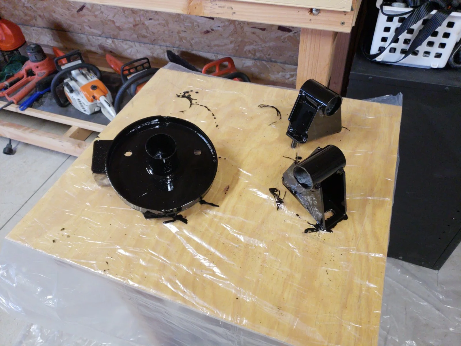

Yes those are my front upper spring mounts, and yes I can put my finger through it. I do have the materials to rebuild these, and after cutting out the rot there's plenty of good material to make the repair.
