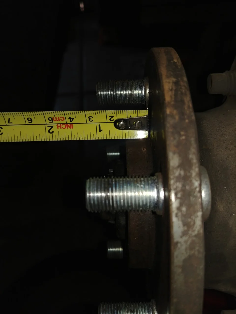

Hey guys,
New on this forum. Have been researching what brake rotors to purchase for my 97 TJ. From the great information I have read on this forum you have to measure the hub and rotors. For 97-99 TJs hub should be 1/2 inch and rotor 3 inches with rotors being composite. Anything after the split 99 year would be 3/4 inch hub and 2 3/4 rotor.
Is this correct? Because when I measure my TJ the hub is just shy of 1/2 inch and the rotor is 2 3/4 inch measuring from inside the hat. I have read that you can't mix them up otherwise you will have problems. I bought this jeep like this and have driven a couple thousands miles with no issues.
Can anyone confirm if I have it mixed up? Thanks so much!

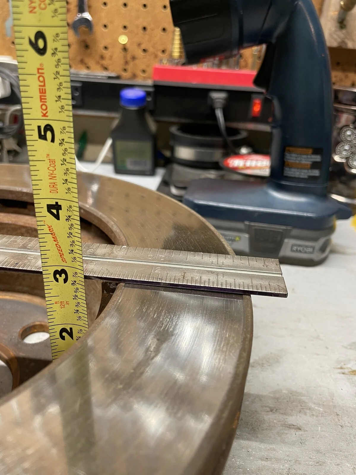

You don't want a composite rotor. They make full cast for all the TJ unit bearings. The only accurate measurement is from the inside face of the rotor hat to the top of the rotor with a straight edge laid across it.
You can run the later rotors with the early unit bearings but the outer brake pad winds up almost exactly flush with the end of the cast slider the pads rest on.
If you try to run the early taller rotors on the later unit bearings, the rotor contacts the steering knuckle.

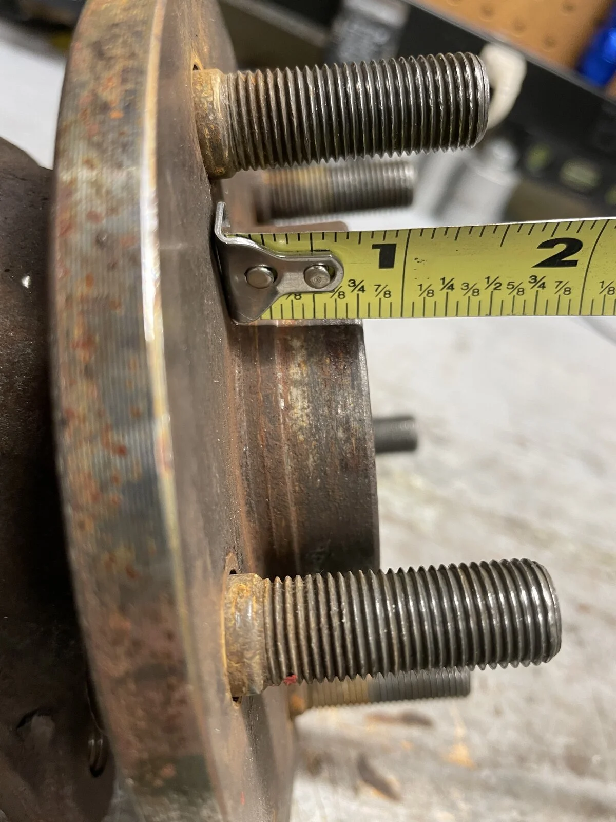

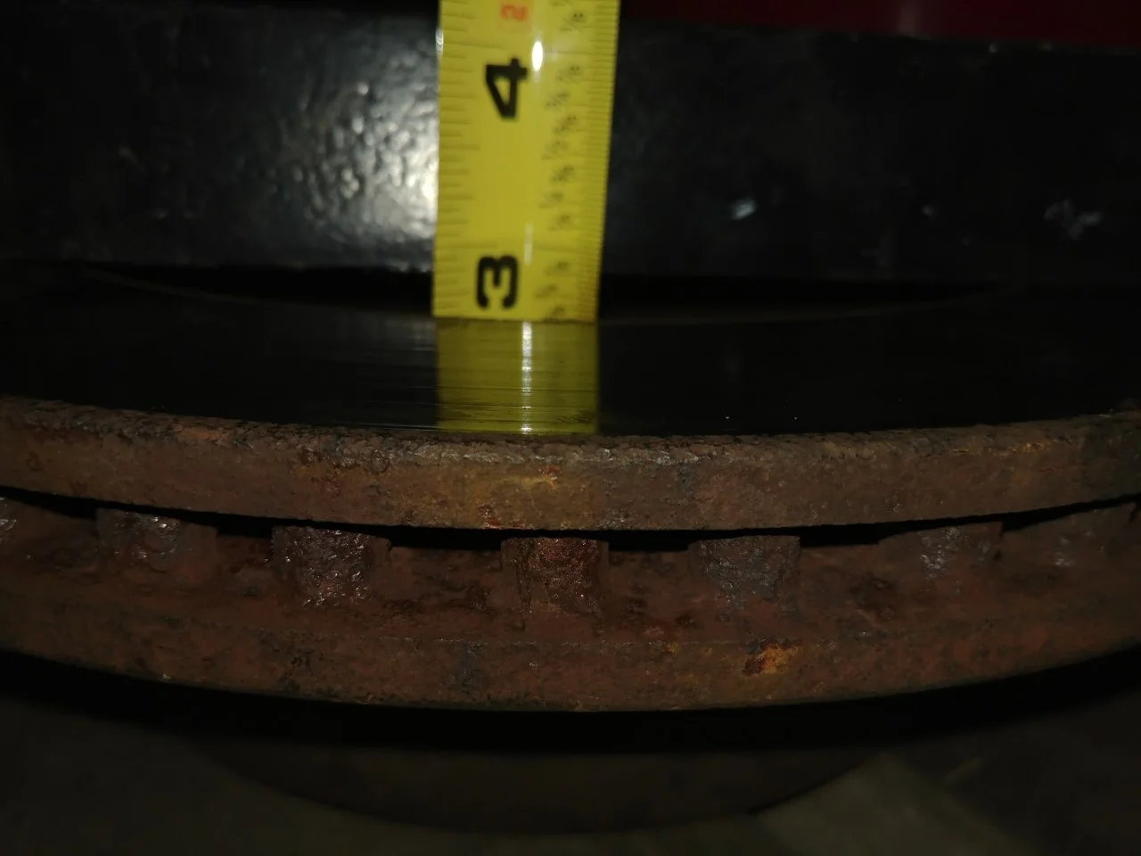

Thanks mrblaine! So full cast rotors but which year brake rotors should I order?...the ones I have now measure 2 3/4 inches from the inside face of the rotor hat to the top of the rotor with a straight edge laid across it. Thanks again really appreciate it!
Post up a pic of the unit bearing face. Pic of the rotors wouldn't hurt either.
Thanks guys. Posting pics of hub, rotor and rotor on hub. Pics aren't great...what I took last week when had the wheel off.
Are these statements accurate?....mid-99 or older TJs hub should be 1/2 inch and rotor 3 inches (inside hat). And mid-99 and newer would be 3/4 inch hub and rotor 2 3/4 inches

Resurrecting this thread.
I have a 97 TJ, and if I’m understanding this correctly with a 2 3/4 rotor I would want the later 1/2” hub bearing?
What I have currently in the pictures will work, but it will put my outer brake pad almost exactly flush with the end of the cast slider the pads rest on?
So this is the correct part number for the 1/2” hub?
Timken 513084 Axle Bearing and Hub Assembly​
