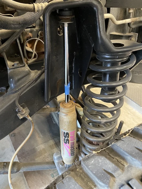

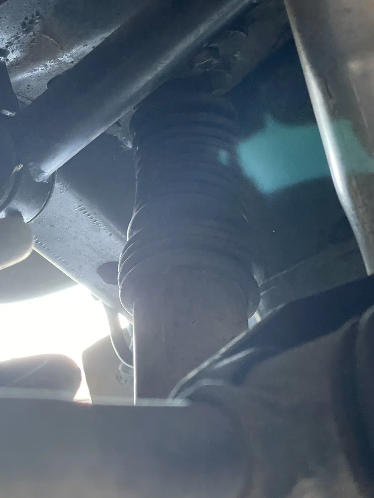

Spent some time meandering around the Jeep today as I was waiting for the little road air compressor I use for my car to struggle airing up the 35in tires from 10psi to 29psi, took about an hour with a 20 minute break in the middle to let it cool down a bit. During that time I removed the shock boots on the front shocks to see how bad of a selection I did last time when I replaced the shocks. I marked the shaft of the shock with blue painters tape to indicate the ride height location. I then jacked up the frame right behind the front lower control arm mount and lifted the tire to where I could spin it. Needless to say that is about 1 to 1.25inches of drop. Scouring the forums I think I'm going to lean towards the rancho rs5000x shocks. Anything really would be an improvement over what I got now. With regards to shock bushings I am aware that poly bushings is not ideal for control arms, is the same true for shock bushings? Jounce bumpers are already in transit for all 4 corners as what is supposed to be installed are all laying in crumbles on top of the axle spring perches which can be seen within this image as well.
With regards to the rear shocks, I did not cut the boot off but I would guess, based on how compressed the boot is that there is at most 3 inches of up travel there. This is at ride height.
This weekend I should have time to be able to tackle the oil replacement and new addition of the differential skid of the front axle. While I am working on that section I'm going to cycle the suspension as best I can to get proper shock length estimates so that I can go ahead and get those ordered.

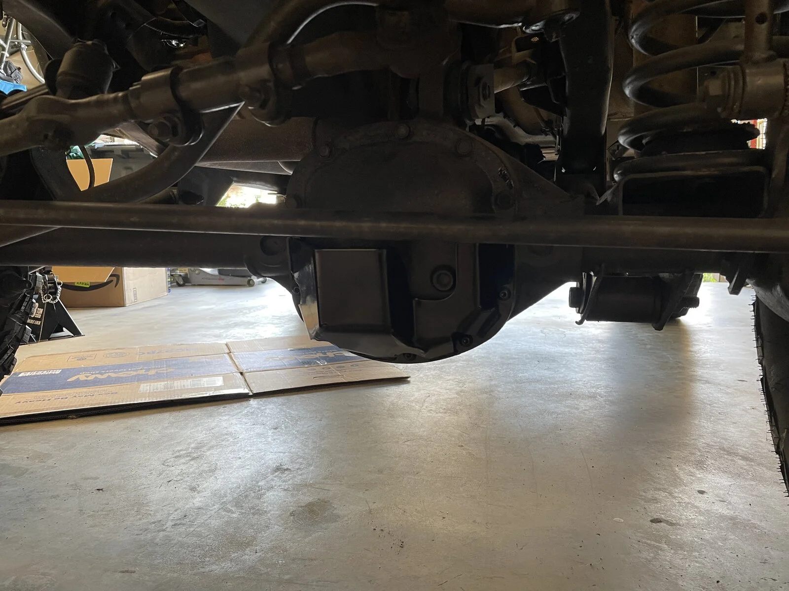

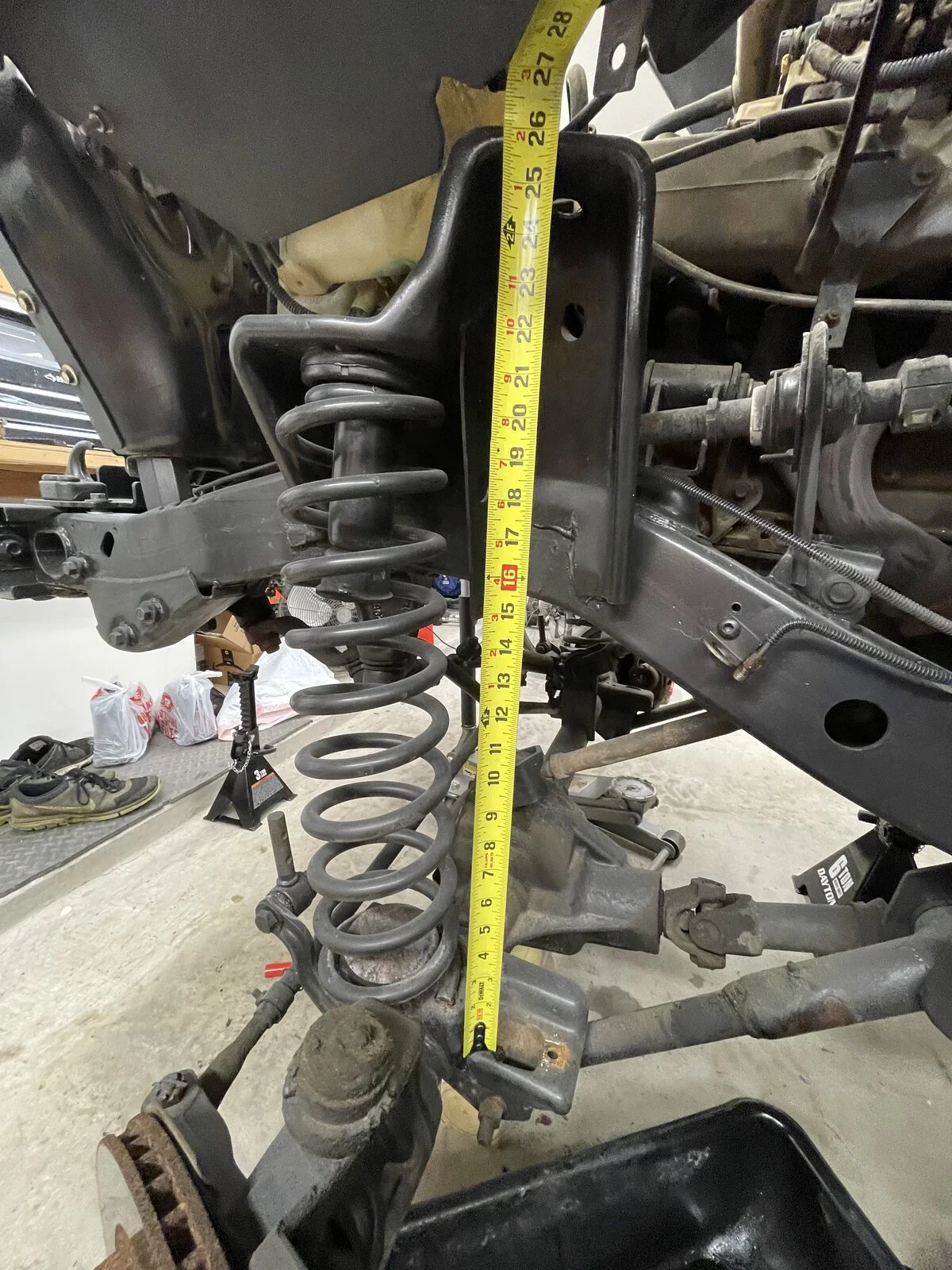

Was able to get the diff protector on the dana 30 and also replaced the diff fluid. While working on the axle I was able to get 1 measurement for shock length. During this process I discovered that there is a bind somewhere in the suspension. I have my suspicions that it is related to my control arms. One of the front lower arms is welded so there is little to no twist associated with it (bushings are the only play). But with full drop on what I have available at this time I am looking at just over 25in of shock length. I couldn't get compressed shock length as with the bind in the suspension this prevented the spring from fully decompressing and I didn't want to pull a link or use ratchet straps to compress the spring. I already know I'll be replacing all my control arms but that is for a much later date. In the picture it does look like the lower control arm mounts are resting on the control arms but there is about 1/4in-1/2in of space left to go. With the shocks removed I took the opportunity to replace one of the brake lines as it has been rubbing against the shock body for some time. Of course I ran into a road block with the bleeder nipple as it is currently stuck on there pretty good. I ordered up a couple replacements and will be hitting the stuck one with good ol' pb blaster during the week.

Pull your springs to get your shock lengths.
