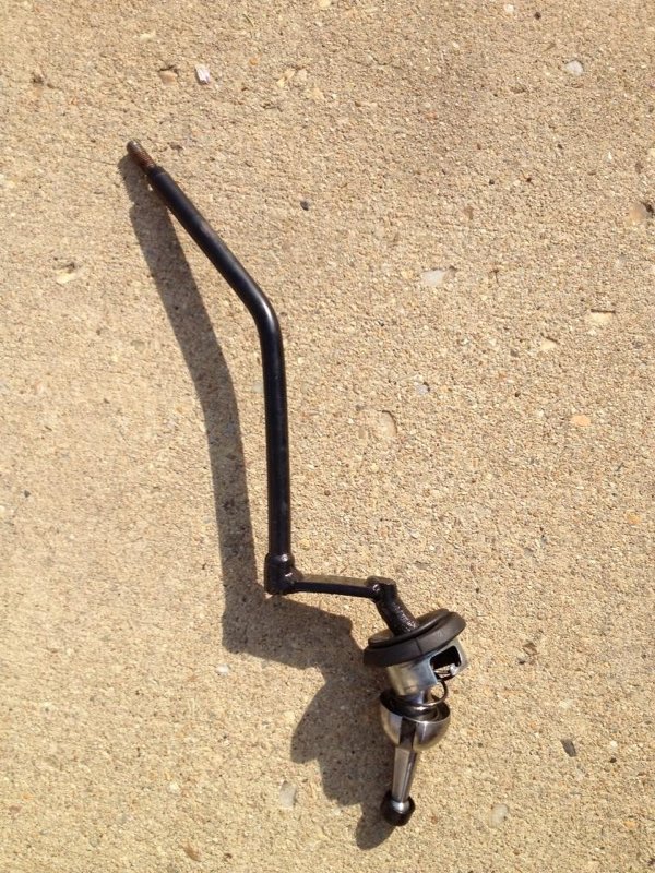

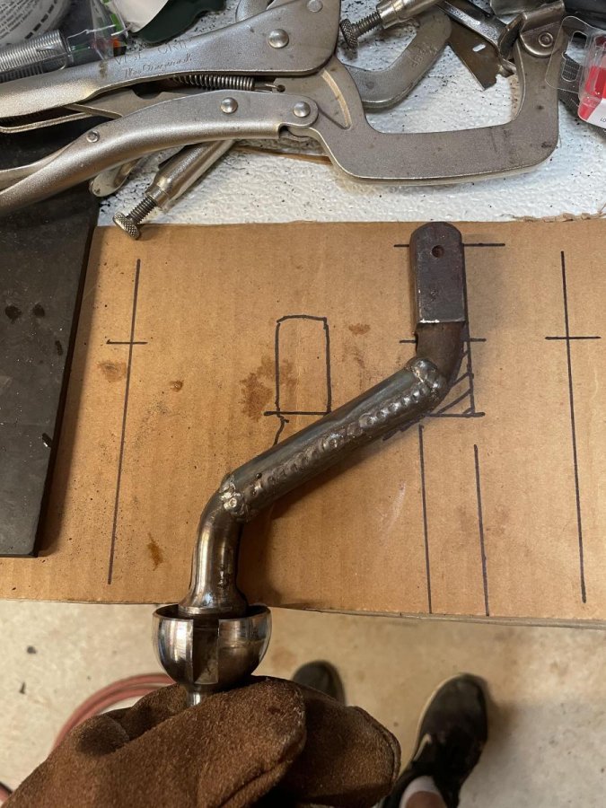

This is the easy way to do the mod. You cut it and use a piece of flat stock to move it back the needed distance. I can't tell you what that would be. You'd need to get it mocked up and figure that out. Then take it to someone to be welded since you don't have a welder or maybe be able to have it done when the mobile welder is there.
The other way is to cut it and then add a piece of round stock in bent to the distance you need.

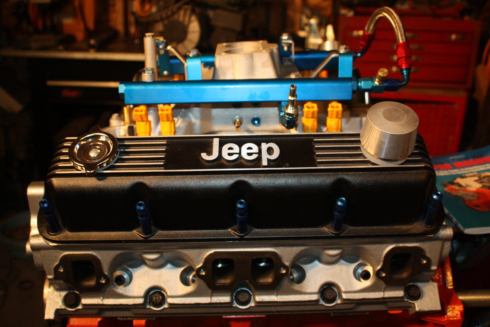

Bumble Beast will live on in this Jeep. I plan on painting the fuel rail canary yellow in loving memory of our beloved donor.
I was going for a Blue & Black look on my last build of my first 5.9.

I'm still looking for a picture of the shifter.

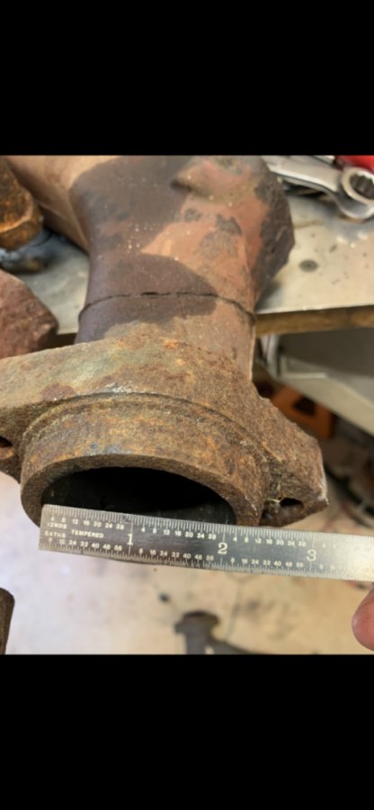

If you are going to run the stock exhaust manifolds find some from a 1992-93 Dakota as they have a larger opening.

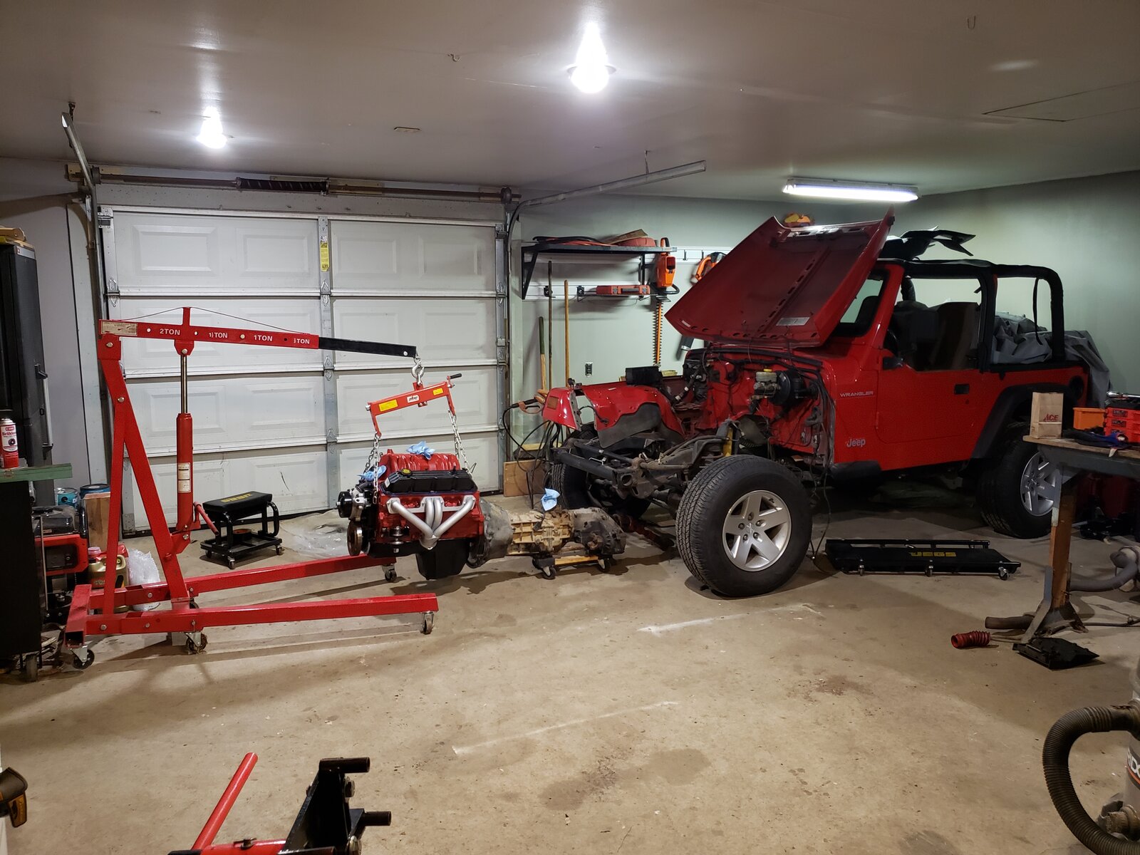

My drivetrain is now all hooked up and ready to throw it in. Just need a buddy to help me put it in as it seems impossible as a 1-peron job. My AA motor mounts are temporarily held in with C-clamps. Any suggestions on what angle to set the mounts. I would like to get them very close to where they should to eliminate removing and reinstalling multiple times.

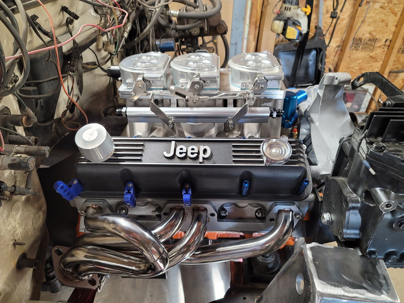

I really want to put on those Jeep valve covers. Keep telling myself just to get it running first. Great info here. Thanks.
I had the Hughes plenum plate on my 5.2 and you're correct it is a very good kit.
Getting things SET before you drop the engine in place will save you a lot of headaches. It's a lot easier to mess with the distributor when the engine is on a stand as opposed to in your TJ.
You can't get the Jeep valve covers anymore unless you find someone selling them used or because they decided on something else. If you watch Junk Yards you can find them on some Grand Cherokees.
Having help pushing around a engine hoist is always a good idea. I'm a one person show and with one leg it makes it a lot of fun moving my engine around.

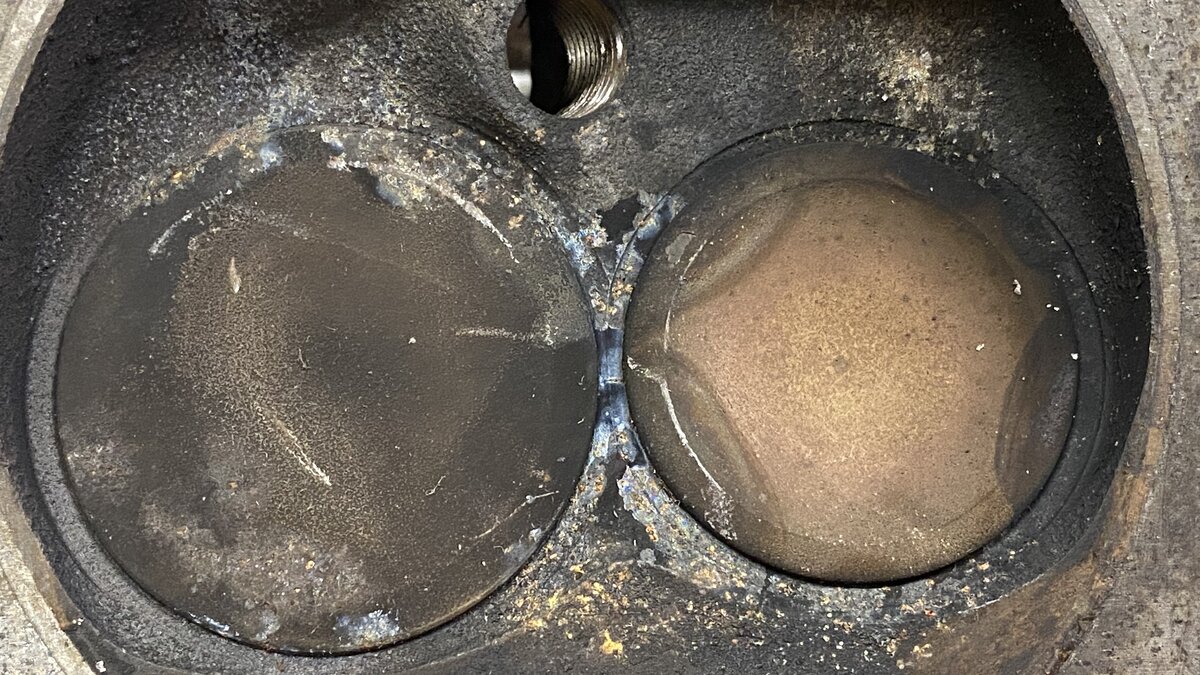

Here is my old 5.2 coming out.
What a mess.

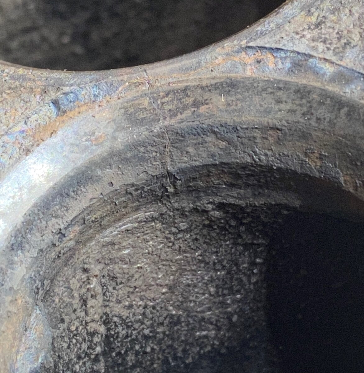

This is what was making it overheat. Start thinking about replacing your stock heads at some point. I don't know what the percentages are of stock heads that crack but you read about it enough online.
I have EQ monster heads on my new engine but unfortunately EQ doesn't make a quality head anymore. Finding iron aftermarket heads that are any good is becoming a problem. There are a few companies that make good aluminum heads for our engines.

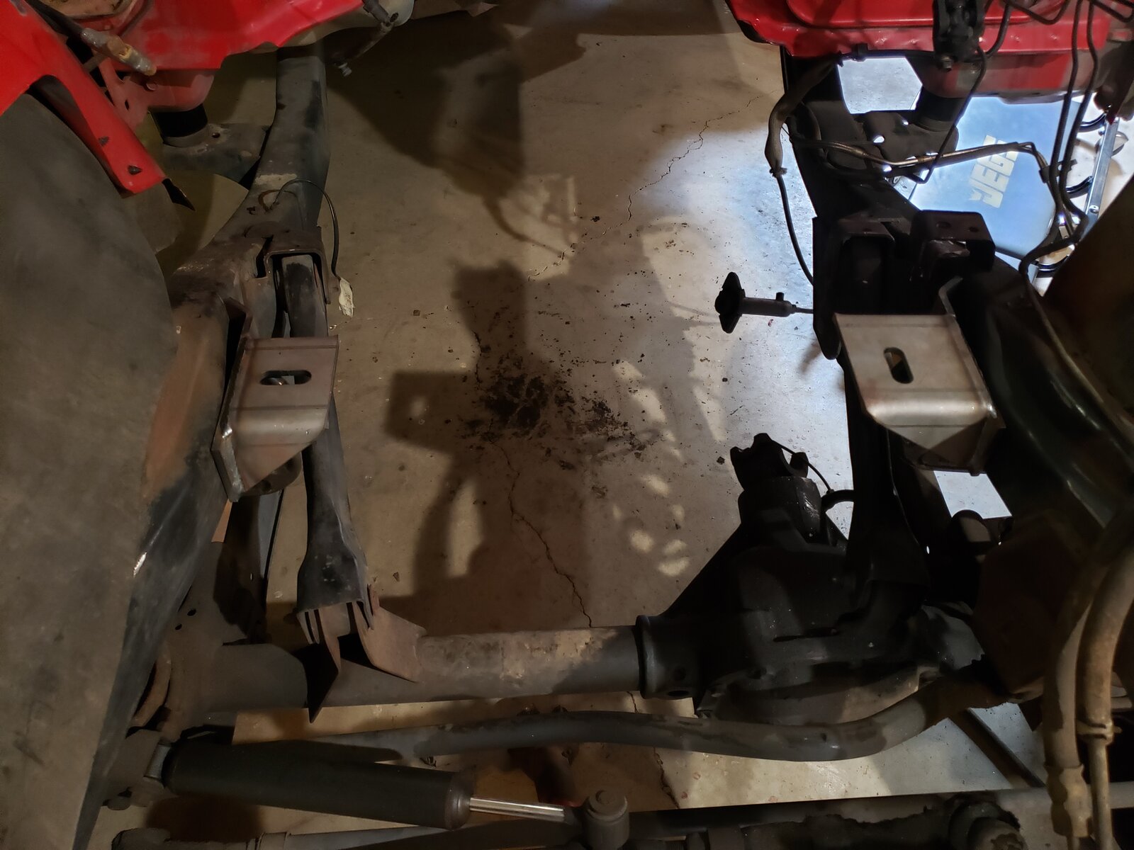

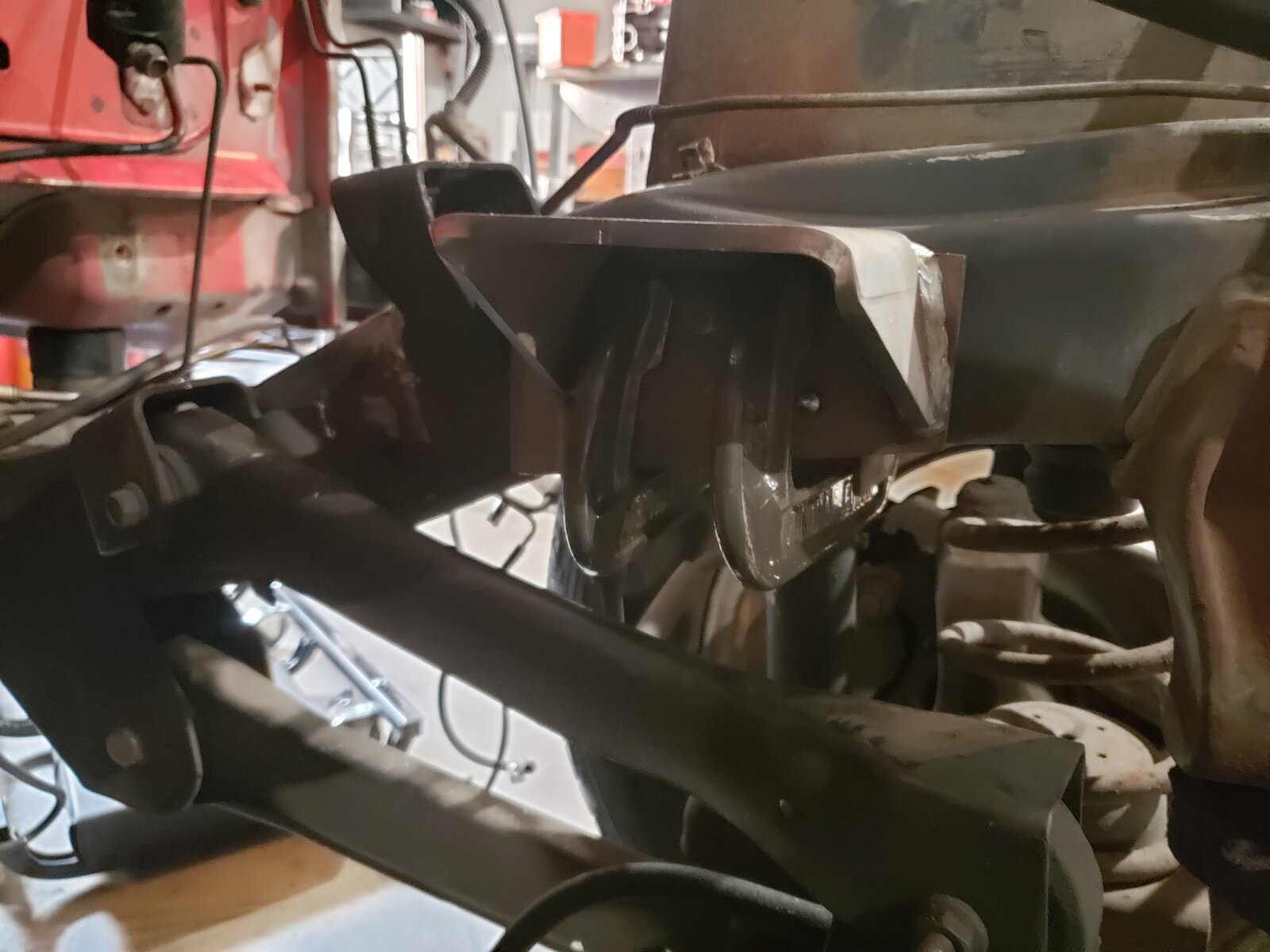

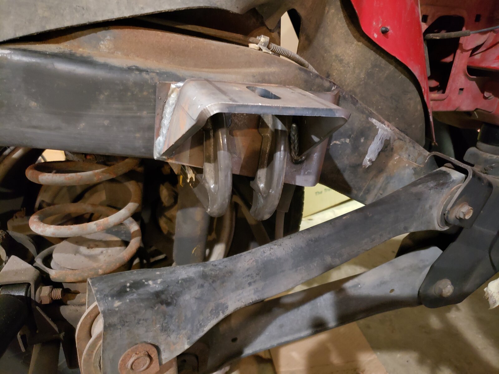

This Saturday I had a buddy come over with his welder. I double checked to make sure my AA mounts hadn't moved. They are still 5 degrees sloping to the back of the TJ. He burned the motor mounts on and I spray painted the mounts, frame, and a few components for rust prevention. We also modified the AX15 shifter. I used the pictures that @Wildman posted as a starting point. I liked keeping a natural looking curve even though all of the bend will be under the shifter boot. It turned out looking great but I won't know how it will sit until I put the drivetrain in. The modification ended up moving the shifter post 2 3/4" to the rear and up 1/2" in height. While we were welding my Barnes 4WD skid plate came in. I need to paint it and then all my supports for my drivetrain will be ready. My NP231 Transfer Case that I bought second hand already came with a SYE and the correct speedo gear (34 teeth I believe) for a 4.11 gear ratio and 33" tires. I'm crossing my fingers that I will get lucky and have enough "bite" where my 2-piece driveshaft comes together. I hear that 2" is the minimum that the male end of the driveshaft should fit into the female end of the driveshaft. I also bought a shifter seal and internal boot for my shifter since I had it all apart.
The third picture above shows the driver side motor mount. Since it was so close to the steering bracket we ended up bending the steering bracket out of the way temporarily. We cut the bottom of the bracket, scored the top weld, bent it up out of the way and after welding pushed it back and welded it back in place.
I cut mine off a while ago so I can't tell you what mine looked like. Try to get your lower steering bearing as far away form the exhaust as you can.
