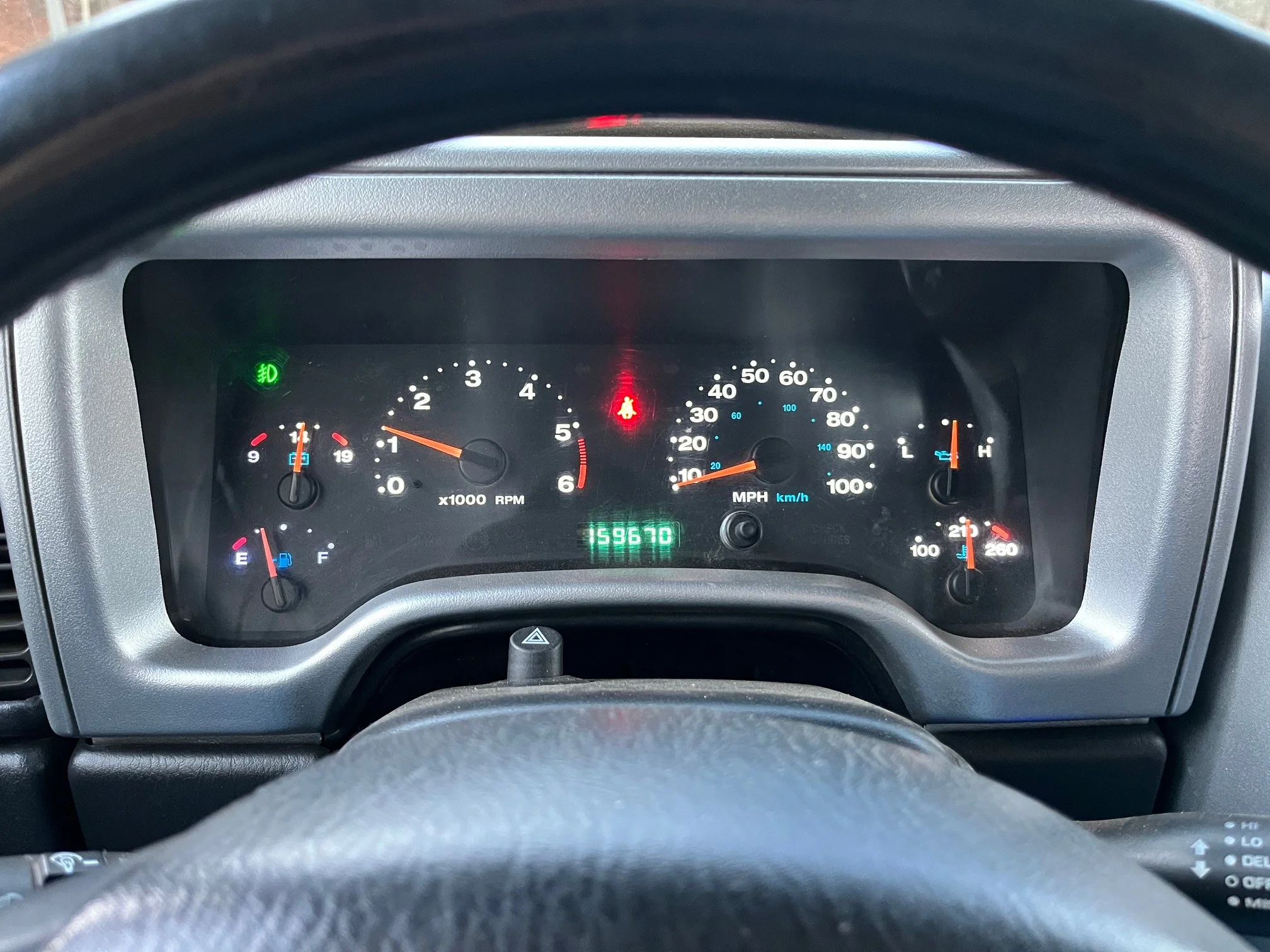

Well last night I swapped out both upper o2 sensors as well as the IAC sensor. While I had the throttle body off the intake I thoroughly cleaned every part of it with throttle body cleaner and it looks much cleaner now. During my drive to work this morning the high idle was still there. I tried spraying starting fluid around the vacuum line harness to find a leak but I cant find anything . Does anyone else here have any suggestions as to what to look for? I have not tried tightening the intake & exhaust manifold bolts yet but I will look at those also.
Its seems like a strange scenario to me. It only seems to happen once the engine is up to operating temp. The picture attached is this morning on my work commute after coming to a stop sign with the transmission in neutral. Its an automatic so the higher idle is very noticeable when braking to come to a stop.

Lots of other places for vacuum leaks...you've got the T heading into the cab for inside HVAC... behind the battery...and then it drops down to a vacuum reservoir inside the fender.

TPS fixed 2 of my rigs with similar symptoms of high idle. One was a '87 XJ with Renix system and may not count, other is a '05 TJ both 4.0L.
The '05 did set a CEL. Thought I would mention it.

Ok thanks for the heads up. In the past I had a random P0301 cylinder 1 misfire code occasionally pop up but I haven't seen that code in many months nor have I noticed any other strange symptoms besides the high idle.

I have noticed the "harder" I'm driving (eg. taking off quickly, near wide open throttle driving characteristic, etc) the higher the rpm's will be at idle after coming to a stop and putting the transmission in Park or Neutral.
When I drive very light and conservative the lower the rpm's will be at idle after coming to a stop and putting the transmission in Park or Neutral.
I wonder if there could be any correlation here that could help diagnose.
