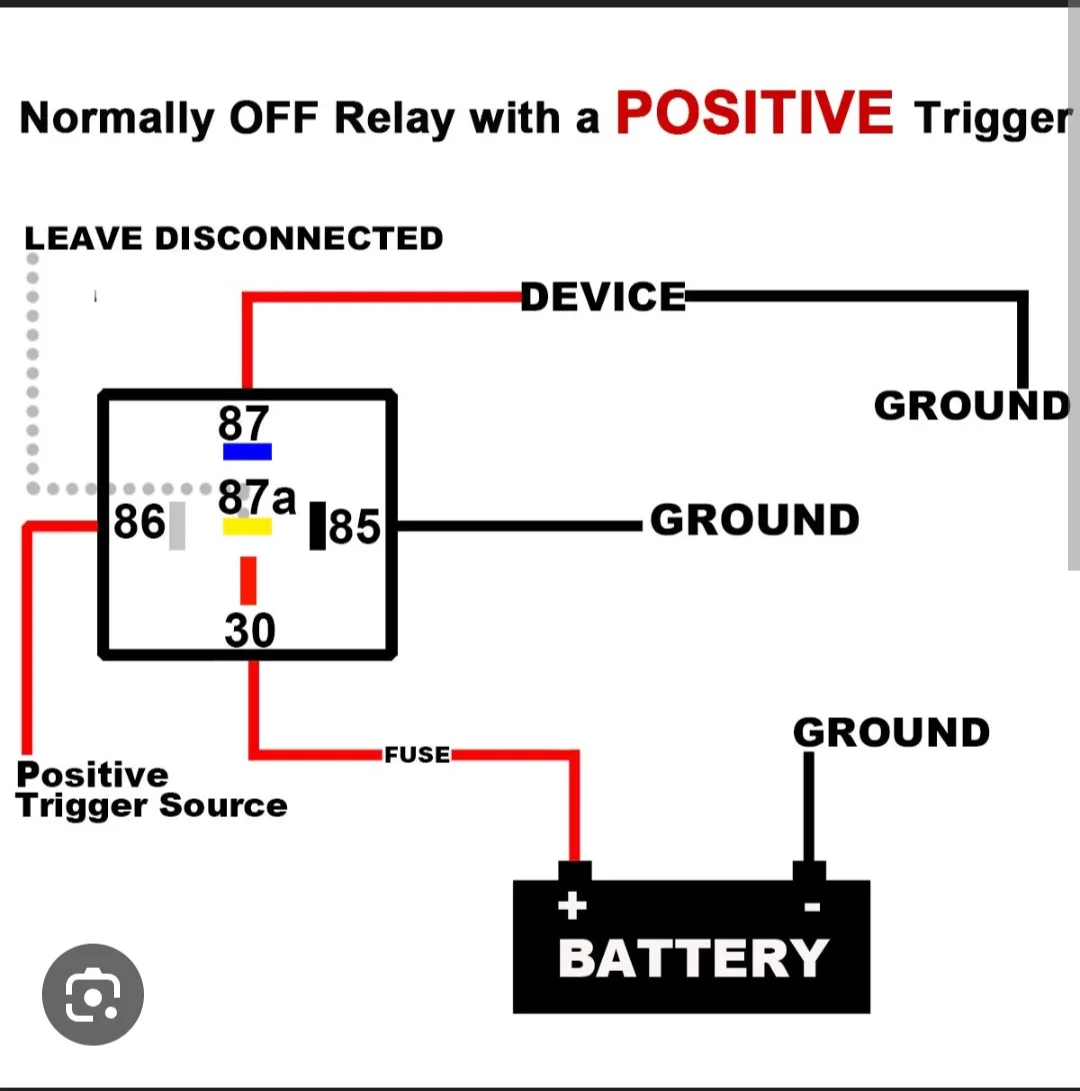

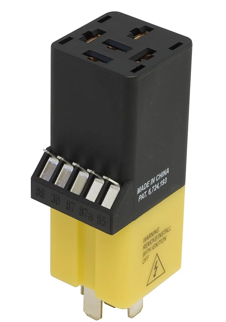

if you bypass the relay and it fires up it would make me want to use a meter and check the wires going into the relay socket. Power in and out work but what about the power to activate the relay? The ground for the relay?
Trace it backwards til you find the problem

Ricky when I do the back check with a meter, what should I be looking for? Numbers wise ohms or amps?
