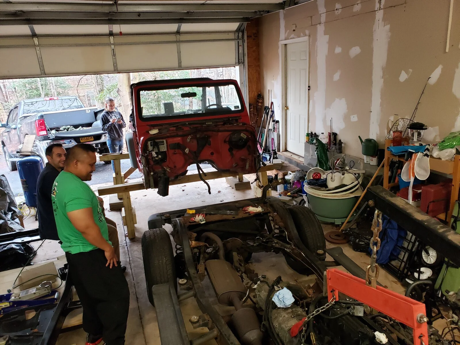

I brought the TJ home and moved my ATV and motorcycle out, covered it in a tarp and hid it for over a month. My wife and youngest daughter got to go for a ride in it and luckily the wife bought into my idea. Even more amazing is my youngest daughter never spilled the beans about the surprise. So on the big day after juggling some schedules and moving kids around I went to get the TJ out of the garage. Dead battery, and in replacing it I sliced my hand on the hood. Amazing how sharp it is and I now have a great scar on the back of my hand. BUT I got it running. At the big reveal her smile was beaming and she loved it. All it's imperfections and everything. So we went out on the first drive.....and the fuel pump died stranding us. I had to wait because the plan called for us to drive for an hour or so and then when she got home all her friends would be waiting for her and her party would ensue. Needless to say I felt like an *** when we rolled up in a tow truck her Wrangler on the back. She didn't care. She still showed it off to all of her friends and told them SHE was gonna rebuild it. Most of those girls think she is nuts. But that's my girl! By the next day we had the front end pulled apart.

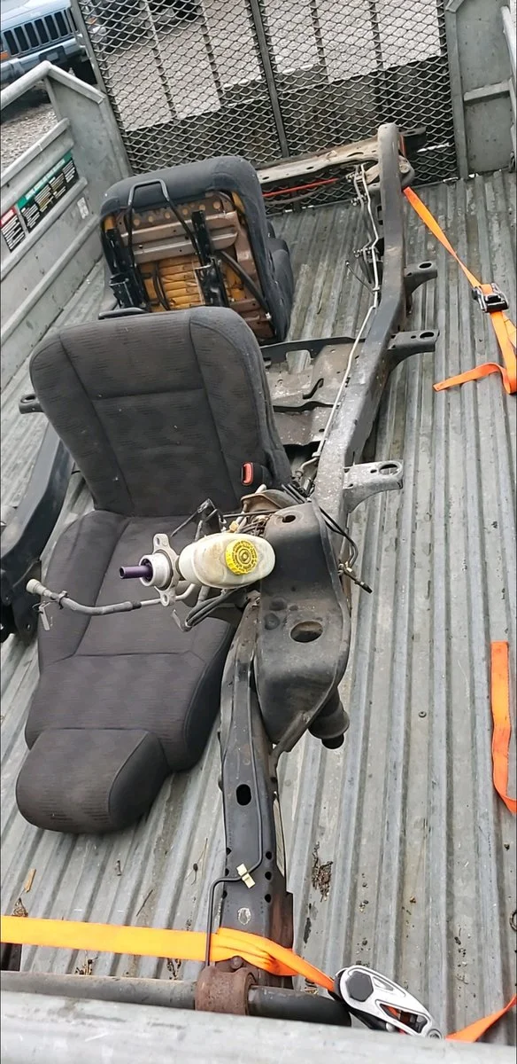

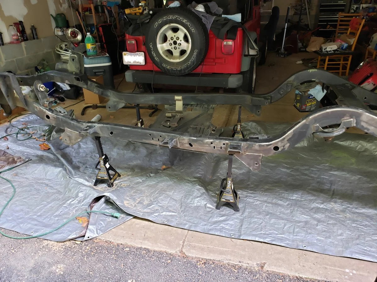

After a bit of searching and some runaround from a few online dealers my options were drive to Davey's out in Ohio for an 05 Rubicon frame in good shape for 2500 or buy a brand new one for around 4500. ROAD TRIP! Frame and two new seats in hand we made excellent time to and from Ohio with no issues and that made the choice of going with a used frame worth it.

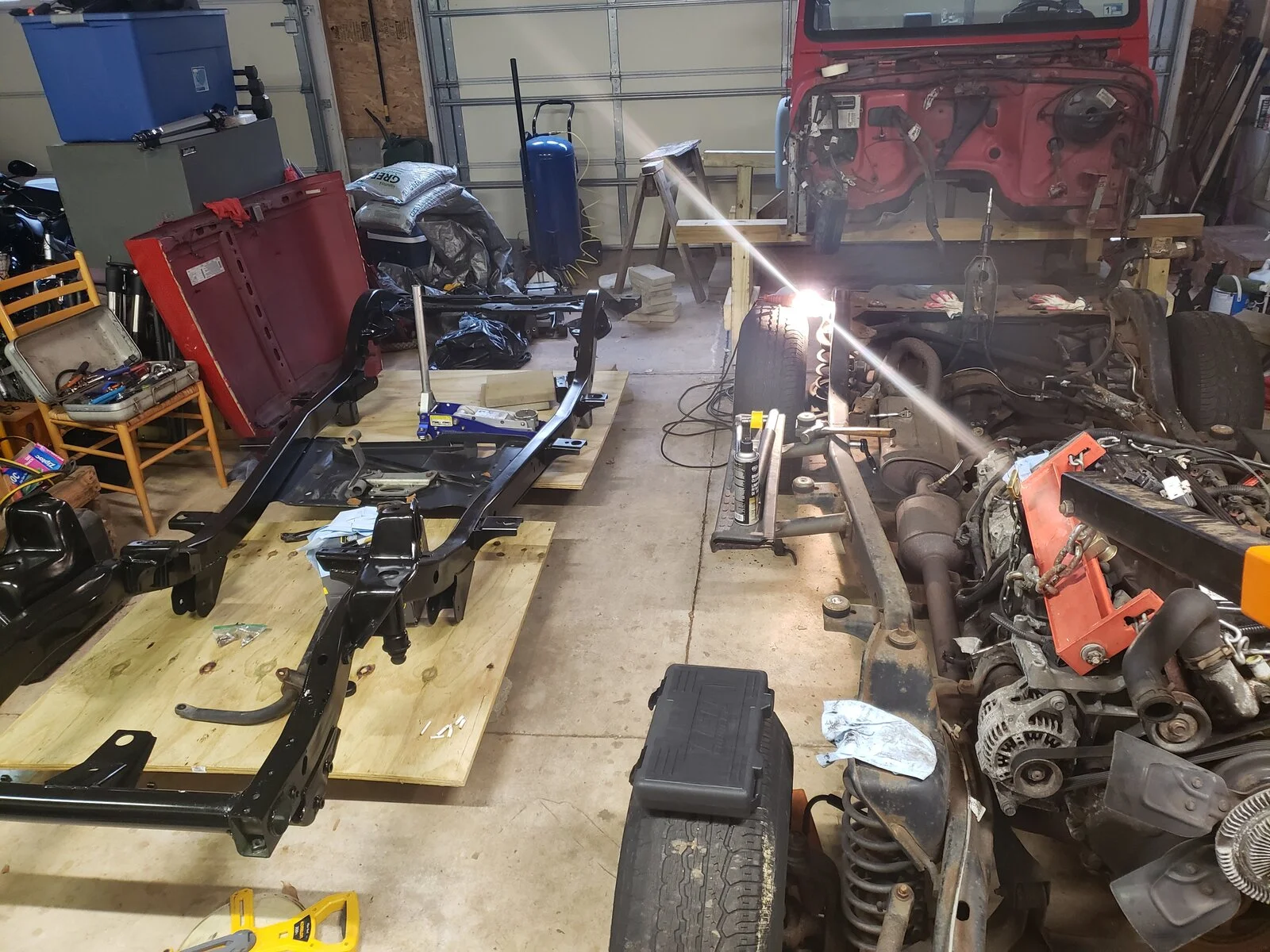

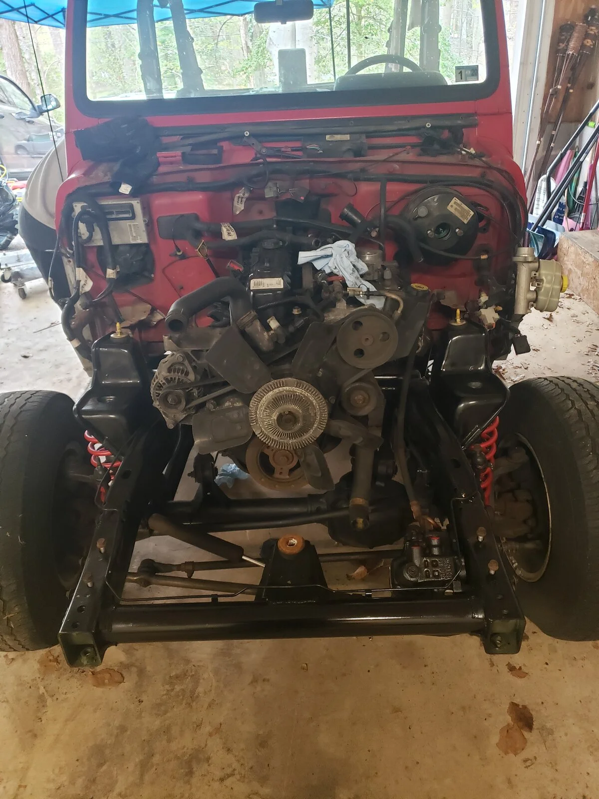

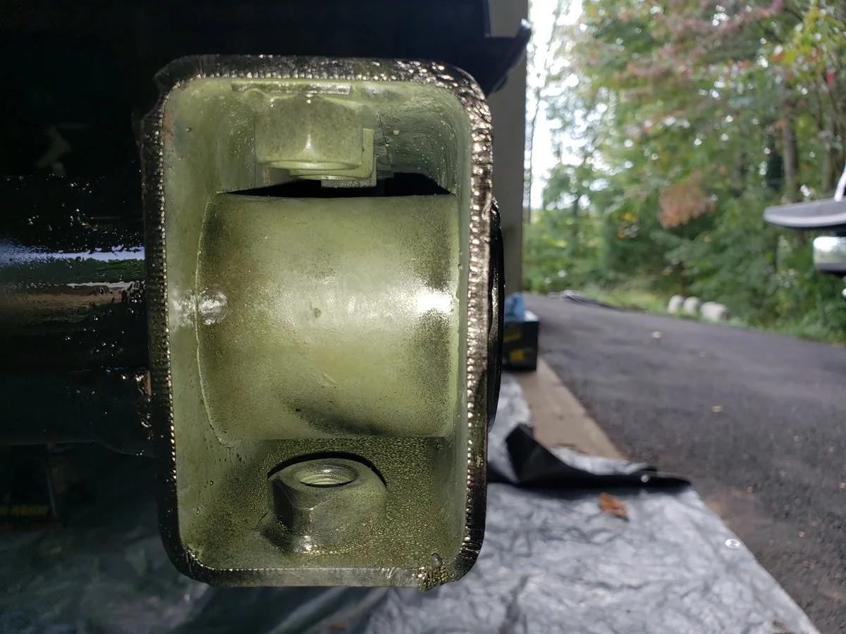

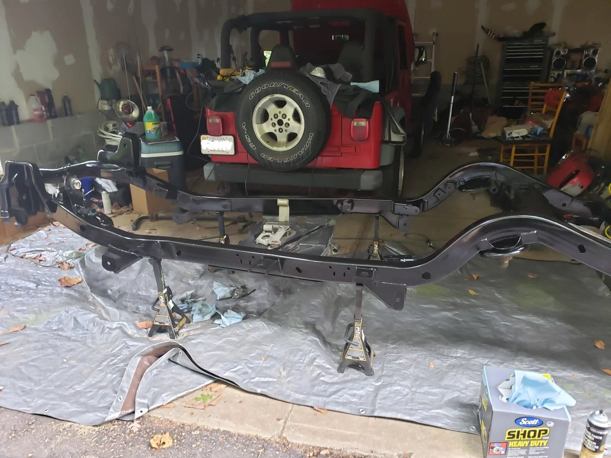

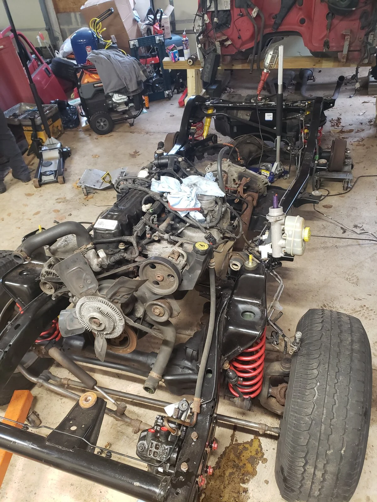

Fast forward two months....actually almost 3 because I was insanely busy with work, and I finally got around to stripping any surface rust off the frame, cleaning it inside and out and putting a few coats of Eastwood paint on. I went with green on the inside of the frame cause....why not and a coat of primer and two coats of gloss later my wife asked if it really needed any more. I don't reckon 6 coats are necessary so, FINE...we will get on with it.

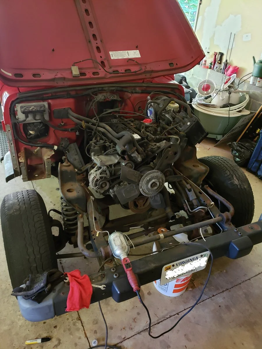

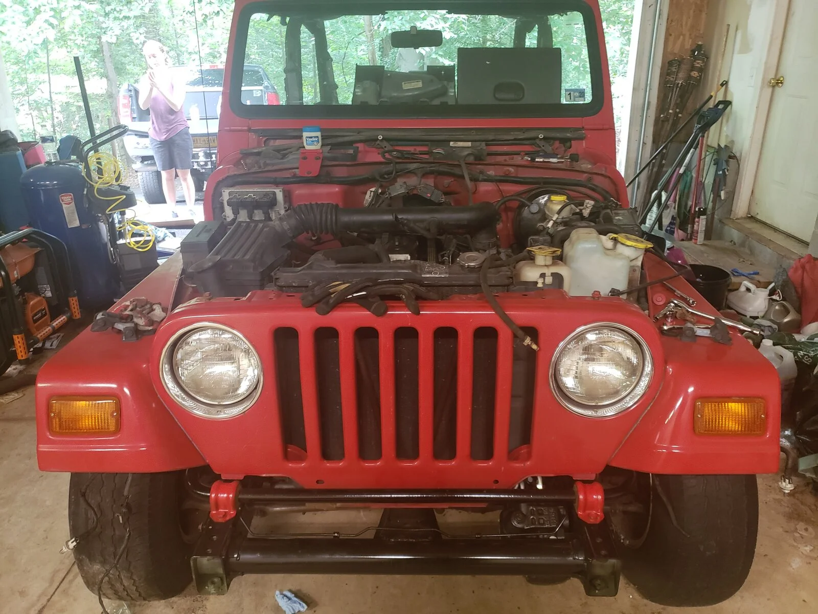

That pretty much brings things up to speed. Next week we are planning on lifting the body off, hoisting the engine and getting straight to stripping parts off the old frame. I'll clean them up, paint em and throw them right back on the new frame. At least that is the plan.

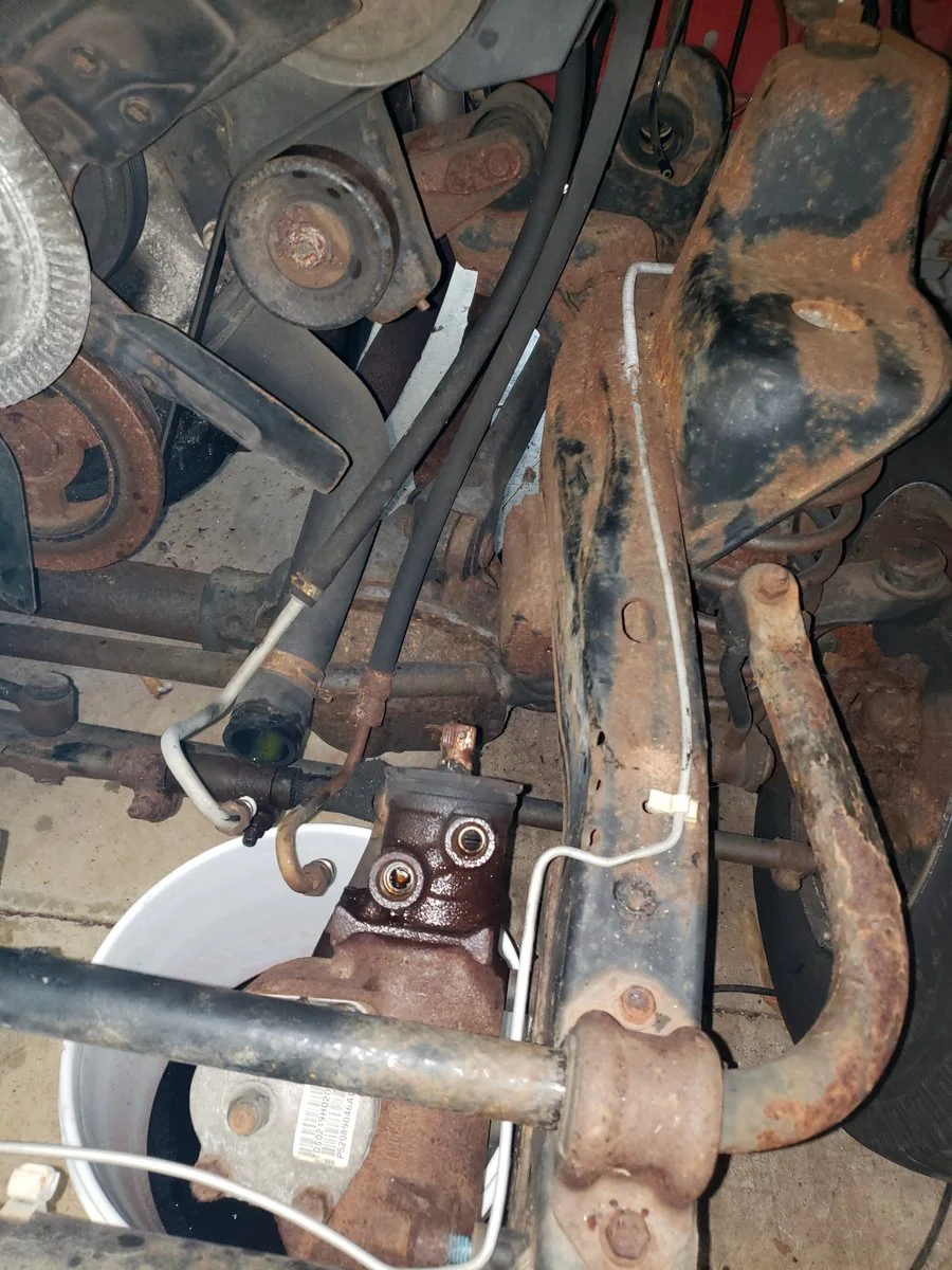

The steering box. Obviously the 05 frame wont accept the 99 steering box without drilling the frame or some other welding and what not.
Some people have been telling me to just do the "Durango" upgrade, but some reading I have done tells me that this only works on 02 and prior. 03 they switched to a Mercedes box. The prices for new ones are not a cost I was planning on absorbing. Since I still need a fuel pump and five new tires, possibly rims if there's enough left over.

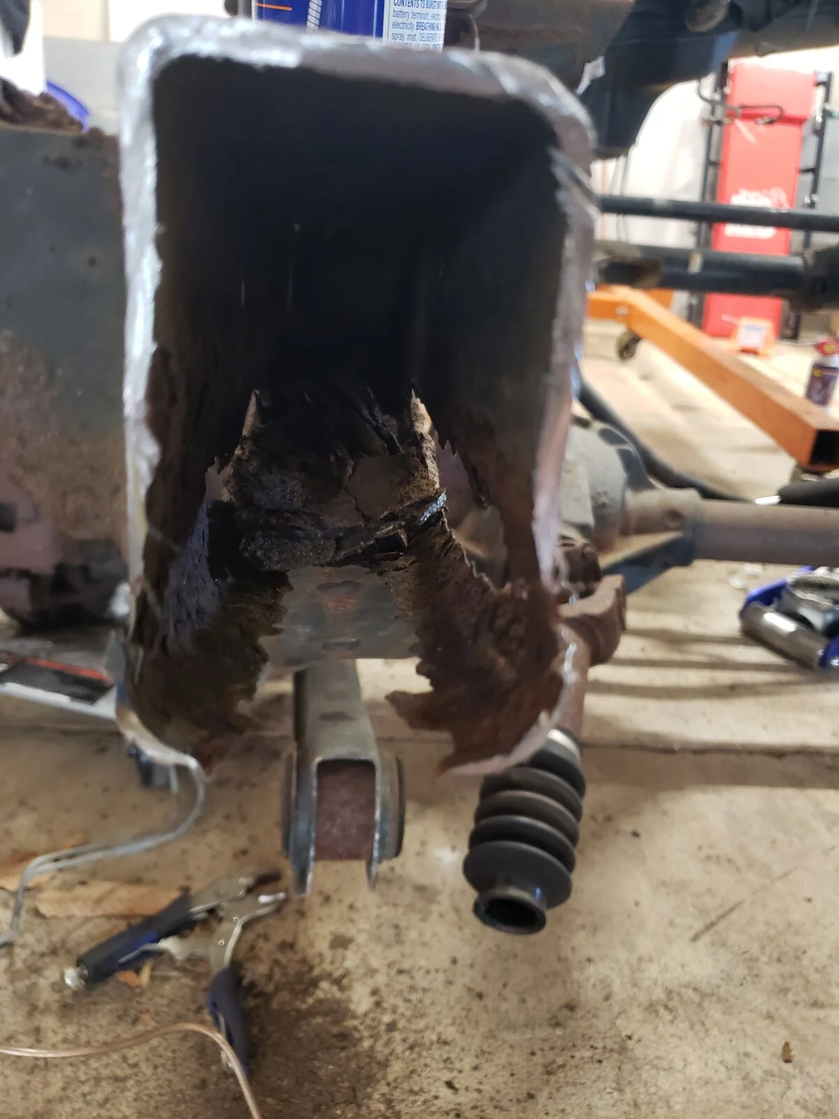

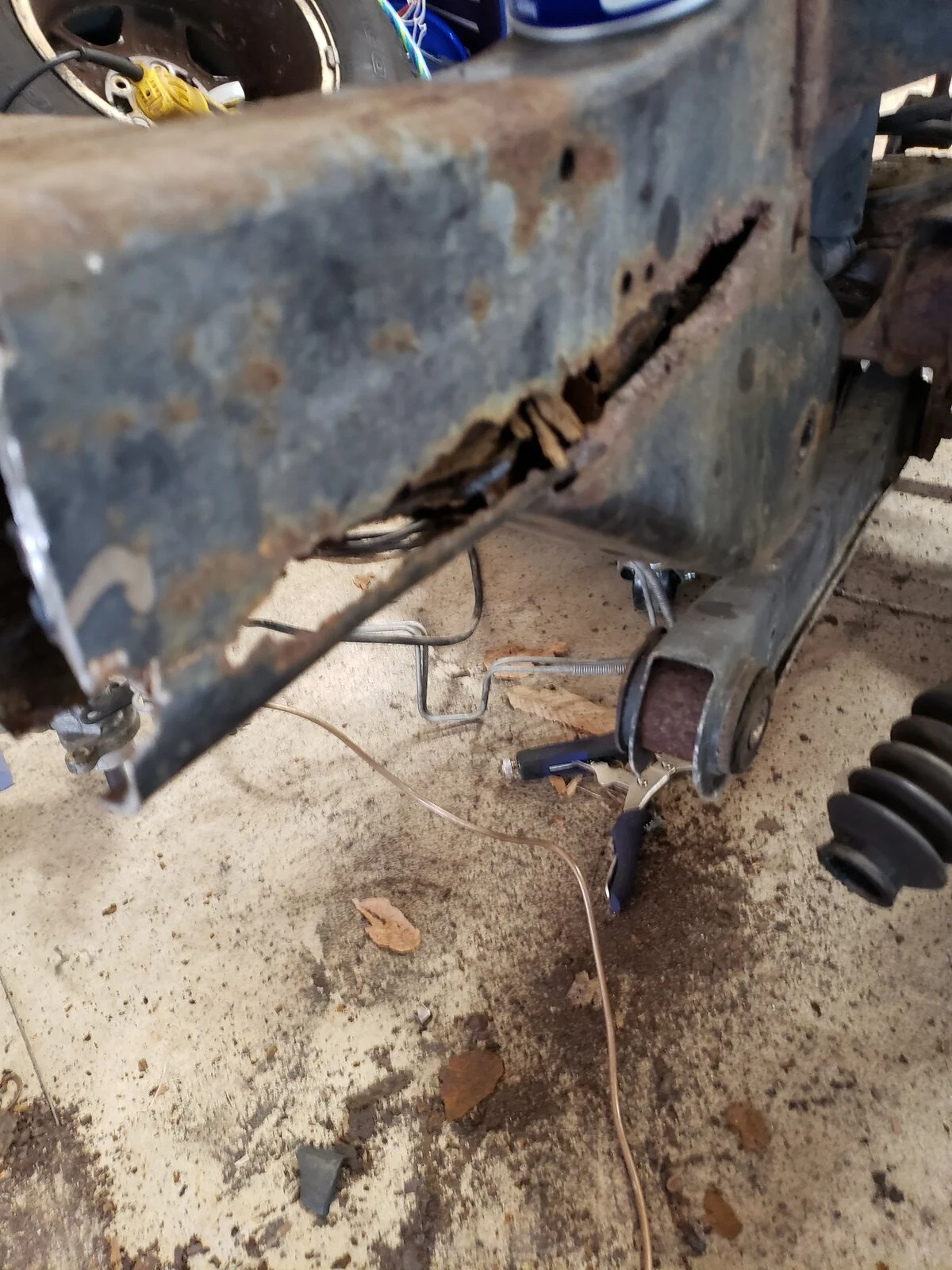

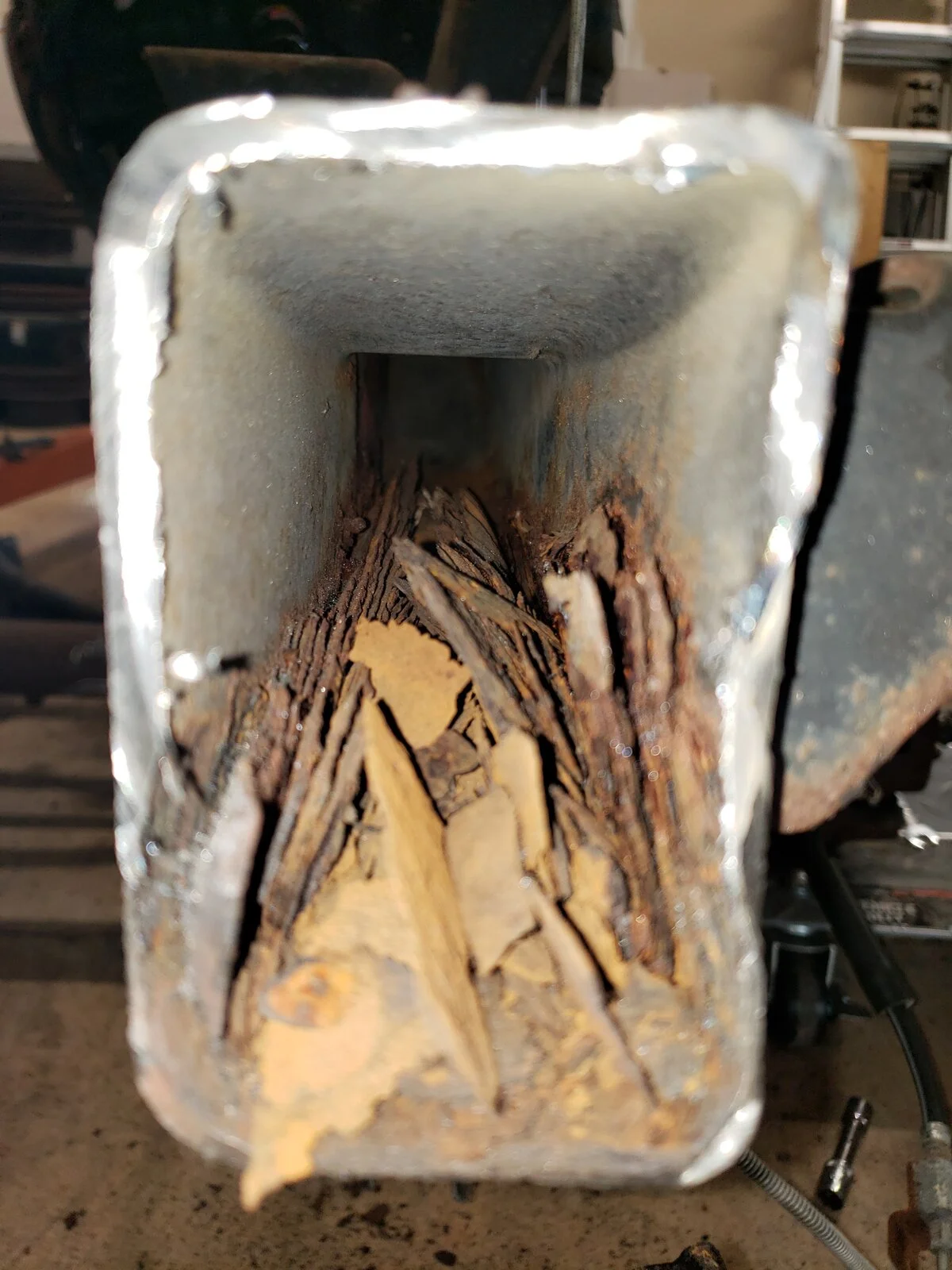

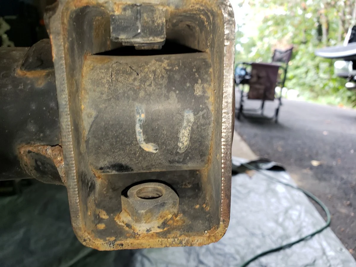

OH..and for those that are asking why I didn't just put those frame caps on or weld them up....the frame rails are REALLY bad. I was considering fixing the frame and building another one off of it but they are too far gone. I'll make sure to get some pics of it before I cut it up.
