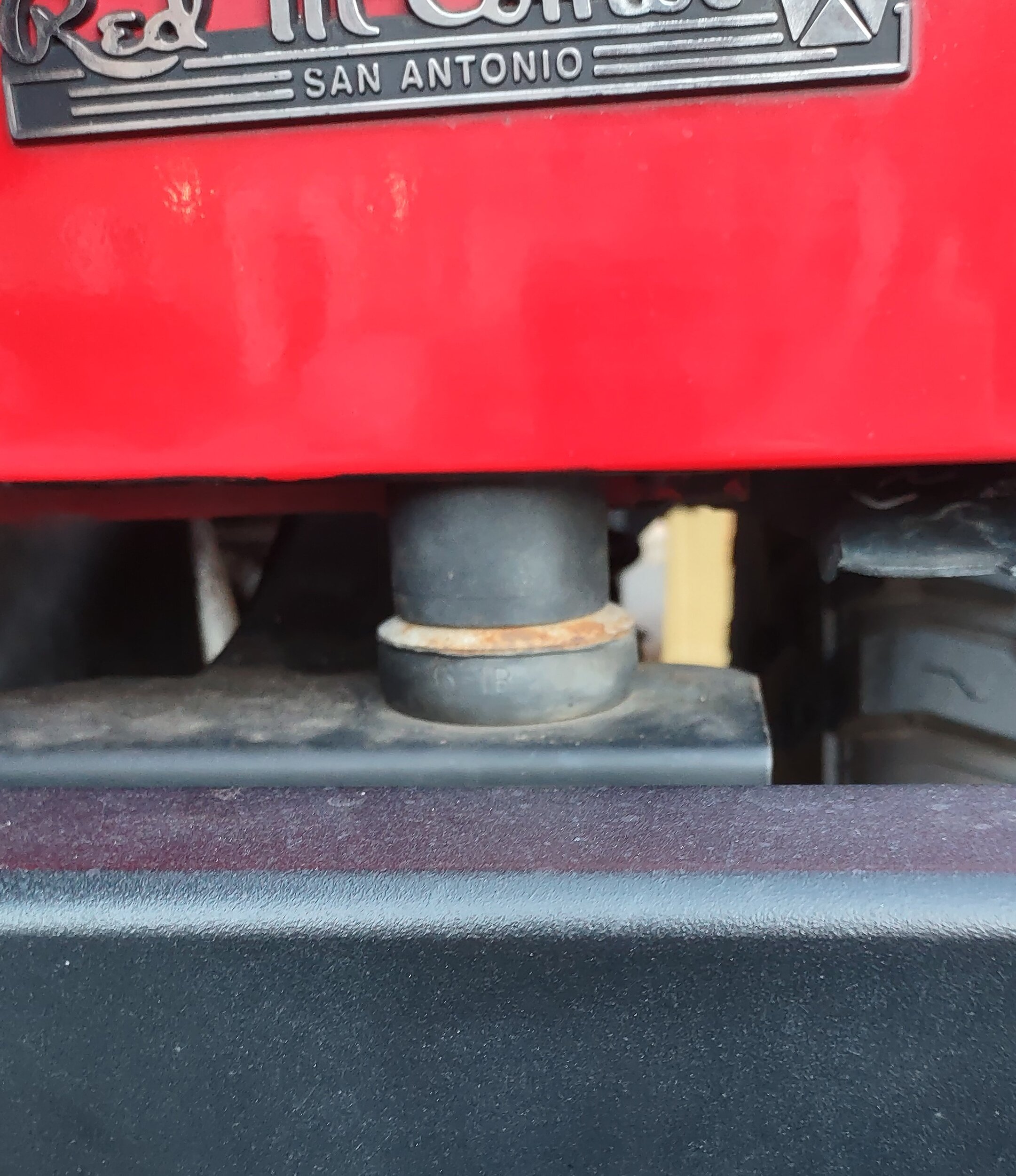

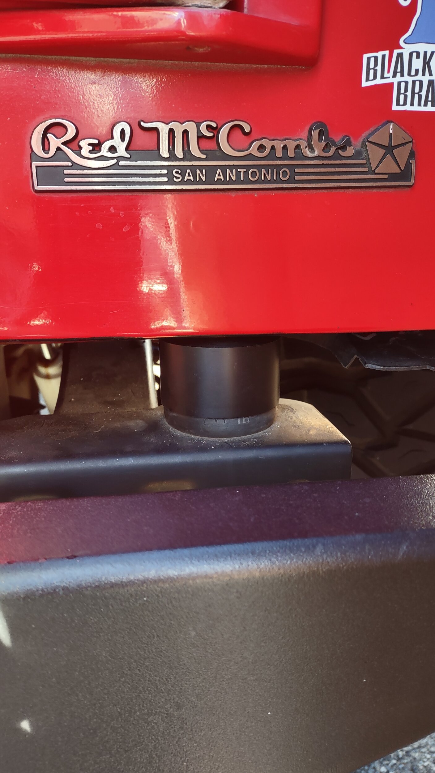

Yes. The Zone combo lift consists of a 3" suspension lift, 1" MML, and 1.25" BL. I swapped my ugly BL for a Black Magic one. :cool:

I'm glad nobody told me this stuff before installing my Zone combo lift 7 years ago. ZERO issues. :unsure:
This is a key post-
You may have zero drama
You really don’t know til it is done-
The body lift gives you more height with less driveline change- raises the tub.
