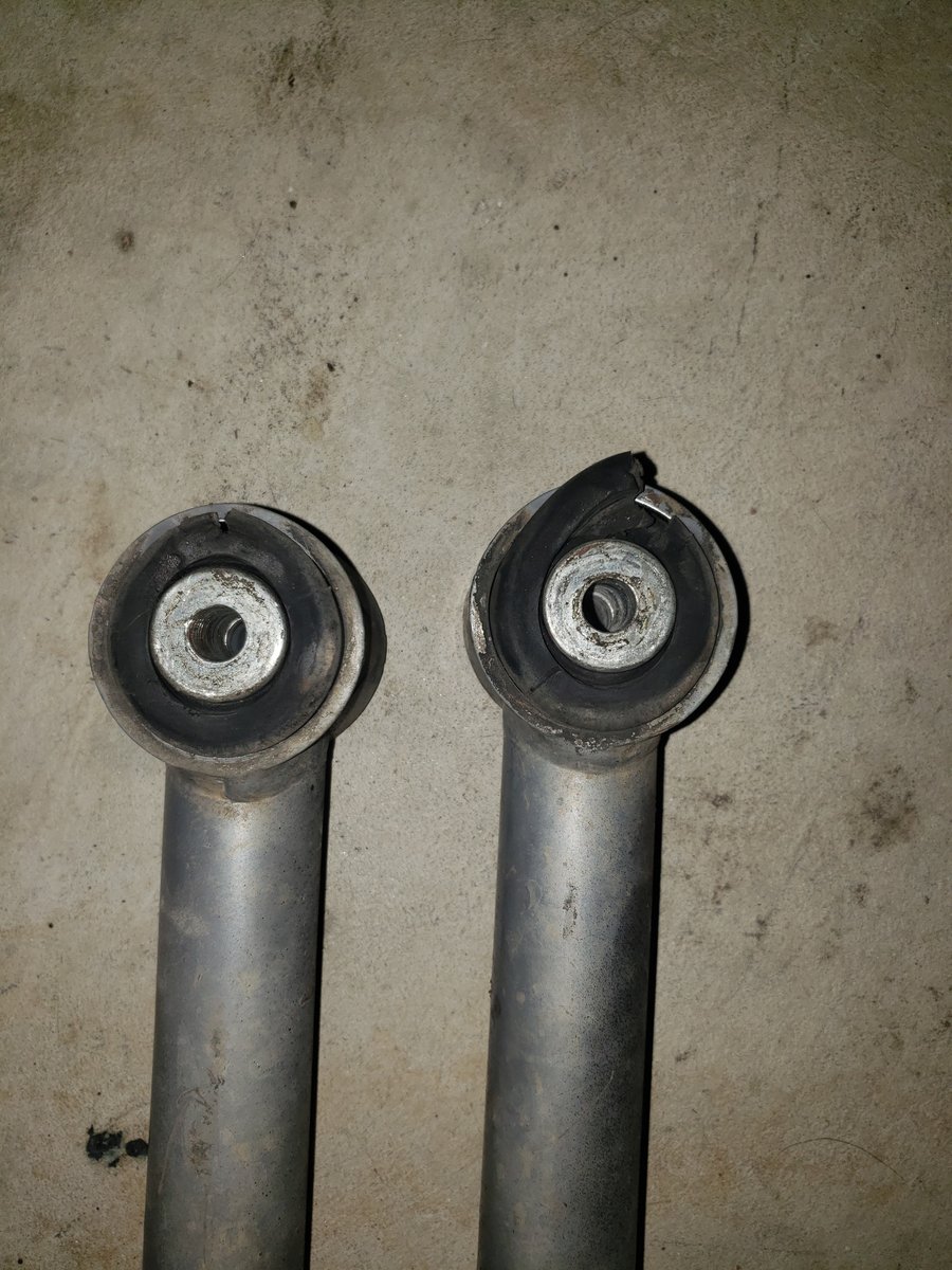

Here is a good reason not to buy a cheaper lift.
These are Rubicon Express control arm bushings at 10k miles (thanks to @Alex01 for the photo).
That's pretty unacceptable if you ask me to have bushings be in that condition with only 10k miles on them.
It's like I always say, "buy once, cry once".

Understand the thought, however, my last TJ had a Rubicon Express 4.5" super flex kit on it with OME shocks and I never had any issues with it throughout the life of the vehicle. Rode well, flexed well can't really say anything bad about it.
I've been doing some digging and the rubber is actually covered for life. Getting a hold of RE wasn't as easy as when I have talked to other manufacturers such as currie, metal cloak, and warn. I got placed on hold after the rep had to talk to a higher up about my issue then got hung up on. When I called back they didn't answer for 5 min so I hung up and waited 20 min. I tried again a few more times and finally got a hold of the same rep that I spoke to on the first call who remembered me but didn't seem overly excited to be on the phone with me. (Just in case your wondering I was extremely polite on both my calls because I don't take out my issues on the sales reps since it's not their fault. I'm a strong believer that someone who is nice will get more help than someone who is a PITA.) The RE the sales rep told me that he spoke to his manager previously and they ended the warranty. Which sounded really odd to me since when I bought it it stated lifetime. He did however say he would send me out a new set of rubber bushings since the website still states it has a lifetime warranty. He did however made it very clear that the website shouldn't say that and he was doing me a favor.
On a positive note the rep told me that he would send out some extra rubber bushings so I had them on hand which I was pleasantly surprised about.
Per the website.
*Rubicon Express PT-MEG Super-Ride bushings are covered by the Rubicon Express Advantage Lifetime Warranty, and will be replaced in the event of failure for the life of the product.

I've been doing some digging and the rubber is actually covered for life. Getting a hold of RE wasn't as easy as when I have talked to other manufacturers such as currie, metal cloak, and warn. I got placed on hold after the rep had to talk to a higher up about my issue then got hung up on. When I called back they didn't answer for 5 min so I hung up and waited 20 min. I tried again a few more times and finally got a hold of the same rep that I spoke to on the first call who remembered me but didn't seem overly excited to be on the phone with me. (Just in case your wondering I was extremely polite on both my calls because I don't take out my issues on the sales reps since it's not there fault. I'm a strong believer that someone who is nice will get more help than someone who is a PITA.) The RE the sales rep told me that he spoke to his manager previously and they ended the warranty. Which sounded really odd to me since when I bought it it stated lifetime. He did however say he would send me out a new set of rubber bushings since the website still states it has a lifetime warranty. He did however made it very clear that the website shouldn't say that and he was doing me a favor.
Per the website.
So, basically the rep is saying, “I’m doing you a favor because we are stupid enough to put up wrong information.“
These people are IDIOTS!
This should probably be a warning call to anyone in the future to avoid RE. They may have made it right this time, but I doubt anyone else will be so lucky.
