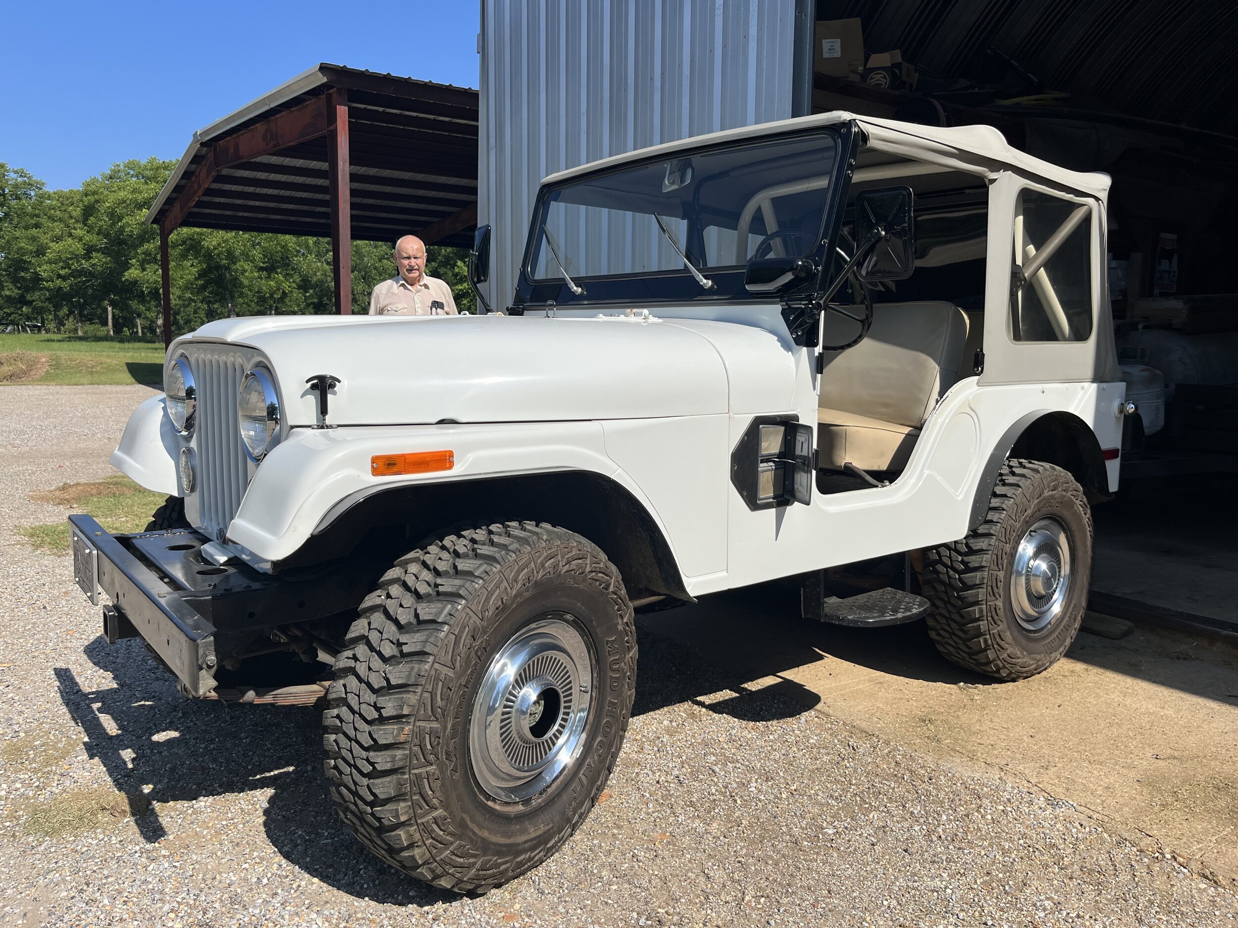

My Dad and I have shared a common interest in jeeps for as long as I can remember. I guess my grandad is to blame as he purchased a CJ5 brand new in 1973. This is him with it (still mint) in 2022!

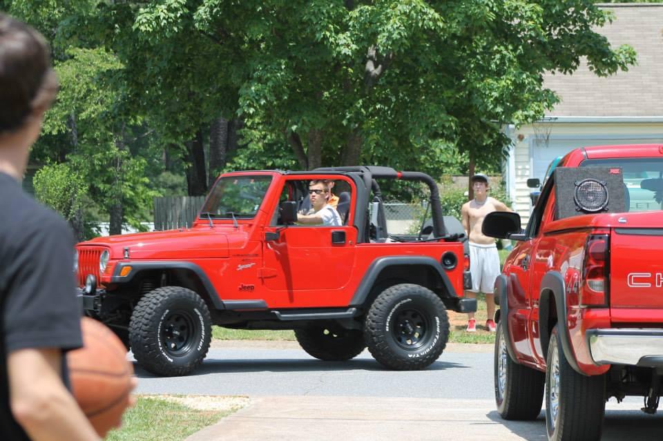

From there, I really got the bug. Unfortunately, I was a high school kid with no money to upgrade the Jeep and my parents weren’t really keen on me lifting it very high. I always loved a TJ with a 4 inch lift on 35s - that was the ideal Jeep to me. But since my parents opposed, I saved up all my lawn mowing money and we settled on a 2.5 inch rough country lift, 32 inch BFG KM2s and Smittybilt SRC front and rear bumpers. At the time, I really liked black rims so I also purchased some Mickey Thompson Classic II in black. This is what it looked like then (before the bumpers):
Now I knew nothing about gear ratios, lockers, LSDs and anything like that but I was pretty happy with how it looked. I drove it for years just like this and it got me through college. Eventually the KM2s got bald and I replaced them with 33 inch BFG KO2s since it spent most of my time driving back and forth from GA to Mississippi State. BTW this Jeep still had a factory Dana 35 and 3.07 gear ratio. It was a dog, but I didn’t know better at the time.

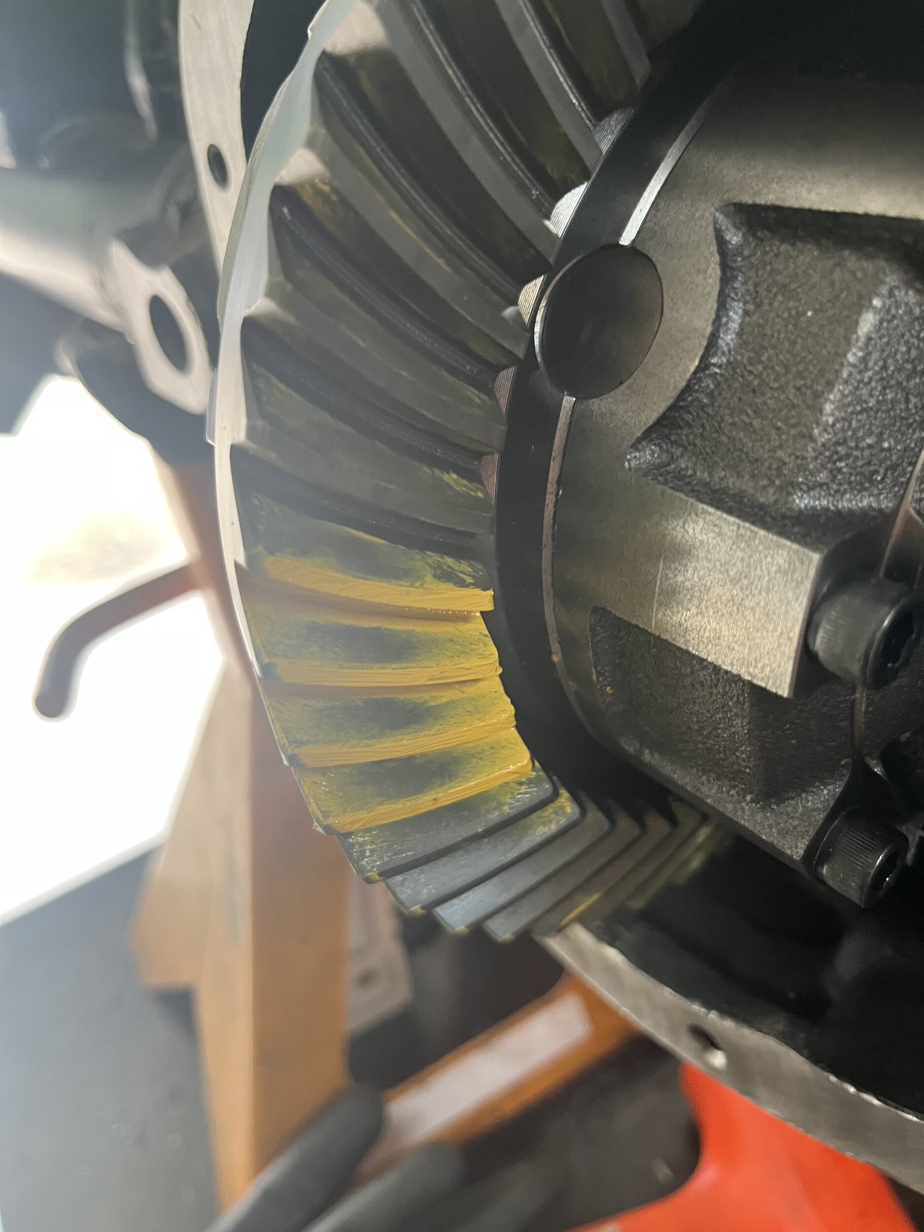

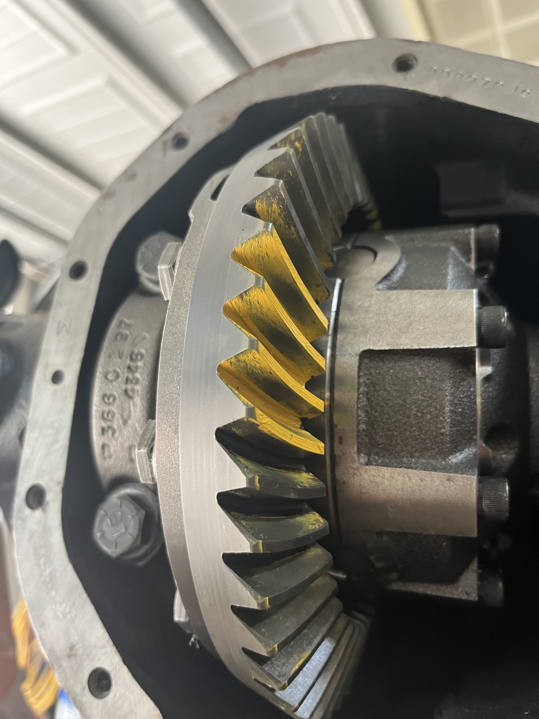

. That was not the case. So, I started researching how to re-gear. Up to this point, every upgrade and fix to the Jeep had been done by my dad and I and that was part of the fun. We had never re-geared before and I contemplated on using a shop but eventually decided against it and we learned to do it ourselves. This was a lot of fun and I’ve driven a few thousand miles on revolution 4.10 gears since with no noise and no issues. Hopefully this continues! Here was my gear settup before we sealed it:
I was told maybe a bit deep but like I said, no noise and no issues! In hindsight, I’d probably go with 4.56 gears but the 4.10s do the job (there’s not much to crawl here in south AL).

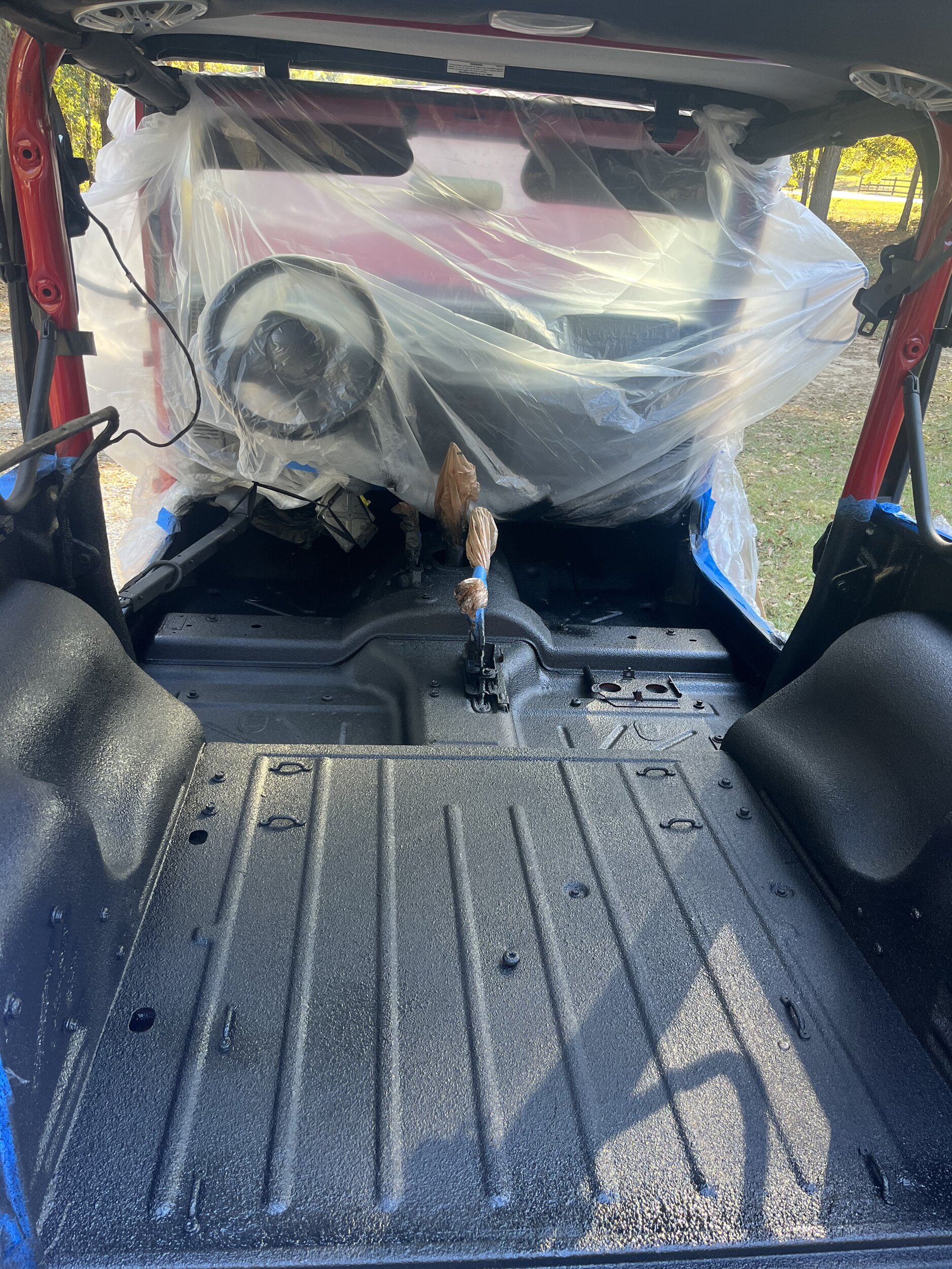

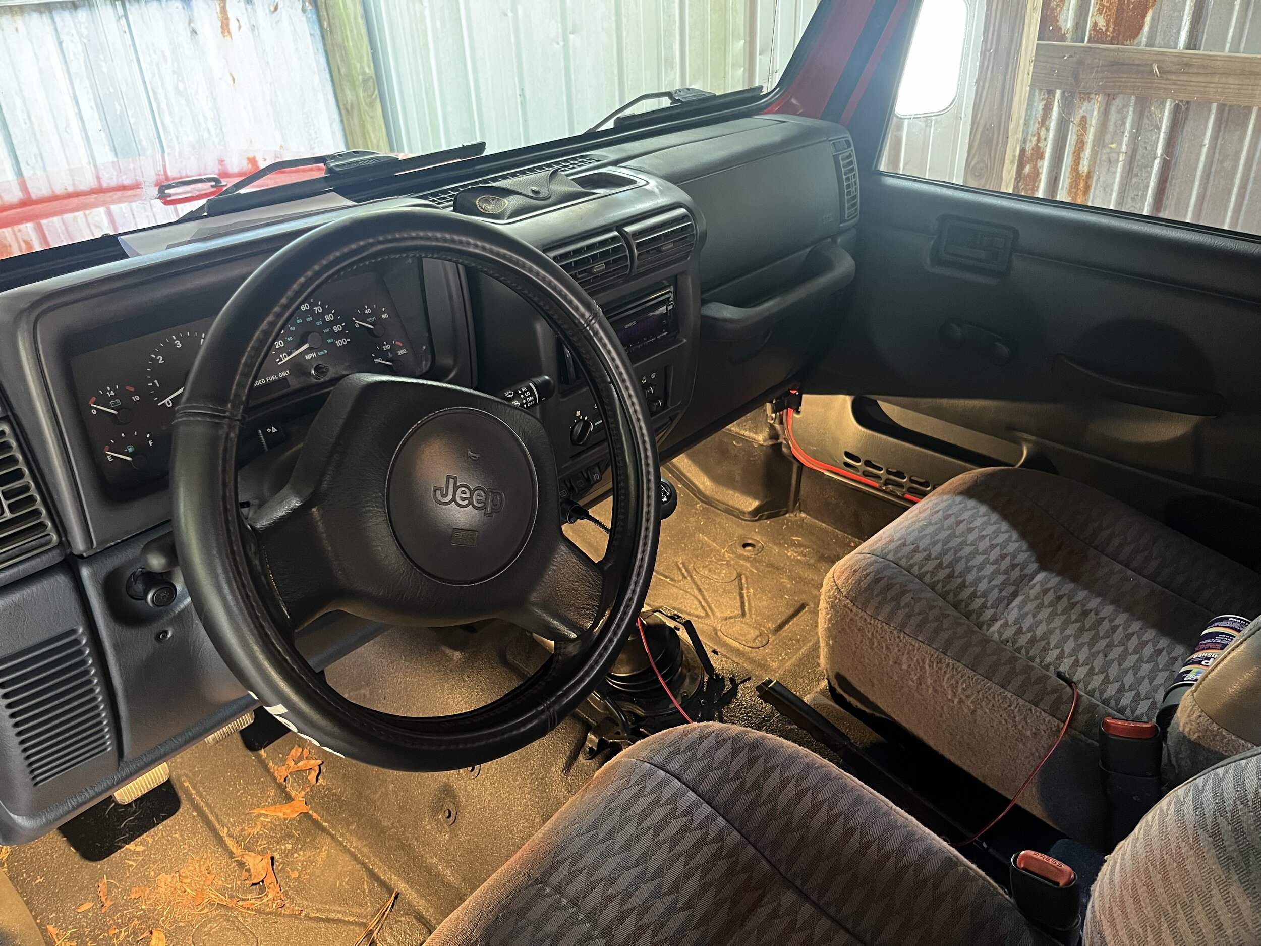

I had replaced just about everything else, so I decided to re-finish the factory interior well. I used Colorbond Chrysler agate (purchased from Genos garage) and raptor lined the tub:
I got rid of the factory mist gray that had begun to fade (especially on the door panels) and went went with the factory Agate paint code. I’m pleased with how this turned out, but must say I’m skeptical at best as to how the Colorbond will hold up. I believe it’s going to flake and chip over time even with a good prep job. We’ll see!

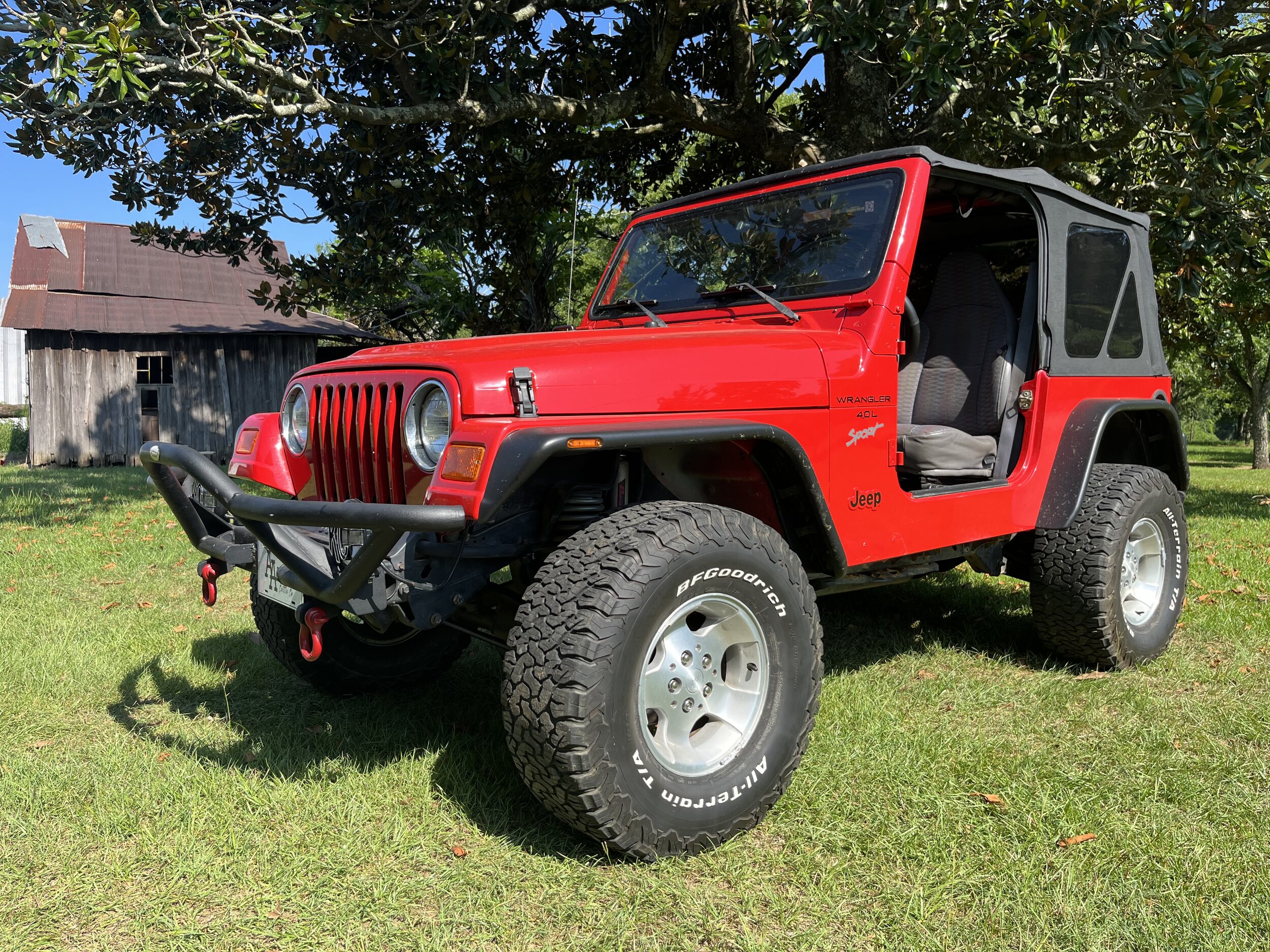

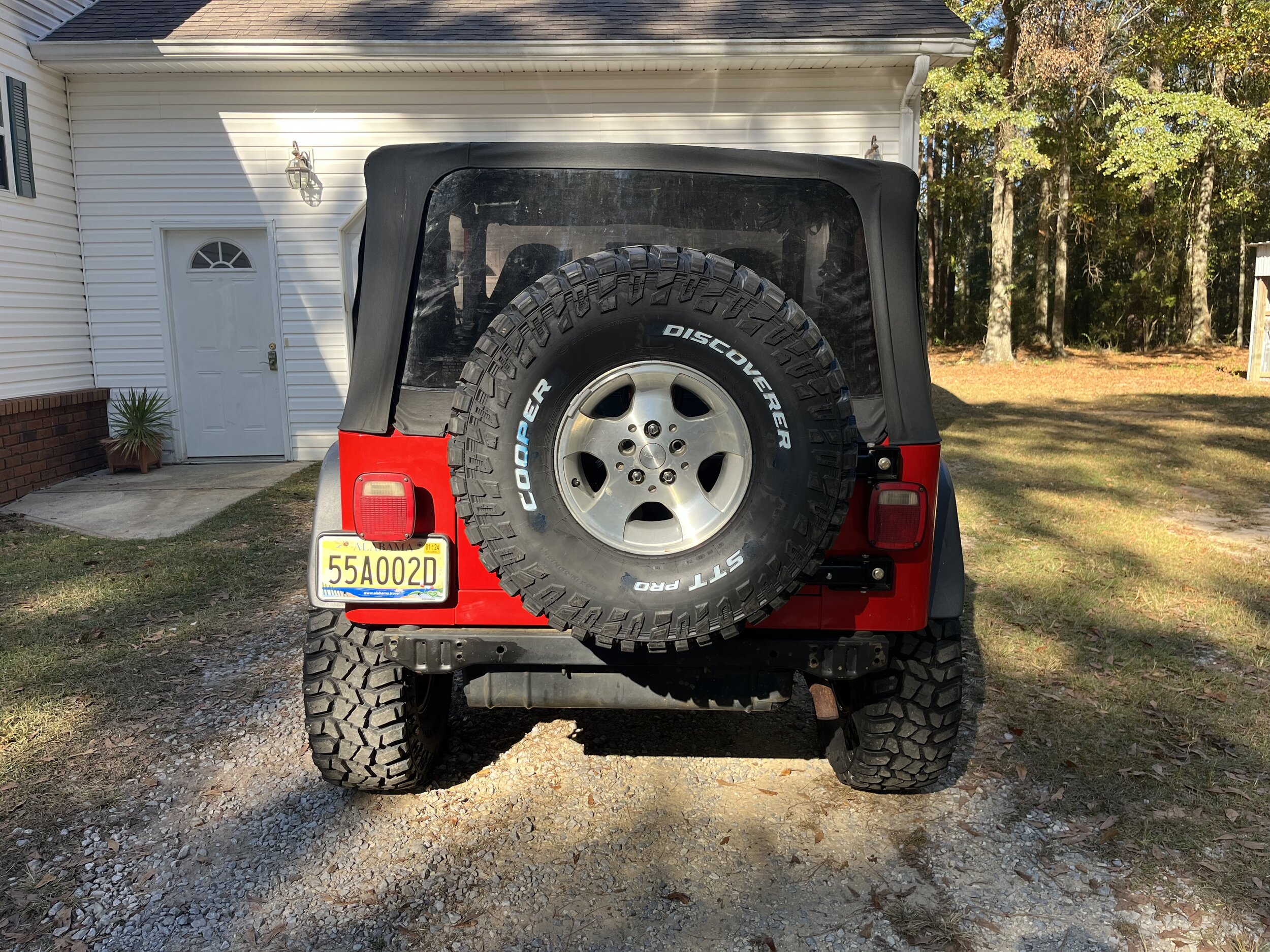

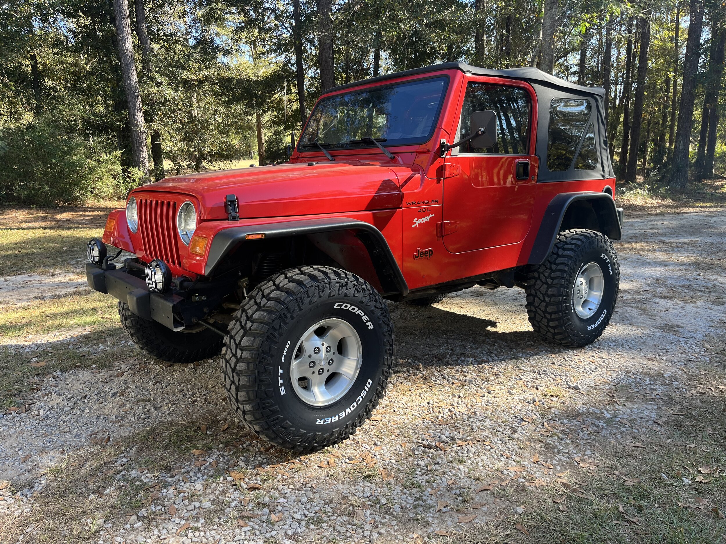

The last thing I really needed to do was get 35s. I let my 33s go bald since they were aging anyway and a year later purchased some Cooper STT Pros. Here is the jeep today:
(Highly recommend Rustys Tire Carrier)

So the jeep was running good and I was happy but as I said in the beginning, I’ve always loved a TJ with a 4 inch lift and 35s! I began to research this and found @Chris thread about how to run 35s the right way. I didn’t even have an account on the forum at the time but always appreciated it as it was my go to place when I had an issue. I slowly started working my way toward the goal of 35s. I began by picking up a Dana 30/Dana 44 in Georgia with a 3.73 gear ratio out of an LJ. I was going to roll with a 3.73 gear ratio for a while (couldn’t be worse than 33s with 3.07s!) but unfortunately when I got them home and took the diff covers off I realized that the rear end pinion was completely shredded and the ring gear was also in rough shape. The guy I bought them from admitted there was a noise but told me it was a unit bearing on the front
