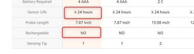

It looks like those sniff testers are single use and only good for about 24 hours once you 1st use it.

OK, the "rechargeable" makes sense with the batteries, but sensor life is listed as "24 hours", and some include 2 sensors. Makes me think the sensor has to be replaced pretty often.
New sensors seem to be $10-$15 dollars. Just something to keep in mind next time you use it, you may need to buy a sensor for it.
Never mind, I am probably over thinking it. I am thinking 24 hours after you open the sensor it expires, where it is probably 24 hours of use.
