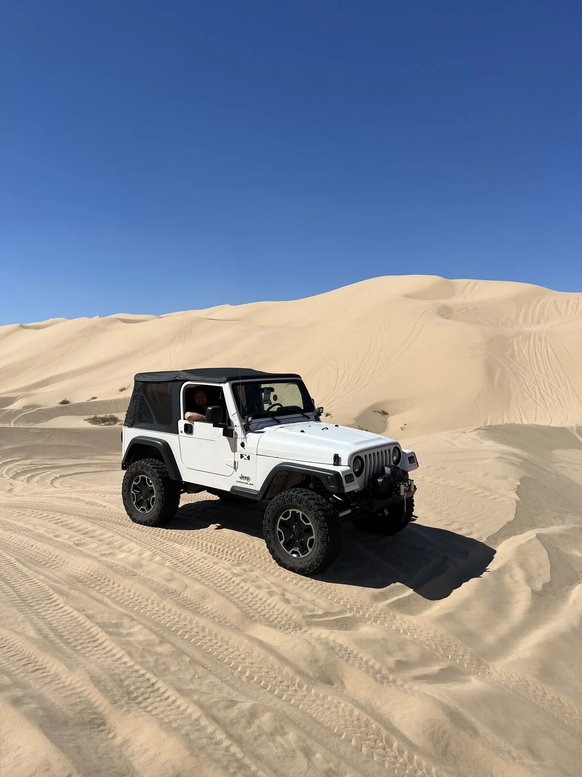

A picture of my dad in my TJ^
Anyways, I've owned my TJ for about four years now. I've been very meticulous with it and one thing I could never get right is the ride. I am currently running around a 4" short arm RE lift with the rancho 5000X shocks. This lift came with the TJ. I have the tires at 27psi. I daily drive my TJ and if I want to keep it for years to come I'd like to address this. My Jeep is light with a soft top and aluminum rear bumper.
Should I outboard and have shocks valved? Should I buy a long arm kit?( Haha kidding) I've followed Nick's yellow jeep build thread and saw Mr Blaine outboarded his shock towers and valved fox shocks. Would that be my best option?
