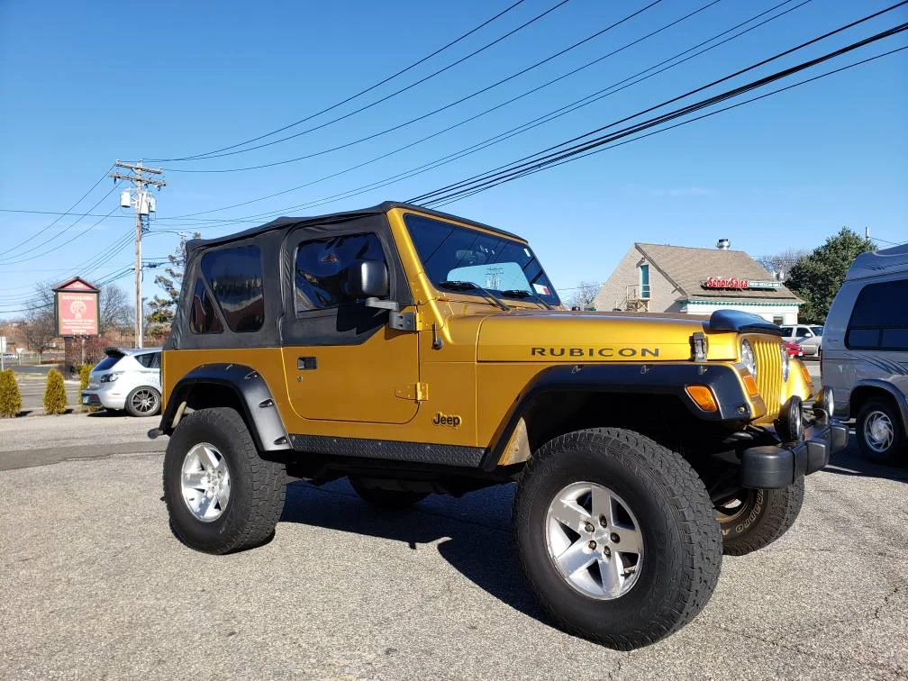

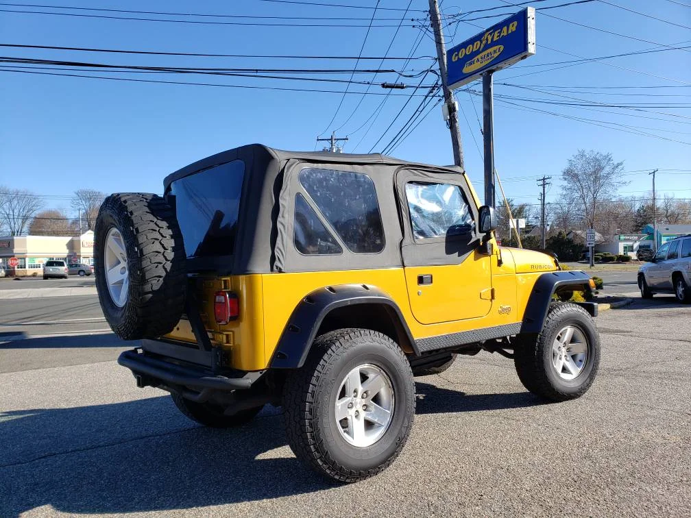

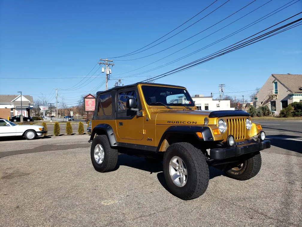

So this will be the first time I’ve created a build thread on any forum I’ve been a part of. Mainly because I’ve never invested so much effort into a vehicle before. I didn’t start repairing/building with having this thread in mind, so pictures up until now will just pretty much consist of what the ‘after’ looks like.

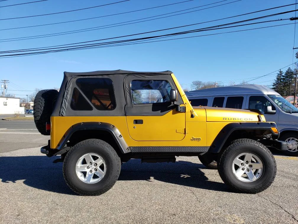

I’ll start by saying that this is my first jeep, and I’m glad to have purchased a tj. This is a 2003 Rubicon in Inca Gold Metallic, 5 speed. LOVE IT. Had some cheap 4 inch lift on it when I bought it about two months ago. Bought it at 103k miles for $10,750. It had been sitting for about 18 months, and definitely needed some love and attention. I took it to my buddy’s shop, and he gave it some life and got it back to a good point to build on.
Until I get some better pictures, here is what the Jeep looked like the day I brought it home.

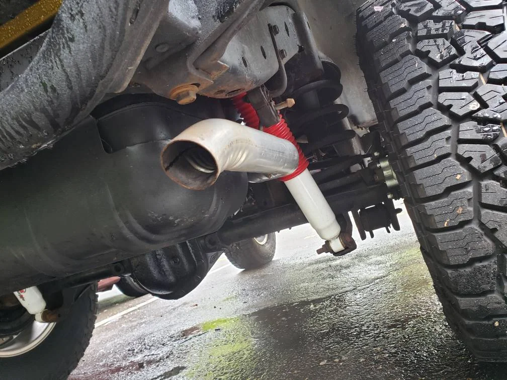

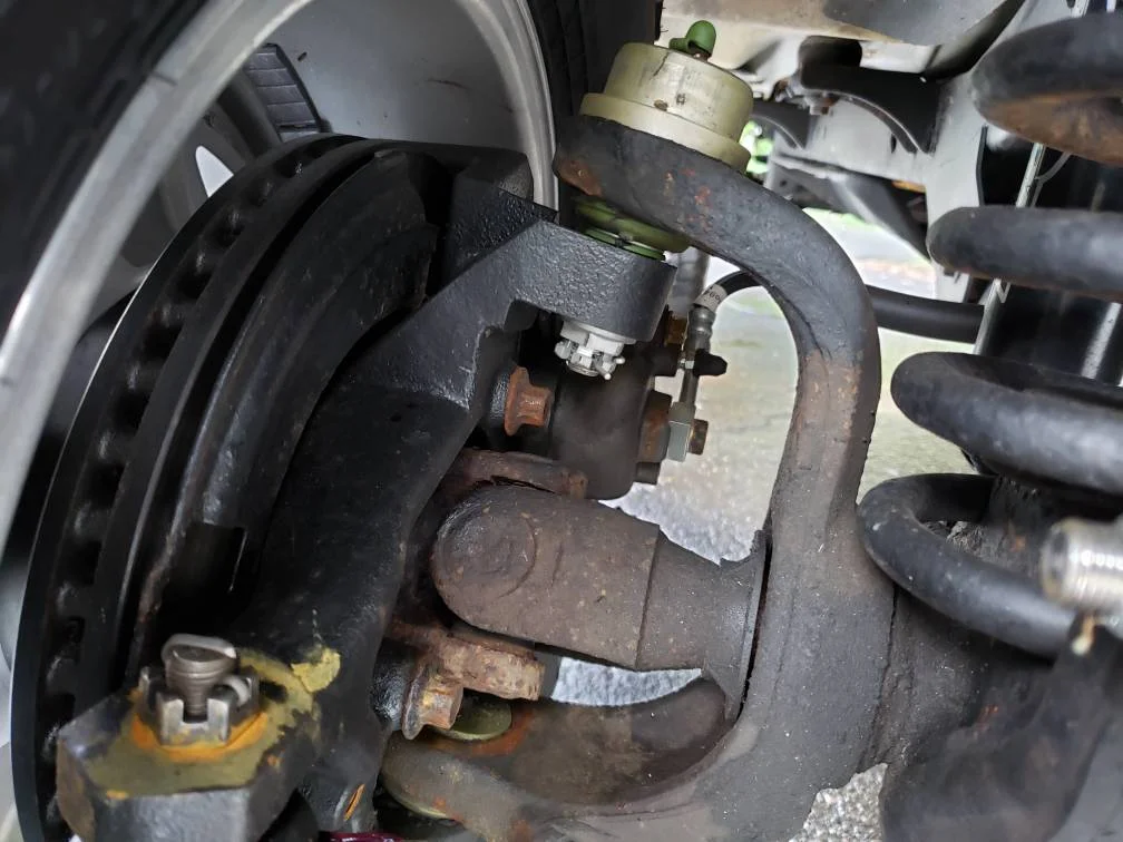

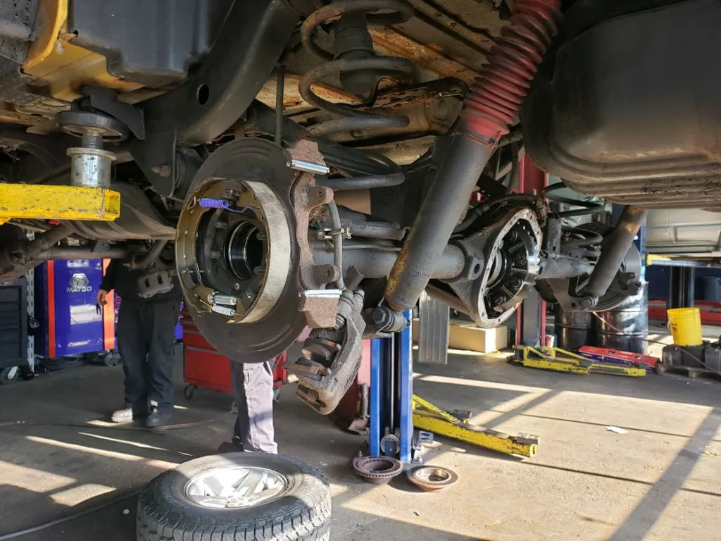

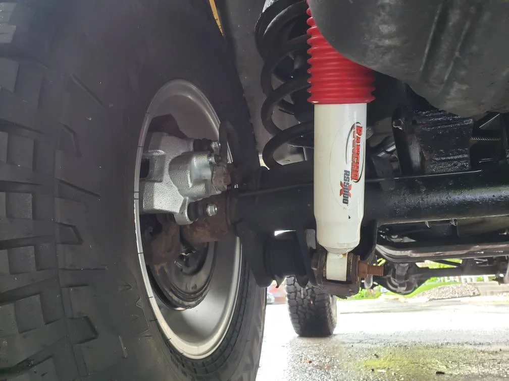

Some of the initial repairs included new brakes all around (rotors, calipers, pads, and lines), all 4 ball joints, passenger rear axle seal and new driver rear axle shaft (not pictured),

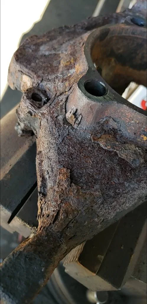

Replaced both driver/passenger steering knuckles
New driver/passenger parking brake assemblies

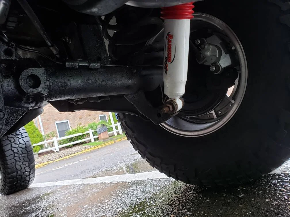

New Rancho RS5000X shocks for the rear

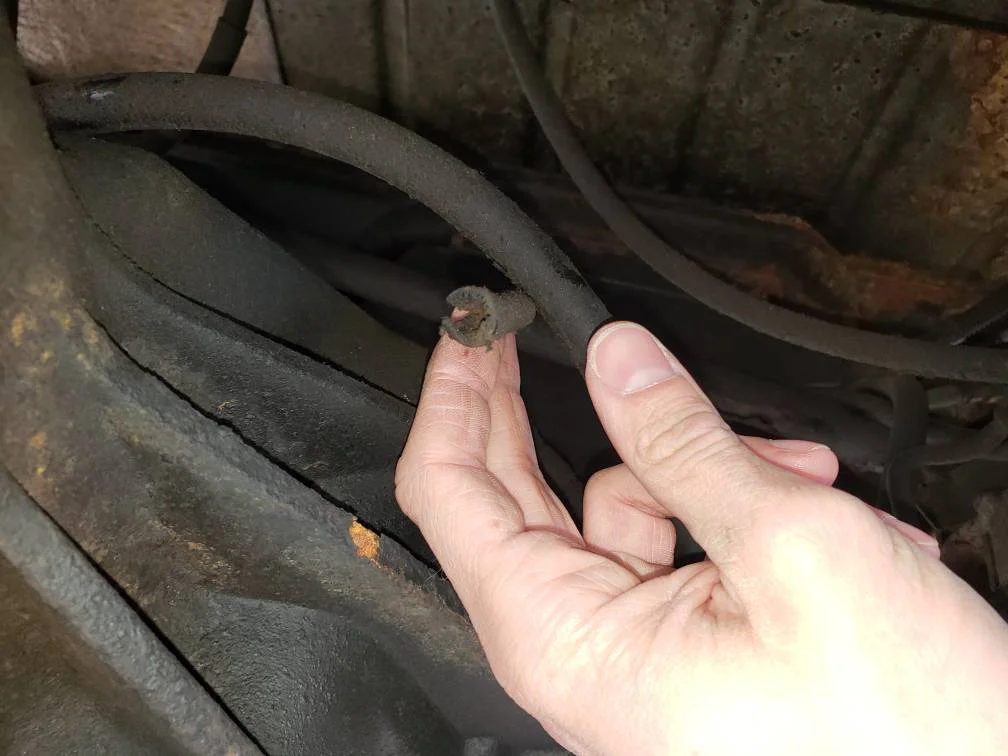

Found/repaired an evap leak

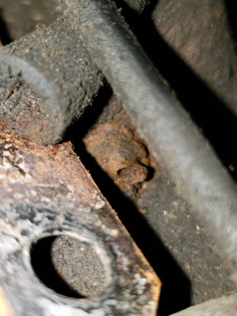

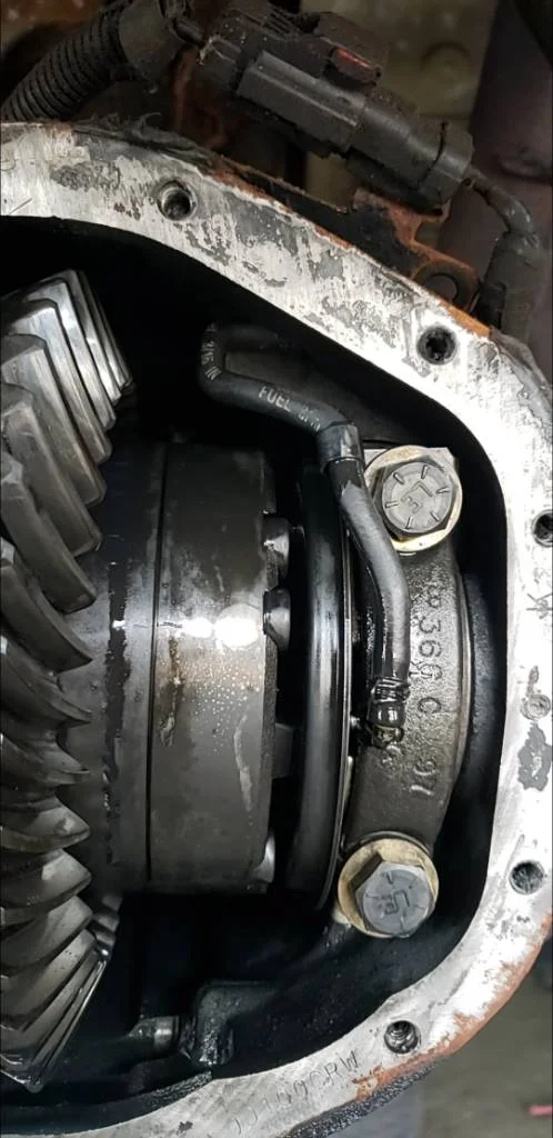

Realized the air fitting for the locker going into the rear diff was rusted and broken off, so replaced that

Love that color. My son wants an Inca Gold TJR when he grows up. Good work so far! I'm glad those are not Rancho 5000 shocks, but 5000X. The X makes a big difference! You wouldn't want the 5000's

@JMT Thanks for the compliment and the heads-up. I didnt realize there was a difference. I'll edit that post.

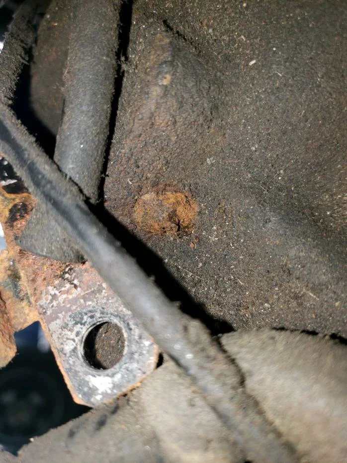

Whats the story on the jeep? Those knuckles and axle rust are intense but the frame looks spotless from what I can see. Im with everyone else, love that color!
WELL. Carfax shows it went a whopping 180 miles in about 18 months (according to inspection mileage on carfax). Theres definitely surface rust on the frame rails that the PO spray painted, but nothing that seems to be too concerning. I eventually plan on tackling one section at a time sanding/scraping it down and repainting. Skid plate was removed without braking any of the nutserts free, so inside shouldn't be too bad.

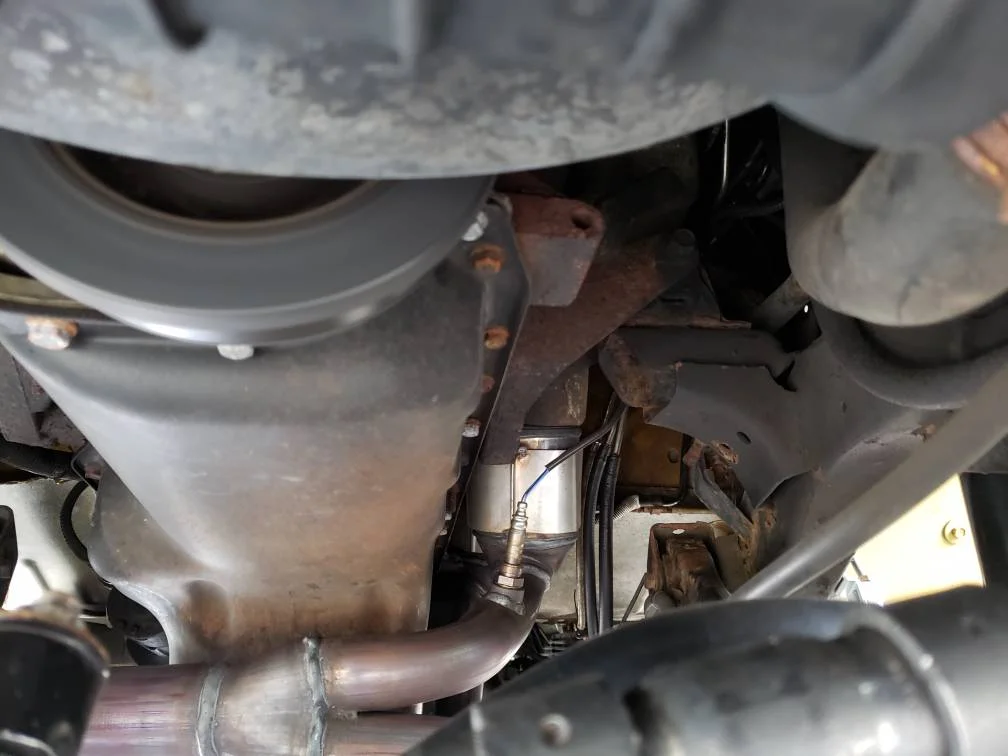

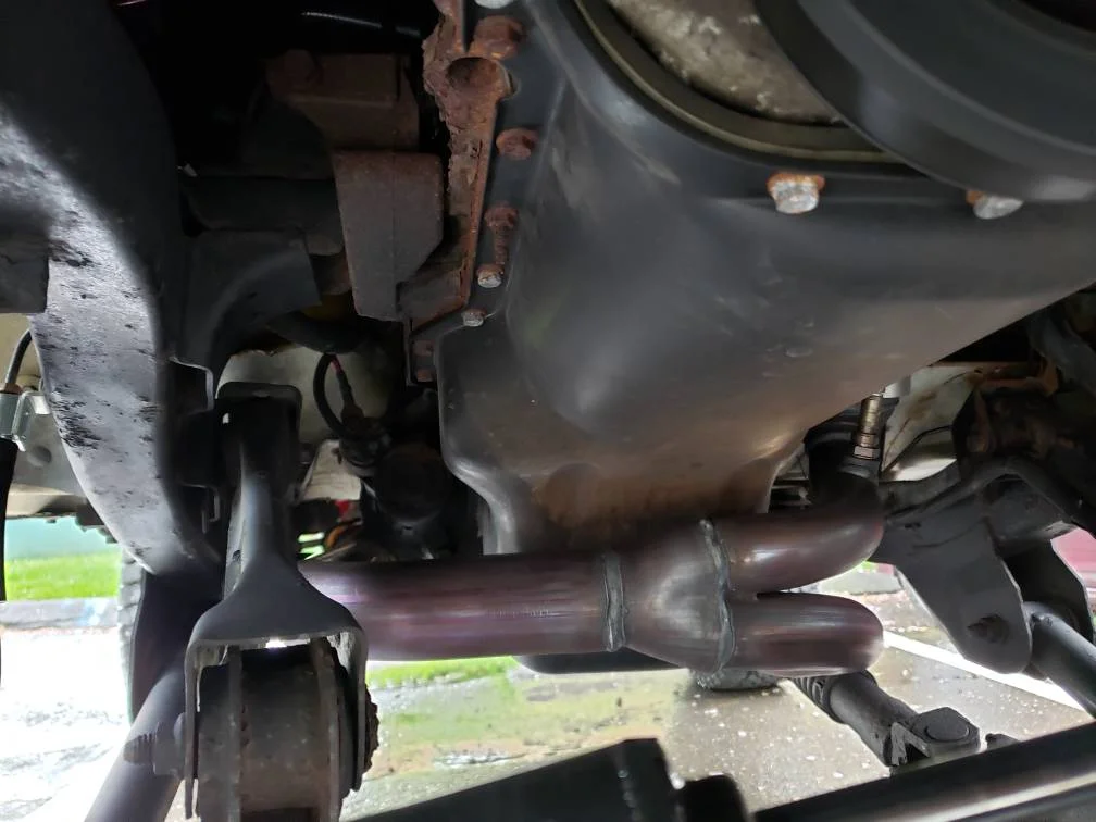

So after all of that, CEL P0432 popped up. O2 sensors looked good, so I played with the idea of installing a new downpipe and third cat since they were probably not in great shape at 103k miles. Ordered in an Eastern Catalytic downpipe with third cat. After loosening the pre cat bolts up to the manifold, we realized that the exhaust manifold was loose and cracked... and one of the studs was broken off in the block. Also soon realized that the muffler after the third cat was held on by rusted bolts without any nuts LOL. So on when an entire new exhaust with new O2 sensors. Not sure about brand of the muffler and manifold (my buddy got them in same day from his supplier).

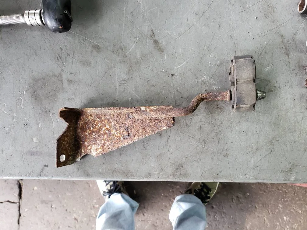

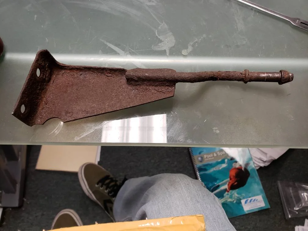

Muffler hanger was broken.
It was fun trying to track down a replacement. Found some used rusted POS on Ebay for $11 since I couldn't find a ‘new’ one. This is before I sanded/painted it.
