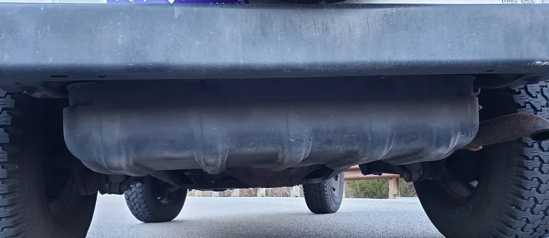

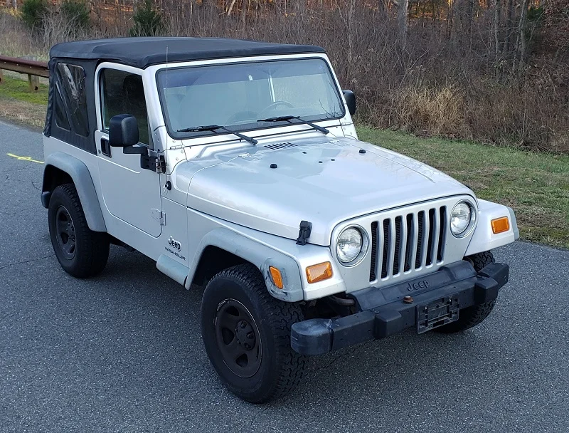

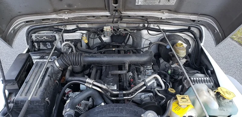

I picked up this bare bones Sport for a very good deal. It has has 180K on it, but is 100% rust free. After bringing it home, here's what I found wrong with it:

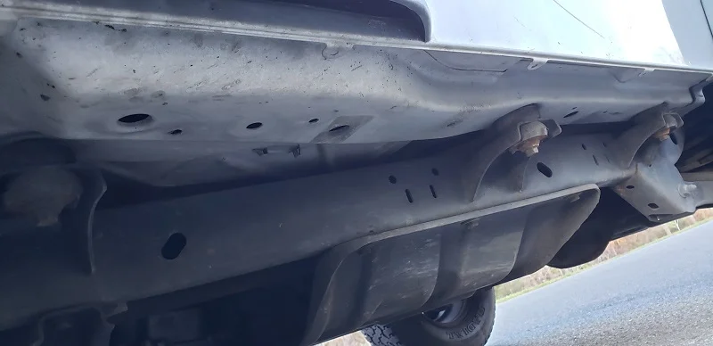

- front pinion seal is leaking badly and there's a growl coming from it (Needs a pinion bearing and seal)
- has a P0135 code (The OBDII connector wasn't working when I got it, but I cleaned the plug and was able to read the code)
- rear main seal is leaking (slightly)
- valve cover gasket is leaking
- rear pinion seal (Dana 35) is damp
- u-joints are all original
- jack and jack accessories are missing
- rear seat belt is broken
- both visors are missing
- washer bottle pump is inoperable

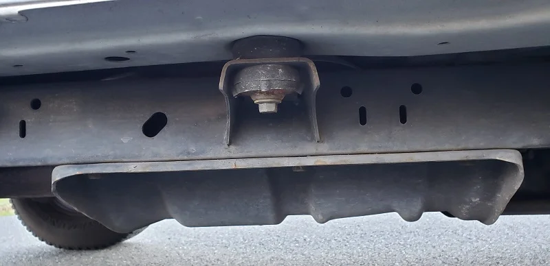

- battery tie down is missing (you can see where the + terminal contacted the fender a time or two!)

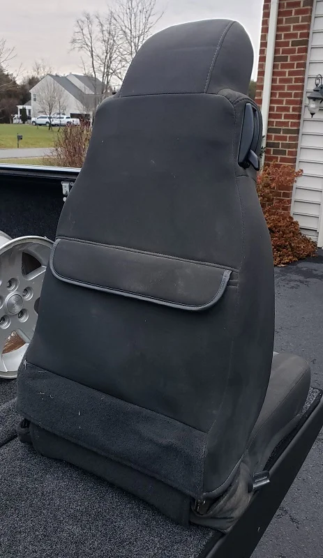

- driver seat is worn/torn
- bad blower motor resistor (Fan only works on high speed)
- soft top is done
Other than that, it runs and drives well. It looks like the cooling system was recently replaced, as well as the alternator. Also, the 42RLE appears to have been rebuilt back in 2012. Given how absurdly rust free it is, I'm going to build this one based on lessons I've learned from the past. Per the title, the theme will be keeping it light and nimble. Since I plan to drive this daily, tire size will be limited to 31".

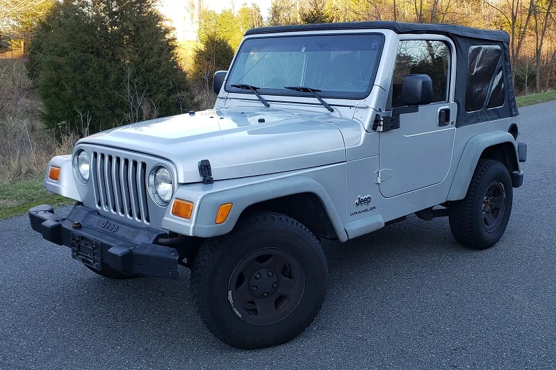

As for the Jeep, here's what it looks like now. The only real options are A/C, full doors, and automatic transmission.
