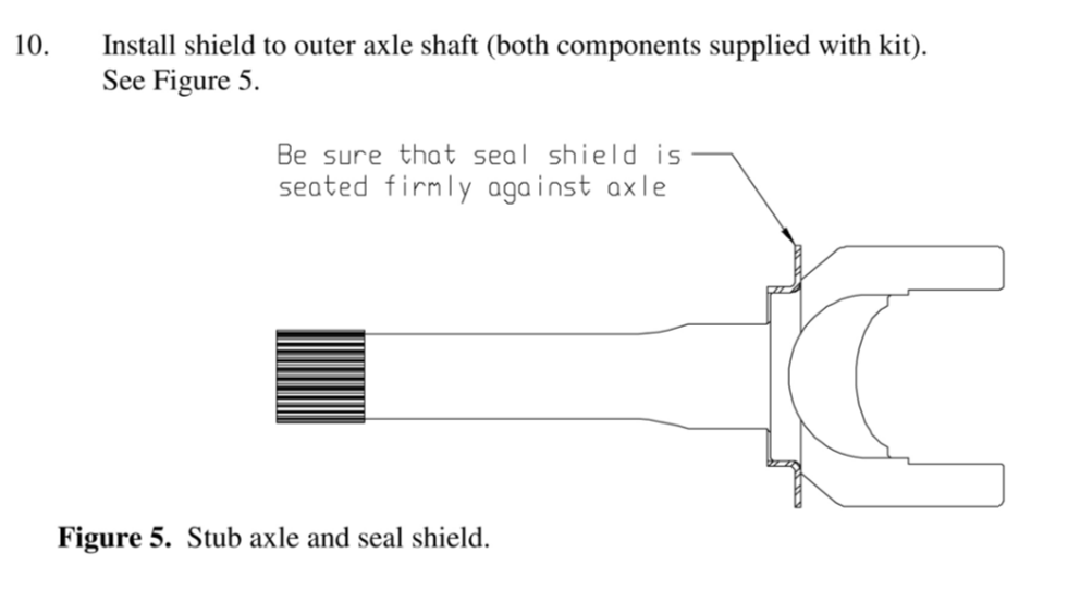

I was able to get all the studs in, but that outer axle shaft dust shield is totally defeating me. I had to stop before I broke something. How did you get them to go on?
If you're talking about the rubber shield, I fought that one too. When I first tried installing it, I greased it and it kept popping off. I pulled it apart, cleaned all the grease off, then installed it dry. It went on easily, and stayed on!
I’m talking about the metal shield, the very first thing that goes onto the outer axle shaft.
I also tried greasing it and now I’m thinking that may be counterproductive. It keeps popping off.
Yep, no reason to grease that when installing it. Mine went on, but did take a little coaxing. If yours is a tight fit, meaning the shield is smaller, you could try heating it up before installing it. A MAP gas or similar torch will make quick work of heating it, or, if you don't have a torch, heat it in the oven at 400° for about 15 minutes.

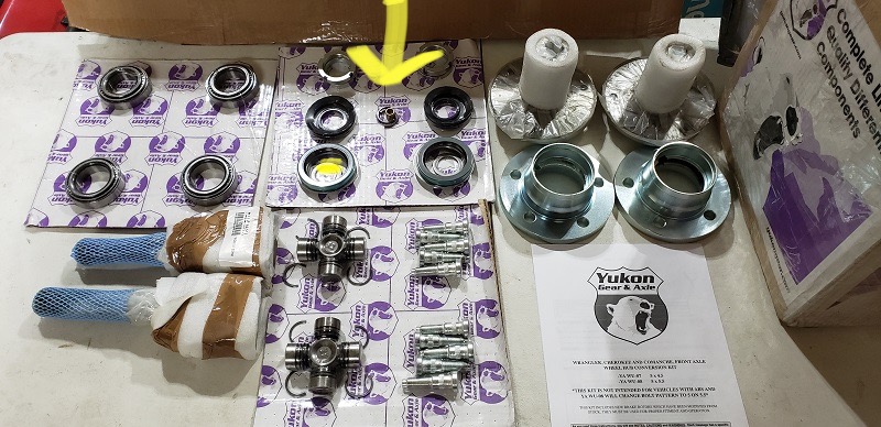

Check your parts and part numbers before proceeding.
Your picture of parts has a couple that mine doesn’t have. I added a yellow arrow below and then yellow highlighting in the section with the hub seal.
In mine that little section with the hub seal only had the seal and the dust shield. It looks like there is another washer. It kind of looks like this one in another picture you posted:
Now the middle section under the yellow arrow has what looks like that snap ring, but it also has another part that I can’t make out. It sort of looks like a brass cylinder about the diameter of a finger. What’s that called and what it for?
The small brass piece was not used. I called Yukon to verify and they had no explanation of what it was, but did confirm it wasn't needed.
These parts you should have. They are the last two parts to go on, before installing the hublock set (Hub body). There's a grove on the end of the stub shaft that the snap rings goes into. To get it to fit, I used a small pry bar (with light pressure) to push the whole axle assembly in. Once that was done I could see where the snap rings went.
BTW, did you get your dust shield installed?
The shields are on. There was nothing elegant about how I got it done. It involved some heating, sanding, 2” PVC pipe as a driver, various hammers and a big rubber mallet. Oh and also channel lock pliers.
interesting that after heating them up they were slightly different colors.
I went back to the seller for these. Just curious - do you know if there are other part numbers these are known by, or if replacements for these might be available locally? I tried searching the part numbers shown in the instructions but only found a discussion from an old Ford ranger forum talking about getting them from a junk yard.
Local Ford dealer can get equivalent parts for a 97 Ford Ranger (FOTZ-3B458-A and FOTZ-3B457-A) but they are overpriced (~$80 for two sets) and will take 3 days to arrive. Much cheaper options online.
But I did speak to the seller, just waiting for Yukon to send the tracking info for the missing parts, should be here in a few days.
Edit - just received tracking info, delivery is tomorrow.

They forgot the spindle washers again! At least I got that useless brass spacer.
I've had a rash of bad parts luck lately, so I feel your pain. Thankfully, the Jeep is only a toy, so I don't let it get to me.
Reactions: khakitj
If you have a HP 30 disconnect axle with the vacuum shifter, that spacer is not useless. Surprised Yukon does not know that.
Thanks! Now I see that it is shown on the last page of the instructions under the optional vacuum actuator section.
I guess it's like everything else, it depends on who you talk to. When I called Yukon I was told they didn't know what it was, and that it was likely a packaging mistake. Good to know what it's really for. Now it won't be nagging me that I left something out!
