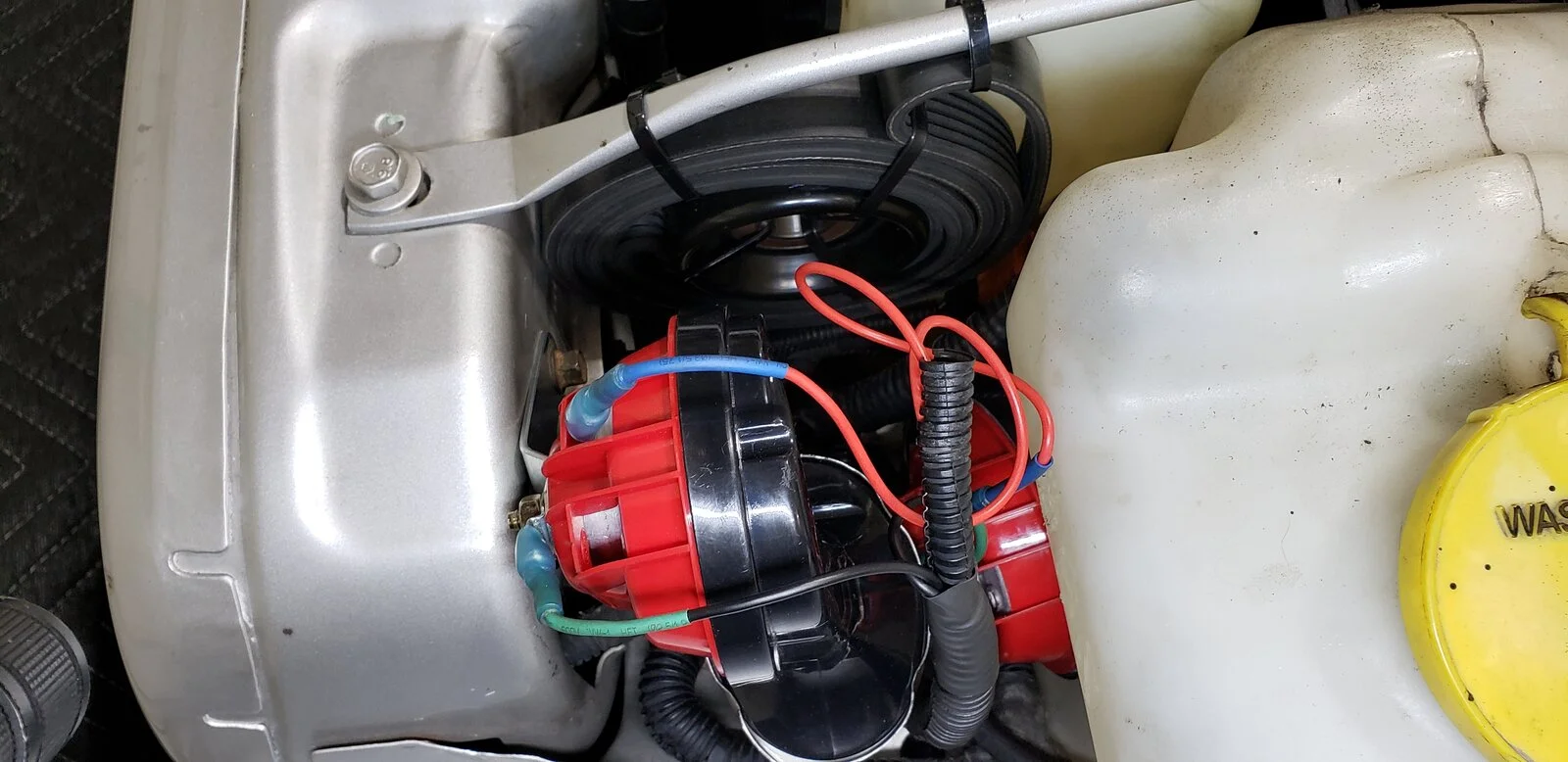

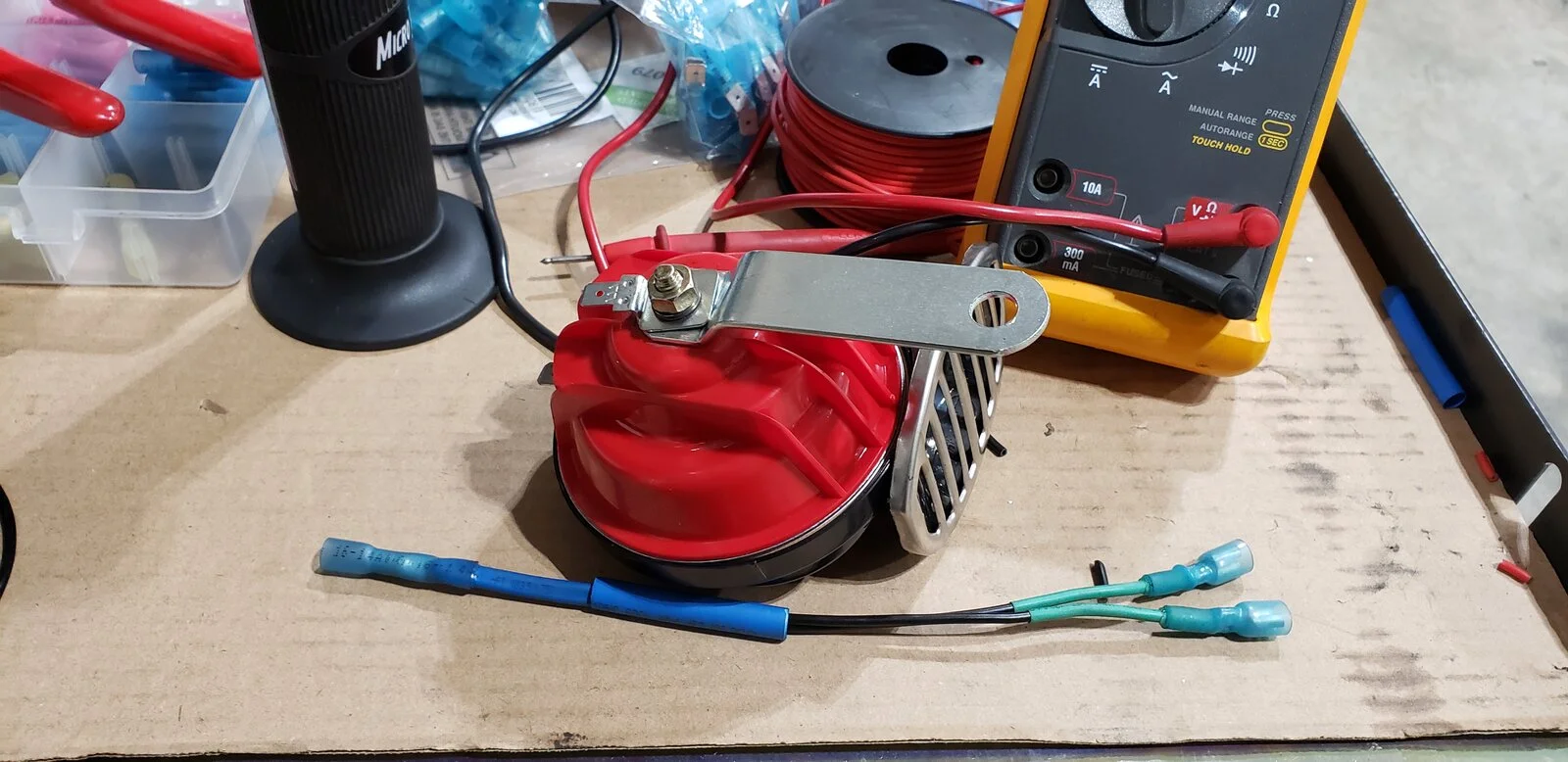

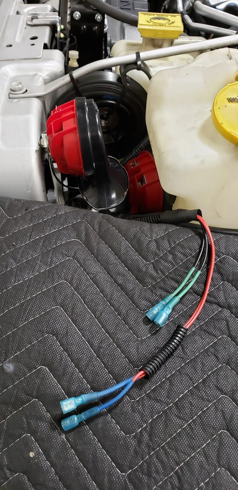

I'm pretty sure these new horns have been with me since the mid 80s. They're made in Italy and are very loud. They make a good replacement for the anemic single horn I had and I didn't have to go buy something else. I thought about throwing these out multiple time, but kept telling myself..."I'll use these one day!".

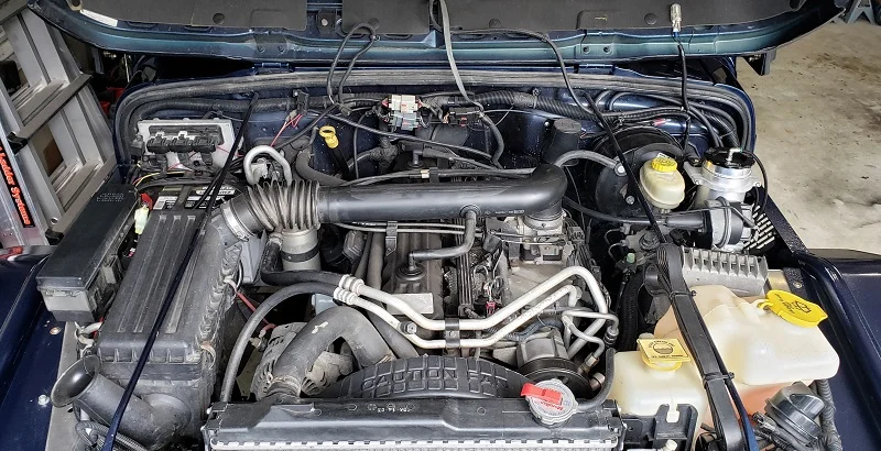

I also installed a spare fanbelt and idler pulley, which I roll up and attach to the hood support rod.

I've carried one for years, seen on the driver side support rod, on my LJ. It has come in handy twice on the trails in the last ten years. Once for me, once for someone else.

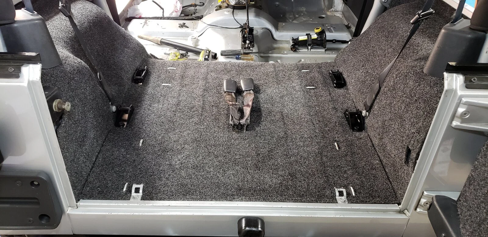

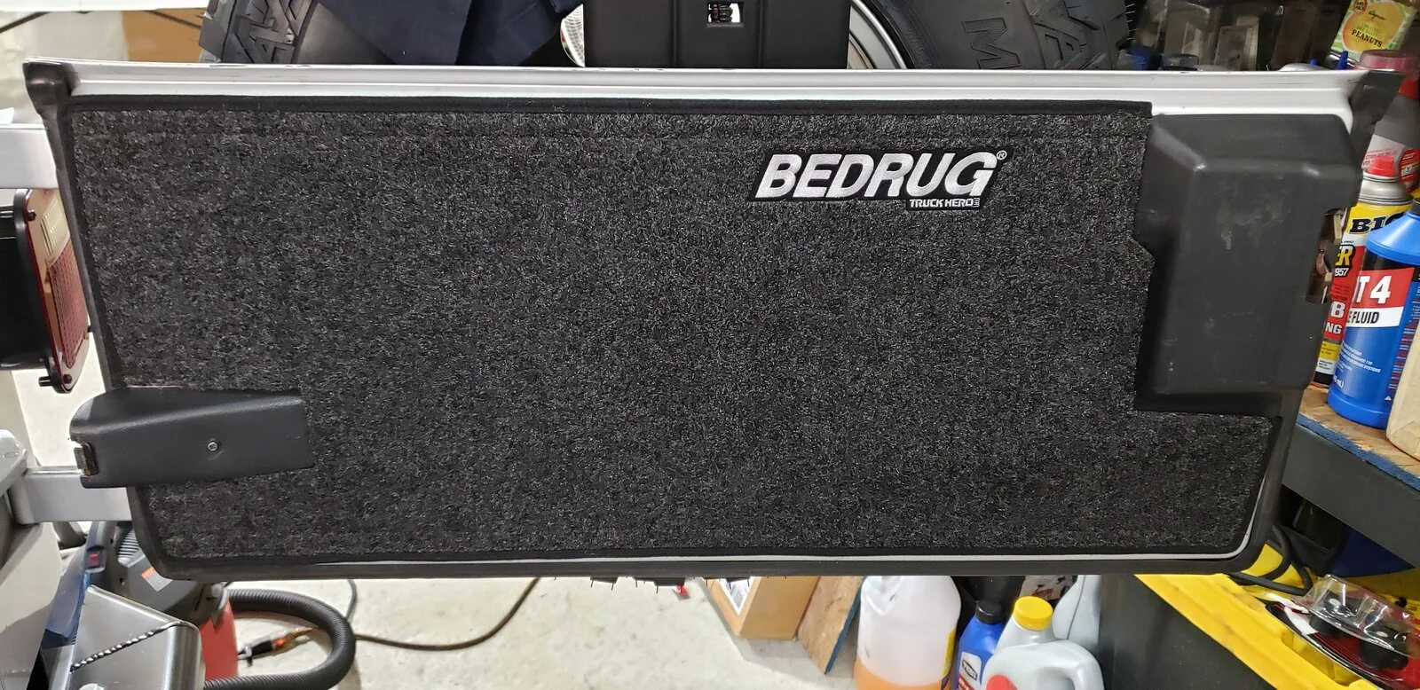

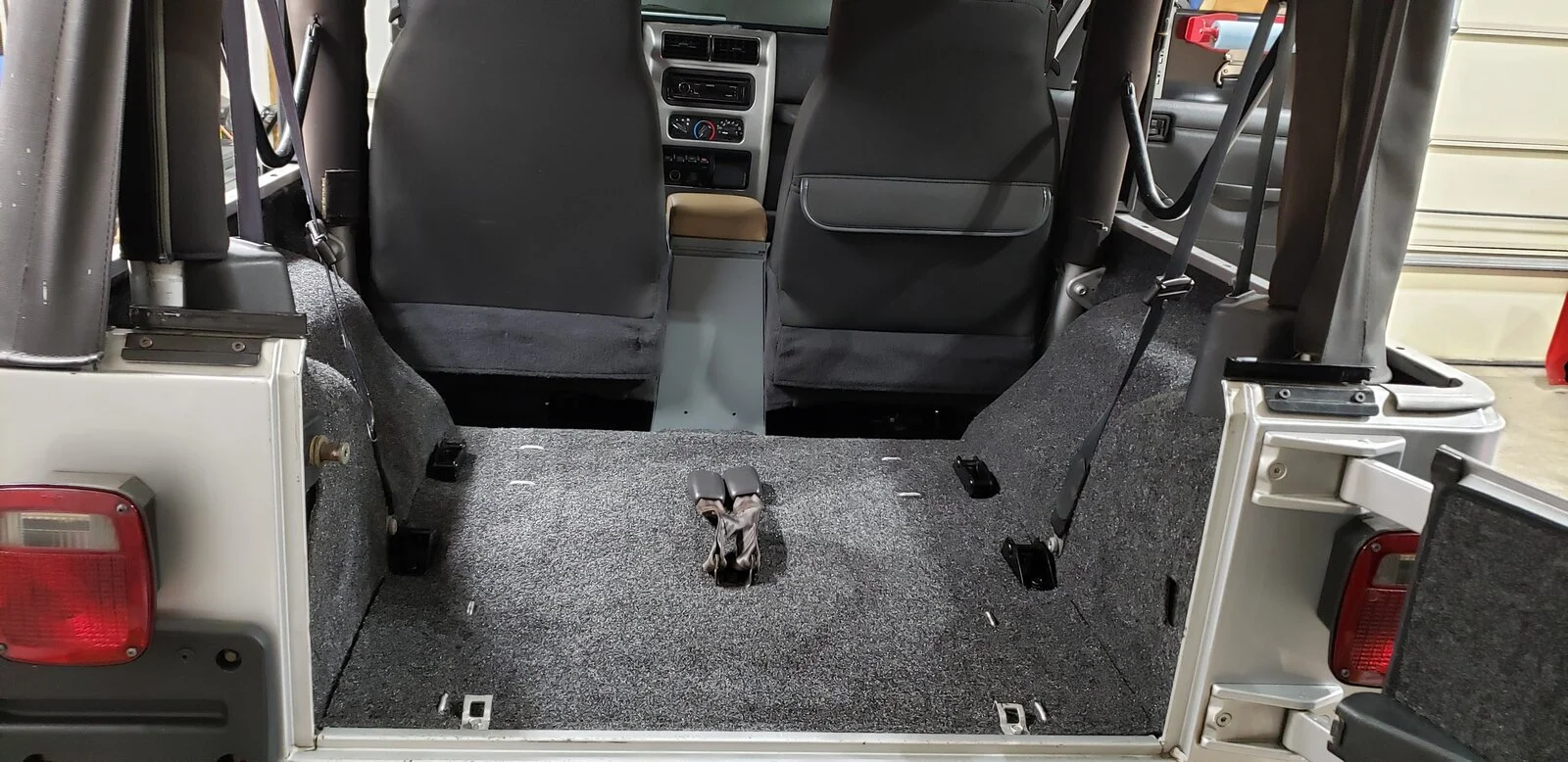

The rear seat/cargo area has been cleaned up and the Bedbug installed. I've done at least 6 or 7 of these and really like the fit and functionality. Not hard to install either.. Of course everything has to be cleaned and painted, that can be.

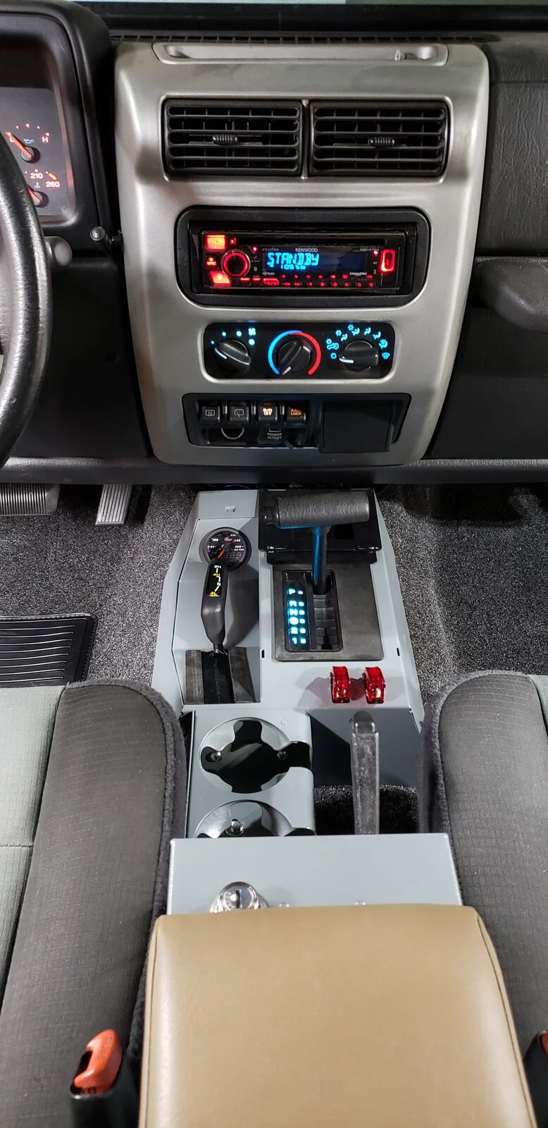

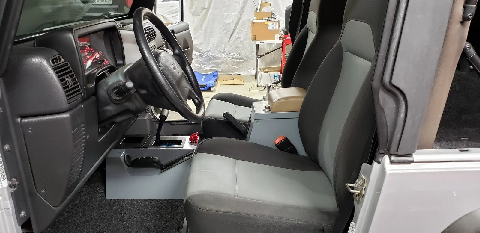

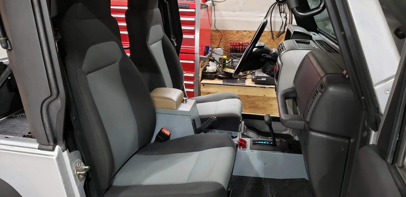

Knocked out the remaining big stuff on the interior:
- Front BedRug
- Tuffy underseat drawer
- Tuffy center console
- Washed the seats I picked up cheap (they're in amazingly good condition)
- Wired in the locker switches
Since the console was originally tan, I had to paint it grey, but still need to swap the tan arm rest out. I bought some material, which will be used to sew a replacement cover. The last thing that needs taking care of is to finish wiring up the transmission temperature gauge.
