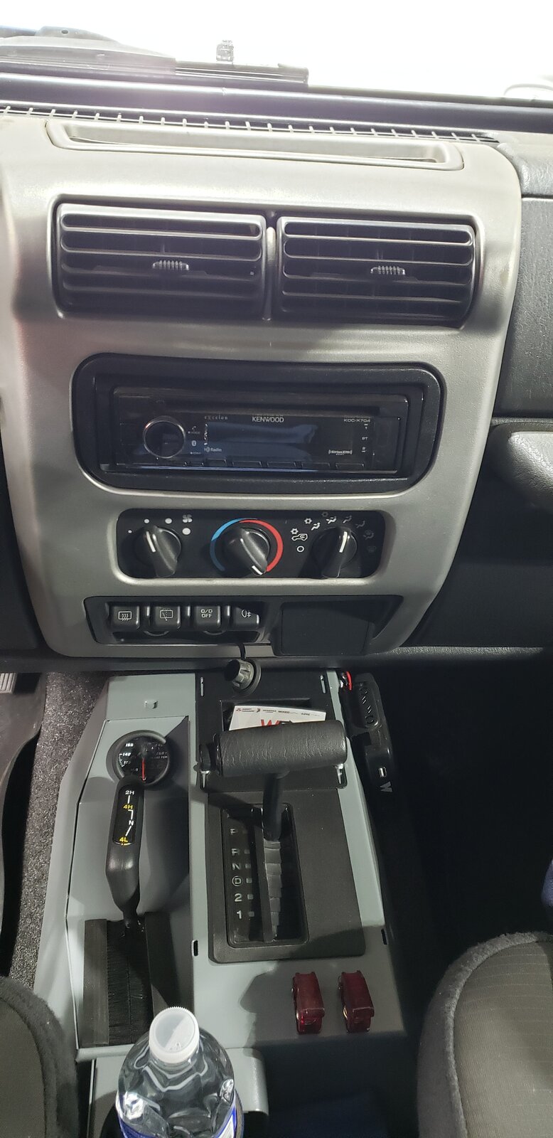

Very interested in your camera placement.

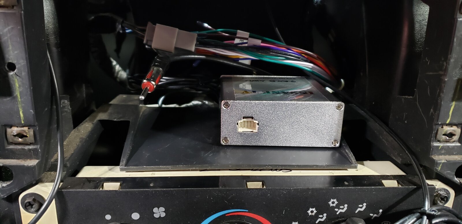

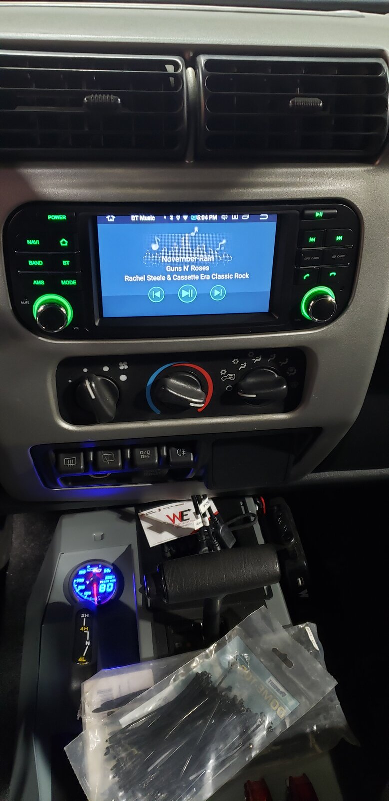

I was able to install the system yesterday, but couldn't work on the camera placement. In order to get them set correctly, I needed to take the Jeep out of the garage, to get a more accurate camera view, and it was just to cold! Although I installed the TV feature, I wasn't able to get it to work. There was a note in the instructions that said a software update may be needed, so I'll call their tech support next week. Overall, I'm impressed with the unit, which is packed full of features. I'll need a while to go through all those!
FWIW, the TJ1002 unit is really a single DIN radio with a double DIN face. As such, it fits in the stock dash bezel. An aftermarket double DIN bezel will not work!
You do have to be careful about bundling the wiring. There are a lot of connections and wiring, which space becomes a premium. That said, it does fit and it worth the effort and expense. Although I didn't get to start and run the Jeep, the gauge customization is impressive!

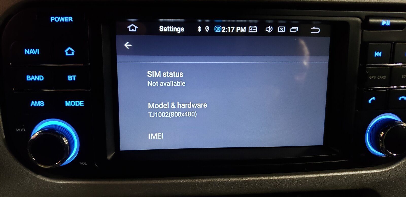

Thanks for the info about the shocks. If you go into settings on that radio and into the about page at the bottom does it mention 8227L or alps? I've been curious about what model insane sells and they don't publish it on their site.
Reactions: Irun
I'll check later and see what's listed.
Have you checked their forum page? I can't wait until I finally get to apply power to mine. I'm sure I'll be months before I know what even 1/4 of that radio can do.
It looks GREAT BTW.

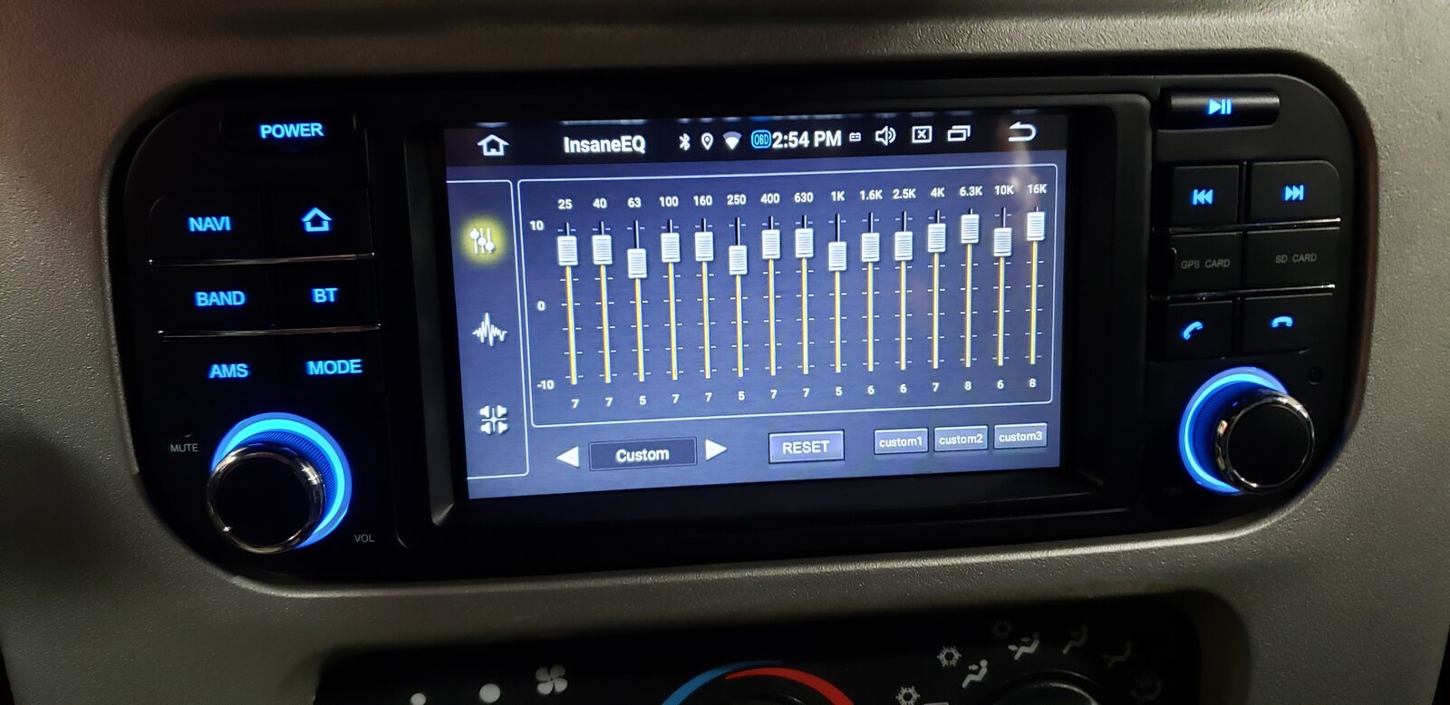

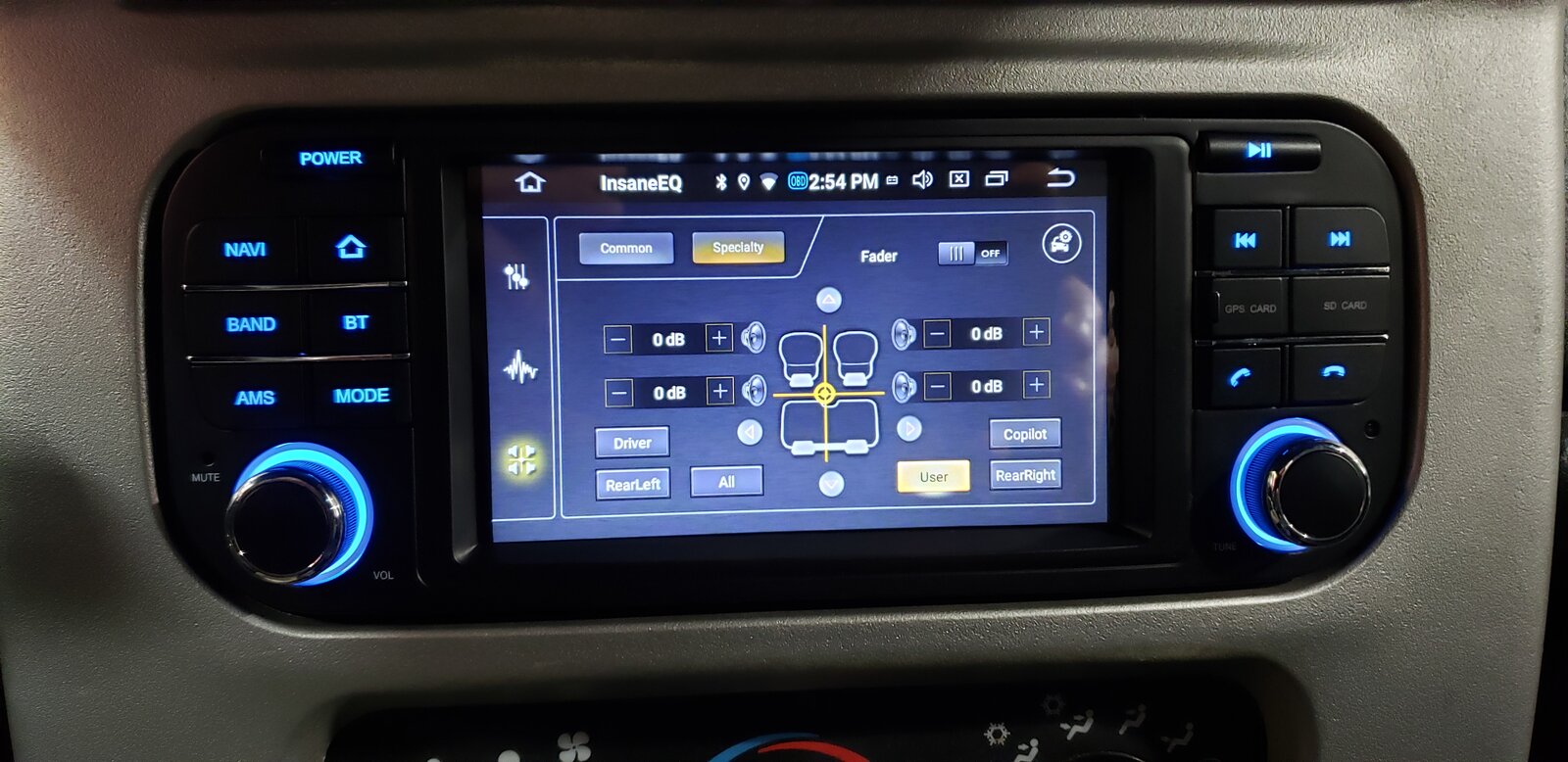

Sound quality out of the box is so-so, but after playing around with a feature rich equalizer and sound settings, I'm happy with what's there. That said, it would be even better with a factory subwoofer setup, and best if an amplifier is added.

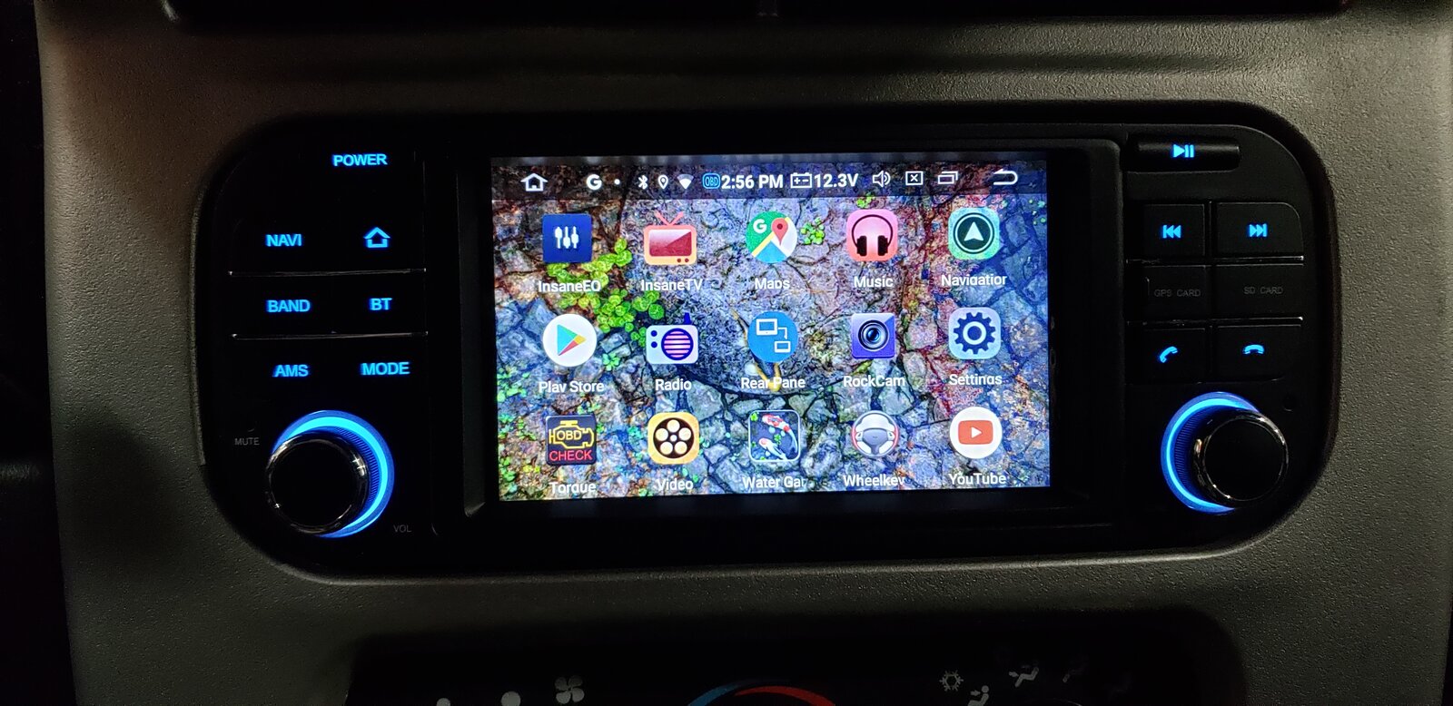

I haven't had a chance to look at their forum page, but plan to as soon as time allows for it. I can say that the price is steep, but once you unpack all the features, you start to see the value. From my perspective, its a very good way to add some modern technology to our "antique " platform, in a relatively simple way!
This is just a small sample of what comes loaded and you can add lots more.

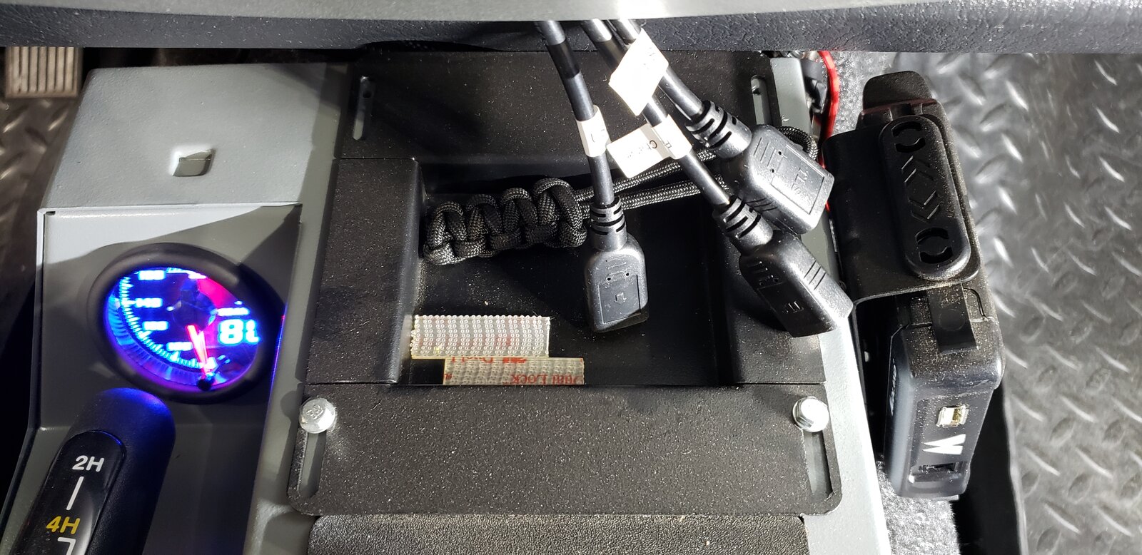

There are three USB pig tails. It will be nice to use one of those for the GMRS radio. In my case I happened to be lucky enough to put my radio in the correct spot. 🙃
