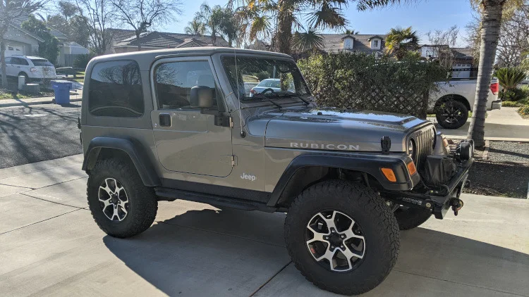

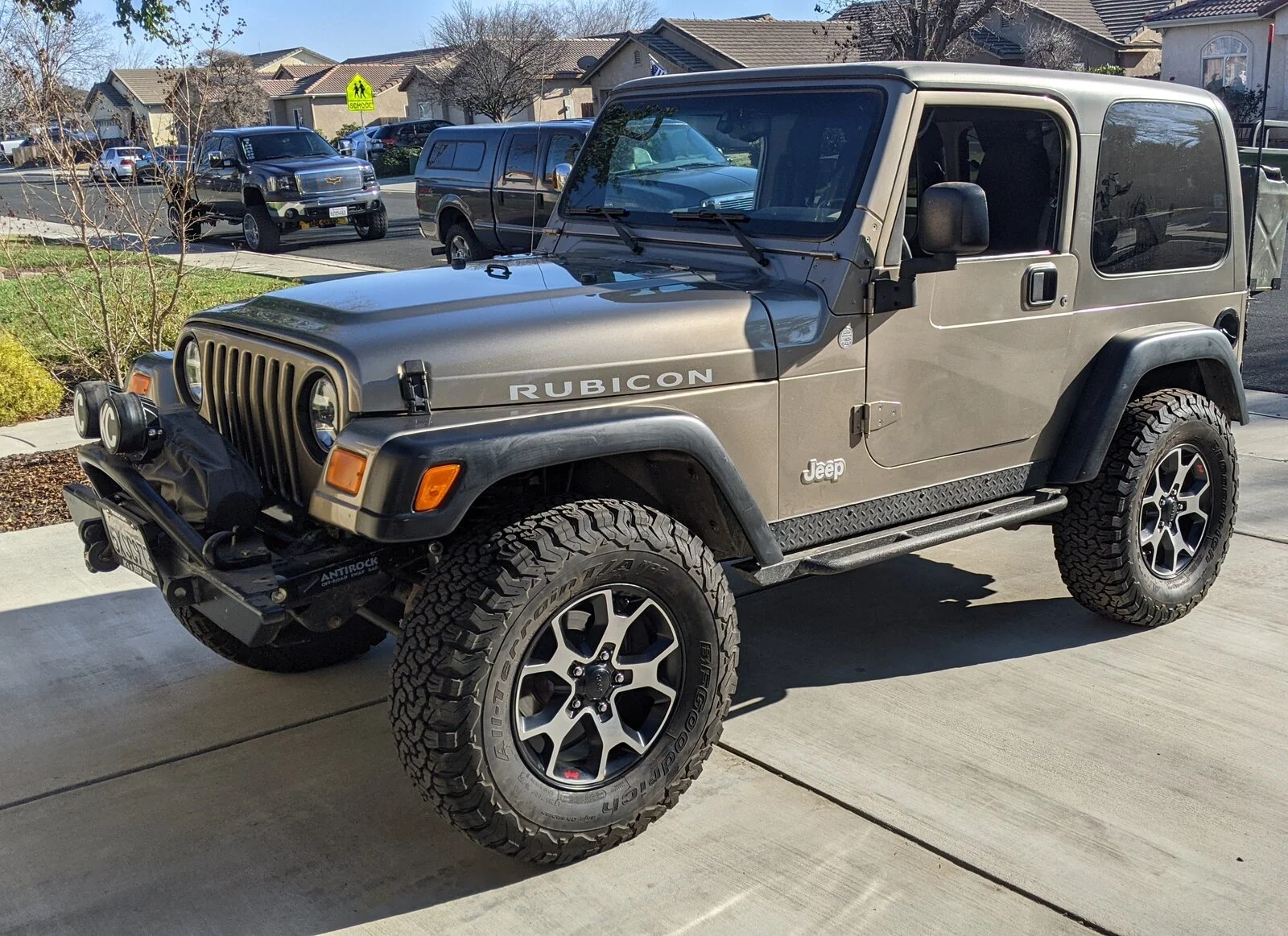

I run the ProComp Springs and have a .75" spacers in front for leveling. I have aftermarket bumpers that would be considered heavy (not Chinese thin crap), a winch and a hardtop. With all that said, I sit level and the lift measures out at 2.25".

Definitely helps, thanks for the data point!
