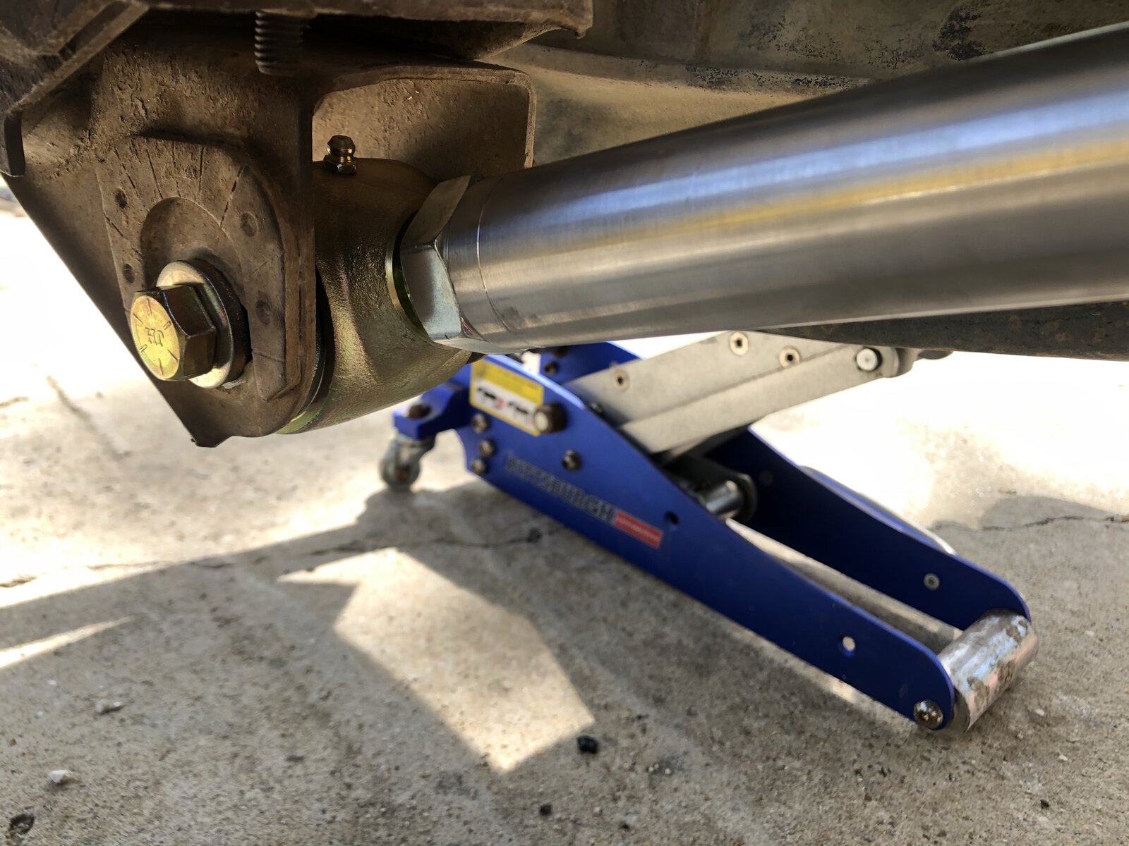

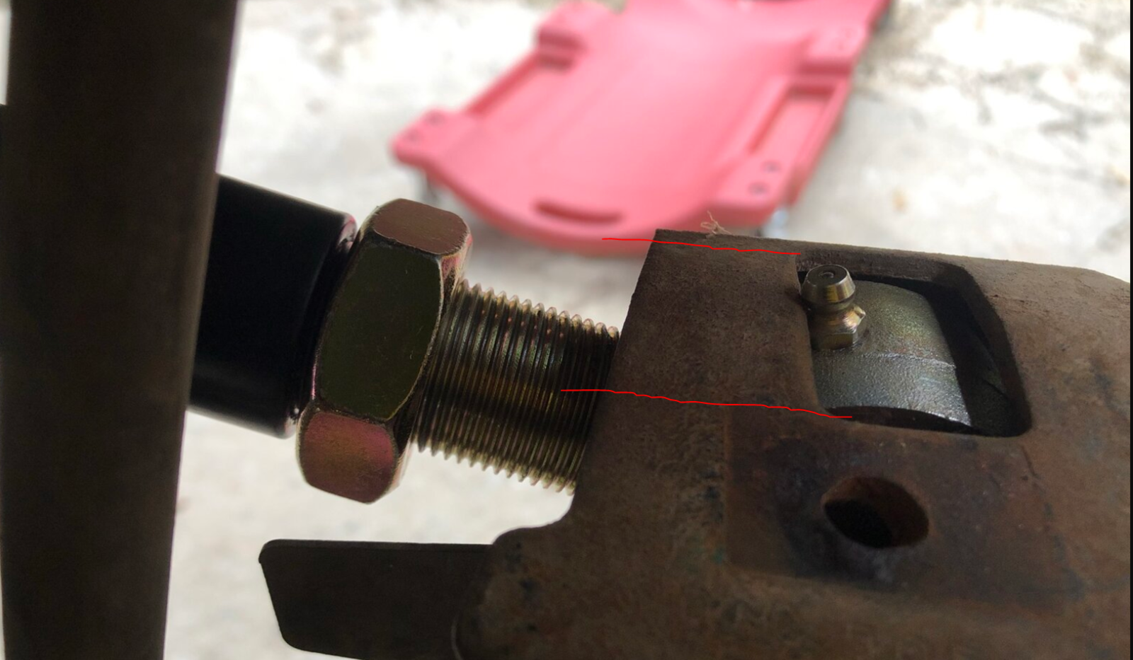

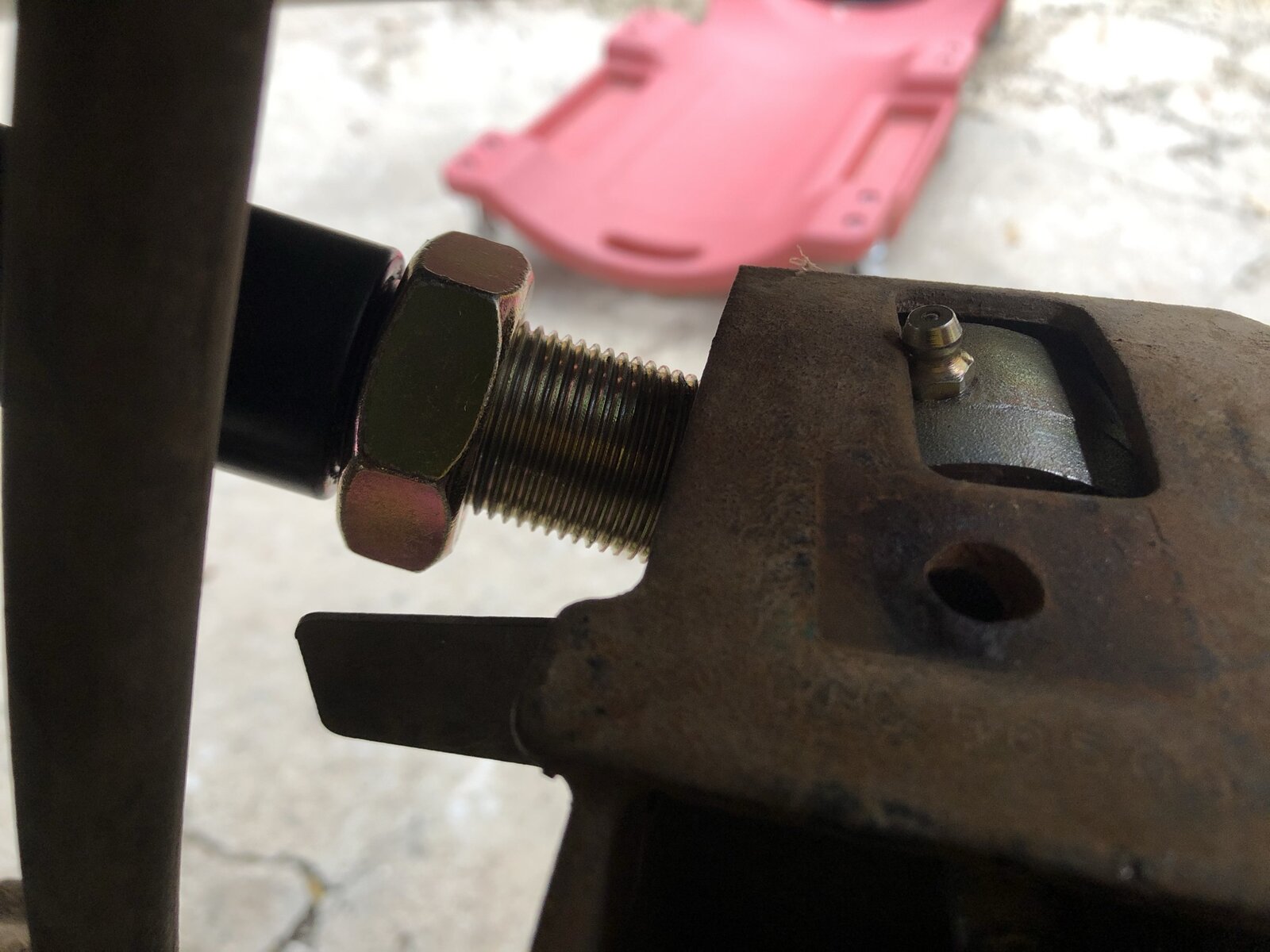

The RockJock rear track bar went in today. I removed the PO's relocation bracket to install it, but I get the feeling that it's not meant to be used with the factory track bar bracket. Under articulation, the axle-side grease zerk makes hard contact against the bracket. And when drooped too far, the threads of the axle-side Johnny Joint bind against the edge of the bracket. Just in case, I'm not going to be doing any crazy flexing until I get the tuck done. I have the angled track bar bracket on hand, I'm only waiting for RWK Haus to ship the adjustable control arms and backordered under armor.
zerk contact on stock bracket
Previous owner's setup coming out
track bar binding on the bracket (passenger side droops lower)

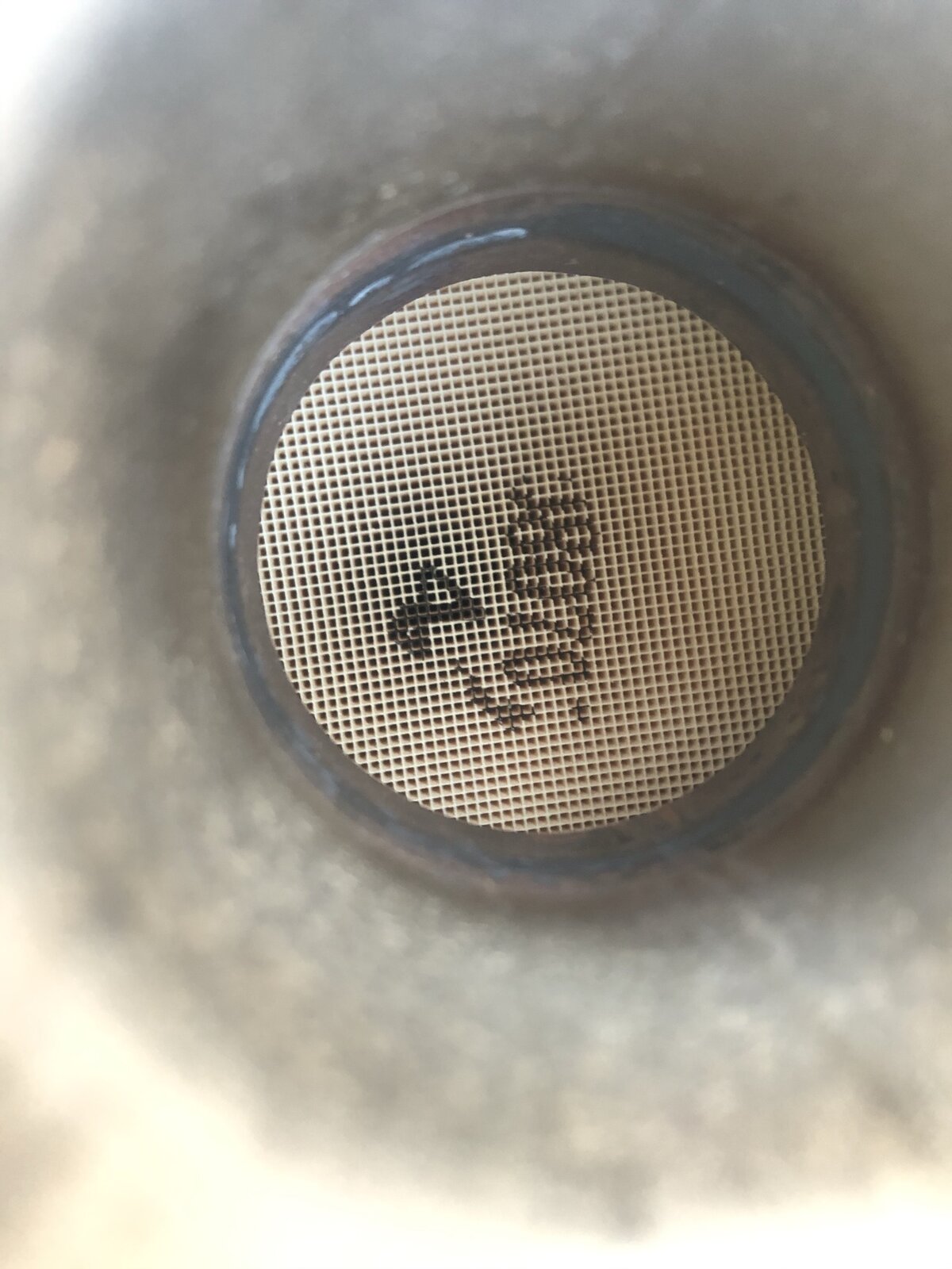

I installed the Flowmaster y-pipe yesterday to combat the P0432 code I've had for a while (Main catalyst efficiency below threshold -Bank 2). And well, well, well, look what I found in bank 2 - nothing! :D
Bank 1 for reference:
And the new Flowmaster pre-cats:
Overall everything went pretty smoothly - a rare occurrence when I wrench. After everything I had read about rusted, seized, and hard to reach pre-cat bolts, I was worried I would have some trouble. Either those guys don't know what they're talking about or I got lucky. I sprayed the bolts with some Kroil penetrating oil per Jerry's recommendation, and let it soak for a minute, and the bolts came right out. They weren't hard to reach, and I don't see why people say they had to remove the fender. I got all of them from underneath with a couple of long extensions. The Flowmaster ones were a bit harder to get a socket on because the heat shields are larger, though.
I've seen others do and personally have cut that little piece of metal between the zerk fittings and the threads in your image, that way your trackbar gets a little more droop before binding, no ill affects in my experience.

I’d just keep the bracket on there. Keeps the trackbar closer to stock angle. Dave Kispaugh does a lot of suspension work using a rear trackbar and his axle trackbar brackets raise for every inch of lift you have to keep it in its most neutral state.
Reactions: Tob
The only reason I removed the bracket is so I would have less to do when it comes time for the tuck... so only temporary. I have the angled bracket and control arms. Just waiting on fedex to bring me the under armor.
side note to what starkey said about the track bar being in a neutral position: when dropped the track bar down to the stock bracket, I was amazed at how much more unstable the Jeep felt.
@Fughuert I’d recommend a wobble attachment if you’ve got one, and just go straight up on either side of the driveshaft with a few long extensions.
This may be a dumb question but can you turn the track bar end so the grease zerk is pointing down?

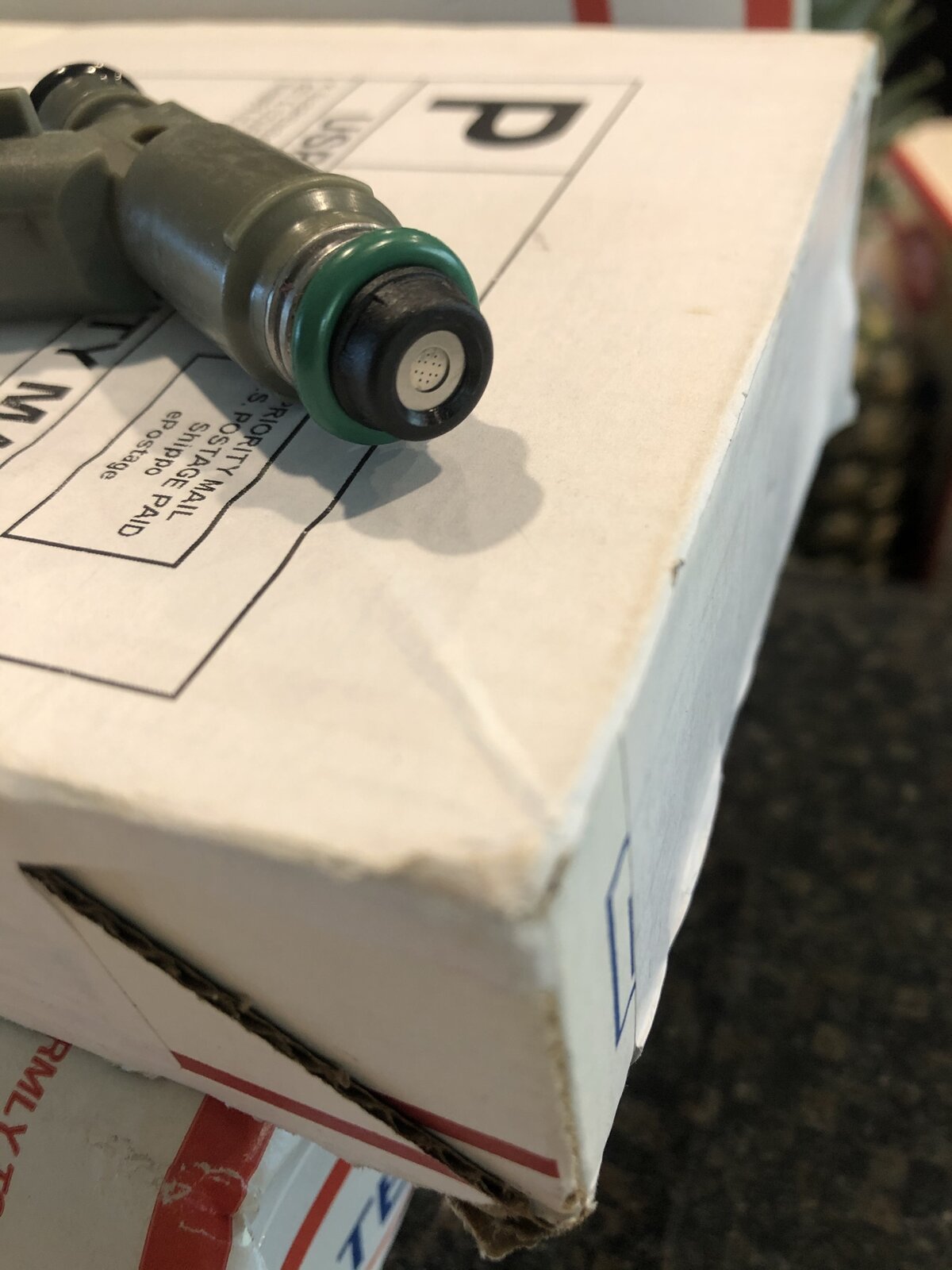

Good news! The injectors fixed my long start fuel pressure leak down issue! It's nice to have it start right up now.

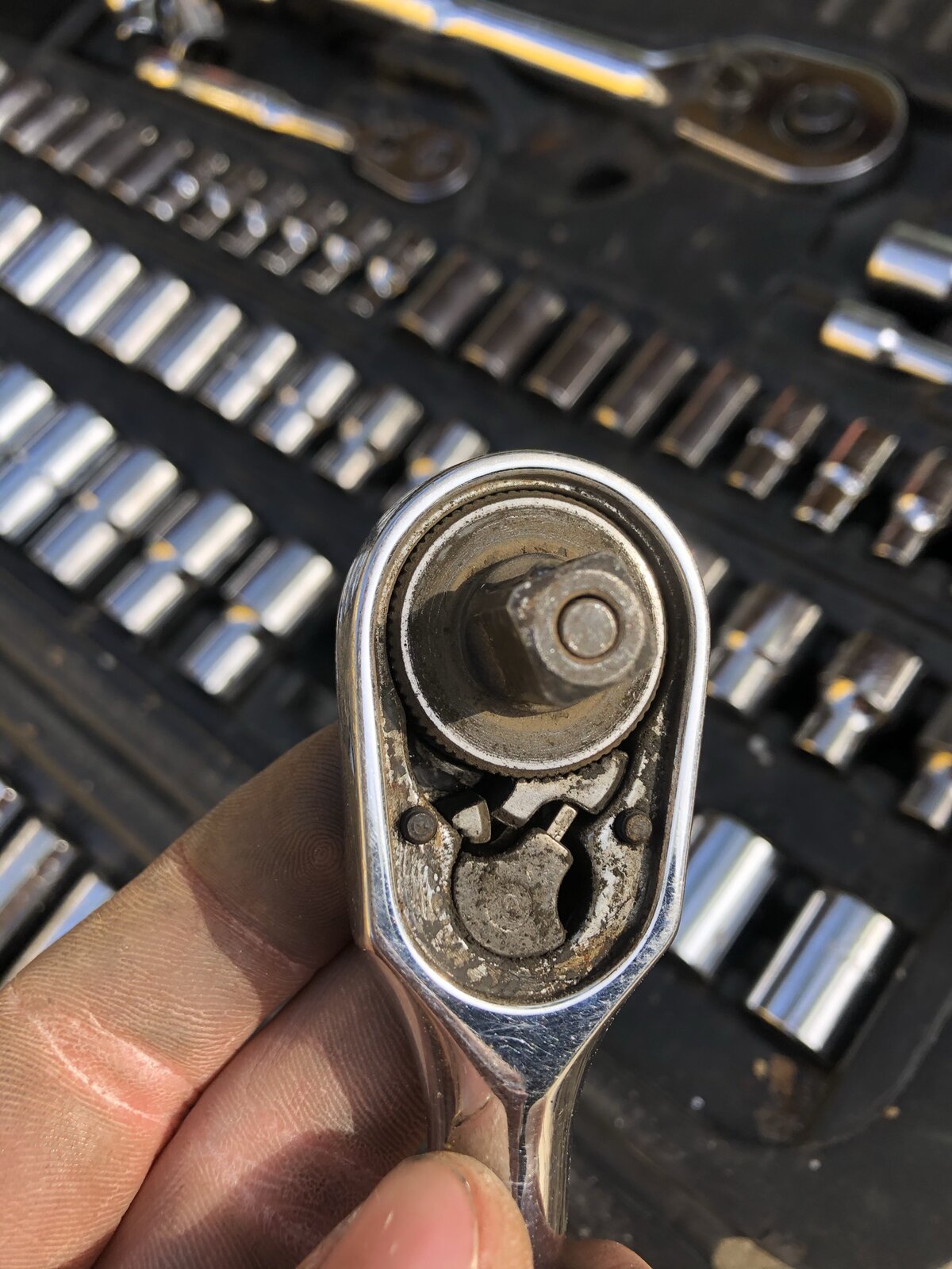

Obligatory quick tool rant:
People look at this and say, "Oh, well it's got "X" warranty, just bring it to such and such place and get a free replacement!". Could I have brought it somewhere to get a free replacement? Probably. Did I? No, I chunked that crap in the trash can. I don't want another one. I want tools I can rely on. Take your cheap tools and warranty and shove it where the sun don't shine. What if my ratchet pulls a stunt like this on the trail? Side of the interstate? I'll say it again. I want tools I can rely on, not dispensable ones I can replace.

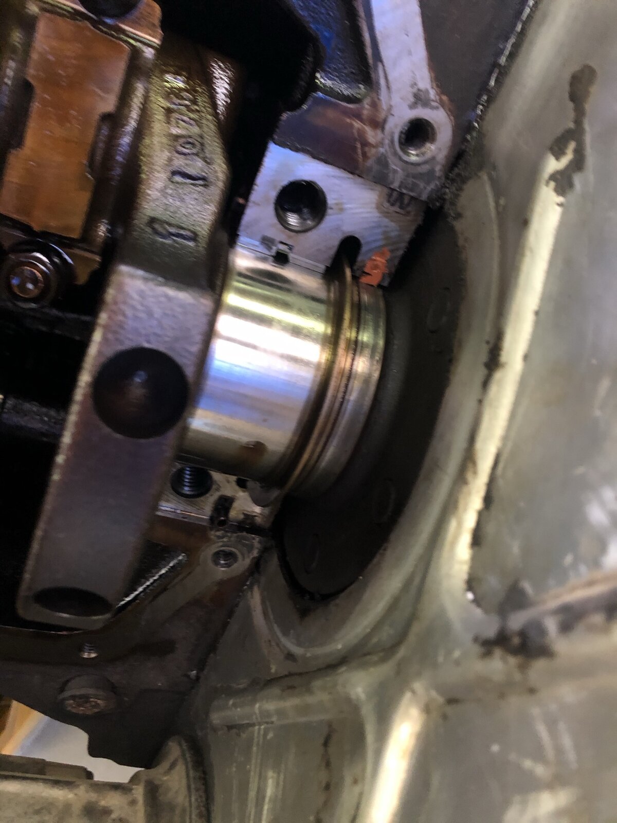

Rear main seal is changed! This was probably the most daunting project I've attempted on this Jeep. Turns out it's easier than it seems. The key to 'big' jobs like this is doing your homework beforehand so that you are prepared with the correct parts, tools, and procedure. Fingers crossed that it doesn't start leaking. I'll be keeping an eye on it.

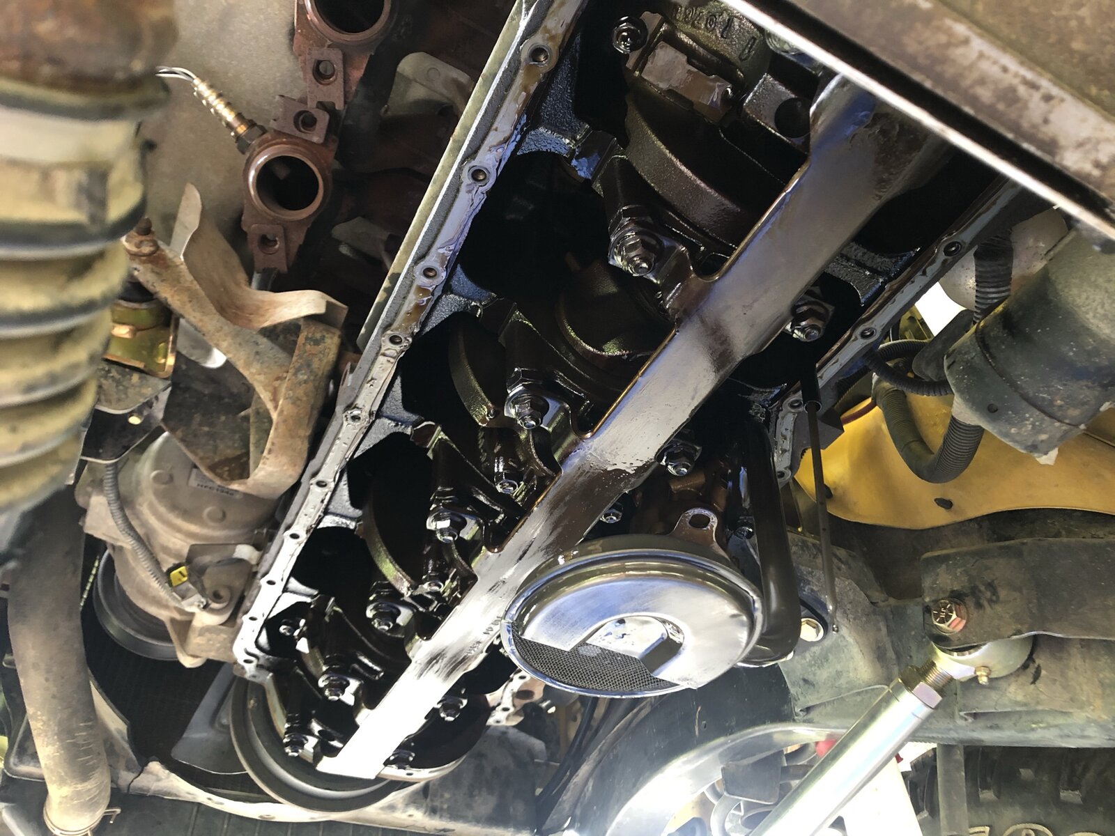

I swapped in a new Mopar oil pan to replace the damaged one, and added a Stahlbus oil drain valve while I was at it. I never thought I'd be excited about changing oil, but I can't wait to try it out!

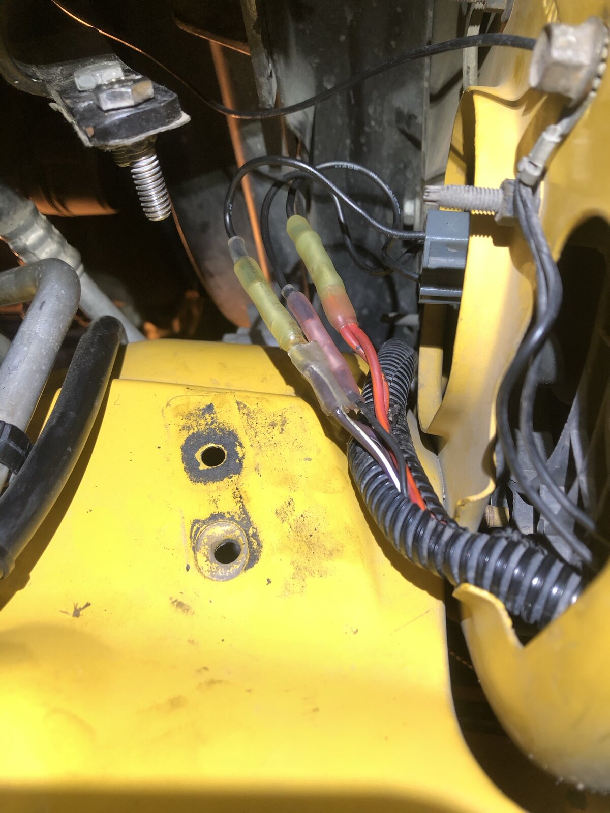

At the beckoning of a fellow forum member, I finally got around to cleaning up that sketchy headlight wiring. I'll add wire loom later.
-idiot
Well, you can imagine my reaction when I saw oil leaking out the new seal like there’s no tomorrow...
Lessons learned: don’t celebrate early and don’t tackle big jobs right before big trips!

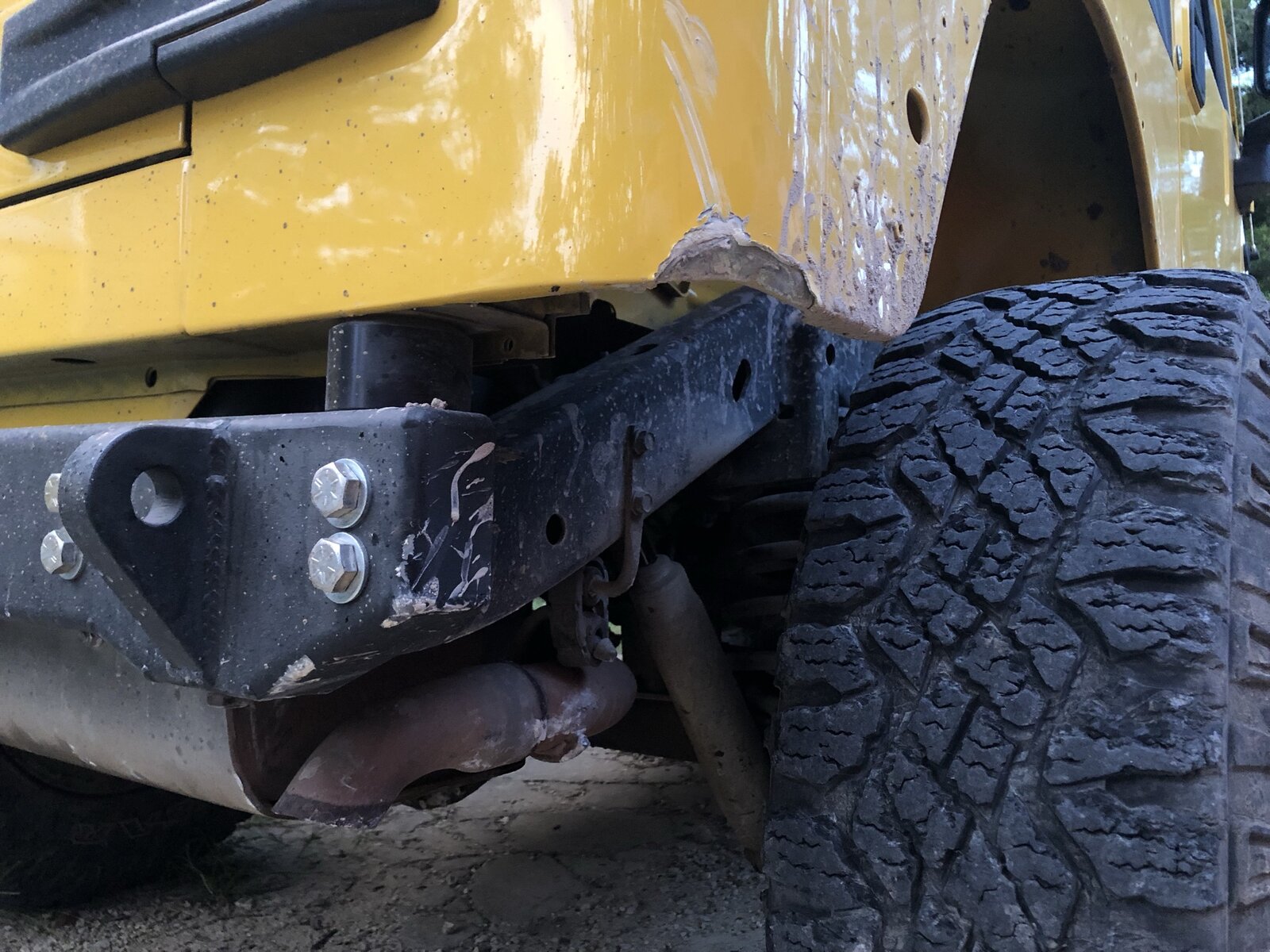

I hit the gas tank skid VERY often, mostly when coming down ledges. Interestingly, as bulky as it is, I did not hit my rear bumper that much; the gas tank skid nearly always hit first
I lacked departure angle on a few steep climbs I tried. I will soon be ditching the tire carrier bumper and adding a SWAG or Next Venture rear bumper, and most likely putting a smaller spare inside.
