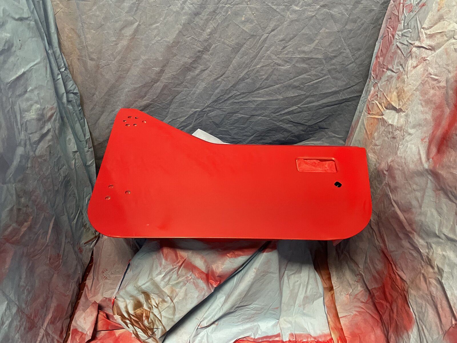

It was a long process with the half doors, but they’re finally coming together. I decided to repaint them completely. I have essentially no experience prepping and painting but the results are… satisfactory.
Lots of Parts had to be replaced, but fortunately the latches were good.
I acquired an OEM Dark Khaki soft top and it is time to get rid of the old damaged pocket flares I'd painted tan. The tan experiment paid off: the SEM Color Coat held up quite well, but I couldn't get a soft top to match.
I went with standard width flares, which means my tires are going to stick out an inch or two, but I'm ok with that for now. Eventually I'd like to go to 33x10.5s and ditch my wheel spacers.
First is scrubbing the new flare with Simple Green and a gray scuff pad.
Next, the adhesion promoter. 5-10 minutes to dry then apply the Color Coat. This is their version of the Chrysler J3 Khaki interior color that came on the '06's.
I like the color; it goes well with the red and should match the dark khaki top fairly well.

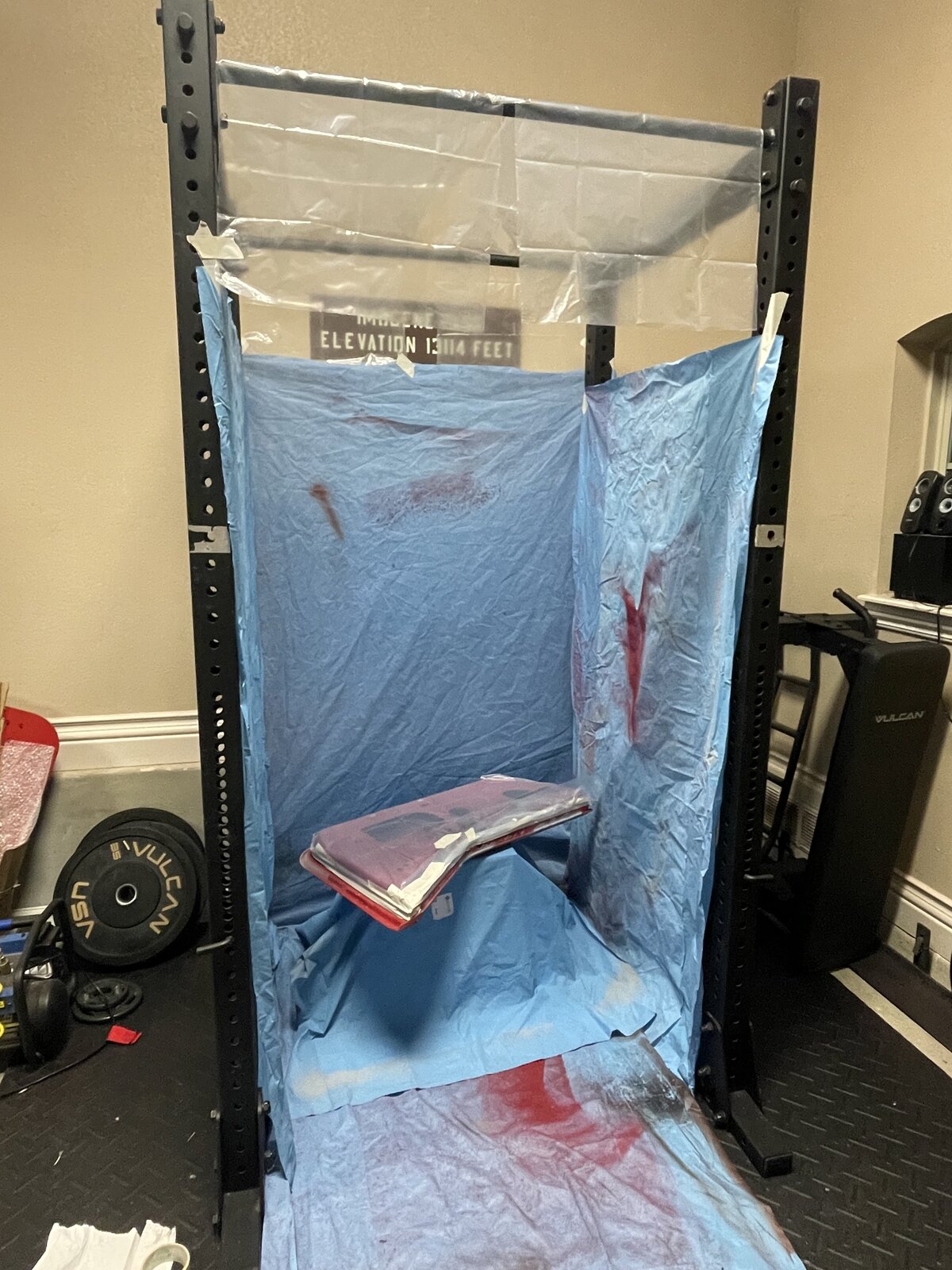

Painting the first half door left red mist dusted over nearly everything in my garage. Not fun to clean up. So for the second door I enclosed my power rack with drapes to contain the spray.
I don't have time to clear coat tonight, so I'll let the base coat dry, do a bit of wet sanding, then clear another day.
Slowly they're coming together!
Squat rack paint booth…. That is awesome.. great job on the build.

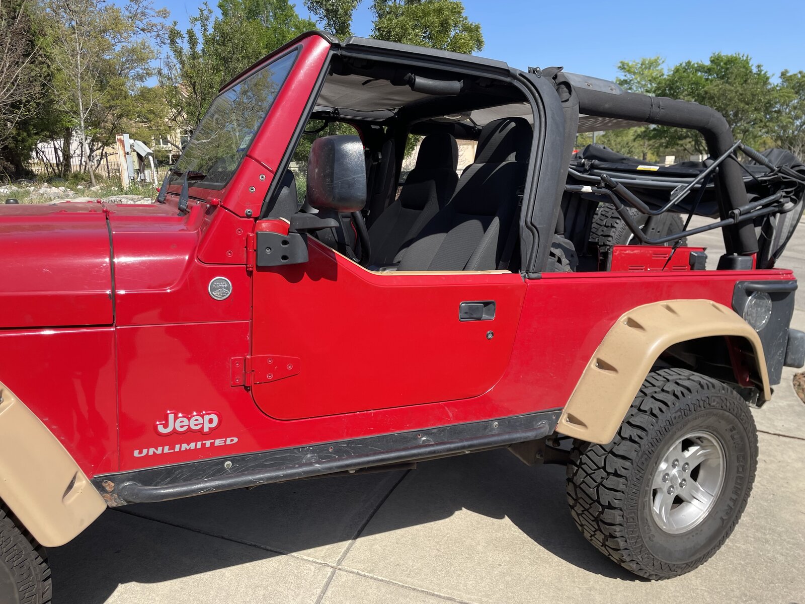

The old 7" pocket flares are officially gone, 2-1/2 years after I bought the jeep. The tan color I'd painted them was fine, but since there are no soft tops available in a similar shade, I went with a light khaki color for painting the new OEM style flares. I think it will look ok with the dark khaki soft top I bought... I hope.
I also had the local paint shop color match a 1K paint to the dark khaki soft top (I have one window with me for the moment), and used it to repaint the Rubicon rock rails I got last year from @rasband . It's a decent color, but I would never have called it 'khaki.' It's a dark gray with a dark olive hue. My wife says it still goes with the Flame Red, but it'll still be a few months before I can assemble the whole package.
I installed the driver-side rock rail last week. I attached the rubber gasket to the rail with 2 long strips of 1/4" double-sided automotive tape from 3M. The paint is a 1K and will scratch easily, so I put a 3" strip of XPEL film over the top of the rail that I use as a step. We'll see how long it holds up.

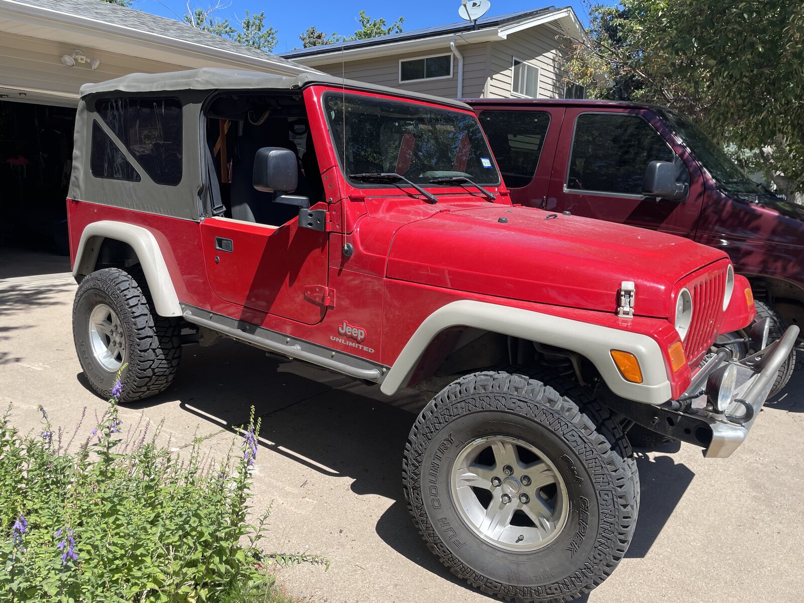

I finally reunited the OEM Khaki top with the LJ. I think it matched the color on the rock rails pretty well and I like the overall look.
