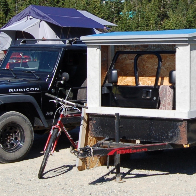

A TJ sized camper
I built a box which slides into my trailer..
And my doors store in the front..
I love the zero setup, zero pack up.
Park, roll into bed, wake up to rain, roll out of bed, drive away.
Next night, everything is still dry and ready to roll into bed.
I just noticed the spot for the doors. Brilliant. I've been envisioning something like this too.
Is there a build thread or something for this camper? I've been looking at A LOT of setups to build something that's really simple, cheap and clever.

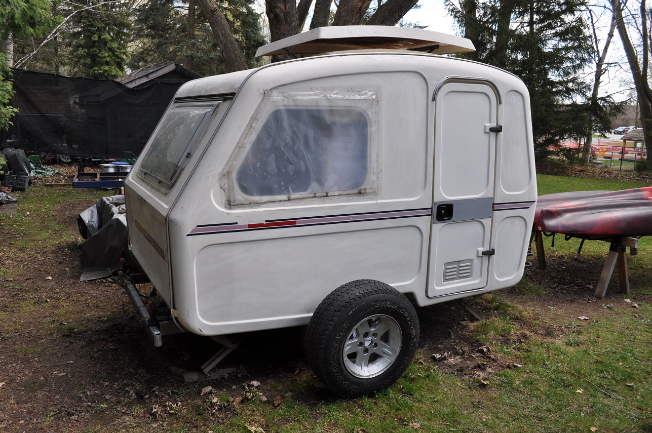

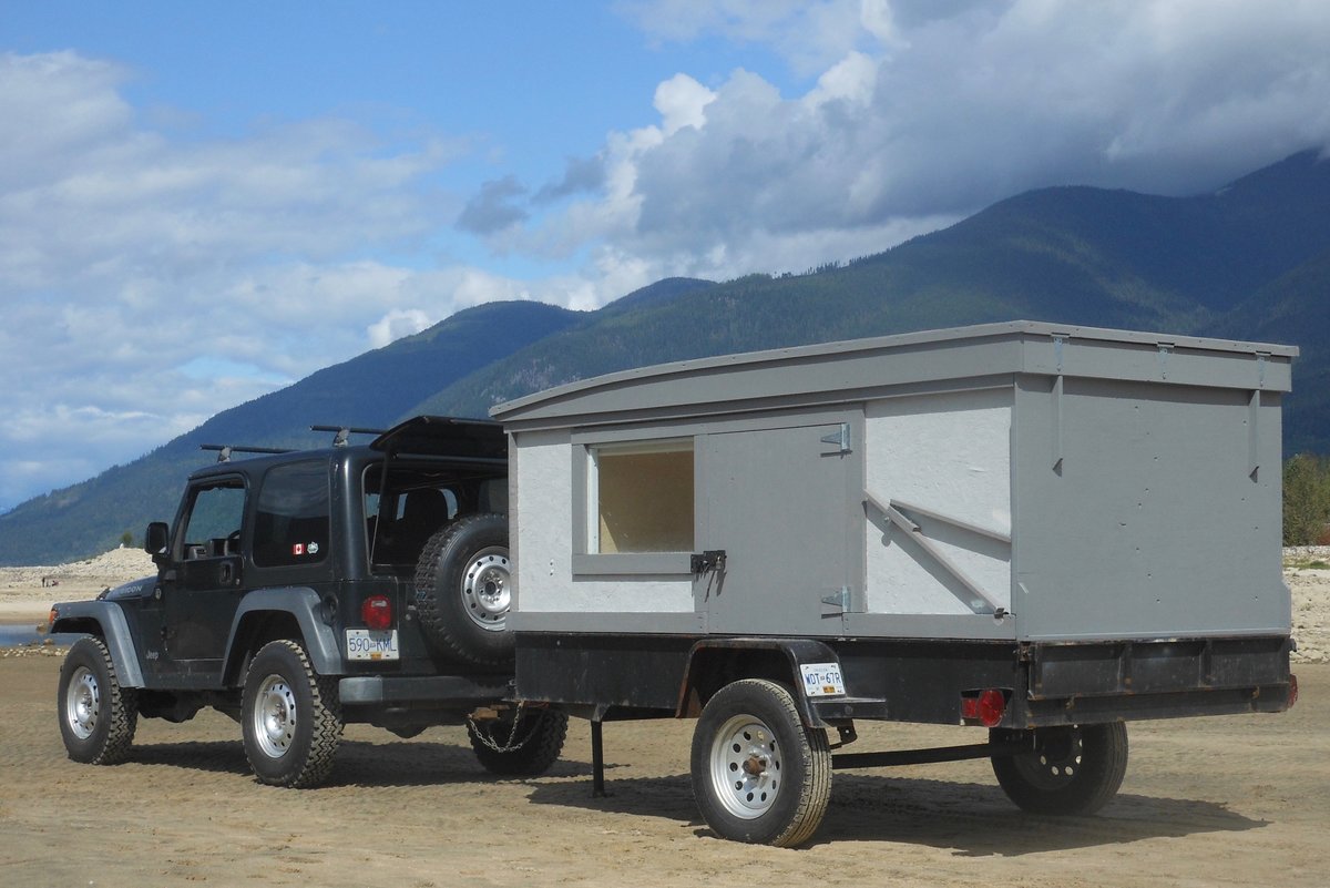

I've been happily using my tear "pop" for the last few years (first seen at post #12 and a few after in this thread). I've also got back at a my fibreglass "egg" project. It's currently sitting on a 2"x4" jig while I'm building an off road chassis for it. I'm trying to get the right axle & wheel combination for it before I cut the body and floor for the new wheel wells. I'll be using Ravine wheels and they'll protrude about 4 inches beyond the body. I'll probably use TJ rear fender flares to cover them. Oddly enough, if you flip them (right to left and left to right) they look surprisingly good. The TJ taillights are on and if you look closely you'll see the TJ door handle.
I got the roof to lift properly and it's nice to be able to fully stand up in it. I have lots of metal and fibreglass work to do and I'm kind of designing the interior along the way. Lots of fun! 😊
Here's the current mock up ...

What’s the track width on that?
Reactions: RustyAutoholicGuy
It's going to be about 70" which is what my Clipper is (post #149) with the Jeep wheels I added. That's wider than my LJ & XJ tow vehicles and I'm fine with that.
I'm looking at my axle and brake options. I have a 3,500 lb. 4" drop axle which would keep the body at a similar height. I'll have to shorten the width but that's a pretty straight forward job. I would use 2,000 lb. springs with it. I also have a pr. of 2,000 lb. torsion axles that would work. The original weight of these is only 800 lbs. Mine will be a bit heavier and probably won't need brakes but they're never a bad thing to have. The axles on these were originally at about the 50/50 mark and look awkward with the 12" wheels. The mock up above shows the axle/wheels at a more traditional 60/40 placement ... and of course it has to have Jeep wheels! (y)
The original frame for these is a basic 4'x8' + tongue for 13'. The body bolts straight to it with no outriggers. The goal is to tuck the wheels mostly inside the body width and then build the wheel wells to fit. As mentioned above, I'll either adapt TJ flares or make some flat metal flares. I don't have a lot of experience with fibreglass and I'm definitely gaining some new skills.

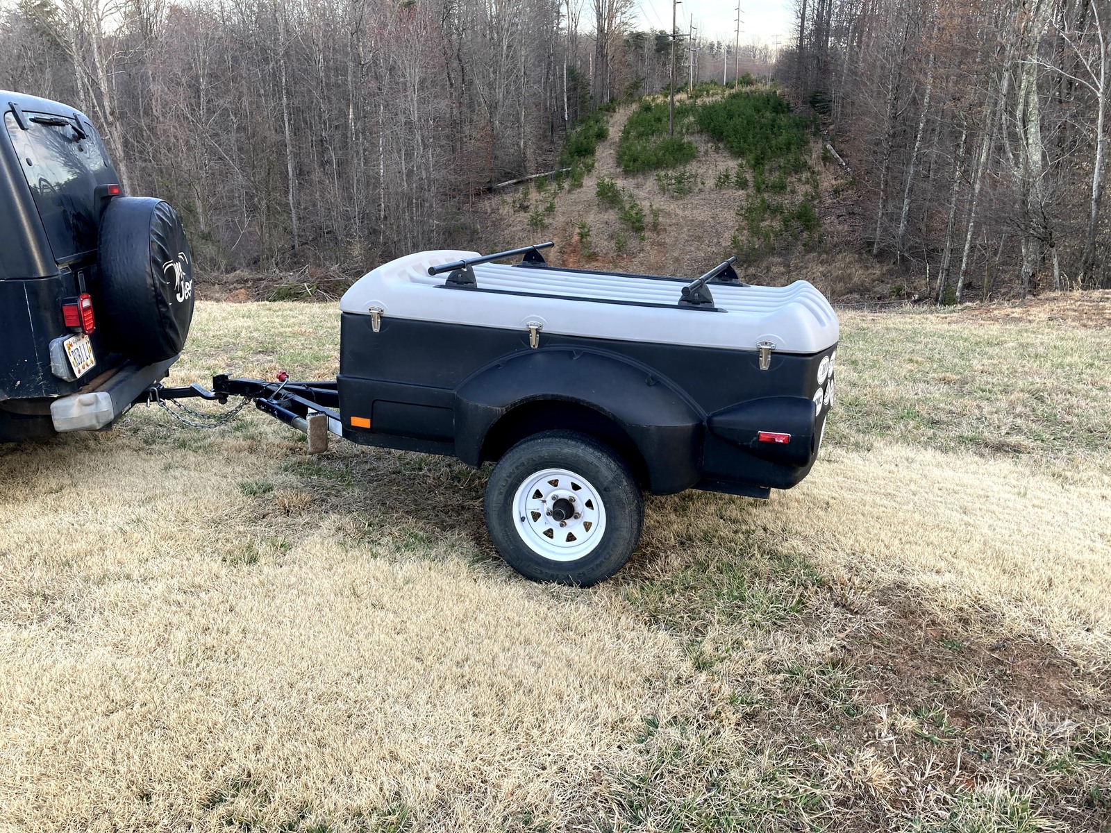

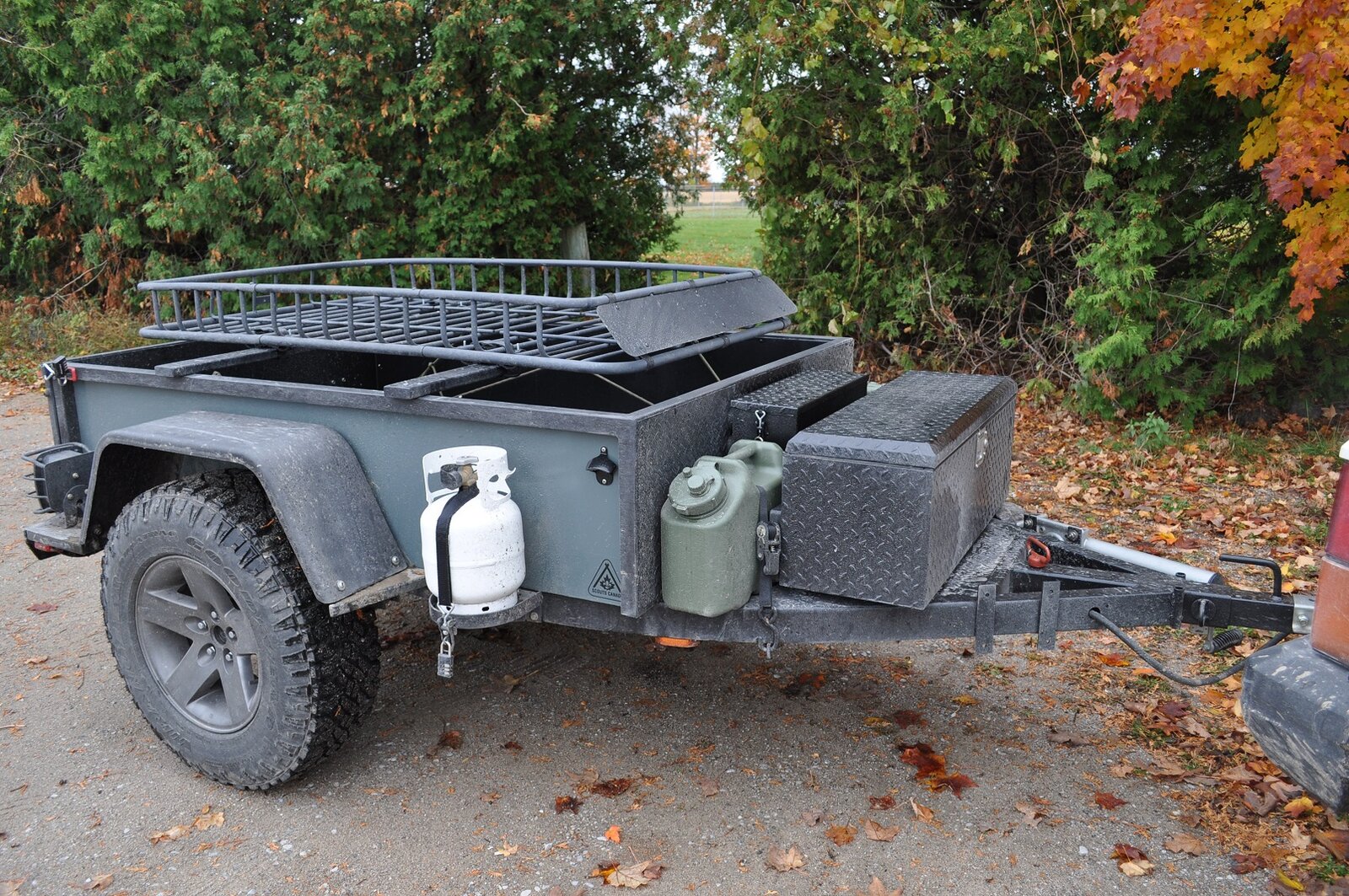

I built a cargo, but not enclosed, style trailer and I don't have a lot of money into it. I'll be camping with it, but not in it, in 4 weeks. It's great to carry camp gear and with racks (not the one in this pic) kayaks and bikes or an ATV. My plan was to build a side entry RTT for it but I'm now on the look out for a pickup tent camper for it.
I use this for more than camping. It's great for trips to Home Depot and the dump. I've also hauled home a lot of used Jeep parts in it!

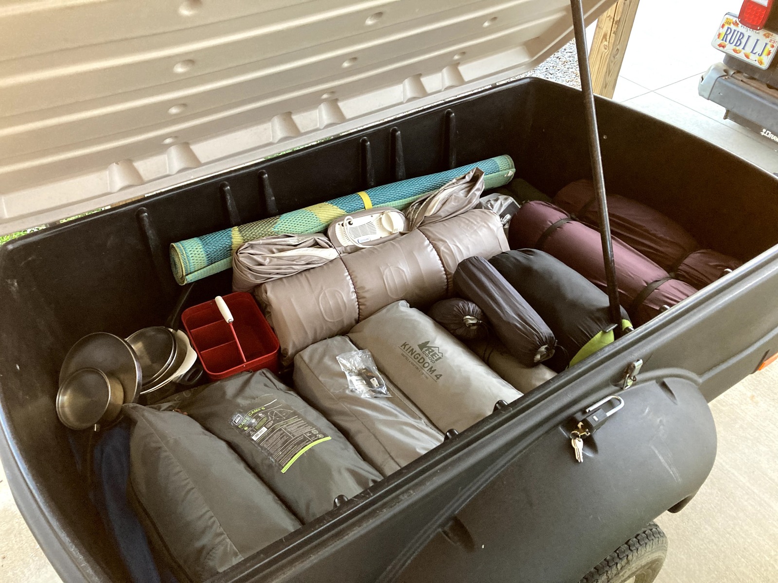

I agree you @PC06, I'm still looking to upgrade to a roof top tent for myself once I get my TJ built but I did snatch this up in March off of Facebook Marketplace.
SUPER lightweight, I don't think it even weighs 400lbs with all the gear in it right now. I forgot what the company is called, but it was a kit you could buy and build the trailer. The couple I bought it from didn't trust the bolt together frame and got a frame custom welded together from a Texas Bragg Trailer.
What's interesting is it's not fiberglass, it's the rotomold plastic like coolers are made out off. It's just narrower than a TJ as well so when you are going down the road you don't have to worry about it hitting anything either.
It also came full of camping and cooking gear as well.
The couple I got it from had just upgraded to a teardrop trailer and weren't going to be using any of the gear anymore so included it all with the trailer as well. I do plan on upgrading the suspension and putting the same wheels/tires as my TJ so it will have the same ground clearance as my TJ when I'm done with it.
When I come out for TJ Fest next year I'll be pulling this for all my spare parts, food, and anything else I might need while I'm in Utah.
