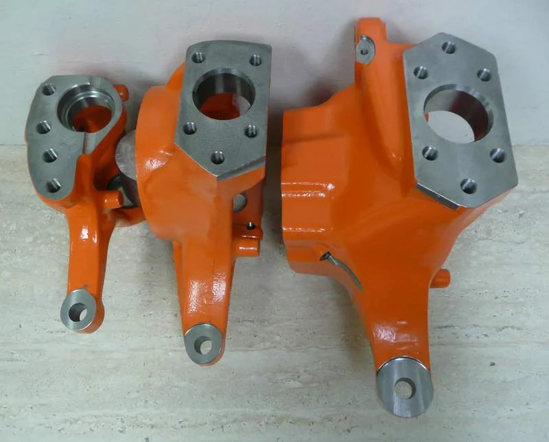

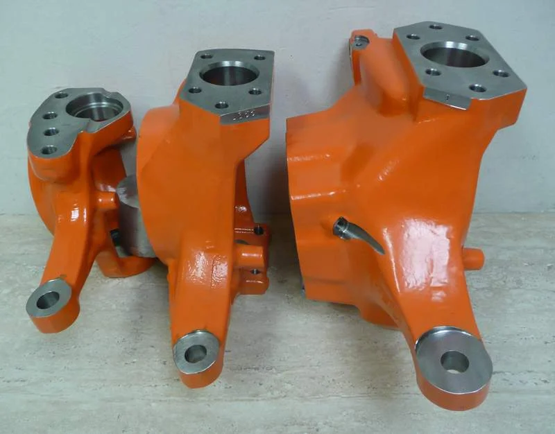

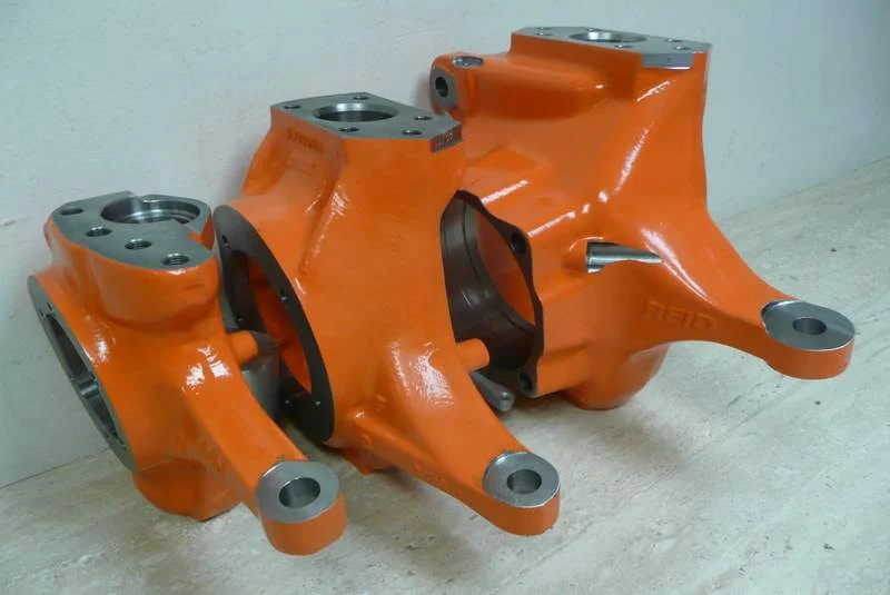

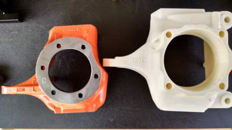

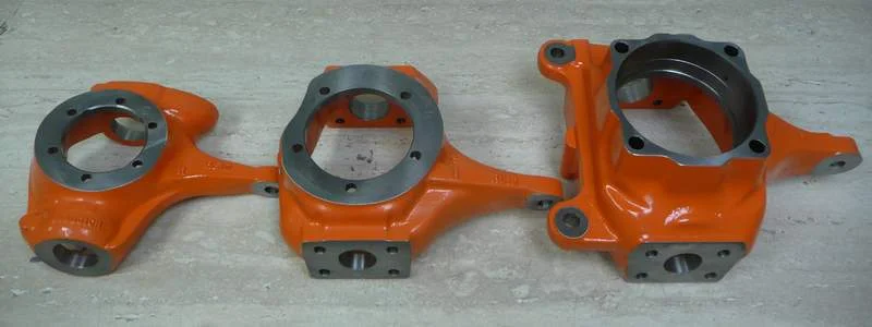

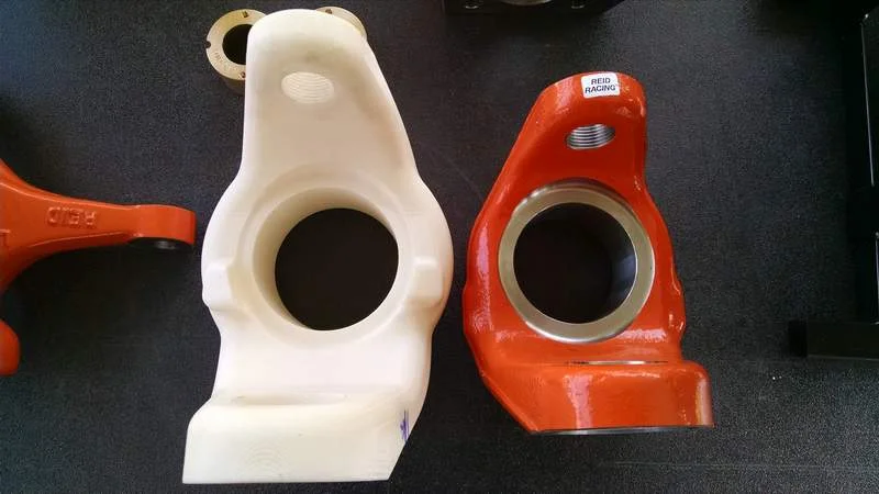

Front axle decision has been made to no surprise; going Spidertrax w/ kingpin knuckles.
Build plan is as follows:
  • Full-Width 69.5” WMS, Driver Drop, Long Driver Side Tube
  • 3.5” Spidertrax Pro Series Housing (Heat-Treated Chromoly Tubes)
  • Reid Super Kingpin Inner Knuckles (C’s)
  • Reid Super Kingpin Steering Knuckles
  • High Steer Arms Drilled for Double-Shear
  • Ford Superduty 05+ Timken Unit Bearings, Re-drilled 8x6.5
  • Ford SuperDuty OEM Brake Calipers
  • Ford Superduty OEM Rotors Re-Drilled 8x6.5
Waiting on Spidertrax to get back to me, I only asked that they tig weld a set of 4130 skid plates on the housing before shipping it out to me.

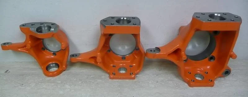

Reid Steering Knuckle Comparisons:
Left to Right:
Dana 44 vs Dana KP 60 vs Super Kingpin 60

View attachment 247735View attachment 247738View attachment 247737View attachment 247736View attachment 247739
View attachment 247740View attachment 247741View attachment 247742
Freaking solid!
Just curious, if you're already using the 05+ unit bearings, why go with the reid king pin knuckles vs the factory ball joint knuckles?
Reactions: Fouledplugs
