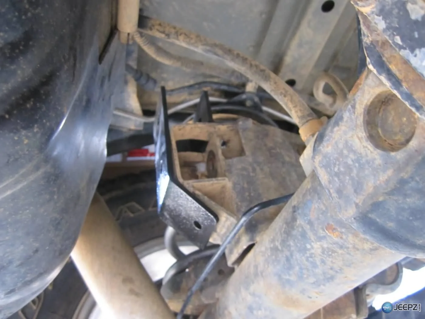

Another question.
I am reading I need a new track bar relocation bracket that is angled. Can I run that with my stock rear track bar? Do I need a rear adjustable track bar to go with it?
Or Do I just get a rear adjustable track bar and be fine?

What brand of lift?
Would look something like this.
I wouldn't think so unless I'm missing something and didn't fully understand what you asked. The bracket that comes with the kit is there to lift the rear track bar into position to keep it inline with the rest of the lift.
When I install my SYE and CV Driveshaft I need to set my pinon angle. I have read conflicting posts saying I need an angled bracket because of binding that will happen from positioning the axle. I emailed Teraflex and they just replied saying I should have no issue with the current bracket.
Anyone else have experience with this? I want to make sure I have everything ready, this is my daily driver.

The factory rear track bar has fixed angle joints at both ends, their angles cannot be adjusted. When you install a SYE and CV driveshaft, you need to roll the axle to raise the pinion angle due to the CV driveshaft's requirement. That changes the angle of the factory driver's side track bar bracket so it is no longer the same angle as the driver's side of the OE track bar. You need an angled track bar relocation bracket to correct the bracket's angle so it again matches the angle of the bushing at the driver's side of the track bar.
Tera was wrong if they said a non-angled track bar relocation bracket will work as well after having installed a CV driveshaft.
