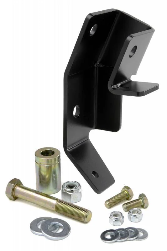

Can you post a pic of an angled bracket? I'm using the bracket that came with the kit but have my axle raise to correct my driveline. Want to make sure something is not amiss.

http://www.rubiconexpress.com/Suspe...2.aspx?t_c=1&t_s=101&t_pt=4303&t_pn=R/ERE1602
So If I get this one, I should be okay?

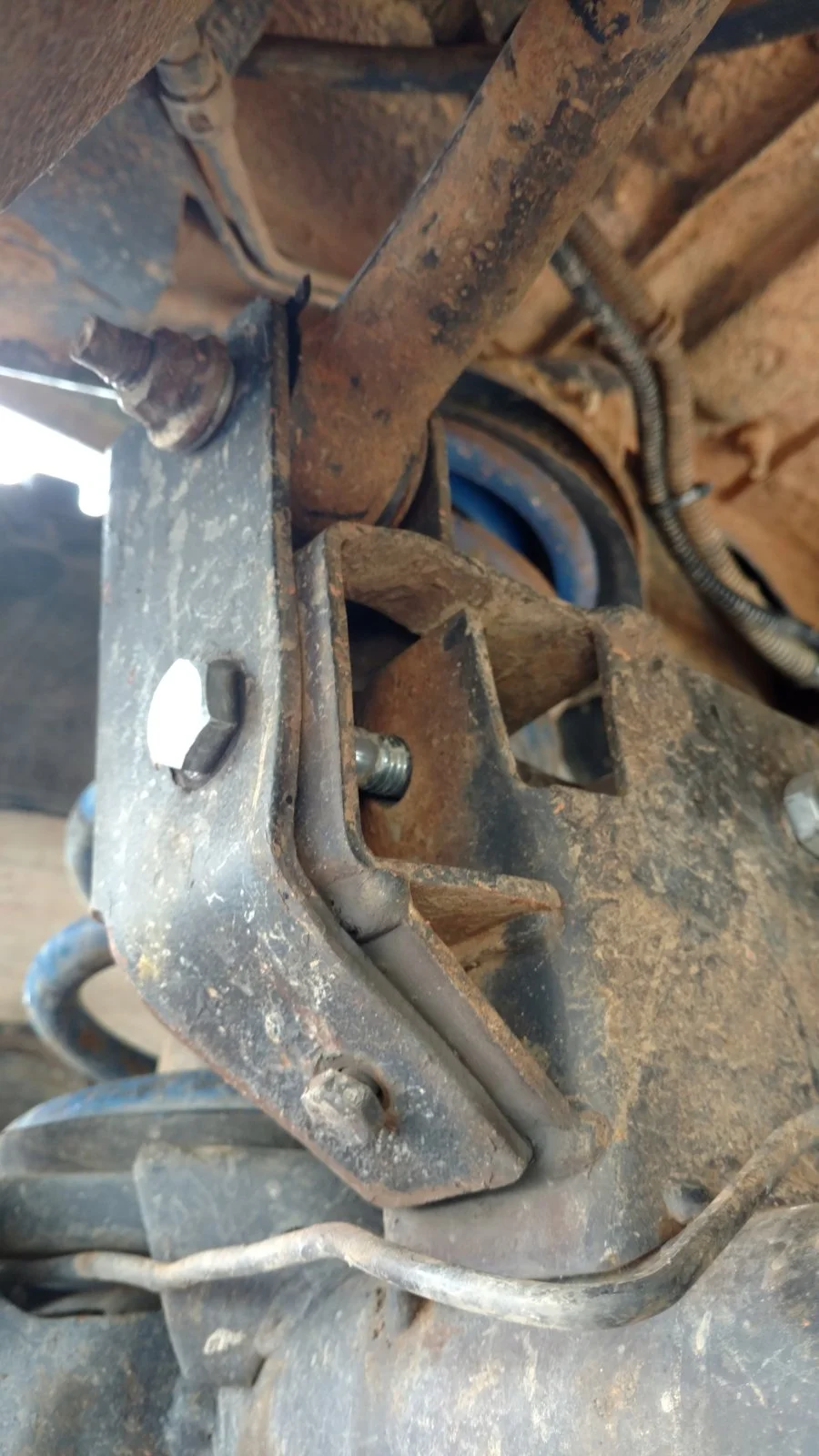

When the axle is rolled to raise its pinion angle for a CV driveshaft, the upper part of the bracket shown below becomes vertical to match the vertical angle of the OE track bar bushing.
Just to confirm, that is a non-angled relocation bracket which is meant for use when there is no CV driveshaft. It works with CV driveshafts but an angled is better when you have a CV driveshaft as it positions that end of the track bar further away from the gas tank where it could otherwise come in contact in some wheeling situations.
Ok. I have been running it this way a long time without an problems. I didn't realize that it could cause an issue. I too will check into the angled bracket.
