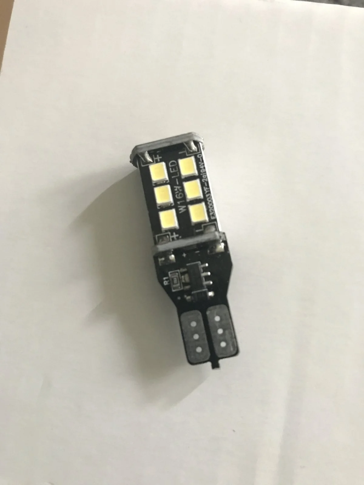

Turned out to be one of the footwell lights. Recently changed them out for some brigher Chinese LEDs. Two of the components had blown on of them so I ditched both.
