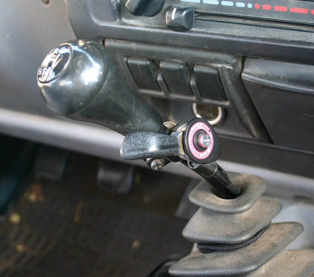

this is a poor mans CC. :ROFLMAO:

Of doing what in your Jeep? 🫢 Shame, shame.
