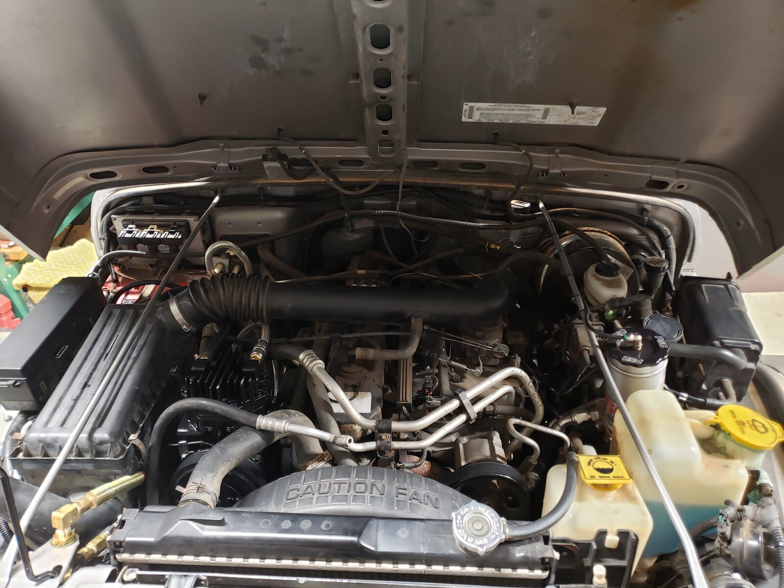

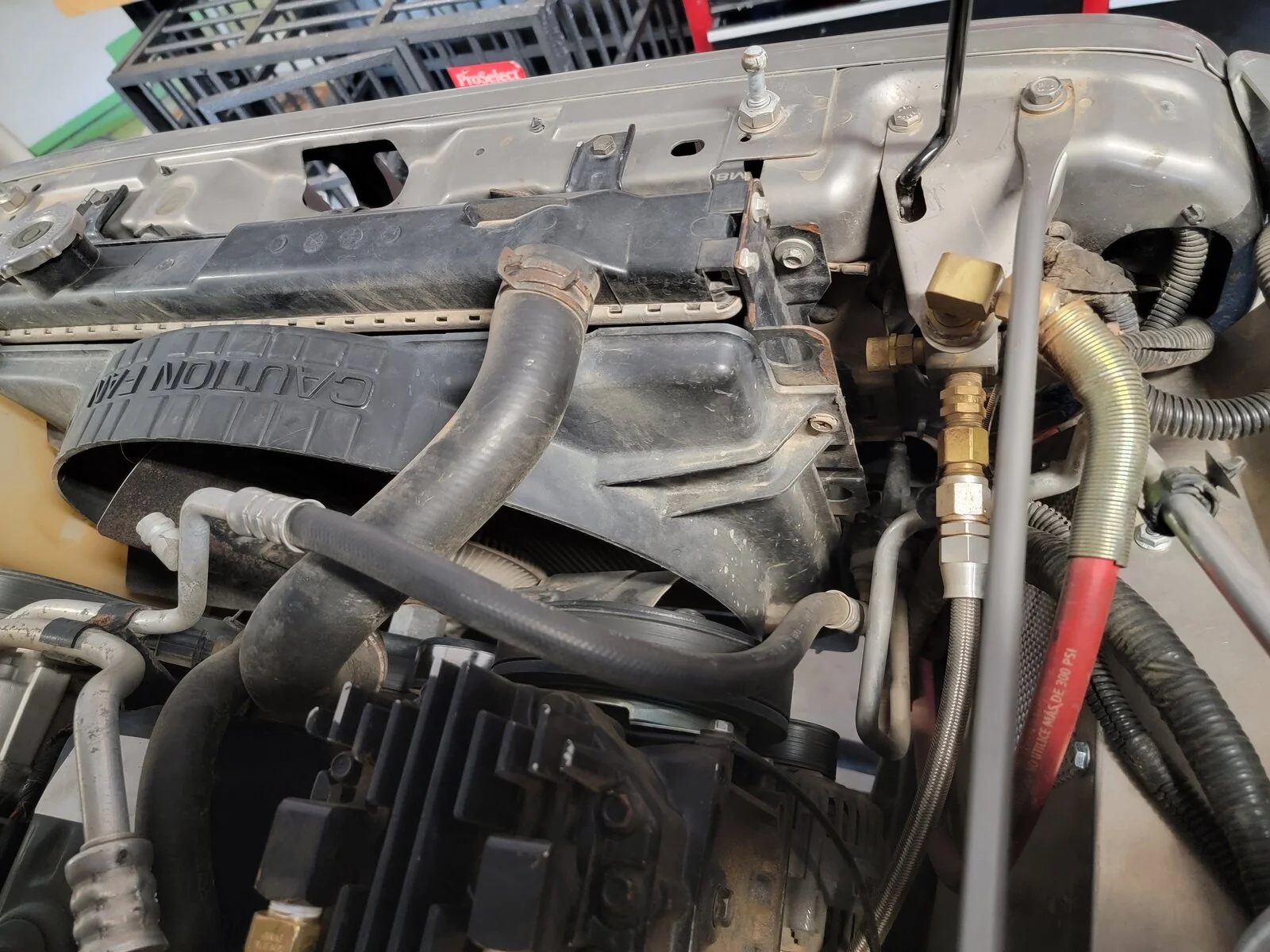

I used the kit as it came but added an oil catch to mine since it was spitting some oil. From there I ran a hose down to the bumper to make a remote fill location.

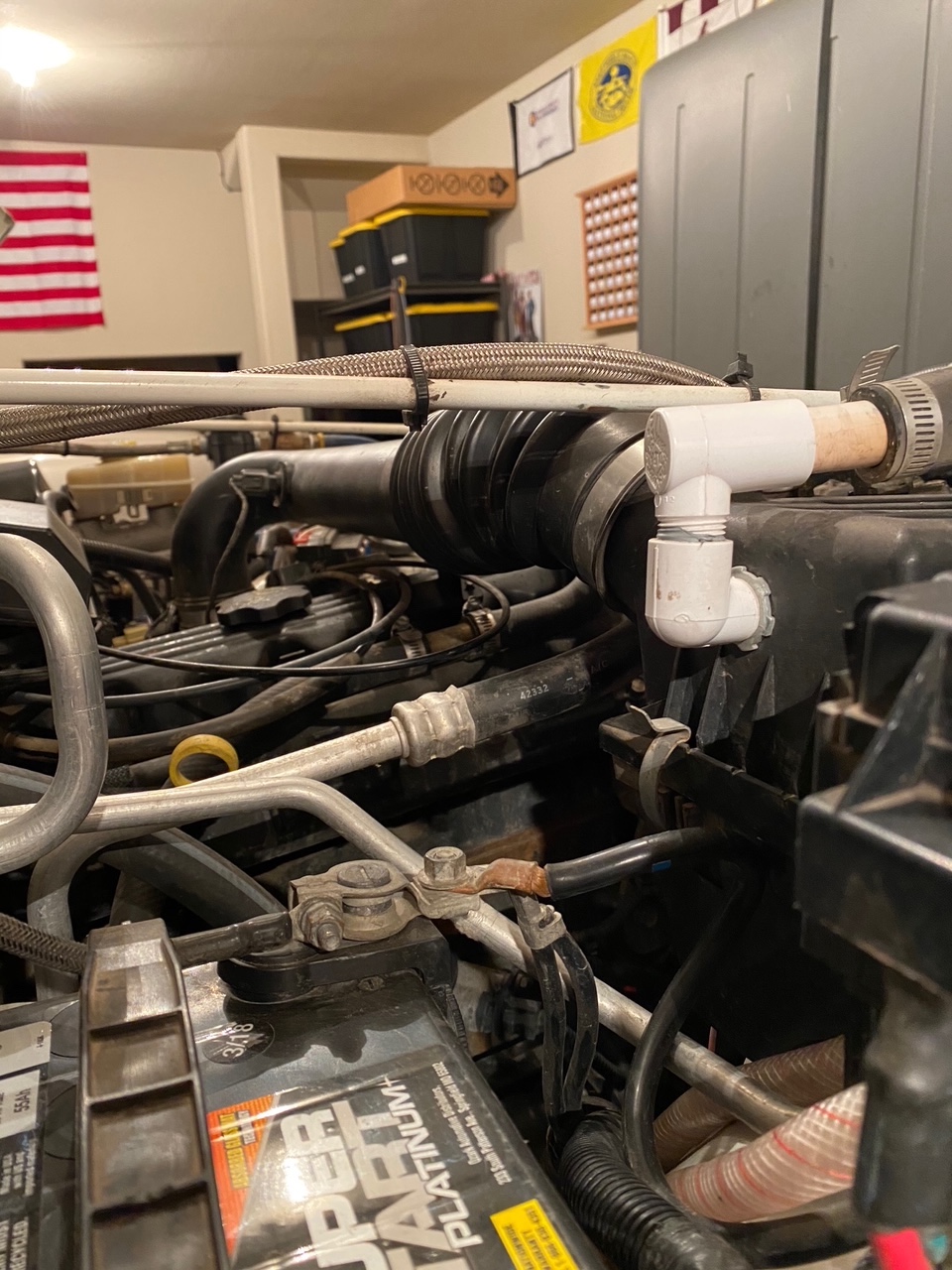

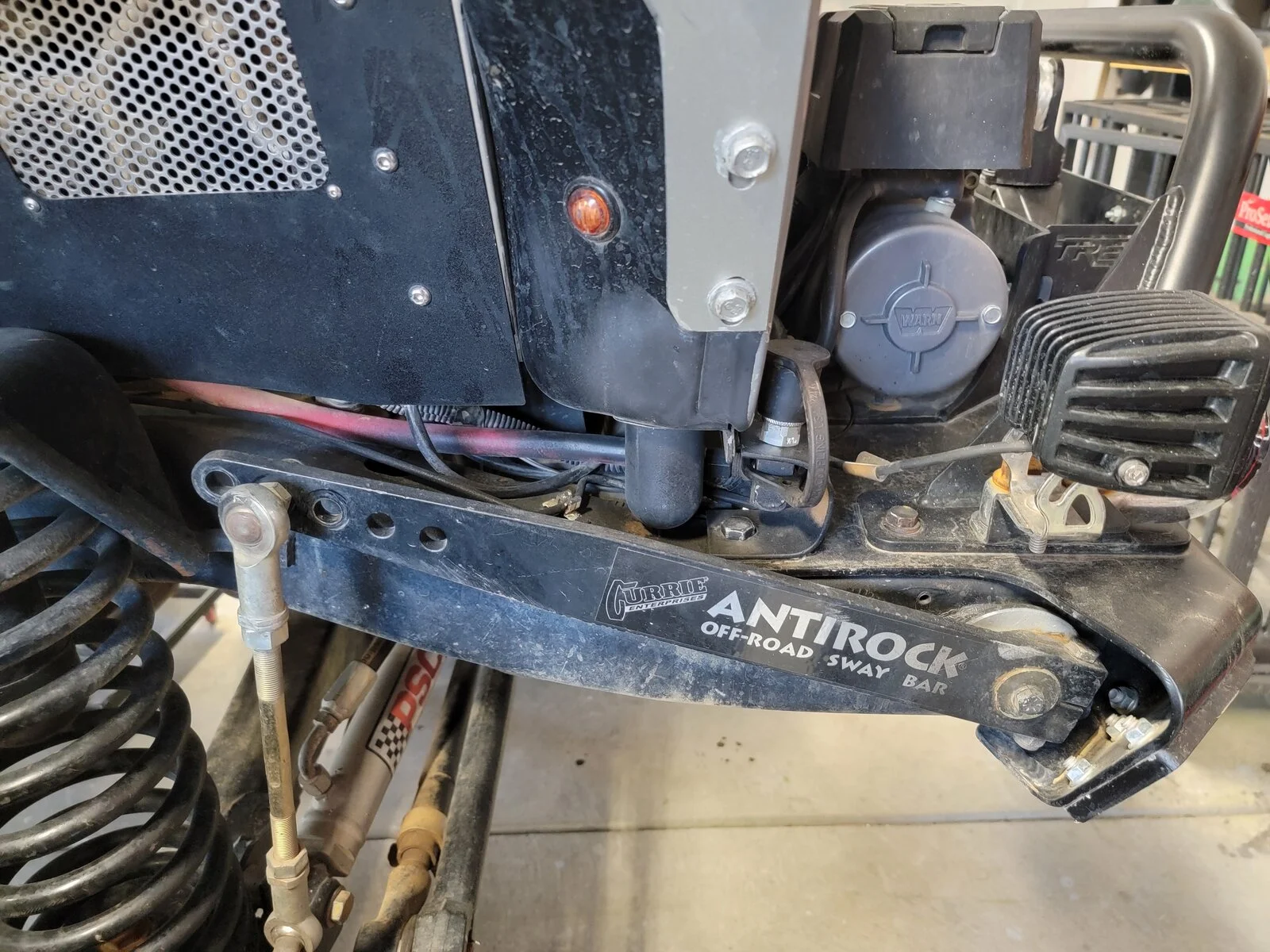

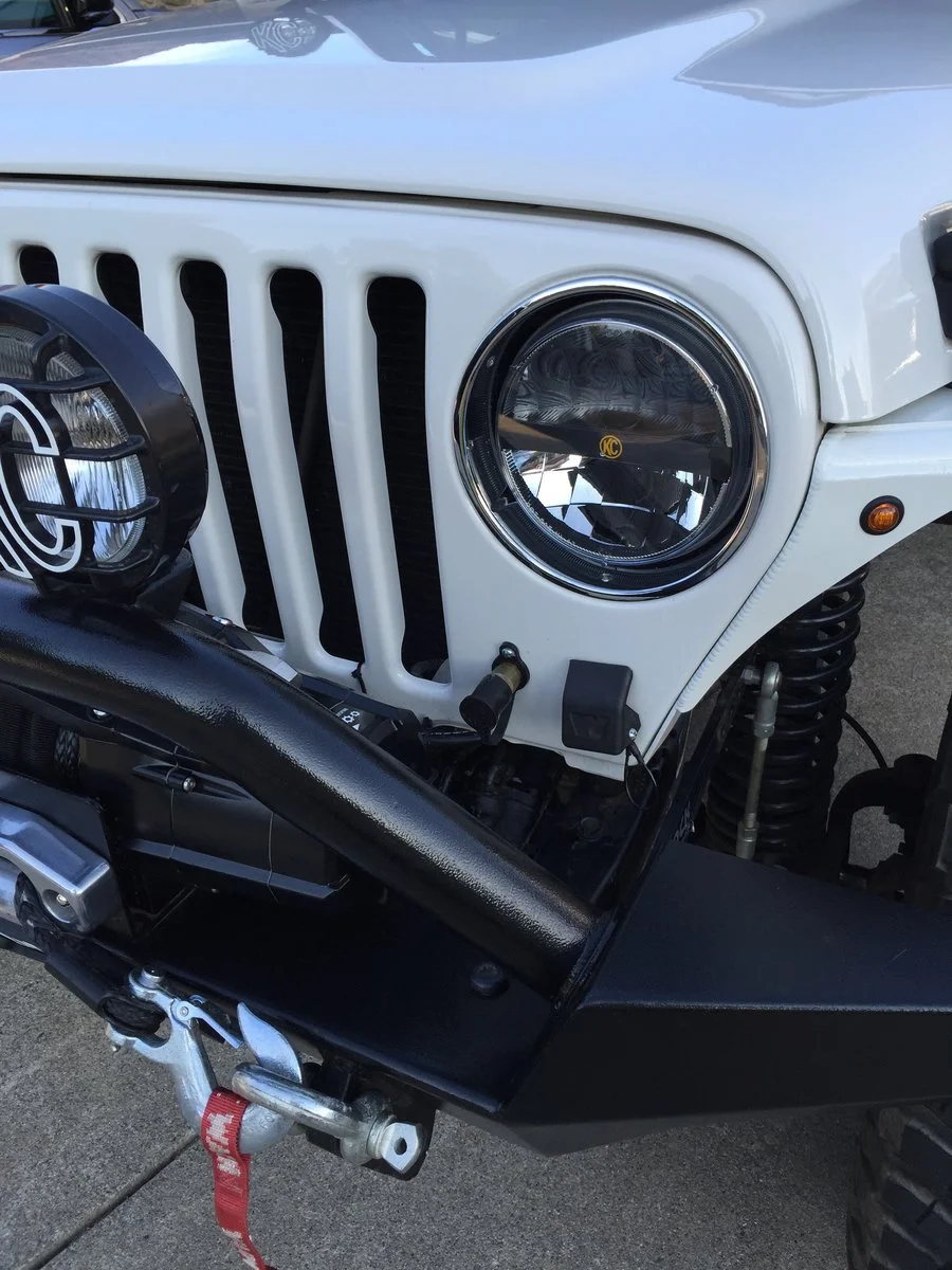

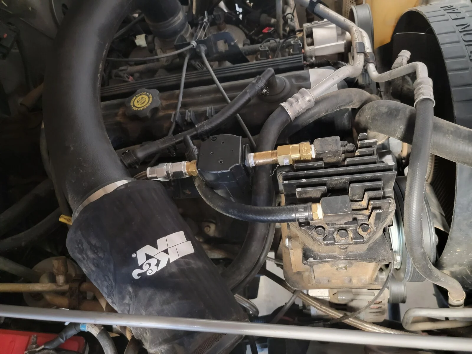

I also run a York I installed an outlet just under the headlight and a second just on the inside the rear driver side near the roll bar. I also added an inlet filter on the passenger side and then after adding my OBS I relocated it my drilling a hole in the engine air box so that filter is doing double duty
You could get by with only one outlet but having one at each end works will to inflate your friends tires as they will line up once they see how much air the York puts out compared to there little plug in compressors
I also use it with a air gun to inflate air beds, rafts, etc. just carry a air hose and attachments
