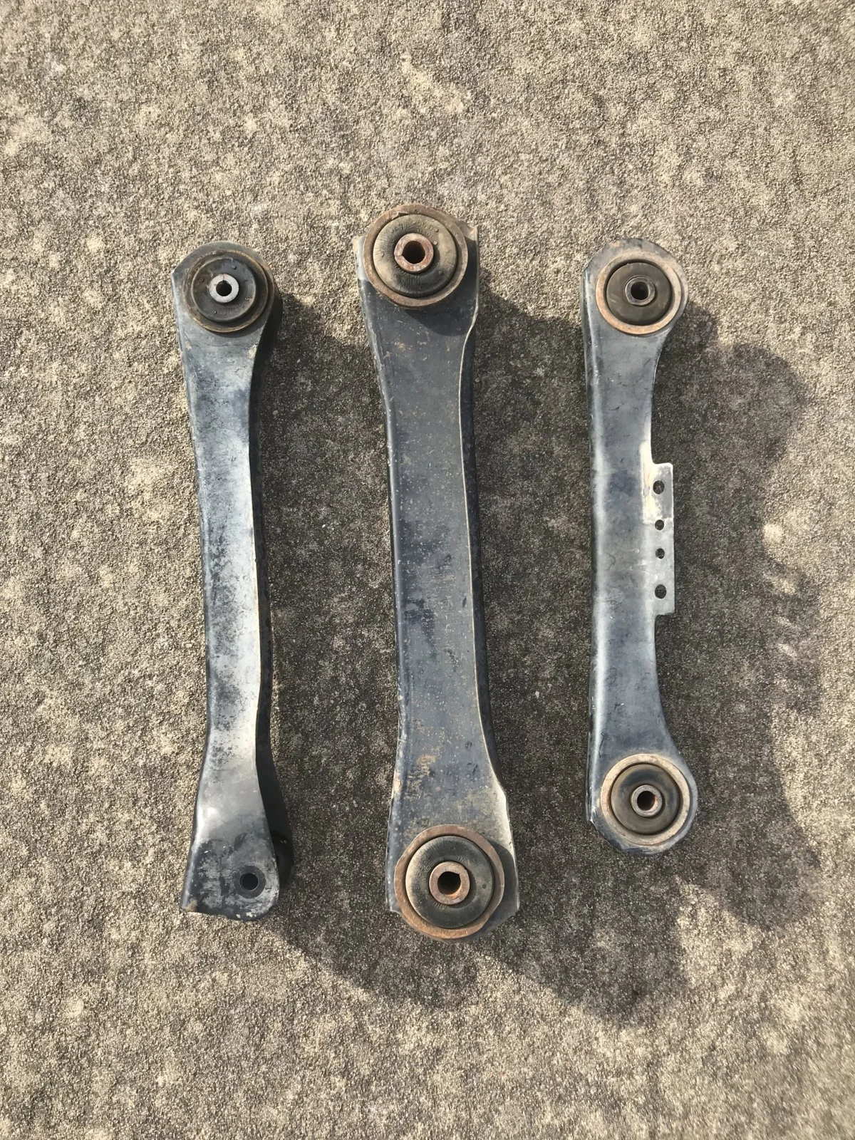

Chris I dug out the box of original parts that came with my tj. I wanted to reference the original lengths. I am short a set of lowers I believe. Can you tell which from the photo?
