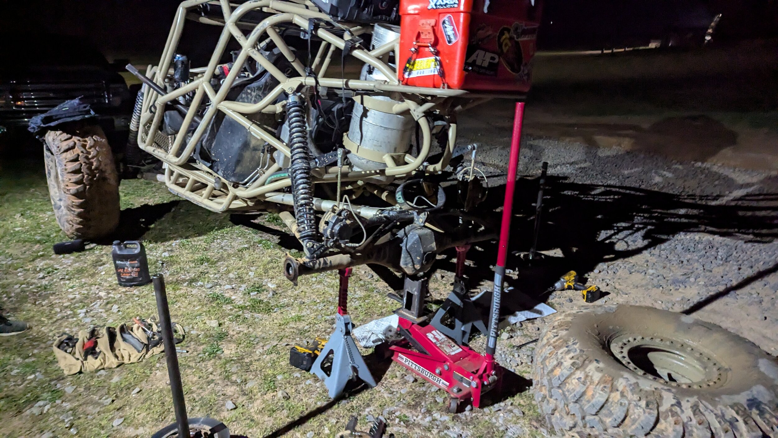

Arrived Friday night around 8:30pm. Beeker and myself were on the trail by 9:30pm, TJ rode shotgun with me and Crow decided to try and get some sleep and didn’t head out with us. We hit Trail 22 which is not even 200 ft from the onsite cabin we rented and it was on right from the get go. Within view of the house, I not only got denied, but I vapor locked the fuel injector from heat and we even had to winch Beeker. The trail is not even 200 ft long and we could see the house still, Haha! From there we headed up to Area 51 and played around in some rock gardens. Again, I was denied on a few of the rock gardens, Beeker made them look easy (funny thing is, next day in the daylight I got redemption and Beeker struggled). After A51 we headed out to George Winters Trail and Beeker broke his rear ring gear on the big obstacle. After we got back to camp and opened it up to see the damage, Beeker decided to run home (1:30 hr away) and grab both a spare front and rear differential (had to grab both because he didn’t have another 5.29:1, but he had two 4:10s). He left AOP at 1:00am and I chose to stay back and try to get a few hours sleep. He arrived back around 4am and it was on, we changed both the front and rear diffs and were ready to roll at 8am. Beeker with no sleep and me with about 2 hrs. Now that is a memory that will be shared around a campfire.
Great thing about Toyota axles is that they have a removable third member (diff) similar to a 9inch and Beeker had two complete 3rd members with 4:10 gears. But you still got to pull the shafts to remove the diff section and on the front that means removing the drive flange, spindle, etc...

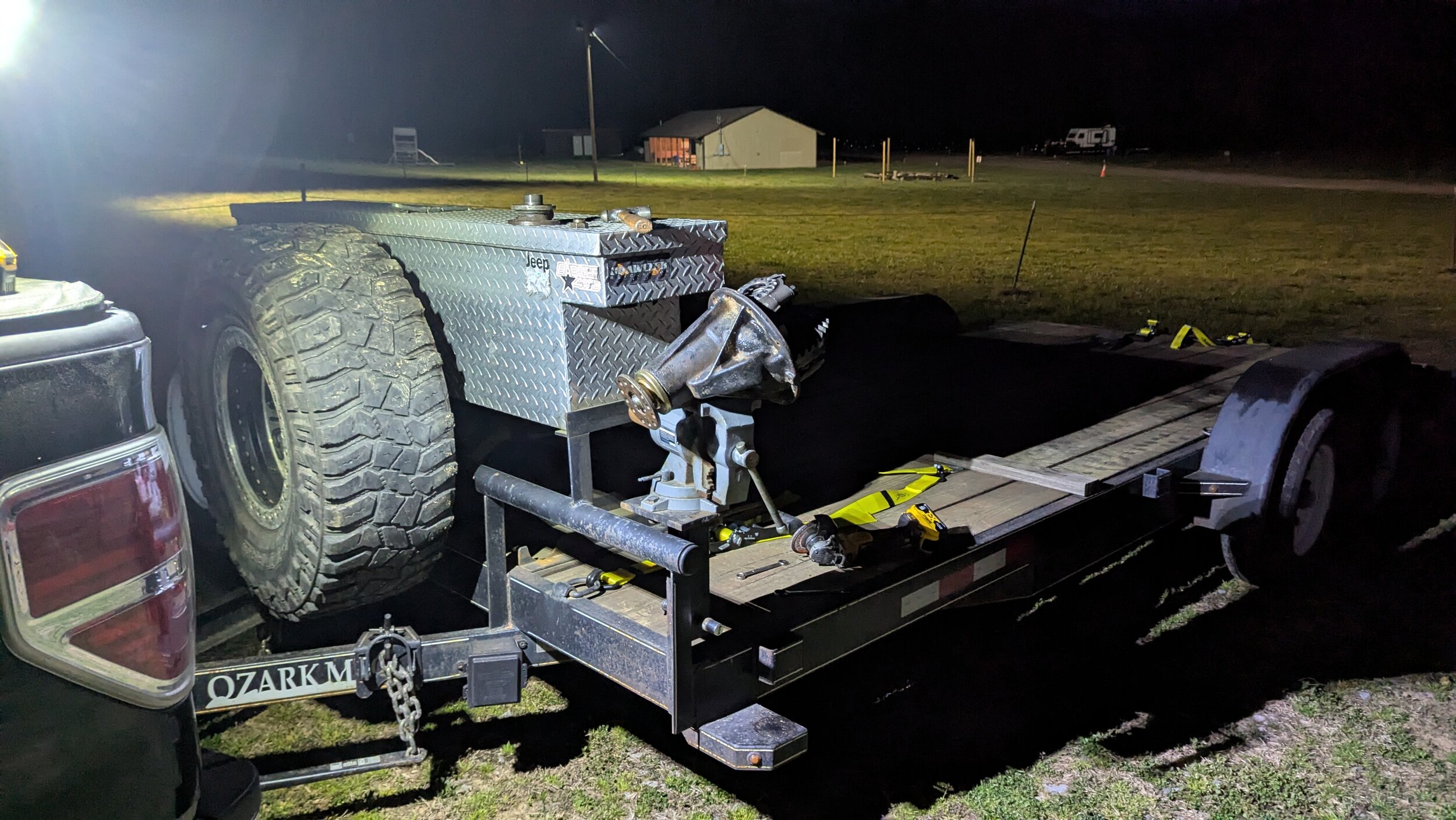

Had to change the yoke and clean up the mating surface for RTV, so the vice mounted on the trailer once again worked out nicely!
