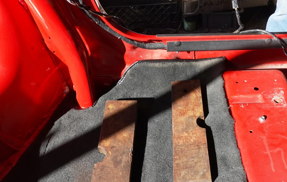

The left rear corner would not go under the tub rail very far. It was stretched pretty tight and pushing further only resulted in the molded corner at the long outer edge of the inner fender being pushed up too high.
Worse, on the face of it, there is not an immediate method to figure this out. (we did eventually though)

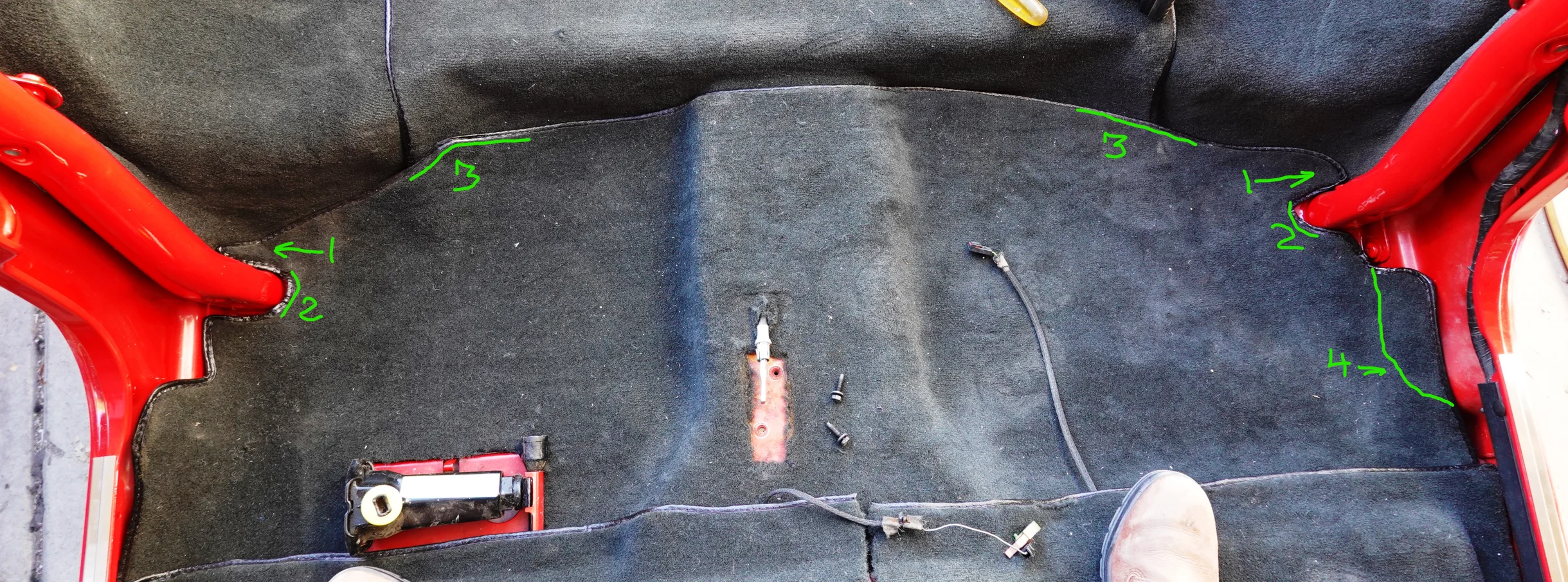

The other side is just fine. Molded into the corner like it should. After a fair bit of poking and prodding, we got the sides and floor of the cargo area sorta installed and moved to the passenger foot well. At this point, I'm starting to get annoyed.
Both 1's should be close to the same shape.
Both 2's should fit around the roll bar the same.
Both 3's should have close to the same shape. Of note, there is a gap where the trans tunnel meets the cargo step. It can't be slid back to close that up because the cuts around the roll bar dictate fore and aft location.
4 points to big flaps that just lay up on the side of the tub instead of being cut around the bubble. Big flaps may be okay, but they would need to line up with matching flaps for the front sections to be sorta correct.

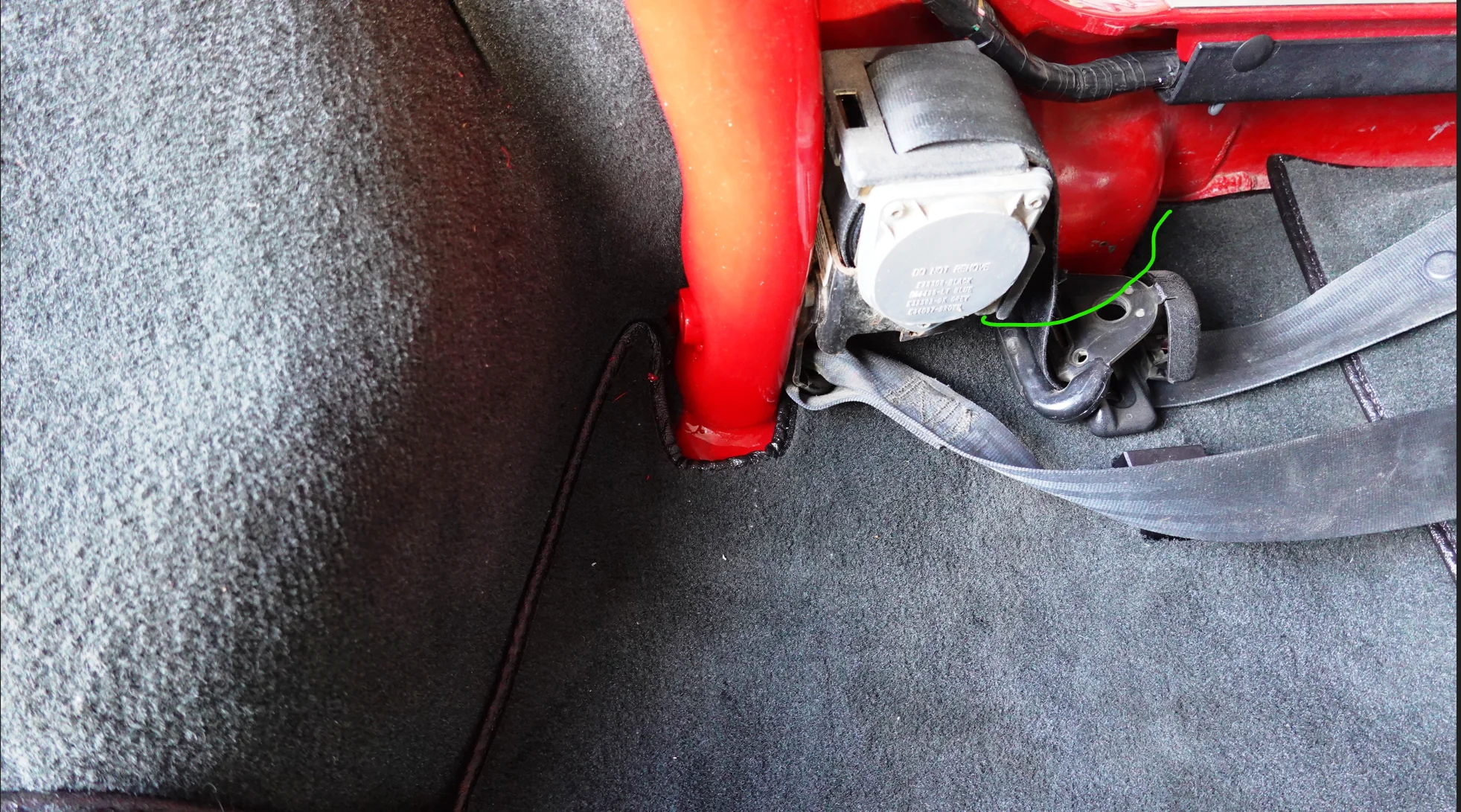

And no they don't. To match, they would be up around the green line under the door sill. Pay attention to the poor fit around the front bubble.
The left side. Better, still no flap and it does fit okay, not great, but okay.

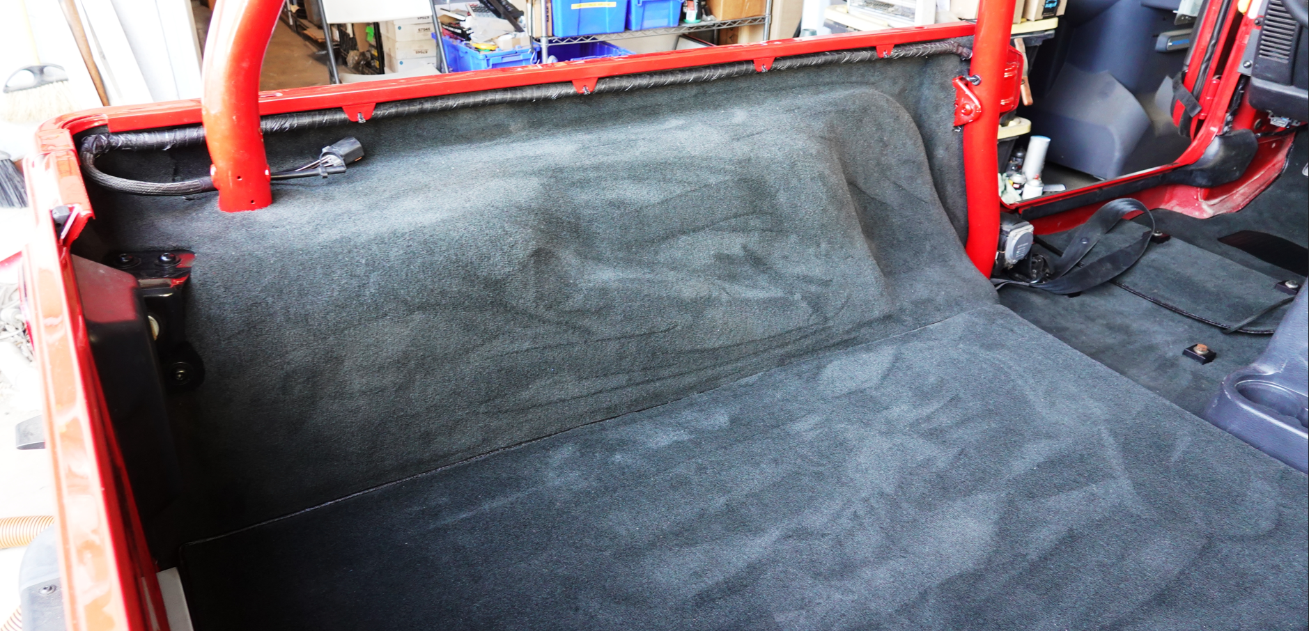

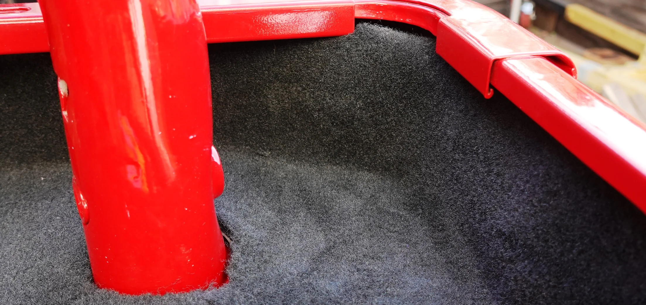

This one is pretty good. We still had to do a lot of trim work since they don't offer the quick install version, but this is how the first kit should have come. (mostly)

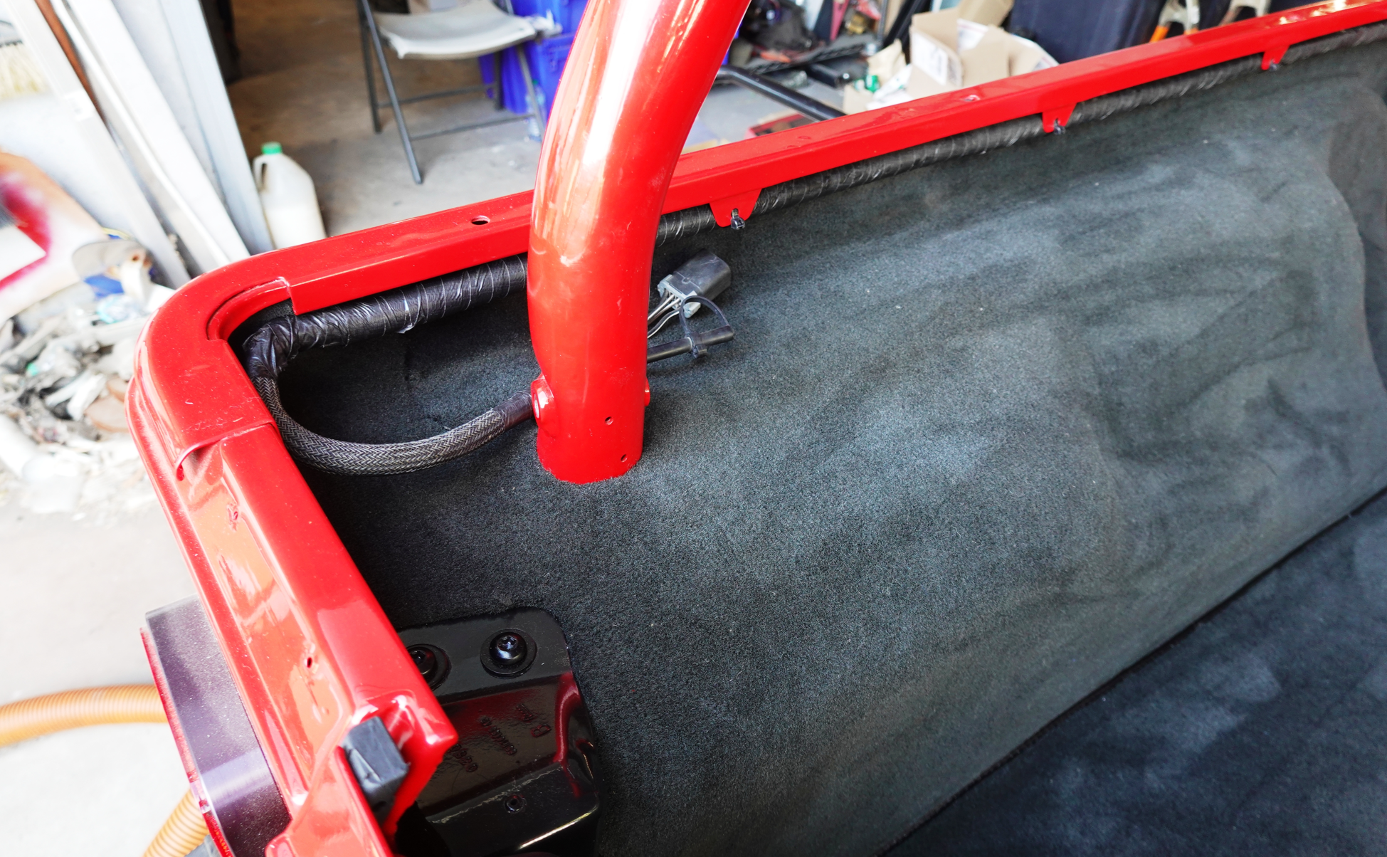

And just to show that we kinda know how to do this, this is our trim work for the roll bar.

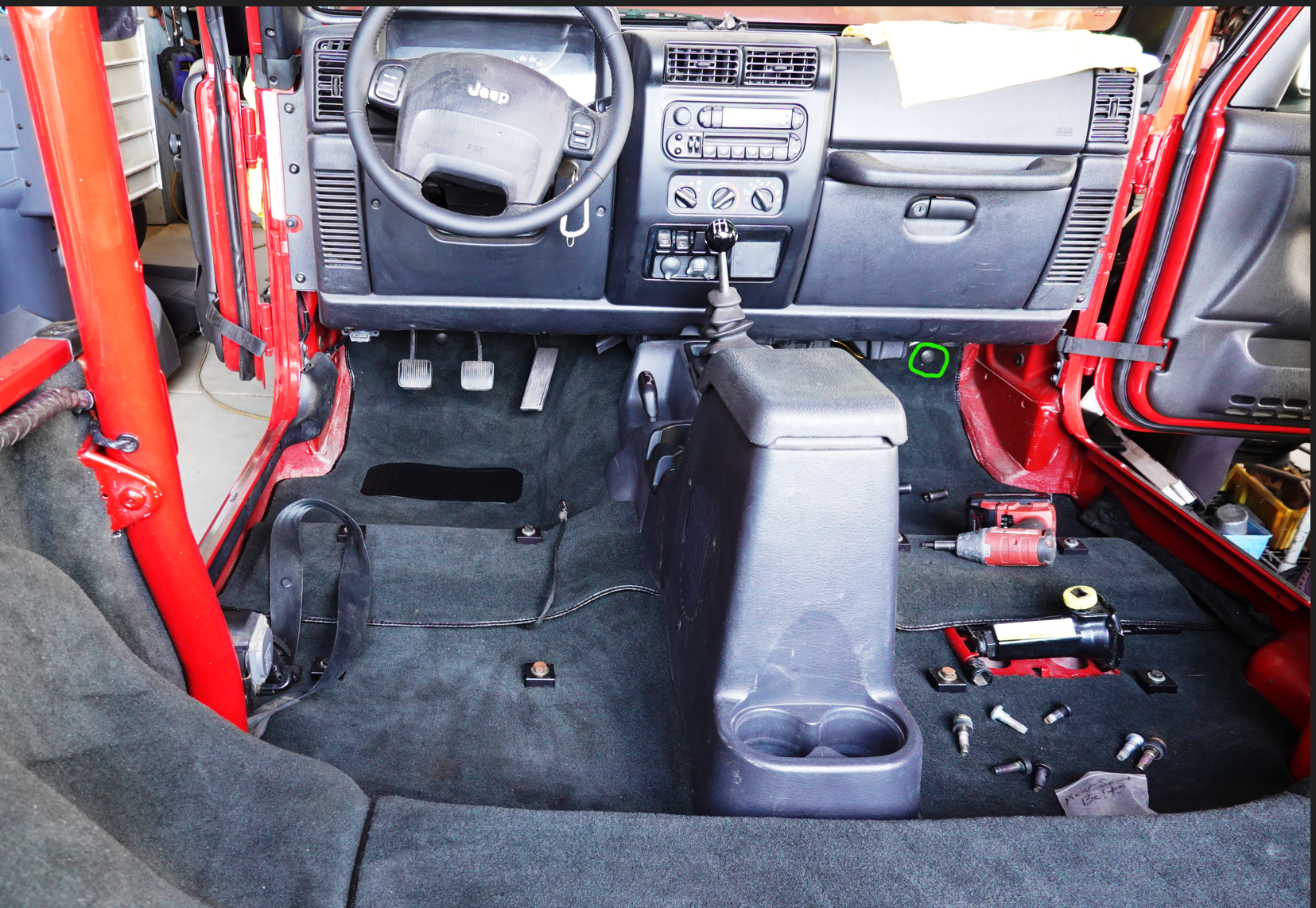

The front fits a fair bit better as well. We had to add a 5mm stud and use an OEM push retainer in the right foot well to hold up that section that folded back down on the floor, but all in all, the fit is acceptable.

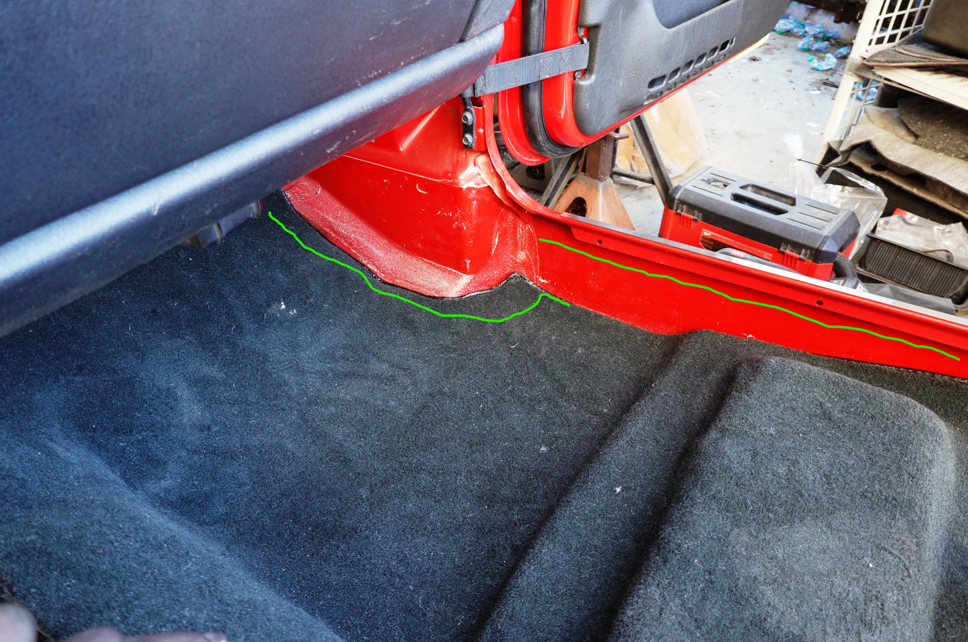

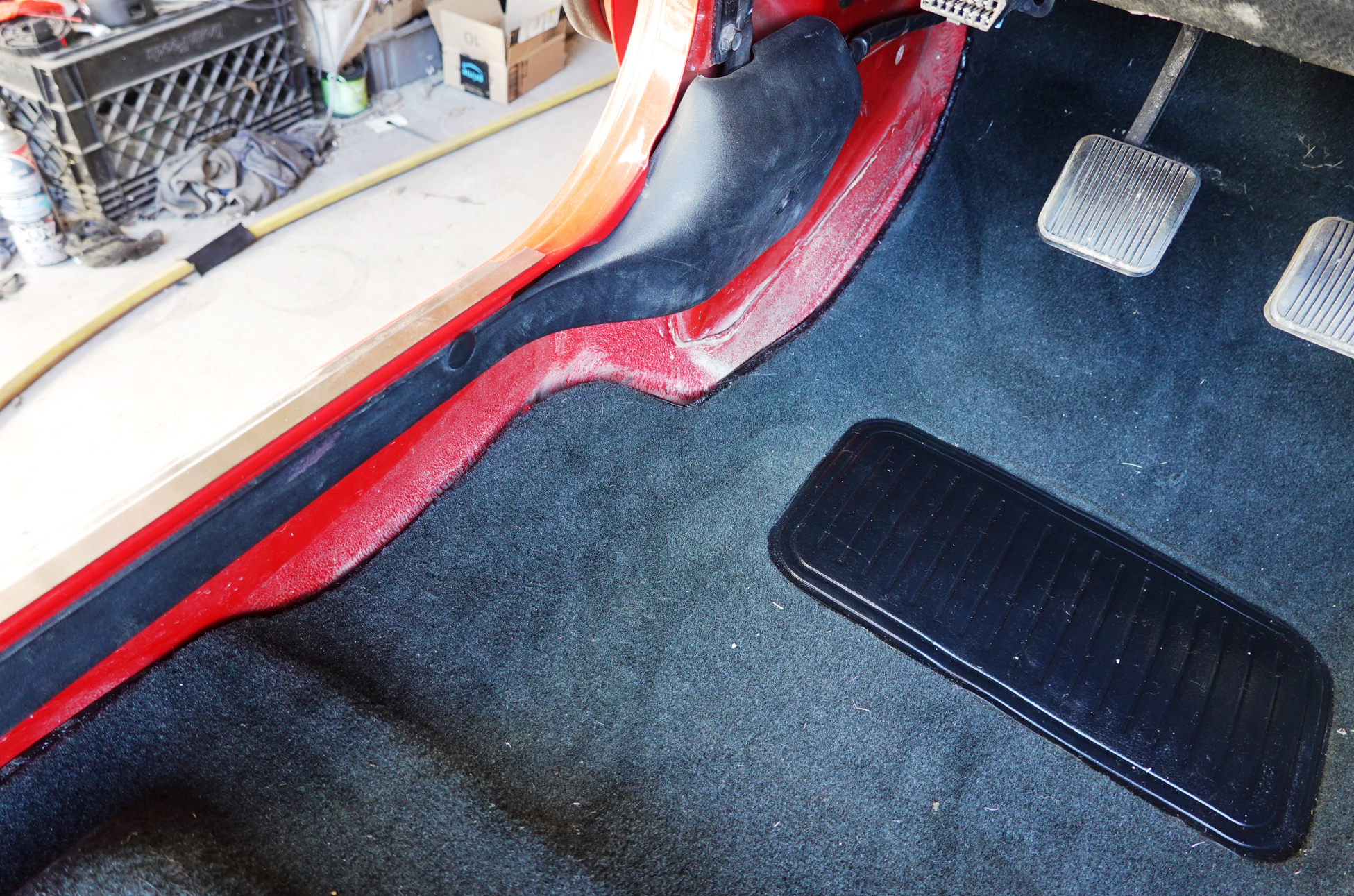

They still can't get the passenger foot well correct but I was over it by this time and we'll just pretend we don't see it.
We trimmed the flap at the green line which you can see on the right side above.
