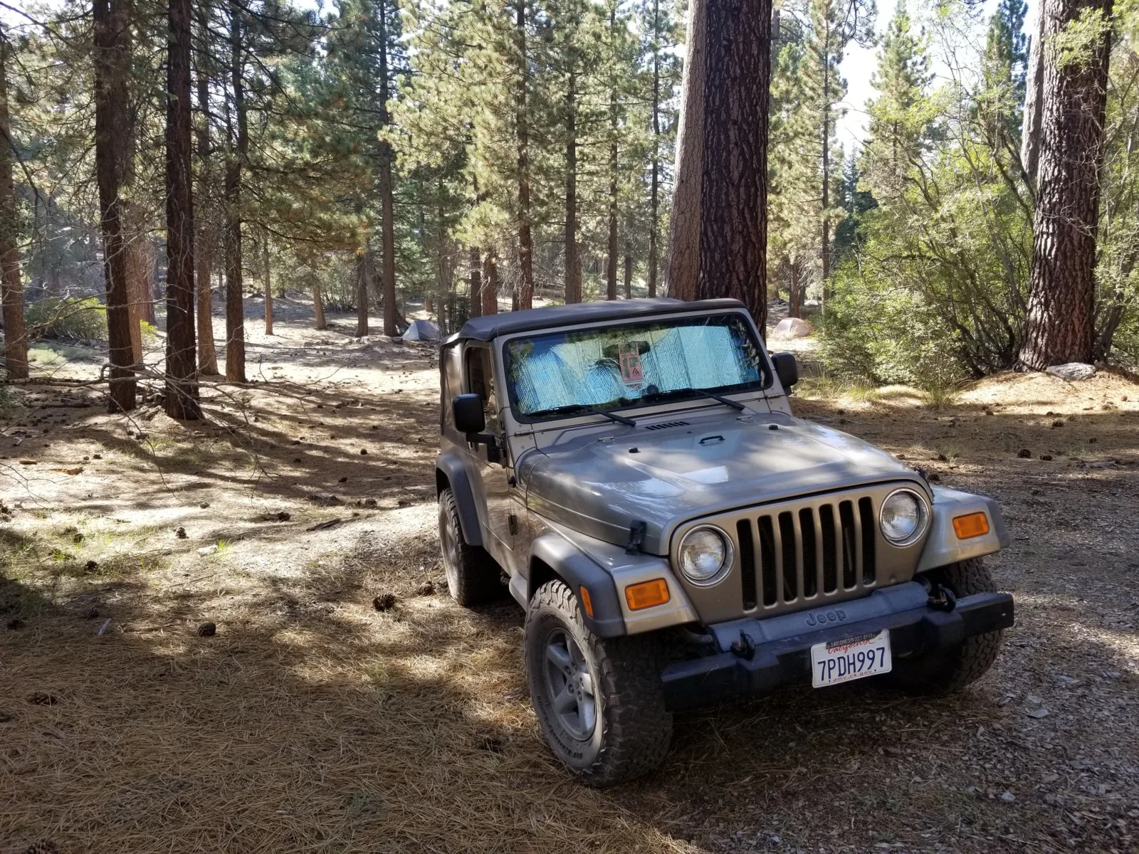

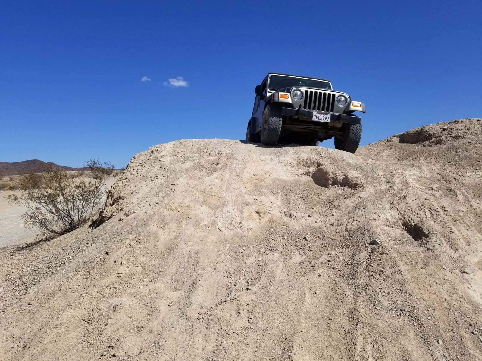

I looove my bfg ko2 at.
Just did a joshua tree desert run (soft sand) combined with sharp rocks, and mtn trails ( big bear) the day before. Tires performed excellent! And a 2.5 hr freeway drive.

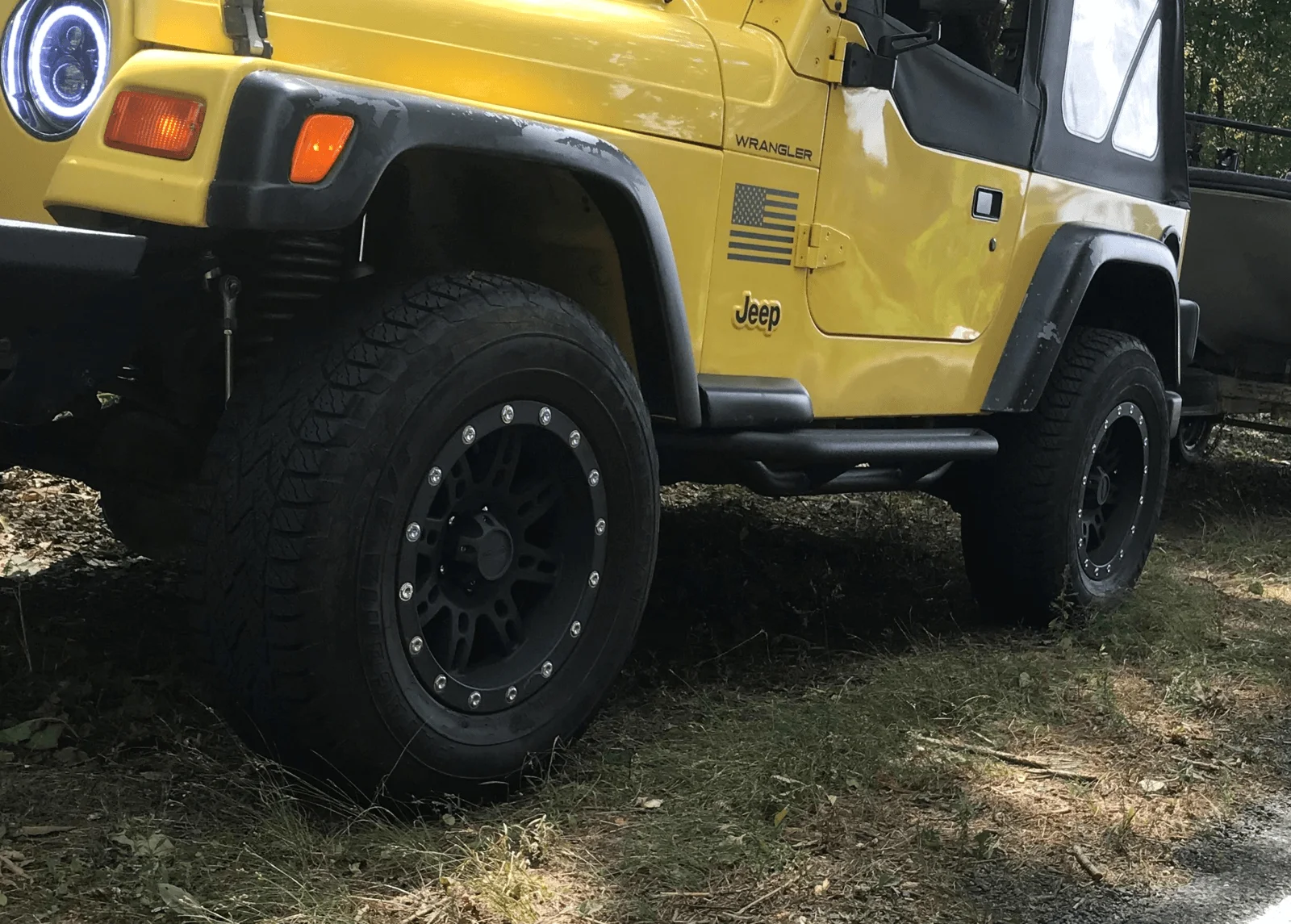

I have had nothing but bad luck with K02's personally. I have never had a set wear good, and I have had them on different vehicles. I actually just bought a 3/4 ton truck that has a set of 35's k02s, and they are the best warn set I have ever had, but I do like the duratracs. I would say they balance better than the BFG's in my opinion. I just bought a Cooper STT pro and I am really liking those on my TJ. They are slightly noisier than the Duratracs, but a little more aggressive. I have found the Duratracs to be quieter than the k02's too at least on my TJ.
Also as a fun fact Mickey Thompsons are owned by Cooper. I thought you would get a kick out of that!
I would say +1 for the duratracs and +1 for the cooper stt pro if you are looking for a little more aggressive. I am starting to be more of a Cooper fan lately.
I am not sure why the k02's are so popular, maybe I just got some bad ones, but I sure have not had much luck with them. Now years ago I ran the MT's exclusively and I really liked them, but I think now I would run Cooper over BFG's
This is just my opinion, and by the looks of it not a popular one, but there you have it.

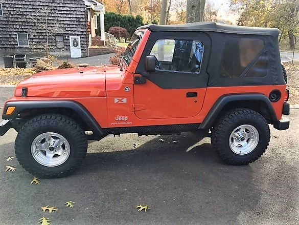

I put 31x10.5x15 Yoko Geolanders on my 2000 TJ 4.0 5 speed. I wanted to keep the suspension stock and avoid build issues when I am doing no rock crawling, 40% highway, 30% country roads, 30% dirt roads and over land. My decision was to stay stock regarding suspension, and from what I have read on this forum, 31's are the max for stock. I had to add two washers to my steering stops to stop the rubbing, but no real big change in turning radius, but I know it is not as tight as if I had the original size tires with no rubbing. I am very satisfied with the Geolanders for my use, ride good on highway and seem capable enough for my off road use. Not going mudding or rock climbing anytime soon, so 31's seem perfect for me.
