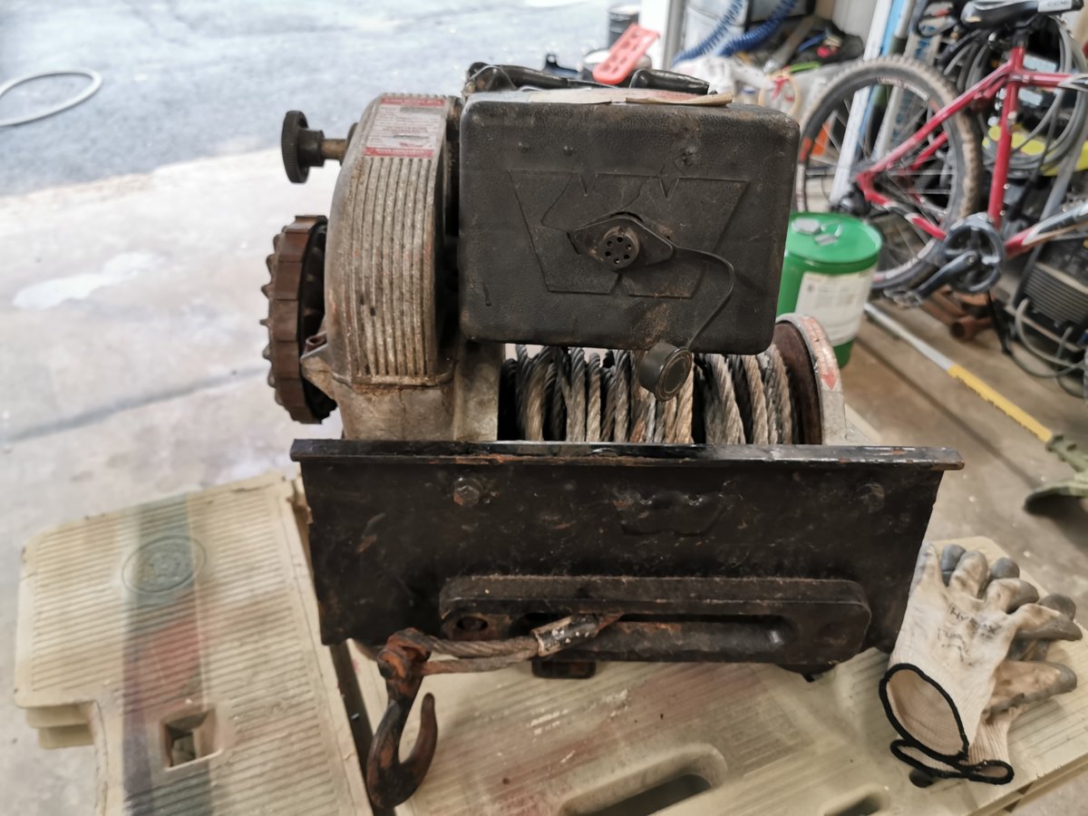

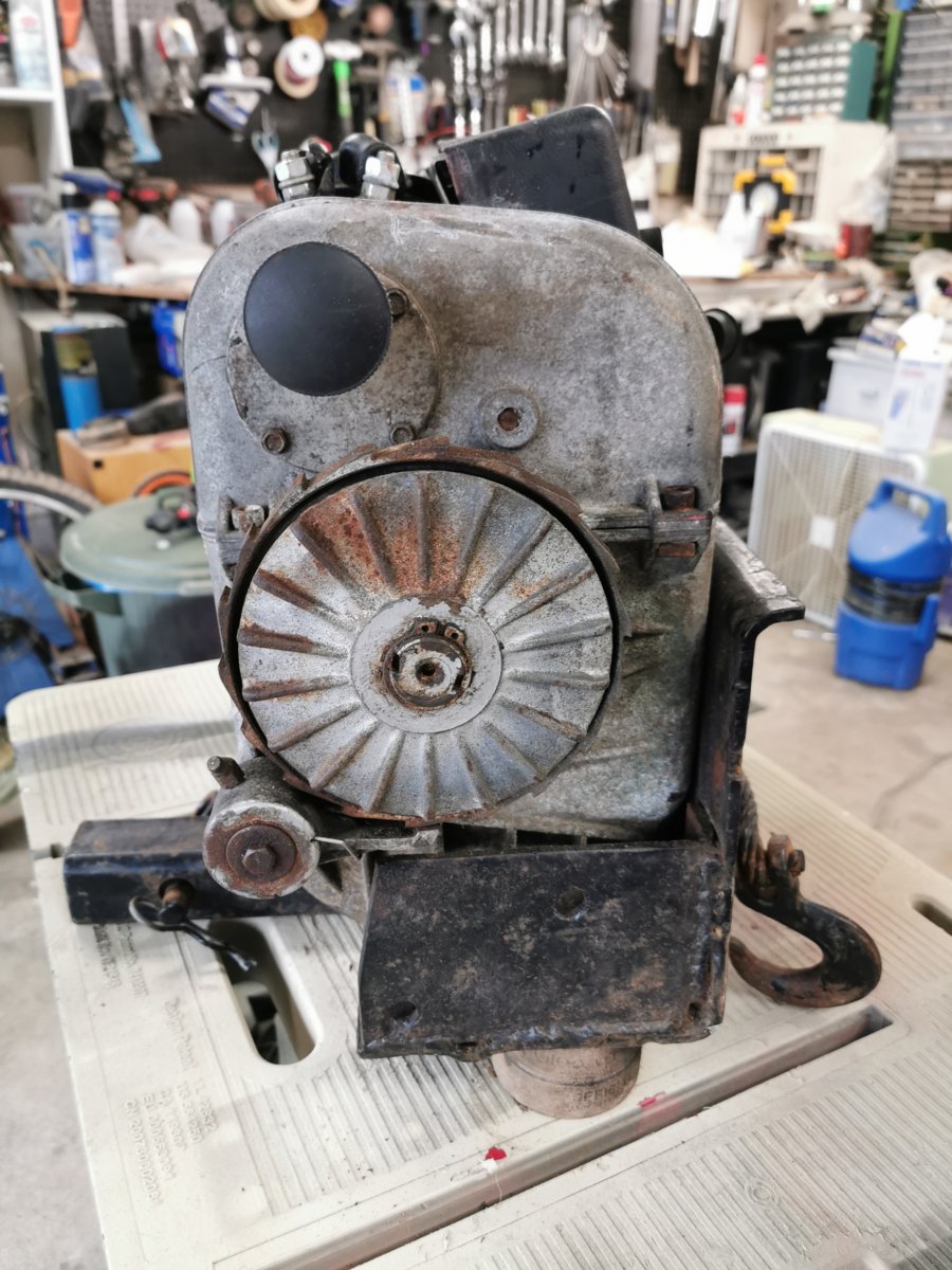

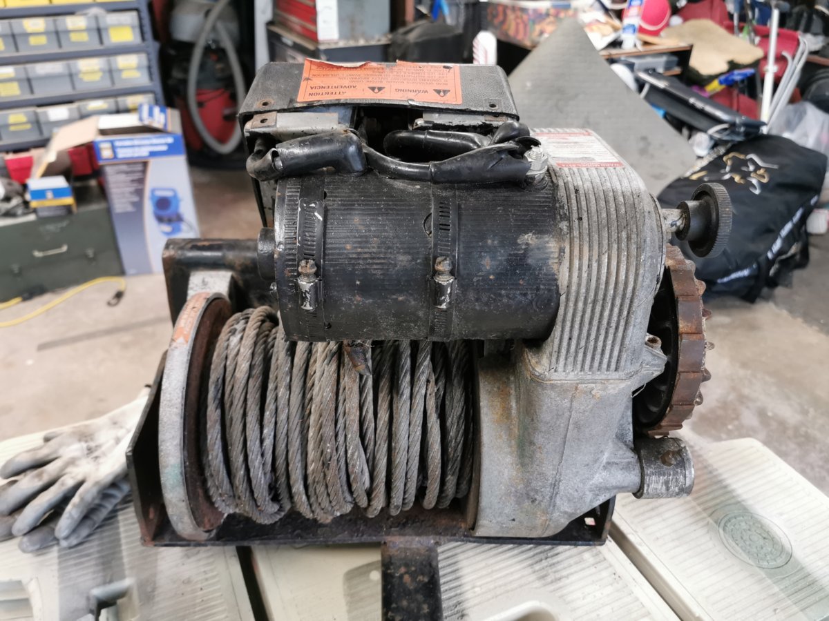

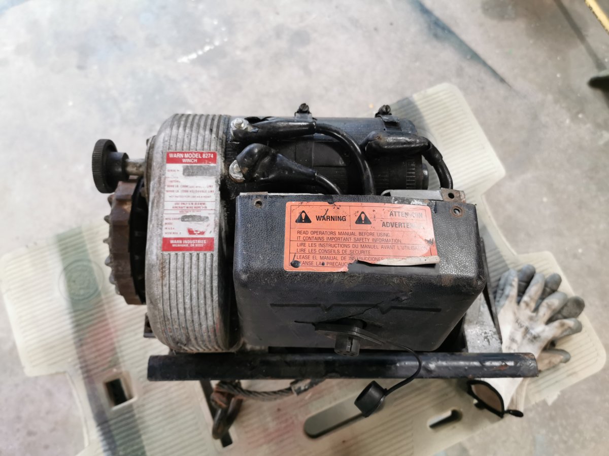

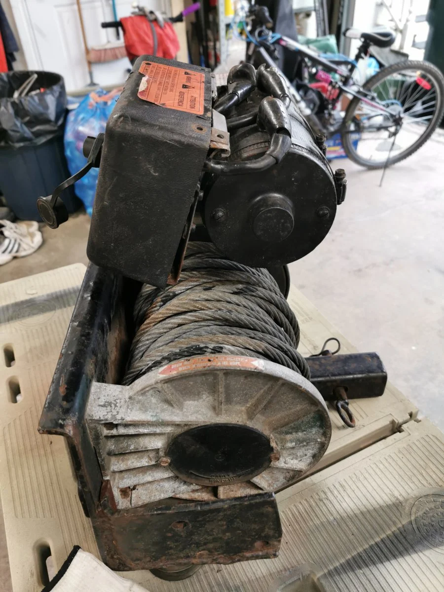

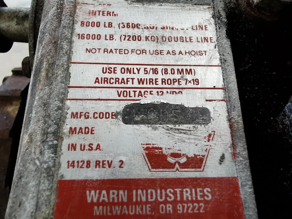

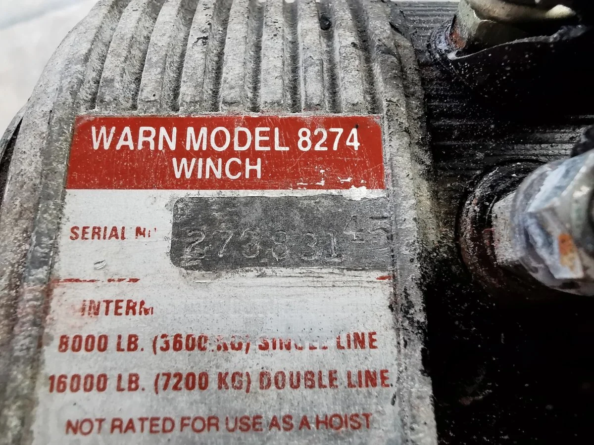

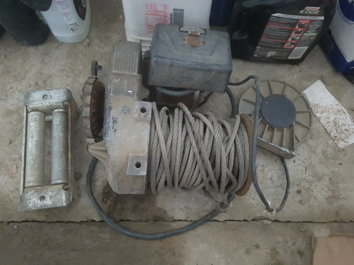

Speaking of used winches, I picked up an 8274 yesterday. It needs a new lower housing (got dropped off the back of a truck, or the PO broke it trying to remove one of the mount bolts), but everything else seems in good order
IMG_20190621_185416.jpgIMG_20190621_185324.jpgIMG_20190621_185349.jpgIMG_20190621_185336.jpgIMG_20190621_185404.jpgIMG_20190621_185356.jpgIMG_20190621_185410.jpg
View attachment 100643View attachment 100644View attachment 100645View attachment 100646View attachment 100647View attachment 100648View attachment 100649

That 8274 looks heavy! Is it possible to switch over to synthetic rope to lighten it up a bit? Just curious...
Of course but that weight difference wouldn't be significant when all things are considered. That said I'd still switch to a 3/8 synthetic. I went through 3 wire ropes due to kinked/broken strands in a couple years caused by multiple pulls some days when there was no chance to respool it evenly. Made the switch to synthetic and no more problems. Synthetic holds up very well to hard use with reasonable care.
Reactions: EJD
I'd say it's gotta be 100-120 lbs.
Loaded with steel cable perhaps but not empty.
Fyi the weight difference from 125ft of steel with a steel hook to 125ft of synthetic with an aluminum thimble is probably close to 30 or 40lbs. It's not insignificant but in the grand scheme of a 4500lbs jeep it's not much. Switch if for all the other great reasons to run synthetic if they matter to you, but not bumper weight. On my 8274 I run synthetic and will never go back. But the only part that weight plays in that is the weight of pulling it up a hill behind you.

Yeah, when I picked mine up it had a full spool of cable on it, and was mounted to a heavy hitch mount. It felt quite a bit lighter after I removed the cable and mount.
I will eventually switch to synthetic, but it's not a top priority right now.

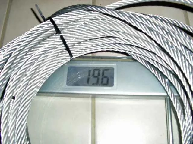

125' of 5/16" wire rope is right at 24.5 lbs. My 100' of 5/16" wire rope weighed just under 20 lbs. 125' of 3/8" synthetic is 4.25 lbs.
For just the ropes there is a 20 lb. difference between the original 125' of 5/16" and 125' of 3/8" synthetic.
