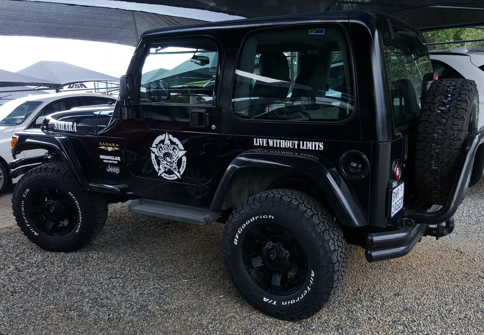

HI All - I am based in SA so need t o order correct parts first time round
I just did a Quadratec 3.5 inch lift on 33 inch rubber the ground clearance is decent but i also have the spacers you mentioned in the previous thread, need to see what material they are and if not solid metal defiantly need to make more robust. Seems to run well and have had no issues since the lift.
My only issue is down on power due to the 3.73 gearing and 10% down on Speedo and actual speedometer reading due to larger tyres. I am looking at a 4.88 or 5.13 ratios change. I have a 43 RLR box with lock up Torque Converter and heavy duty DANA 44 and DANA 30 on the front. I have Trac Loc ( LSD). Please can you advise on the gearing to go for 4.88 or 5.13. From what i have read my car has a 4th gear 100: 1 and 3rd 069:1 for in 3rd gear at 120kmph should be around 250 - 2600 on 4.88 and in 4th gear at 120kmph should be around 3500-3600. I regularly do highway speeds in SA at 120kmph. (Speedo is off so will need a Transfer case speedo gear for the final rations)
Given the 4.0 is a low reving low torque motor I want to be in the power band between 2000 - 2800. I believe on the 5.13 ratios I should be at 2700 at 75mnph ( 120kmph). This should be spot on right? or slightly lower 2500 if i use the 4.88 ratios. Also any thoughts on best brands Motive or GT2? I am based in SA so want something that lasts. Would wlecome thoughts as well as I will be opening up diffs, should i look at replacing the Trac Loc on the DANA 44 and go for a locker on the Rear or all round including my DANA 30 . Need to get it all right first time
