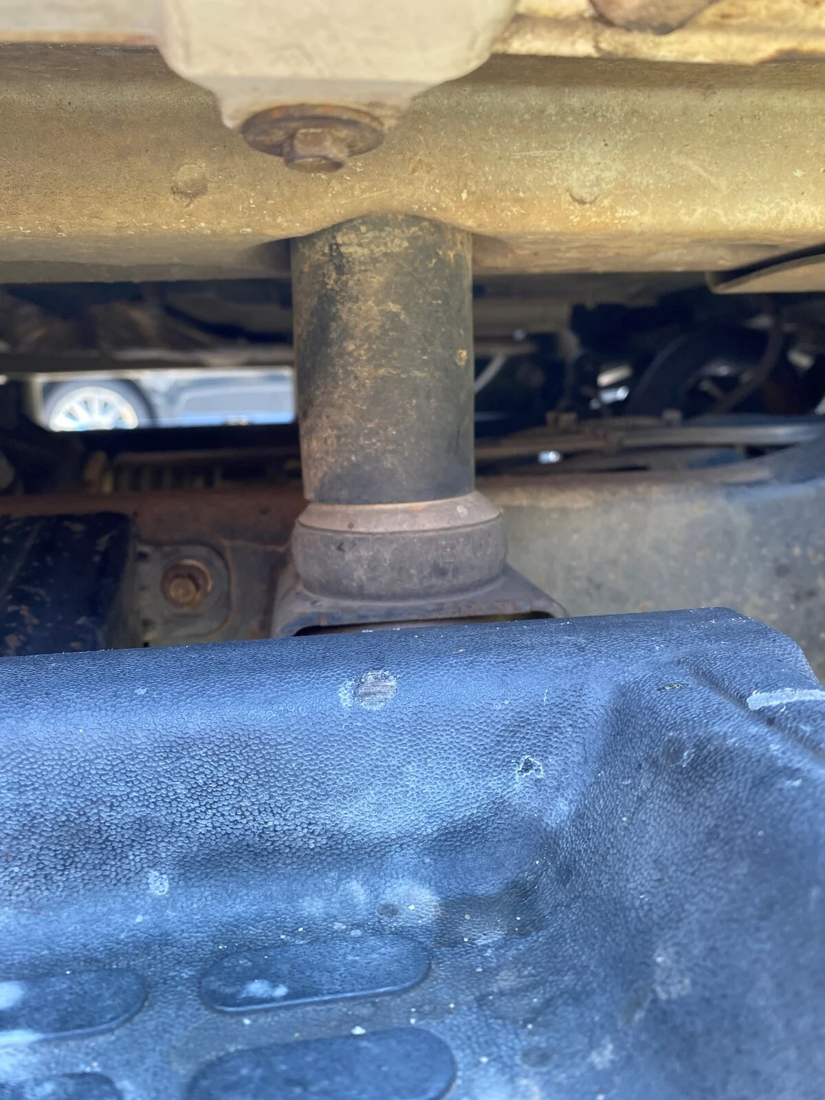

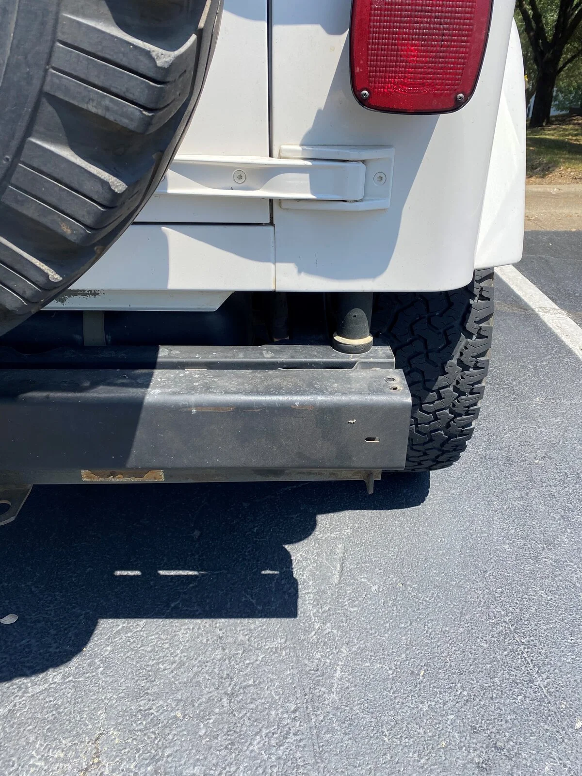

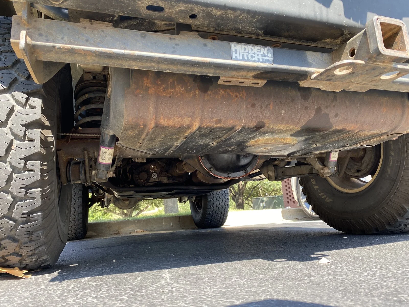

Before deciding on a course of action, can we see pics of your transfer case skid, gas tank and maybe your motor mounts? I don't feel like there's anything to worry about there, but better safe than sorry

Those aren't stock tires, you know they're going to fit before pulling it? Good to have an idea before wrenching. Guys on here that can tell you with confidence. Also those look like Mopar shocks, curious if those are original? Don't see those on this forum very often, ha.
No they’re 33’s and I’m debating if I want to add a suspension lift when I get rid of the body lift or go down to 31” tires. I’m leaning towards new tires for now because I live in Dallas for school and do a lot of highway driving. I’m thinking that smaller tires might be better since this is my daily.
And yes they are stock shocks! They’re actually surprisingly pretty good but I will be upgrading them soon.
31" tires are a good idea along with loosing that body lift. If the you like the ride forget about the shocks, they are fine.
