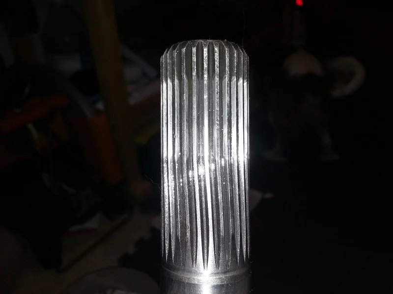

My concern has always been hidden damage from before with 35s on the stock axles.
Best to pull them and see. This is what I found when I pulled a pair. A break waiting to happen!
Reactions: rasband
If the splines aren’t twisted and the ears are fine I wouldn’t trip out about running 33’s on an open dana 30 in your environment with the stock shafts. If you want to upgrade you would be fine with any reputable axle company.
