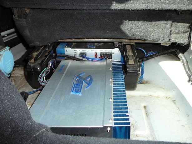

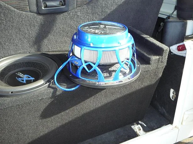

New head unit
Rockford Fosgate PS-8
Polk DB’s in dash and sport bar
$450
Total stealth
RFosgate is mounted on underside of rear seat. 😊
3 years going 💪

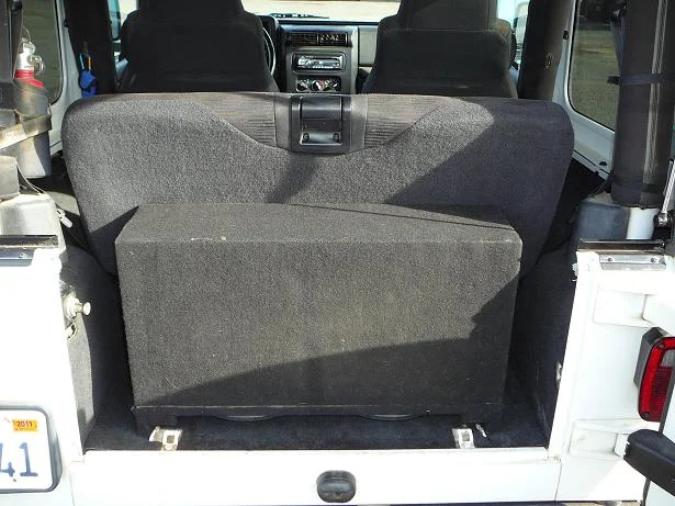

I don't listen to rap whatsoever. However, the bass is pretty damn impressive for the size of the sub. If you're looking for serious bass though, you'll probably want an enclosure to go in the trunk with 2 10" or 12" woofers.
Yes! I have a Kenwood Box in the back trunk area. It does work very good.

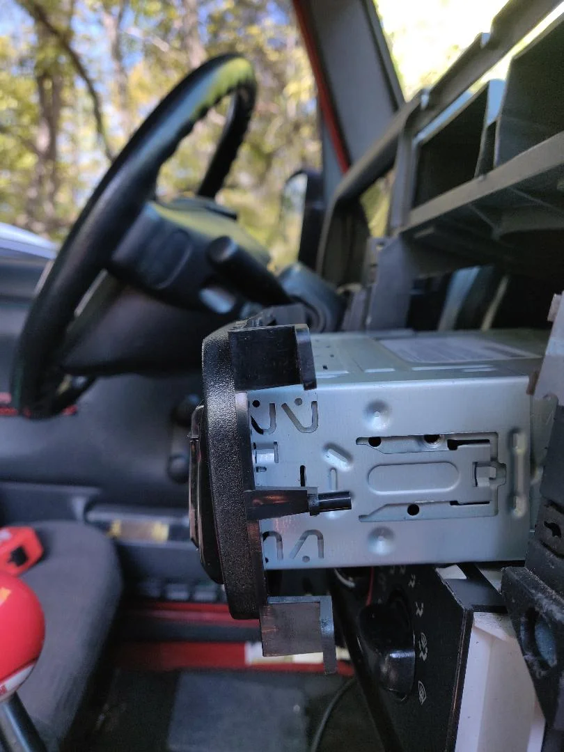

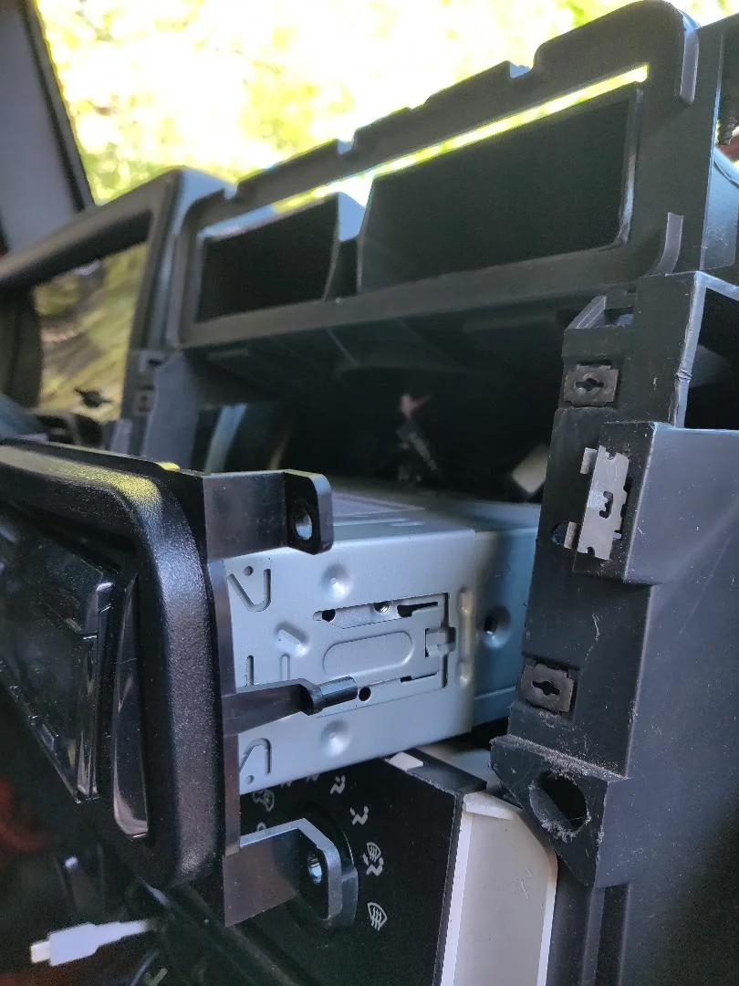

How are you guys installing the head units so they are solid? There is nothing to secure the unit to. The stock support bar has to come out to fit the deeper unit and then you're left with an empty hole. The unit I have is a cheap one that needs to go already but I'd like to do it right this time around.

Thanks for the reply. I'm still confused how that secures the head unit. I have an installation kit that looks very similar to the one you linked. When you slide the unit into the provided "hole" (for lack of a better description) nothing bolts the unit in. What stops the it from sliding forward? It just flops around until the face plate falls off.
The free one from Crutchfield, which is a Metra brand, provides enough support. The head unit weight like 2-3 lbs, so not much to support, and this Metra bracket attaches to the front of the head unit, which attaches then attaches to the Jeep, with a male peg on each side and four screws, two on each side.
My Jeep's audio happens to be apart right now so I snapped some pics. I have had an aftermarket head unit installed like this in my Jeep for a long time, 7-8 years, and multiple head units.
I guess I'm not describing the issue well enough. I have the same install kit. Looks almost identical. The only thing keeping the head unit in place is the tiny plastic surround on the front of the unit. I don't have my Jeep so can't take a pick but it's the plastic trim on the front. That tiny trim piece clips to the metal and is the only that thing that keeps it from falling back into the dash. If I hit a bump, or even just push a button too hard, that trim piece falls off and the whole unit falls into the dash.
