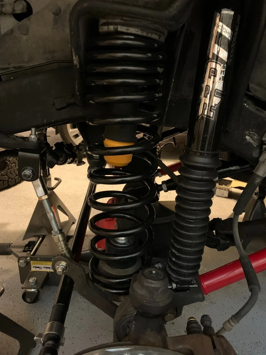

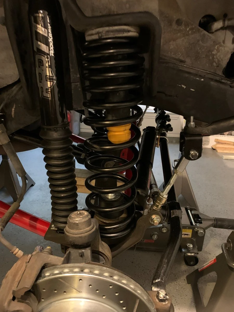

Here are two pics, one from each side of the coils and shocks. Doesn't anything look wrong or unusual that would cause the driver's side to be 3/4 of an inch higher than the passengers.
Both seem to sit perfectly in the lower perch with the end of the coil snugged up against the notch in the perch.
Progressive springs can be very sensitive to small weight differences if you are light enough to rest on the lower rate section of the spring. You could probably just gently push on the Jeep to even it out. I guess that's both the good and bad part of those springs.
Reactions: BobK
Once you jack it up trying rotating or spinning the spring and see if they are seated correctly.. the bottom end of spring could have come off perch
Reactions: BobK
Yeah I just did that and the springs were snug up against the groove on the lower perch. No change in height difference.

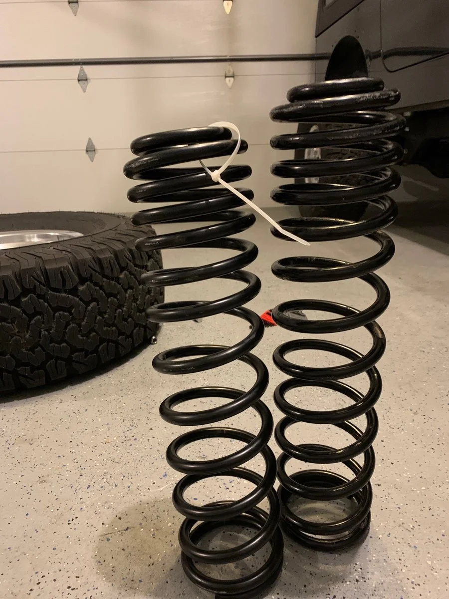

I called the manufacturer this morning and we discussed the drivers side higher than the passenger side. They asked for a ton of pics, which I sent. They then suggested I move the coil from the drivers side to the passenger side, which you guys also suggested.
I told them I was not thrilled with all that work only to find that the problem shifted sides and then I would need to take them off again and replace them with new ones. Instead, I was willing to take them both off and compare.
The coil with the white zip tie came from the passenger side. What do you think now.....I was not crazy!!! (my wife says that I am, just not this time)

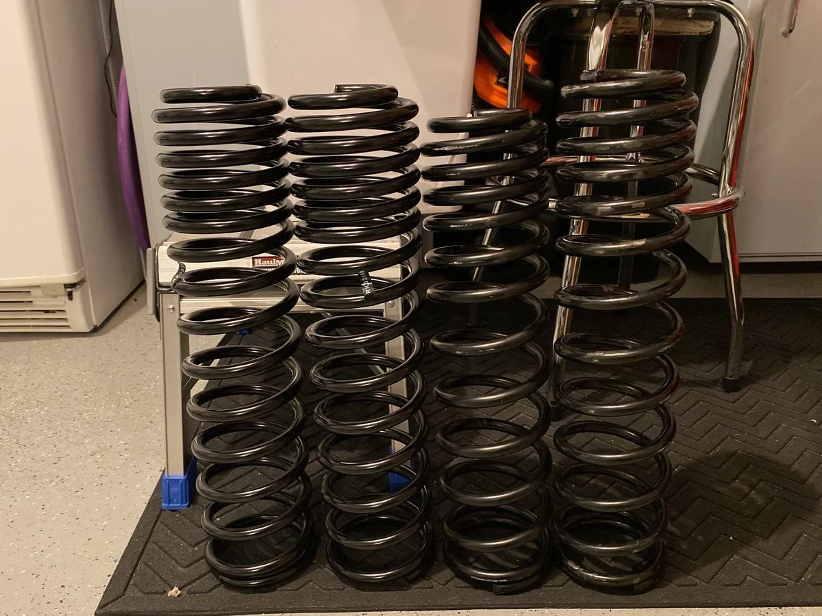

The replacement coil springs arrived on Friday, here is what they look like compared to the ones I had installed and now removed. The new ones are on the left, the old ones on the right.
The reinstallation is set for tomorrow.
Looks like they sent you a 3" coil by mistake.

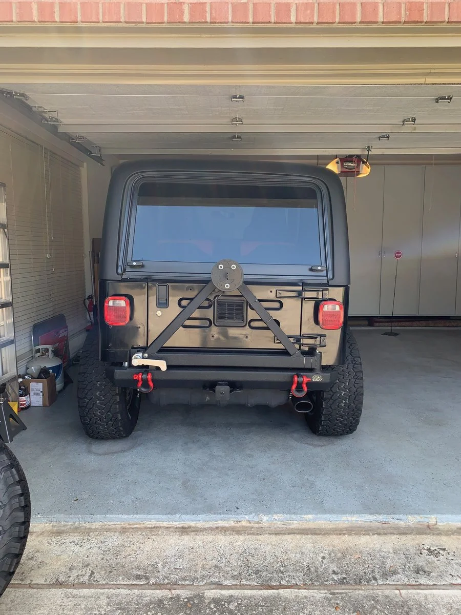

I could have lived with two 3" lift coils, but the difference between the two when mounted was substantial. For a newly lifted Jeep it looked a bit strange. (FYI, garage is level)
