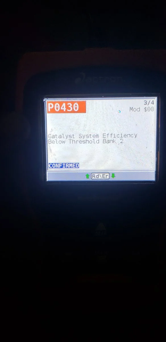

Ok sounds good. If it helps when I had advance Auto do their engine check since the light was already on and this is what came up
