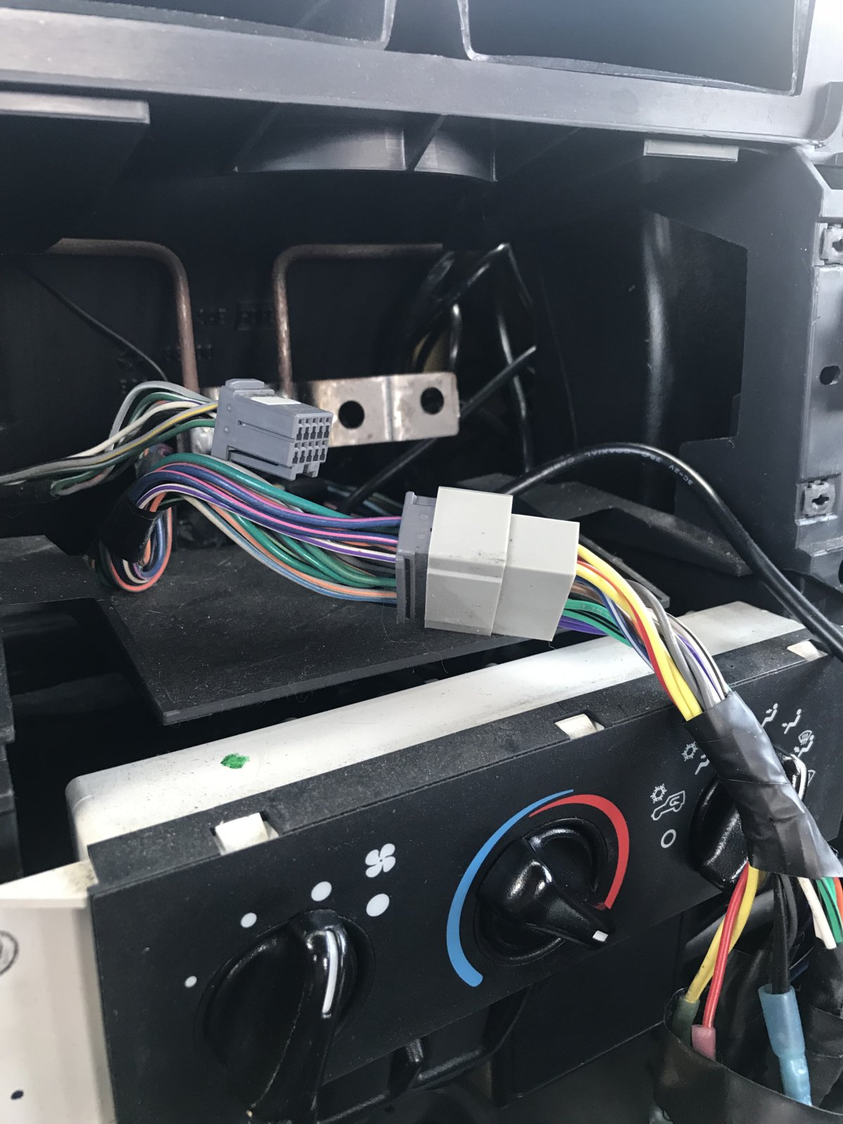

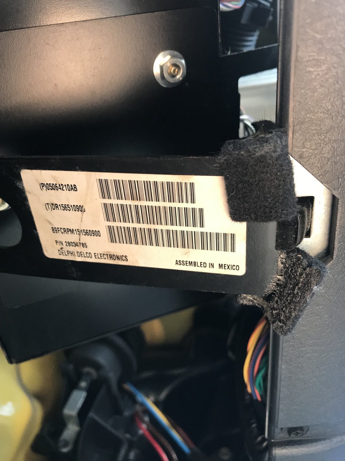

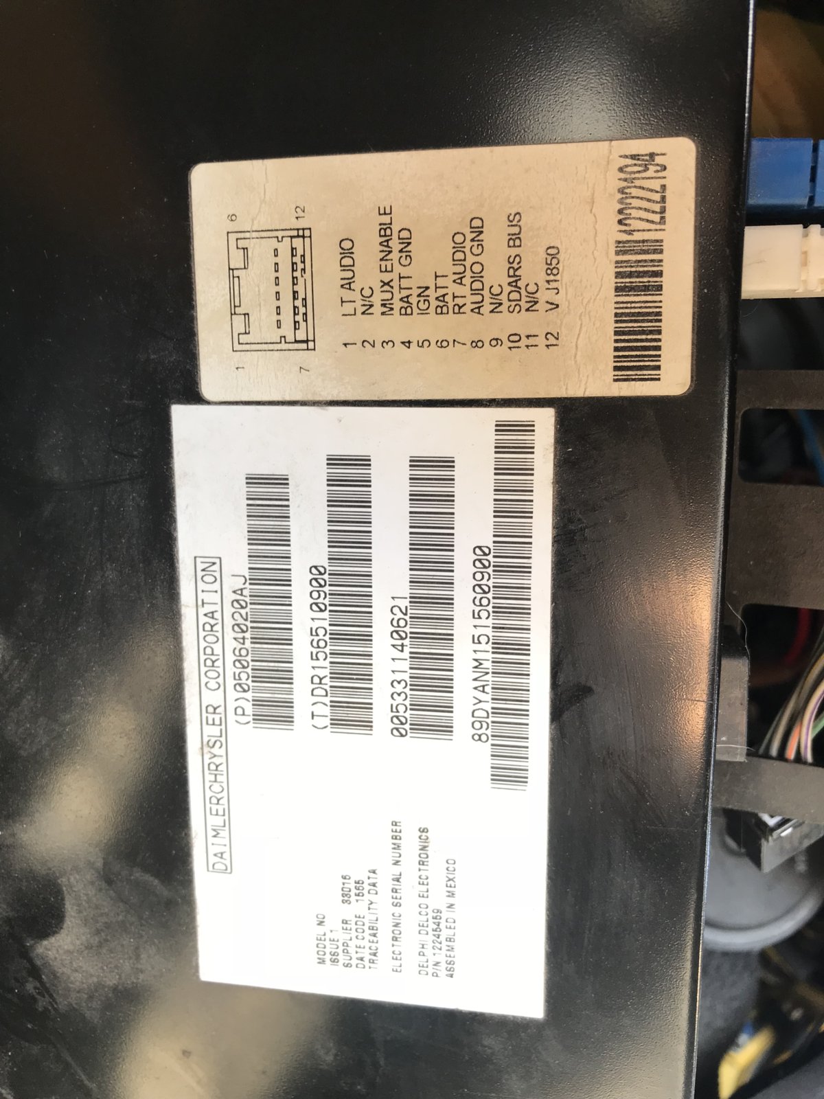

Well im not sure if what i found under the dash on the drivers side is an amp? It says its a "Delphi Delco Electronics" it has a grey 10 pin plug connecter and a blue and white connecters, both of the plugs run to the back of the non oem radio, the grey plug is not connected to anything at the radio?
That grey plug goes to the amp, yes. The amp is mounted to the back of the subwoofer enclosure. Once you remove the center console and the factory sub, you’ll see it more clearly.

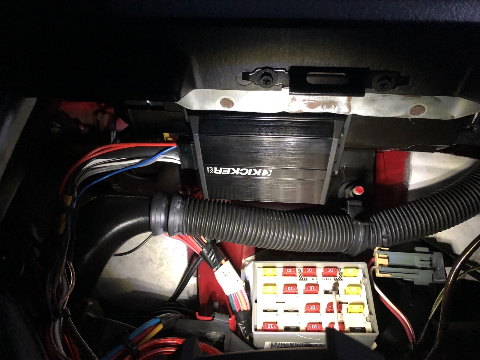

I mounted my amp right before the shifter console, under the carpet. As soon as I get home I’ll snap some photos for you. It’s small enough that you can very easily mount it just about anywhere. It really is a tiny amp. It’s amazing it puts out as much power as it does.
This is the gray box that is under the dash in the driver's side. The gray plug behind the radio was not connected to anything. Do you have any idea of what the gray box under the dash is?

Oh yeah, that grey plug isn’t the amp. The grey plug I am talking about is visible once the center console is removed.

I installed the same Kicker amp and sub in my LJ last week along with a new double din head unit and Polk speakers front and rear. The sound is fantastic and the sub delivers that little bit of low end that was missing. I ended up mounting the compact Kicker amp inside of the glove box via 3m heavy duty adhesive tape. There is a metal bracket above the inside of the glove box that offers a perfect mounting base.

Did you tap the fuse box for power or run a lead to the battery? Did you find a decent ground location inside the glovebox or was that ran elsewhere?
I ran powder directly from the battery and through the firewall grommet near the steering wheel. For a ground I was able to use one of the screw holes around the glove box. That allowed me to keep the ground wire short and easy to access.
