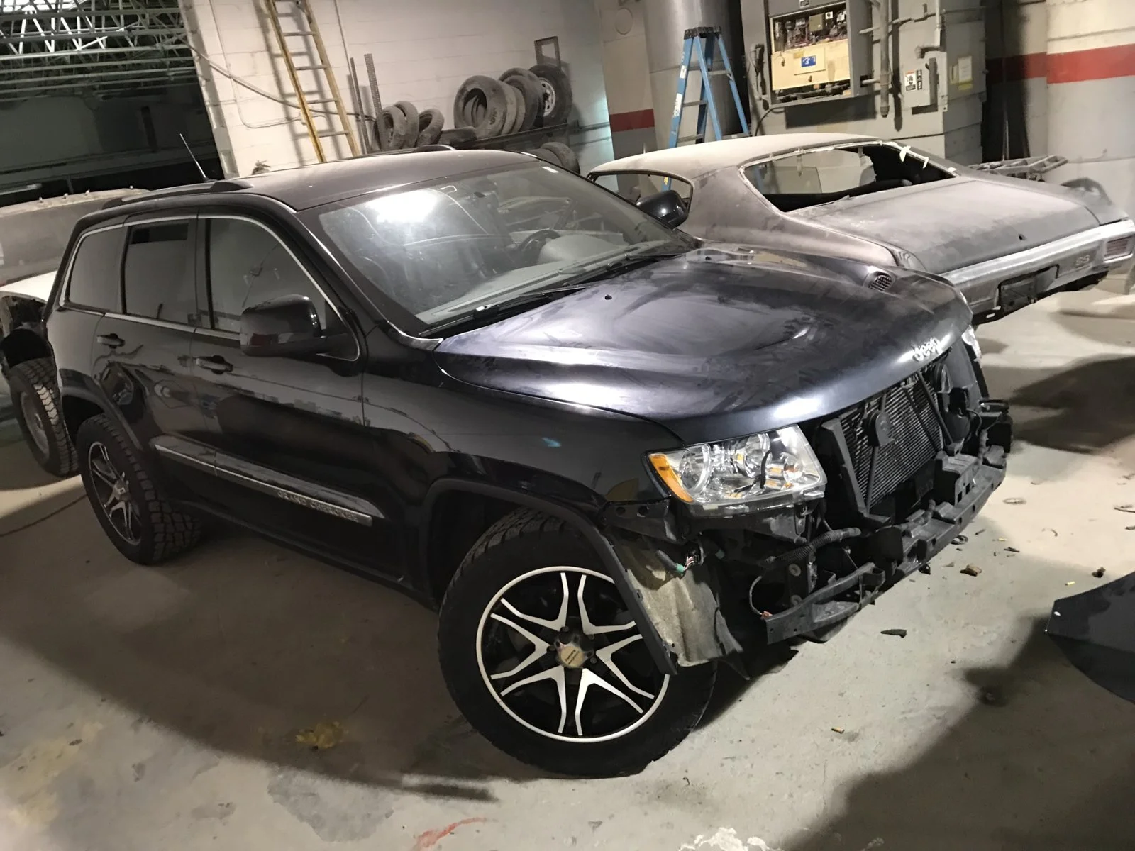

In the meantime my ram 1500 lease is up so I bought my cousins 2011 JGC Laredo. She hit a deer so I got a deal . It’s nice, leather heated seats, Hemi, AWD with the snow, sand, rock, sport settings, and upgraded audio. Now to make this one fast and loud! I’m such a glutton for punishment lol. :roto2lol:
