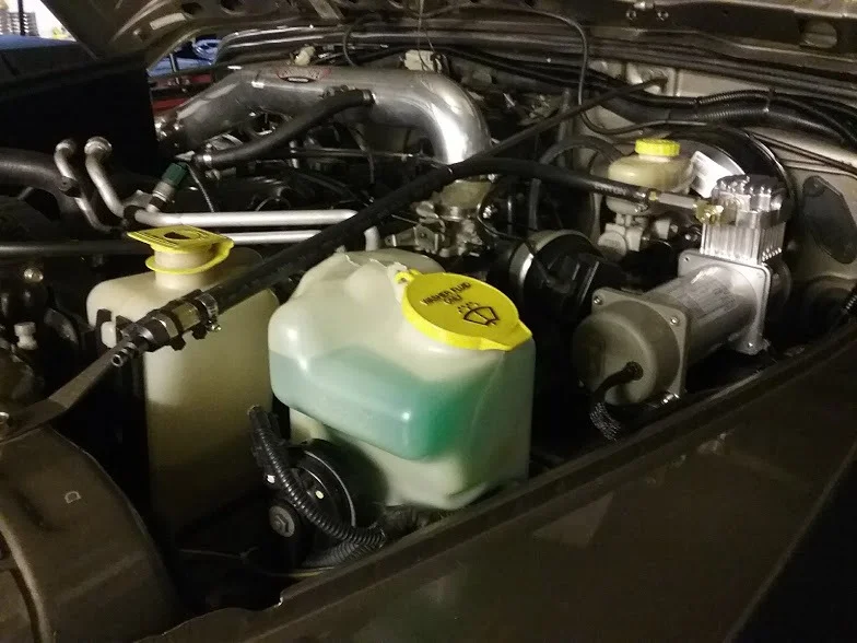

Here is my current set up which uses a Viair 400 series compressor:
https://wranglertjforum.com/threads/how-to-simple-onboard-air-for-your-tj-lj-viair-400h.10235/
